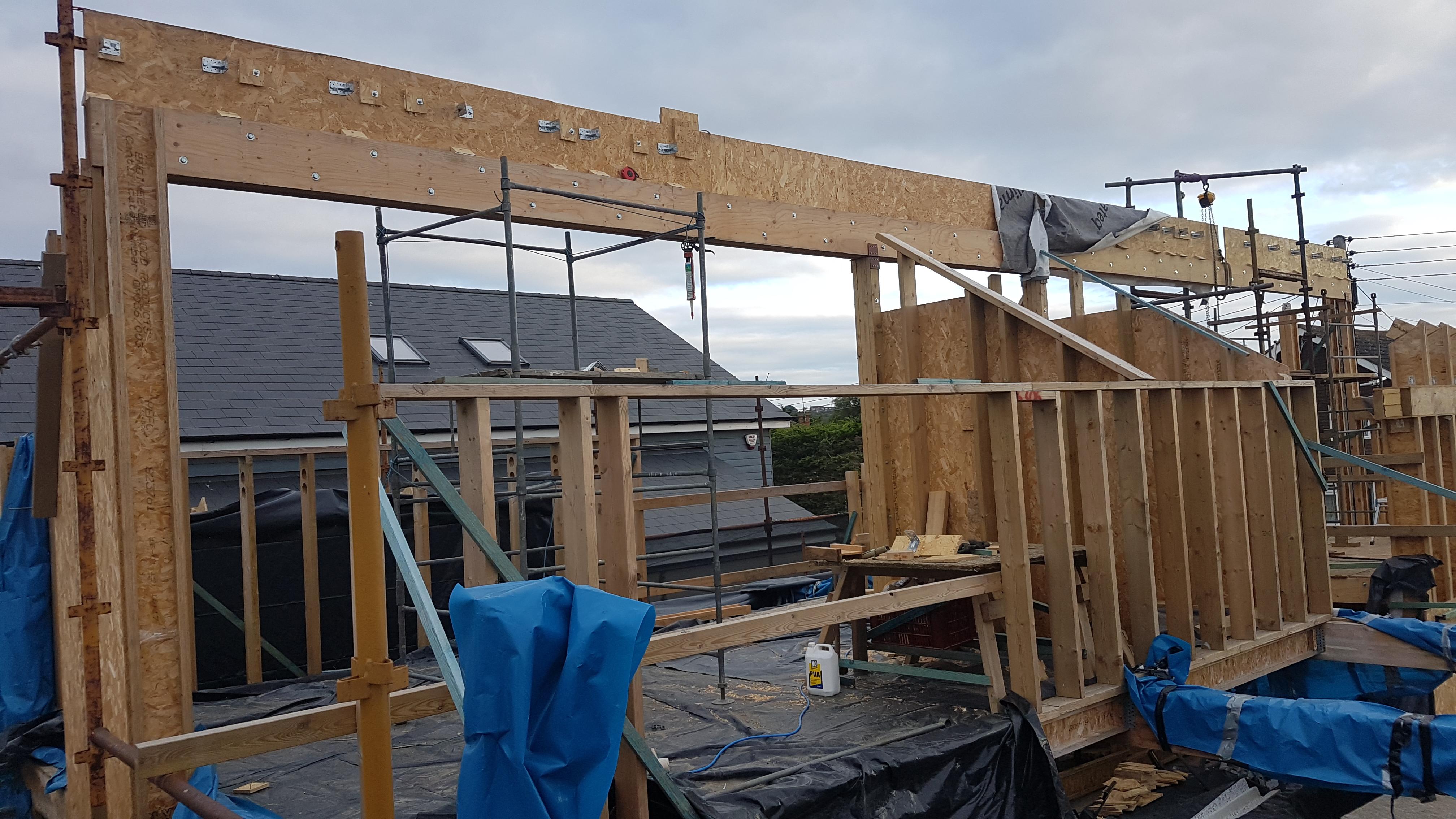

MikeSharp01 Posted August 27, 2021 Posted August 27, 2021 The longest we had were 7m 300x96 I Joists and we slid them up. I also lifted our ridge beam 8m x 240x320 Kerto assembly with headboard by building a scaffold above it and lifting it on a chain hoist, just got the hoist at the balance point which worked well - managed it all by myself! The picture is the smaller front beam lift but used the same approach on the main beam on the left. 1

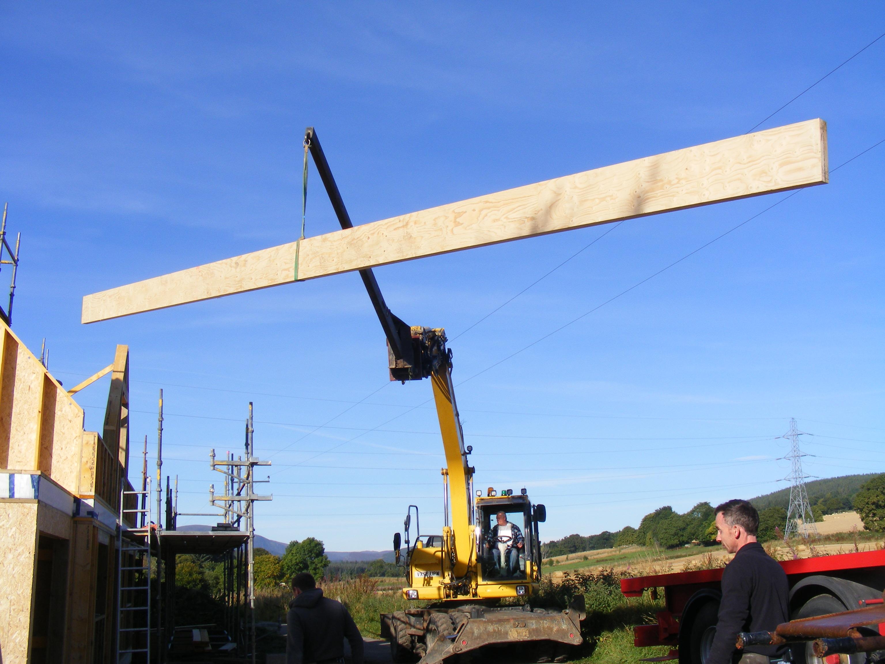

ProDave Posted August 27, 2021 Posted August 27, 2021 Here is my 11M ridge beam being lifted on with an extended jib on the digger. Larger beam so did not bend significantly and once balanced lifted from a single point.
