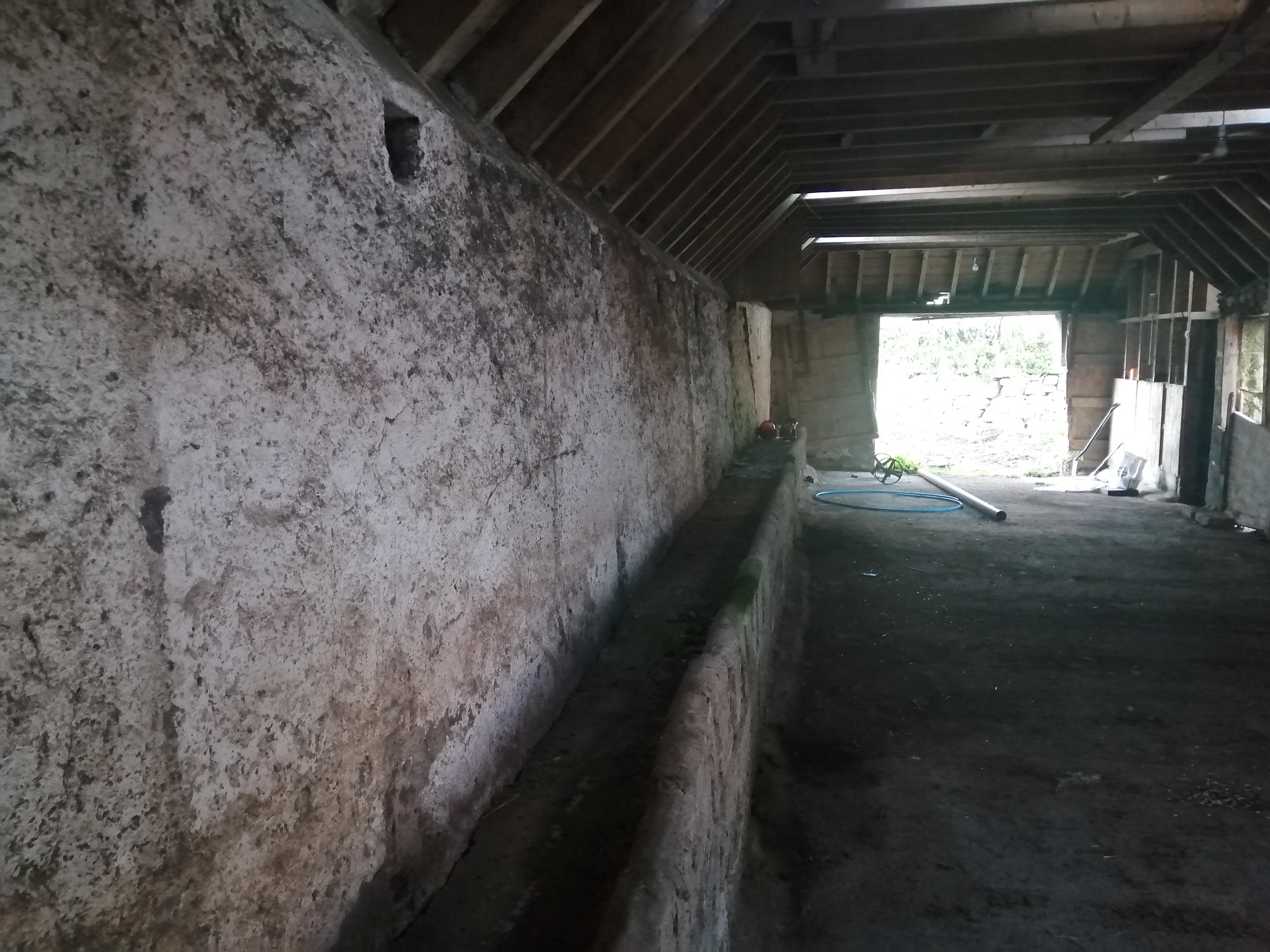

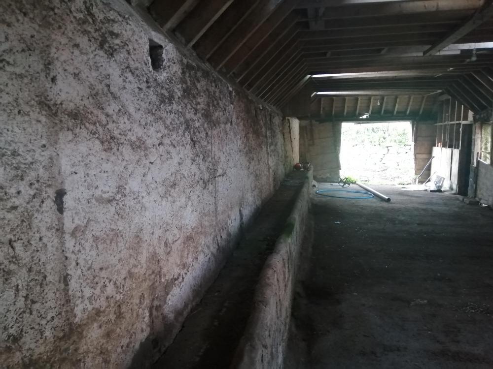

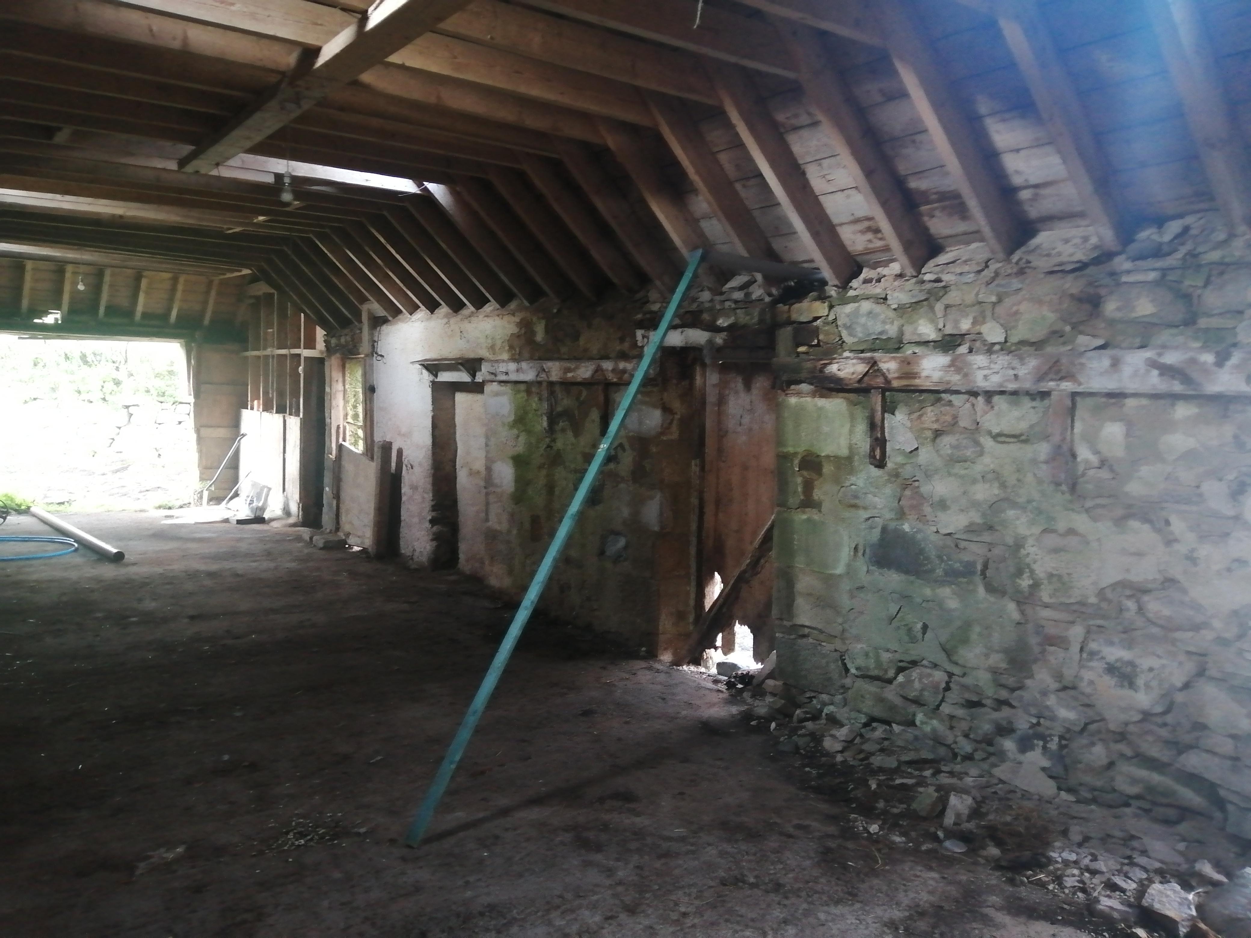

saveasteading Posted August 26, 2021 Posted August 26, 2021 A big dilemma. Repair or rebuild? The steading has four sides, with a central courtyard that used to be a cattle area. Three of the wings are unusually solid and require only local repair. The fourth, rear wing is another matter and it is for that I seek your learned thoughts. There used to be a roof over the central area. This was presumably a later addition as was the custom in the area, when cattle became a bigger earner. This canopy was in an awful state, so we have removed it. Already the building is in better order re damp and the leaning of broken timbers. The canopy has been pouring water from its valleys onto the poor rear wing for decades, washing out mortar and causing some failure of the walls. If there was no roof, it would be obvious that the walls be completely removed and rebuilt. However there is a watertight roof, with 95% of the timber in good condition, as are the sarking boards and as is the slate. However to one length of about 10m at the courtyard, the wet has rotted the bottoms of the rafters, the roof has dropped (and rotated?) and rain runs on the walls. If the walls were solid, I think we would jack up the roof trusses, splice on new ends where the bottom has rotted, and lay it down again. Then, concurrently or later, we would remove the dodgy areas of wall and form new openings, retaining the footings and lower layers, and rebuild. BUT with some damaged timber and some broken/leaning walls the local builders all want to take the whole roof and walls down, and rebuild with new materials (They have not the slightest intention of re-using the timber. I think this is because it needs de-nailing and more thought.) The new timber will be about £5,000. I can’t see them being careful with the sarking either so add another £1,000. Strip slates and sarking, cut off roof and dismantle stone walls, rebuild both with new materials wood/ concrete block (to later be timber clad) In my estimation we are comparing a £5 to £10,000 rebuild, with £50,000 new. Against which is the risk that my idea might not work…quite, or be a shorter term solution. Perhaps I am being overoptimistic, or perhaps the builders don’t acknowledge anything out of the ordinary. From inspection of all junctions/ movement etc and some old photos, I don’t think things have got much worse or moved for many years. I am a Chartered Engineer by the way, and would not do this lightly. But this is a new sort of building to me and there may be problems I haven't thought of. If removed, will the Building Inspector require modern calculations, or will he accept my view that it has done rather well for 140 years and can perform again, by inspection? The roof as it is would be impossible to prove to current standards, which would require a lower tie I think, to prevent outward thrust. However, for either way forward, I plan to make every new cross wall as a bulkhead, using plywood fixed to the rafters for strength, and some diagonals to link to the other trusses. Perhaps the ungraded 6 x 2" rafters can be increased to graded, deeper sections. My other aim is to not remove the whole wall as we then might have to build as new, with deep foundations, and I don't like new, deep concrete foundations next to old, shallower lime ones. Photos of the internal area attached . Floor is concrete. Walls are 2.2m high, 600 thick. Roof is A frame with ties at 3.1m and ridge 5m.
ProDave Posted August 27, 2021 Posted August 27, 2021 If it is just the lower part of the roof that is affected (i.e. below the ties) can you not prop up the rook on acro's dismantle and rebuild the wall and repair the damaged parts of the roof? Cut off the damaged parts of the rafters and sister new timber alongside?

saveasteading Posted August 27, 2021 Author Posted August 27, 2021 8 hours ago, ProDave said: If it is just the lower part of the roof that is affected (i.e. below the ties) can you not prop up the rook on acro's dismantle and rebuild the wall and repair the damaged parts of the roof? Cut off the damaged parts of the rafters and sister new timber alongside? I think so, but would have to persuade a builder the same. Unfortunately I cannot be on site to supervise, and my family there are torn between my views and the various builders met so far. We have even bought some hydraulic acros for the purpose, so we can nudge it back up to height. I have seen a roof exactly as you described in a local hptel, recently rebuilt.

saveasteading Posted August 29, 2021 Author Posted August 29, 2021 Thanks. Currently thinking to retain lintels, even where cracked, by forming steel subframes which will suuport and also square up for windows. Re height, planning to have lobbies at current levels with minimal insulation and screed, then step up to new floors. V keen to find a solution to avoid a new roof. I agree with ProDave that it can be kept, but the family not convinced. I am the Engineer, but they have to live there, and builders need to be persuaded.
Gus Potter Posted August 30, 2021 Posted August 30, 2021 On 26/08/2021 at 23:57, saveasteading said: The roof as it is would be impossible to prove to current standards, which would require a lower tie I think, to prevent outward thrust. However, for either way forward, I plan to make every new cross wall as a bulkhead, using plywood fixed to the rafters for strength, and some diagonals to link to the other trusses. Can you turn the cross walls into load bearing walls? It already sounds like you are intending that the cross walls should provide lateral stability to the external walls. i.e they are shear walls. Build these in timber frame if you like. Roughly where the ceiling ties join the rafters can you stick in a purlin running in the direction parallel to the long walls? The purlin is supported on the cross walls. The purlin can sit above or below the node point to the ceiling tie / rafter. These purlins take out all the spread out of the roof and carry the majority of the vertical load. Not you have relieved most of the load off wall that is causing problems and you can work on it as and when you like. It's (the ropey wall) pretty much left to carry it's own self weight and a small portion of rafter load from the bottom two or three feet of slates / sarking. The same principles can be used for loft conversions where the roof is required to carry heavier loads. This may work fine or you can often adapt the principle to suit the layout. 1
