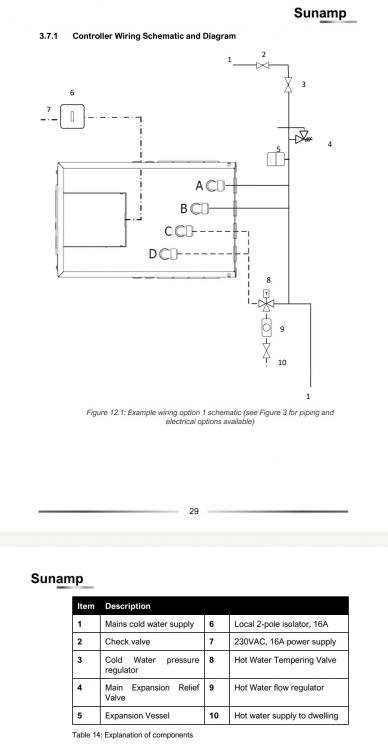

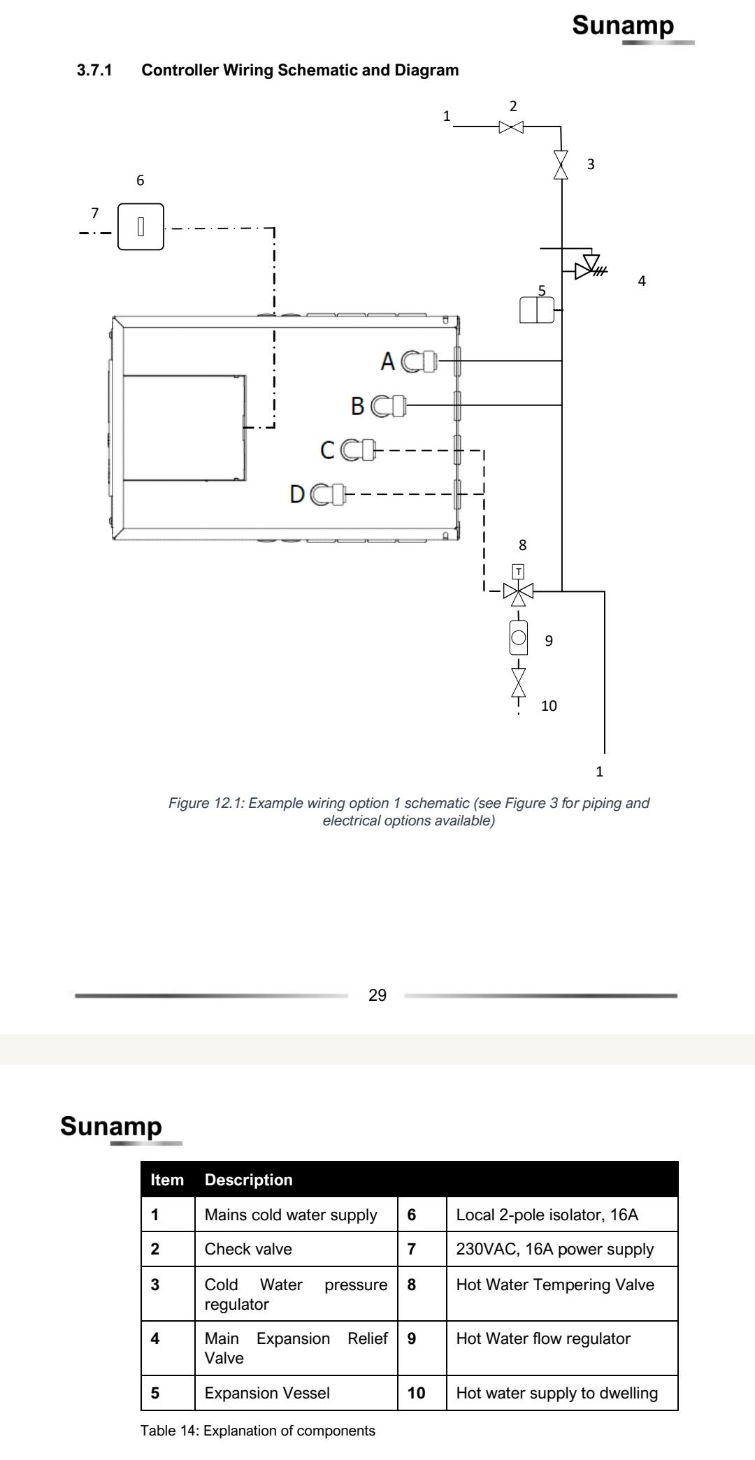

willbish Posted August 25, 2021 Share Posted August 25, 2021 Take a look at this schematic from the Sunamp installation manual (this is from a UniQ eHW12, so may be subtly different). No pump required PRV set to 3 bar Without a PV diverter, your Sunamp will start charging as soon as the timer switches on, regardless of whether the sun is shining or not. By the time the sun comes out you could be fully charged from the grid and your opportunity to self consume your PV generation is lost for that day. Most people say a PV diverter pays for itself relatively quickly. It's a must have really. 1 Link to comment Share on other sites More sharing options...

westcoast Posted August 25, 2021 Author Share Posted August 25, 2021 11 hours ago, willbish said: Take a look at this schematic from the Sunamp installation manual (this is from a UniQ eHW12, so may be subtly different). No pump required PRV set to 3 bar Thanks a lot for reply. So rising main directly into Sunamp is sufficient? ..but without power showers I'm guessing I would need to increase pressure after heating? Link to comment Share on other sites More sharing options...
PeterW Posted August 25, 2021 Share Posted August 25, 2021 31 minutes ago, westcoast said: Thanks a lot for reply. So rising main directly into Sunamp is sufficient? ..but without power showers I'm guessing I would need to increase pressure after heating? You can’t pump off a rising main anyway. And 3 Bar mains pressure is a lot ..! Link to comment Share on other sites More sharing options...
