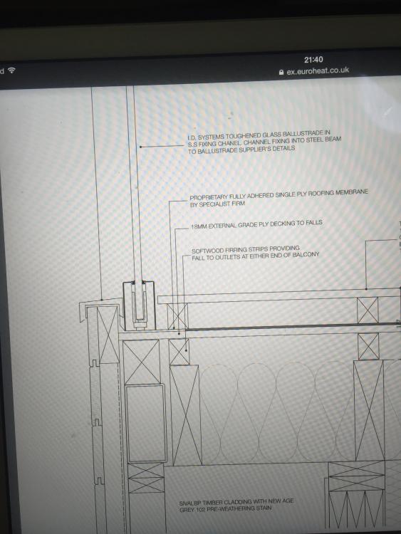

We will be having a glass balcony on the rear of our property - however it ultimately means that the epdm membrane must be bolted through in places to allow the balcony channel to be fixed to the steel beam below.
Assuming no one has an alternative way of doing this, can anyone recommend the best sealant to use to try and ensure this detail remains weathertight for as long as possible. Something that can withstand both sunlight and cold temperatures. The epdm will be raised at this point so rainwater should be kept to a minimum.
Picture to help explain although I will put a timber under where the railing is to raise it from being where rainwater would collect.
Can you bilid some stainless steel stools to bolt the balcony rail to with these penetrating the roof in a fail safe leak proof way, I would.
Could you sketch/show me a link to what your thinking?
The other potential possibility is to fix in from the side using a slightly different profile. The issue with this route is trying to clad over the channel so that it looks neat.

We had this dilemma with our balconies and a GRP roof. I wasn't confident that there would enough support to attach the glass from the side and did not want to penetrate the GRP.
Elite Ballustrades have come up with a neat solution, they build an aluminium deck frame on the balcony and attach at corner points to the wall. The balustrade hangs on the side of the deck, which is covered in plastic wood. Obviously increased cost but couldn't see any other way of doing it.
http://www.elitebalustrade.com/composite-decking/qwickbuild.html
I ll give them a call and see what they have for this - only issue is I don't have a lot of height

We've done something similar a few years ago to that sketch when fitting roof top safety lines albeit down to a concrete roof. Will try and get a drawing out of our archive.
