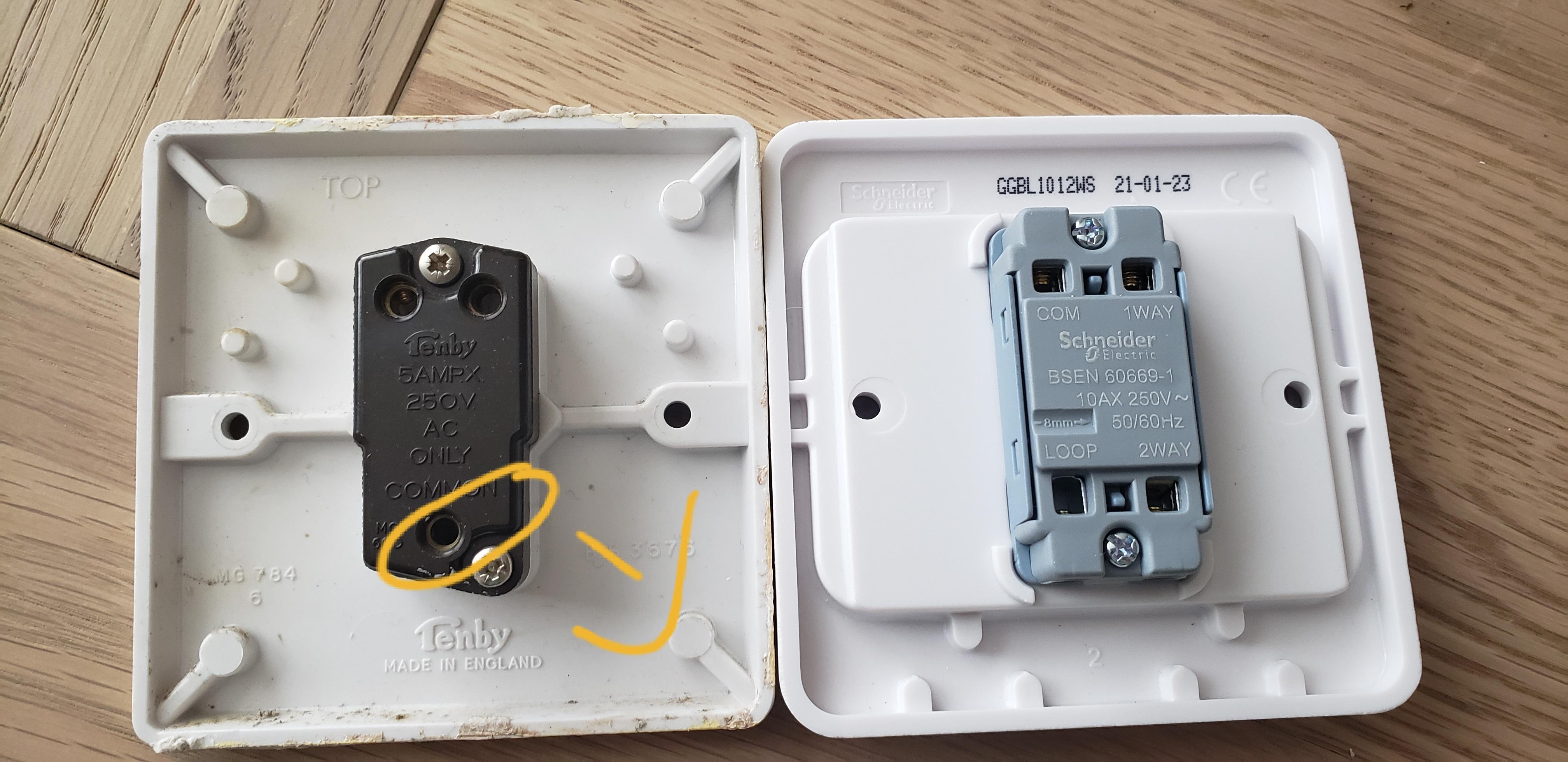

TryC Posted August 20, 2021 Posted August 20, 2021 Hi All, Was wondering if anyone could offer some help on what has happened when I changed my light switch cover. i changed one with no issues, but then when I went to change another one, it only works upstairs when I push the button but the one downstairs does not turn it on when I push the button. It is an upstairs landing light that has its own switch upstairs and a switch that turns it on and off from downstairs too. Below are some photos. The photo of the switches - the one on the left is the original one, and the one on the right is the new one, but I noted there are more holes in the one on the right (4 vs the 3). I have 5 wires in total 9 ( one red and blue went into the same hole and the other two red ones went into the same hole, then on the bottom, the yellow one wire went in there). I replicated this with the new switch, put the yellow one on the bottom on and it didn't work at first, but then I moved it to the other hole and it was OK, worked. The light switch on the landing worked. However, I realised when I was downstairs, wanting to switch off the light for upstairs, it would not work. The switch downstairs is a two button switch. I also noticed when I went back up to the landing to turn off the light, when i turned it off, then back on, the light actually flickered (or seemed to flicker, it went on, blinked like it went off then back on - not sure if the wires I put into the new switch cover is the reason for this). I was under the impression I wouldn't need to hire an electrician to change a simple thing like a light switch cover - but am I wrong? should I be getting an electrician in for this?? Any help/advice would be appreciated. Thanks.
Gone West Posted August 20, 2021 Posted August 20, 2021 8 minutes ago, TryC said: The photo of the switches - the one on the left is the original one, and the one on the right is the new one, but I noted there are more holes in the one on the right (4 vs the 3). Schneider switches have a connector where all the neutrals can be connected together, for loop-in at switch, which is labelled 'loop'.
TryC Posted August 20, 2021 Author Posted August 20, 2021 2 minutes ago, Gone West said: Schneider switches have a connector where all the neutrals can be connected together, for loop-in at switch, which is labelled 'loop'. thanks! may I know which wire is the neutral one?
dpmiller Posted August 20, 2021 Posted August 20, 2021 Ignore the loop terminal. The wires that were in the bottom of the old switch should be in the top left of the new (all from rear as per the photo). Common. The two terminals at the top of the old switch are the two on the Right of the new one. Put the wires in these, in the SAME combinations as before.
dpmiller Posted August 20, 2021 Posted August 20, 2021 "normal" British wiring has the loops and neutrals up at the ceiling rose so you don't need to consider that fourth terminal at all.
TryC Posted August 20, 2021 Author Posted August 20, 2021 1 minute ago, dpmiller said: "normal" British wiring has the loops and neutrals up at the ceiling rose so you don't need to consider that fourth terminal at all. thanks, the 4th terminal being 'loop' ?
TryC Posted August 20, 2021 Author Posted August 20, 2021 7 minutes ago, dpmiller said: Ignore the loop terminal. The wires that were in the bottom of the old switch should be in the top left of the new (all from rear as per the photo). Common. The two terminals at the top of the old switch are the two on the Right of the new one. Put the wires in these, in the SAME combinations as before. sorry, the abvoe is confusing me. Below shows where the original wires and combos went.
ProDave Posted August 20, 2021 Posted August 20, 2021 What is confusing you is the different layout of the terminals on the new switch. 2* reds from old switch top left go to new switch top right. Red and black from old switch top right to go new switch bottom right. Yellow from old switch bottom to go to new switch top left. In this case ignore new switch bottom left. 1

TryC Posted August 20, 2021 Author Posted August 20, 2021 40 minutes ago, ProDave said: What is confusing you is the different layout of the terminals on the new switch. 2* reds from old switch top left go to new switch top right. Red and black from old switch top right to go new switch bottom right. Yellow from old switch bottom to go to new switch top left. In this case ignore new switch bottom left. thanks very much, i appreciate iy
TryC Posted August 20, 2021 Author Posted August 20, 2021 41 minutes ago, ProDave said: What is confusing you is the different layout of the terminals on the new switch. 2* reds from old switch top left go to new switch top right. Red and black from old switch top right to go new switch bottom right. Yellow from old switch bottom to go to new switch top left. In this case ignore new switch bottom left. oops, i meant red & blue, is that still into the new switch bottom right please?
ProDave Posted August 20, 2021 Posted August 20, 2021 Regardless of colour, what was in old switch top left goes to new switch top right, old switch top right into new switch bottom right and old switch bottom into new switch top left.
TryC Posted August 20, 2021 Author Posted August 20, 2021 39 minutes ago, ProDave said: Regardless of colour, what was in old switch top left goes to new switch top right, old switch top right into new switch bottom right and old switch bottom into new switch top left. thank u
TryC Posted August 24, 2021 Author Posted August 24, 2021 On 20/08/2021 at 19:17, ProDave said: Regardless of colour, what was in old switch top left goes to new switch top right, old switch top right into new switch bottom right and old switch bottom into new switch top left. hi! I tried this and while the lights work and can now be switched off downstairs, when I switch it on upstairs, the light comes on, but then it blinks and laminates as normal. it never used to blink (before I started the quest in changing the cover). I also turned the switch upside down as one of the wires that needed to go to the bottom of the switch was much too short and every time I put it in place to screw back in, the wire would pop out, so hence i turned it upside down so the short wire could still go into the bottom switch but the bottom became the top - is this OK to do?

ProDave Posted August 24, 2021 Posted August 24, 2021 If the light momentarily blinks when you flick one of the switches, then you have messed up the order of the strappers between the 2 switches. Seriously, you could spend days, and hours of our time taking pictures and trying to figure out what you have done wrong, or you could pay a local electrician an hours labour and he will have it all sorted very quickly.
