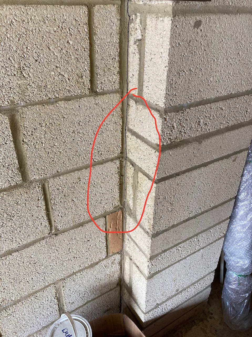

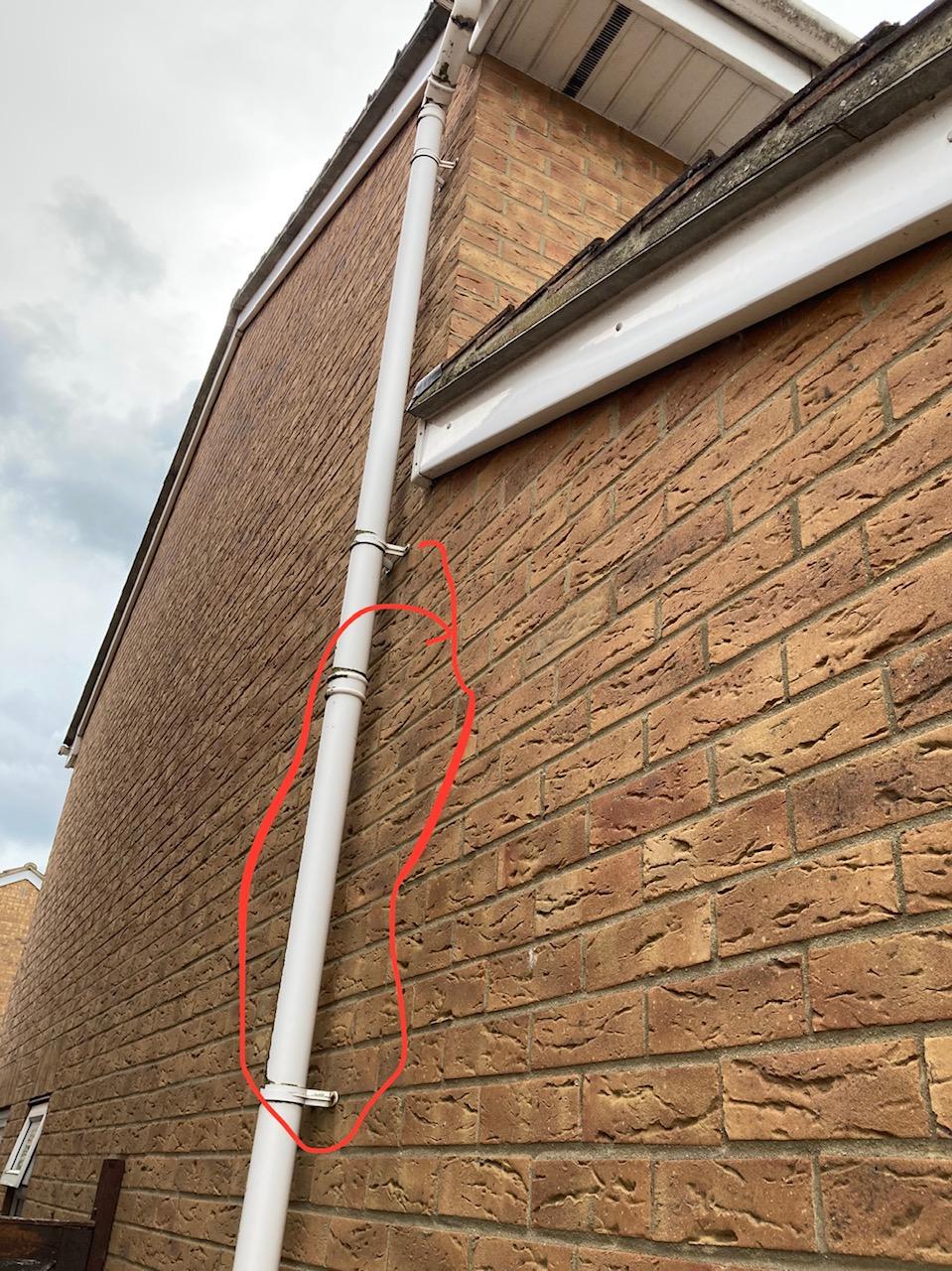

newby2 Posted August 10, 2021 Share Posted August 10, 2021 Hi all, I am glad that I've found this forum. My house is a detached built in the 90s with an integrated garage. I just found in the garage there is a long, vertical crack (from ceiling to the floor) in the pointing where the wall meets a column. It is circled in the photo. It's about 1mm or less in width in most places. It may be there for a long time. The other photo is from outside where I circled the approximate area, which looks fine. Is this something of concern or I am being paranoid? Many thanks for any advice. Link to comment Share on other sites More sharing options...
joe90 Posted August 10, 2021 Share Posted August 10, 2021 Concerned but not paranoid. Good to keep an eye on it but not the end of the world. Is the crack only in the pointing or are bricks broken? Link to comment Share on other sites More sharing options...
newby2 Posted August 10, 2021 Author Share Posted August 10, 2021 only in pointing, not in bricks. Link to comment Share on other sites More sharing options...
newby2 Posted August 10, 2021 Author Share Posted August 10, 2021 @joe90, thank you for your reply. Could it be due to something like thermal movement? Although I just found it, it could be there for a long time. We've lived in the house for 15 years. Link to comment Share on other sites More sharing options...
joe90 Posted August 10, 2021 Share Posted August 10, 2021 No one can be sure but differential settlement is not unheard of, I would just re point it and keep an eye on it, if it tends to move anymore or seasonally I would point it with non setting mastic so it can give a little. Link to comment Share on other sites More sharing options...
newby2 Posted August 10, 2021 Author Share Posted August 10, 2021 Thanks. I suppose it is not subsidence, right? It's not diagonal and less than 1mm wide. Link to comment Share on other sites More sharing options...
tonyshouse Posted August 10, 2021 Share Posted August 10, 2021 Best advice is to report it to insurers and say that you are monitoring it for two years - photos will do measuring better 1 Link to comment Share on other sites More sharing options...
Brickie Posted August 10, 2021 Share Posted August 10, 2021 Looks like that pier may not be bonded in with main wall-possibly built independently with cavity ties tying it in. I assume the pier carries a steel further up which becomes the outside wall above the garage? Link to comment Share on other sites More sharing options...
Dave Jones Posted August 11, 2021 Share Posted August 11, 2021 expamet should really be used on piers not wall ties, costs peanuts as well. Link to comment Share on other sites More sharing options...
Brickie Posted August 11, 2021 Share Posted August 11, 2021 5 hours ago, Dave Jones said: expamet should really be used on piers not wall ties, costs peanuts as well. I’d prefer to see it bonded in,though it does look an odd size (170mm projection maybe) which may have given them a head wobble & led to it being built independently. Link to comment Share on other sites More sharing options...

newby2 Posted August 12, 2021 Author Share Posted August 12, 2021 thanks to all for your replies. @Brickie, if the pointing cracked due to the reason you mentioned, shall I just leave it and keep on eye on it? 1 Link to comment Share on other sites More sharing options...
Brickie Posted August 13, 2021 Share Posted August 13, 2021 I’d consider @tonyshouse advice re notifying insurers to be safe-bear in mind we’re all commenting from a couple of photos. Is the crack also on the other side of the pier? Have you spoken to neighbours to see if they have the same issue? Link to comment Share on other sites More sharing options...
Oz07 Posted August 13, 2021 Share Posted August 13, 2021 Id probably monitor for now without informing insurers but thats just my internet strangers opinion. You could open a can of worms telling the insurers. It looks a pretty typical place a small crack would develop although i'm no expert. Vertical crack = horizontal movement. Position is near to a pier and where single storey meets double gable. If being built on a new build site nowadays I wouldn't be surprised to see a movement joint there. My last (60's, cavity) place had 2 vertical cracks under a window on seperate elevations. I got them surveyed before purchase and thermal expansion was the result. I repointed one and chopped out and replaced some bricks in the other. New place I put a movement joint in on a slightly less than 12m wall. You didn't have to by the book but a siliconed expansion join looks a lot better than a random crack. Link to comment Share on other sites More sharing options...
