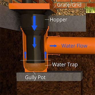

Temp Posted August 9, 2021 Posted August 9, 2021 +1 Unless they specified a particular Inspection chamber you might be able to combine the two into one unit. May also depend on the depth of the red pipe. Google Bottle Trap Gully.. https://www.jdpipes.co.uk/knowledge/underground-sewer/what-are-gullies-and-where-do-you-need-them.html Bottle Trap Gully The bottle trap gully works in much the same way as the P trap, but the change in design solves the rodding problem. Unlike the P trap, the bottle gully doesn’t require the tight bend in the pipe to trap the water. Instead, it uses a removable inner sleeve (or central chamber) that creates a space between itself and the wall of the gully that the water is forced up to reach the outlet pipe. This design still traps the water to use as a barrier against smells and gases, but it does so with a removable sleeve that makes cleaning out silt and debris by hand much easier and also provides direct access to the outlet for a drain rod in case of a blockage in the drain - though this can depend on how deep the gully has to be installed to and whether it requires the addition of a hopper and riser to reach the surface. 1
