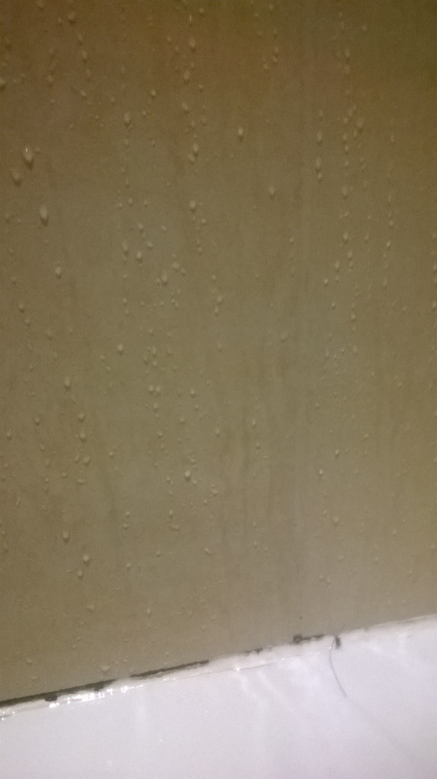

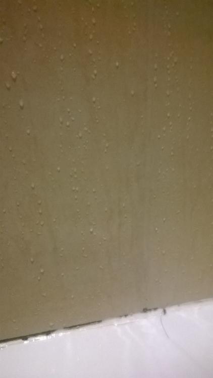

bassanclan Posted March 25, 2017 Share Posted March 25, 2017 it is a bit difficult to see in this photo as the grout I so well matched to the tiles, but its Mapei Kerapoxy, about 7 yrs old. You can see the Dow Corning sealant I mouldy (should have used ct1) but the grout is smooth, mould and mildew free and non porus Link to comment Share on other sites More sharing options...

ProDave Posted March 25, 2017 Share Posted March 25, 2017 A dose of bleach will have that sealant clean and shiny in no time. Forget all your "bathroom cleaning" products,. neat bleach works wonders. I paint it on with a paint brush. leave for a while then rinse off. 1 Link to comment Share on other sites More sharing options...
