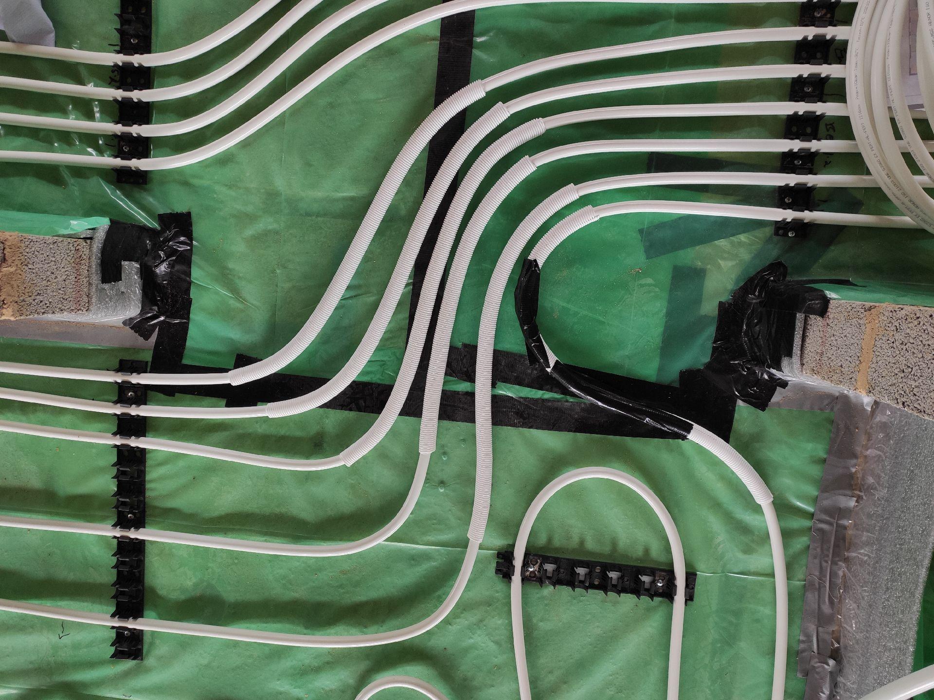

MortarThePoint Posted August 6, 2021 Posted August 6, 2021 I'm going for Cemfloor Therm and the installer said he puts pieces of plywood in the doorways to encourage localised crack. I had already started installing 'pipe expansion sleeves' aka 25mm flexible conduit in the doorways and he said not to bother. Magnus Magnuson, I did it in all doorways. You can see an example below, a bit difficult as it's white. I put them on the pipe as laid, so unless I forgot and added later, they don't have skits along their length making removal difficult. Is this a mistake, should I remove them all? Screed is going in at 50mm nominal and needs 25mm over pipes which it would achieve over these unless the float up slightly.

Nickfromwales Posted August 7, 2021 Posted August 7, 2021 Ok, firstly if it’s a liquid screed, both ends of any sleeve would need to be sealed to stop them simply filling up entirely. Your pics show open ended sleeves, both ends, so these will fill with screed and do the square root of FA. If you have rooms very far from the manifold, it helps to insulate the flow pipe so as to preserve the premium temp water so it arrives at the zone it serves at as close to the TMV ‘injection temperature’ as possible. I see a lot of poor performing installs where the furthest zones really drag behind the others, some don’t get up to temp at all as all the heat has ‘gone’ by the time it arrives at its target area. I always shutter around the UFH pipes where they congregate at the manifold location, which allows for the pipes to be dressed in and bent / straightened to line up with the manifold nicely. Where necessary I also insulate the first 1-2m or more of each flow pipes that is serving a zone that is not local to the manifold. House / installation size / slab vs screed etc are all factors I consider when determining whether this is required tbh. 9mm wall insulation is sufficient, but again needs to be sealed and ‘waterproof’ so the liquid screed doesn’t get inside. As far as just using a sleeve, it is a good idea in terms of protecting the pipe where it may be damaged where it’s above floor level, but your proposals for expansion via use of bits of sleeve ‘here and there’ is of zero practical use afaic. Take the advice of the guys laying the screed, as this advice differs with different types / thickness / etc and each job needs to be advised on its own merits. 1
Russell griffiths Posted August 7, 2021 Posted August 7, 2021 As above, fat bloke knows what he’s talking about. 1
MortarThePoint Posted August 7, 2021 Author Posted August 7, 2021 Thanks Nick. It's always difficult to know what's important good practice and what's good practice according to people who sit in an office and write documents. There are various sources that say to use expansion sleeves (e.g. LABC, Underfloor Heating Trade Supplies) but on site practice is a more useful guide in many cases. The main downsides of having them are the installation faff and the increased depth of screed to cover a thicker item. I sent the image to the installer and he said fine as long as has the minimum cover. I've decided I'll leave them in as they are where the screed needs to be thicker due to hollowcore camber anyway. There is one place where this isn't true, and I'll remove them from there. 21 minutes ago, Nickfromwales said: Your pics show open ended sleeves, both ends, so these will fill with screed and do the square root of FA. I was assuming the screed would be too porridge like to flow in. Pure water would, but will the screed really flow into a 300mm long 3mm wide channel? 26 minutes ago, Nickfromwales said: If you have rooms very far from the manifold, it helps to insulate the flow pipe so as to preserve the premium temp water so it arrives at the zone it serves at as close to the TMV ‘injection temperature’ as possible. I've no zones which are particularly far from the manifold. The furthest is probably about 4m upstairs so hopefully that will be fine.
Nickfromwales Posted August 7, 2021 Posted August 7, 2021 3 hours ago, MortarThePoint said: I was assuming the screed would be too porridge like to flow in. Pure water would, but will the screed really flow into a 300mm long 3mm wide channel? Nope. It’ll get in those just fine. ? 3 hours ago, MortarThePoint said: about 4m upstairs Do you have a loop above the manifold?

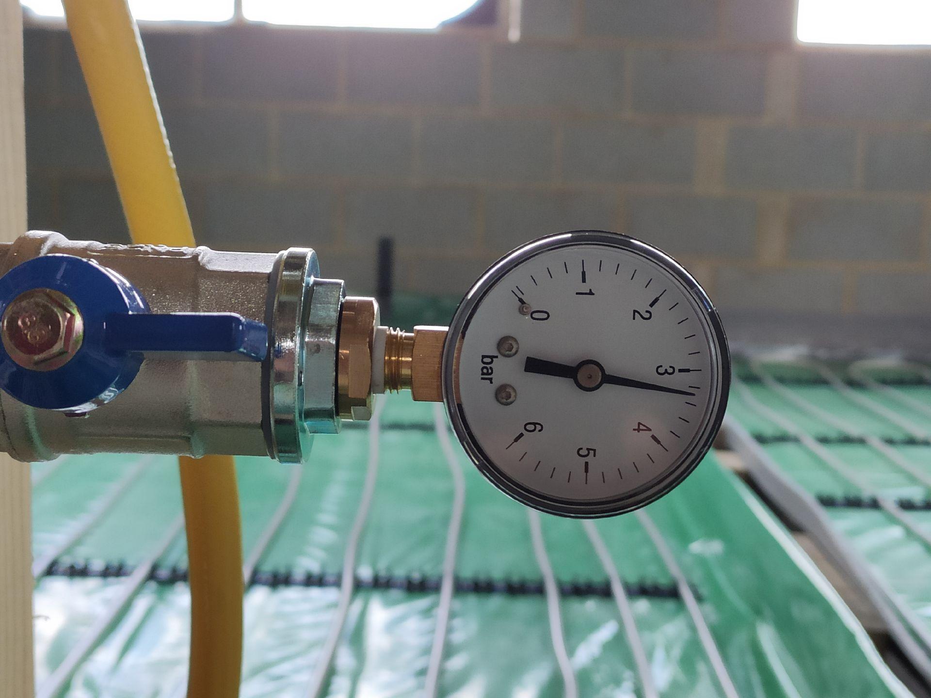

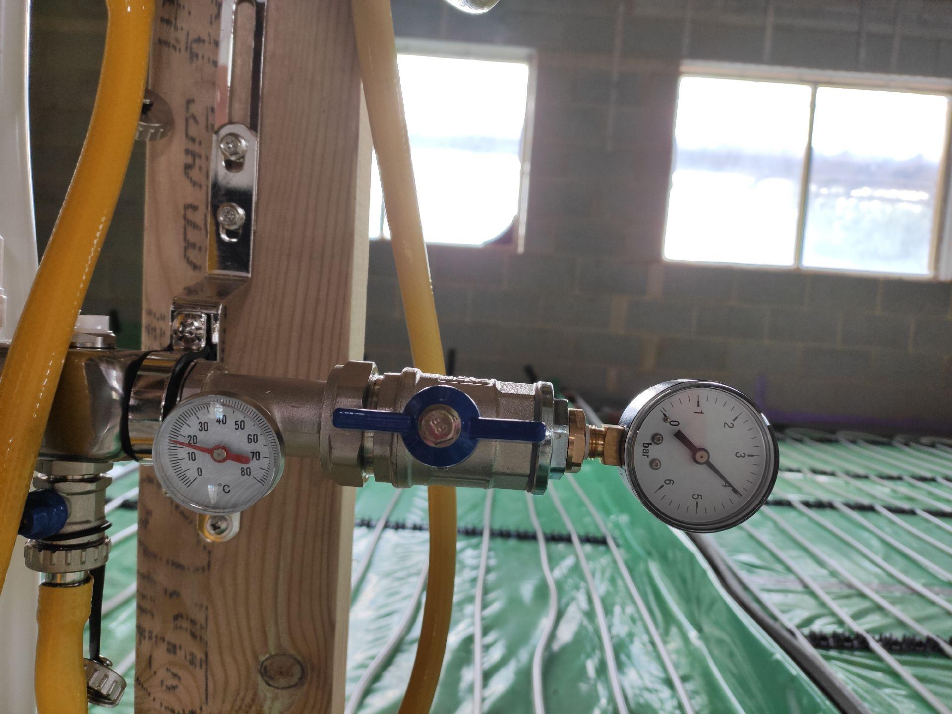

MortarThePoint Posted August 7, 2021 Author Posted August 7, 2021 Just started my pressure test. Fingers crossed! I'm off to drill some holes near the UFH pipes now
MortarThePoint Posted August 7, 2021 Author Posted August 7, 2021 Two holes drilled, one exciting moment Pressure holding so far Beer chilling ? 1
markc Posted August 7, 2021 Posted August 7, 2021 3 minutes ago, MortarThePoint said: Two holes drilled, one exciting moment Pressure holding so far Beer chilling ? You playing Russian roulette?
MortarThePoint Posted August 7, 2021 Author Posted August 7, 2021 14 minutes ago, markc said: You playing Russian roulette? Feels like it sometimes ? Pressure still holding after 1 hour. Cold beer opened. It's been a long week (>80 hours) PS: don't ask why that loop looks so drunk. I had to cram in an extra pass at the edge of the room. 1
Russell griffiths Posted August 7, 2021 Posted August 7, 2021 Remember to drop the pressure when the screed is in, the heat from the curing process increases the pressure. Mine hit 12 bar before I spotted it. ??♂️? 1

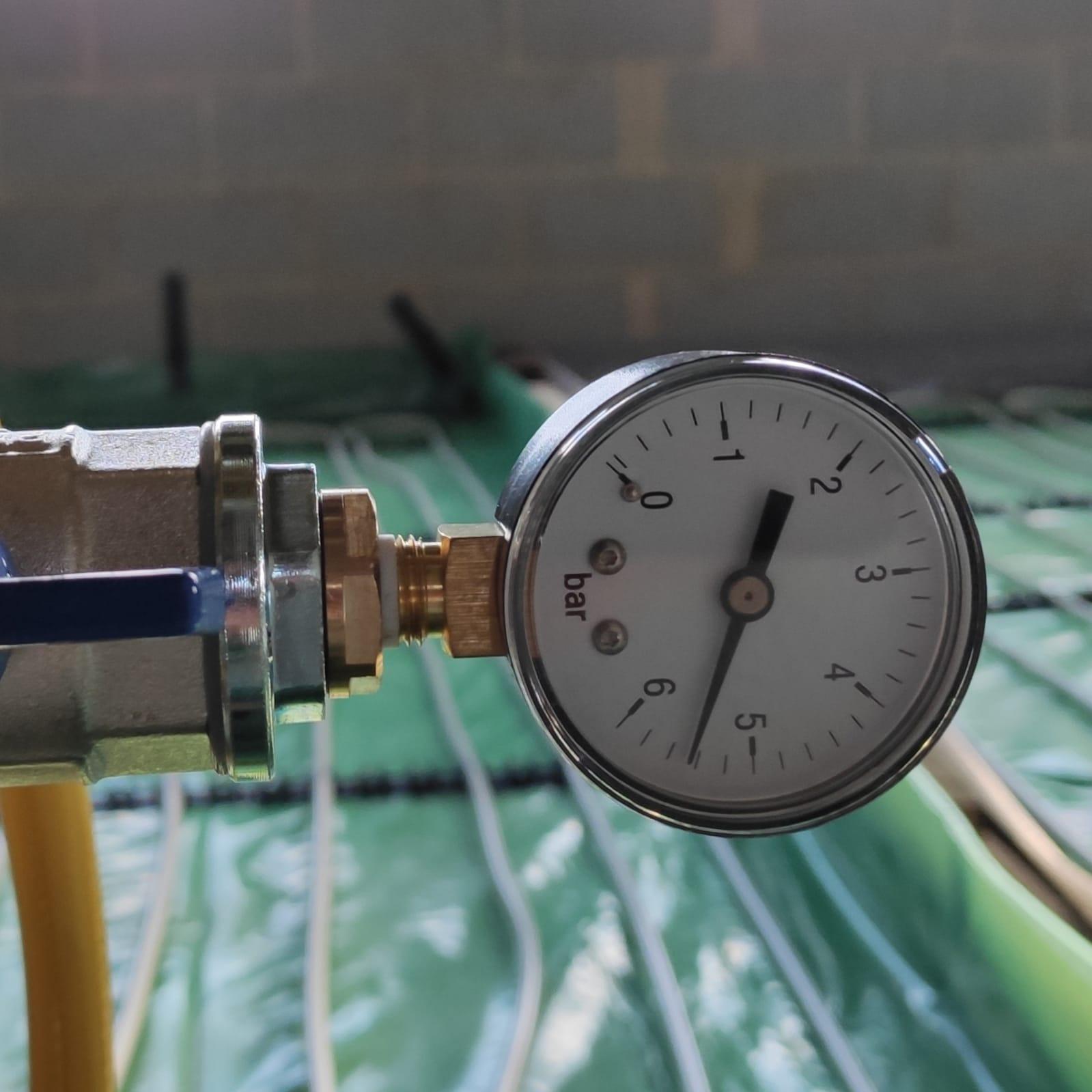

MortarThePoint Posted August 8, 2021 Author Posted August 8, 2021 This is a concern. Pressure vs time 0 5.2bar 1hour 5.4bar 2hours 5.2bar 3hours 5.0bar 14hours 3.3bar That feels like too much pressure drop for it to be 'stabilisation'. I've run my fingers over all the manifold connections and they are dry. I guess my next step is repressurise and to start closing loops. Does anyone know if the flow and actuator valves are pressure tight? If not that approach won't work. I haven't used any PTFE tape anywhere.
MortarThePoint Posted August 8, 2021 Author Posted August 8, 2021 A little bit I guess. I didn't read it, I should check. Maybe 5C lower temperature.
dpmiller Posted August 8, 2021 Posted August 8, 2021 that would likely do it. See if it comes back up a bit today...
Russell griffiths Posted August 8, 2021 Posted August 8, 2021 If you have a leak that needle will drop like a stone, it will literally flop straight around to zero. To give yourself a reality check, crack a valve open the tiniest bit, you will see an instant drop. 1
MortarThePoint Posted August 8, 2021 Author Posted August 8, 2021 1 hour ago, Russell griffiths said: If you have a leak that needle will drop like a stone, it will literally flop straight around to zero. To give yourself a reality check, crack a valve open the tiniest bit, you will see an instant drop. Thanks. It's holding steady at around 3.3bar so I'm going to give it a few hours before I do anything.
Nickfromwales Posted August 8, 2021 Posted August 8, 2021 It’s 100% sound. Chill out. The pressure fluctuations are just relative to changes in ambient temp. Go drink more beer. ?
MortarThePoint Posted August 8, 2021 Author Posted August 8, 2021 2 hours ago, Nickfromwales said: It’s 100% sound. Chill out. The pressure fluctuations are just relative to changes in ambient temp. Go drink more beer. ? Looks promising as the pressure has ticked up a bit to 4.0bar. Another beer chilling in the fridge.
