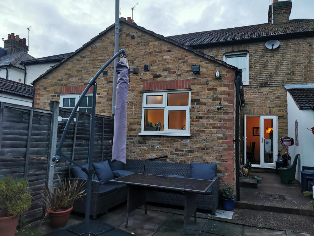

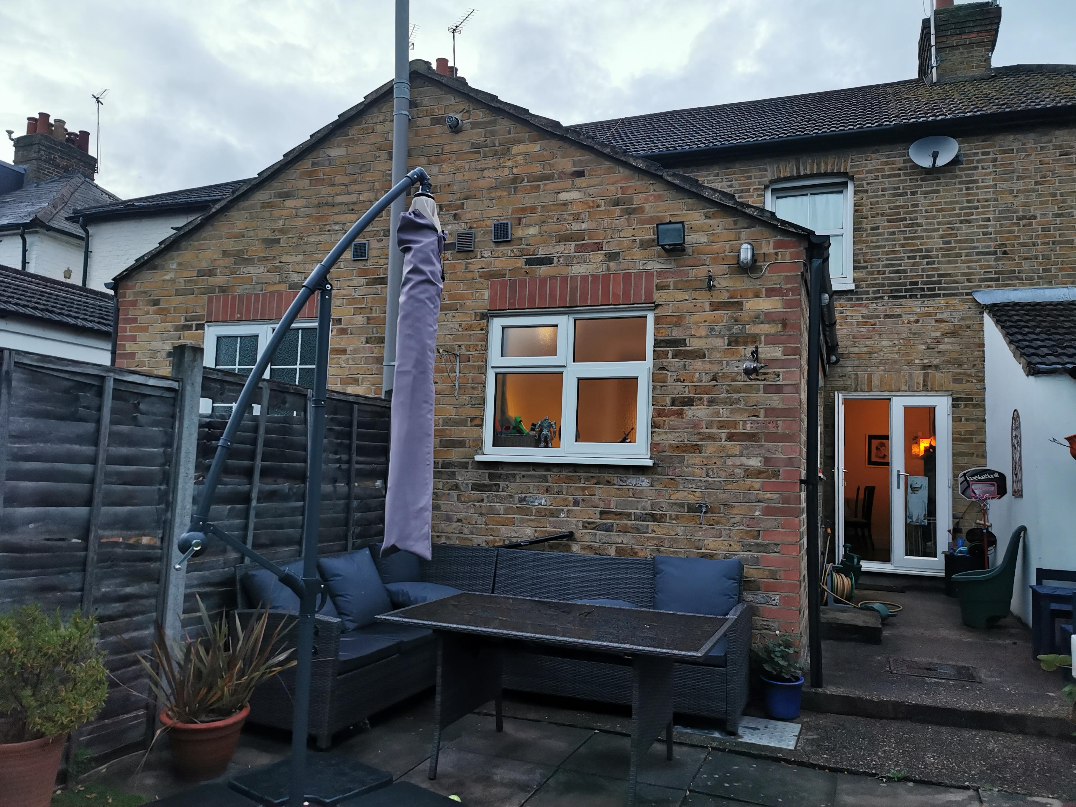

CGLean77 Posted August 5, 2021 Posted August 5, 2021 New extension when we already share one with neighbour Hi, we are interested in building a bigger extension on our terraced house. But we already share a small pitched roof extension with our neighbour which contains mirroring kitchen and bathroom, we think it dates back to 90s. Ideally we'd open out a lot more with a bigger open plan kitchen and family room extension. We certainly have the space but can't see how it could be done without demolishing our half of the existing structure. Can this be done, and would we still have to build out our new extension from neighbour in order not to leave them with half a structure? Thanks Chris

Gone West Posted August 6, 2021 Posted August 6, 2021 We had a semi with the same layout as you back in the 90s but without your small white extension. When we sold it the new owners build a single storey extension with a ridged roof across the whole of the remaining width of the back of the house and joined it to the existing extension with a valley gutter.
CGLean77 Posted August 6, 2021 Author Posted August 6, 2021 Thanks - we're aware it would be very difficult so it's feeling like probably moving is better option, but just wanted to get views on how feasible it might be!
Mr Punter Posted August 6, 2021 Posted August 6, 2021 I think @Gone West has a decent idea. Demolish the lean-to and build another extension the same depth as the shared one with a valley to link the roof.
CGLean77 Posted August 6, 2021 Author Posted August 6, 2021 Unfortunately the white lean-to isn't ours, that's the boundary with our other neighbour, so we only have the alley space to play with.

Gone West Posted August 8, 2021 Posted August 8, 2021 On 06/08/2021 at 13:37, CGLean77 said: Unfortunately the white lean-to isn't ours, that's the boundary with our other neighbour, so we only have the alley space to play with. What used to be over your French doors, there is a colour change in the brickwork for about a metre above the doors.
Ferdinand Posted August 8, 2021 Posted August 8, 2021 12 minutes ago, Gone West said: What used to be over your French doors, there is a colour change in the brickwork for about a metre above the doors. I would say their version of the one on the right was removed to build the one on the left ???. 1
Dave Jones Posted August 8, 2021 Posted August 8, 2021 it wouldnt be too difficult. drop your side and maintain the ridge to keep next door watertight while you rebuild your side. Looks harder than it would be.
