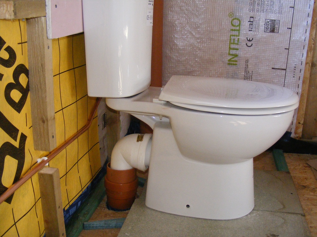

This is what Nick is trying to describe
If the wall was boarded with plasterboard, then the soil pipe will just be touching the wall. Likewise the cistern screws directly through the plasterboard into a dwang fitted there to catch the screws.
A simple cheap bent pan connector fits perfectly.  Same will apply to Barney's horizontal run waste pipe.

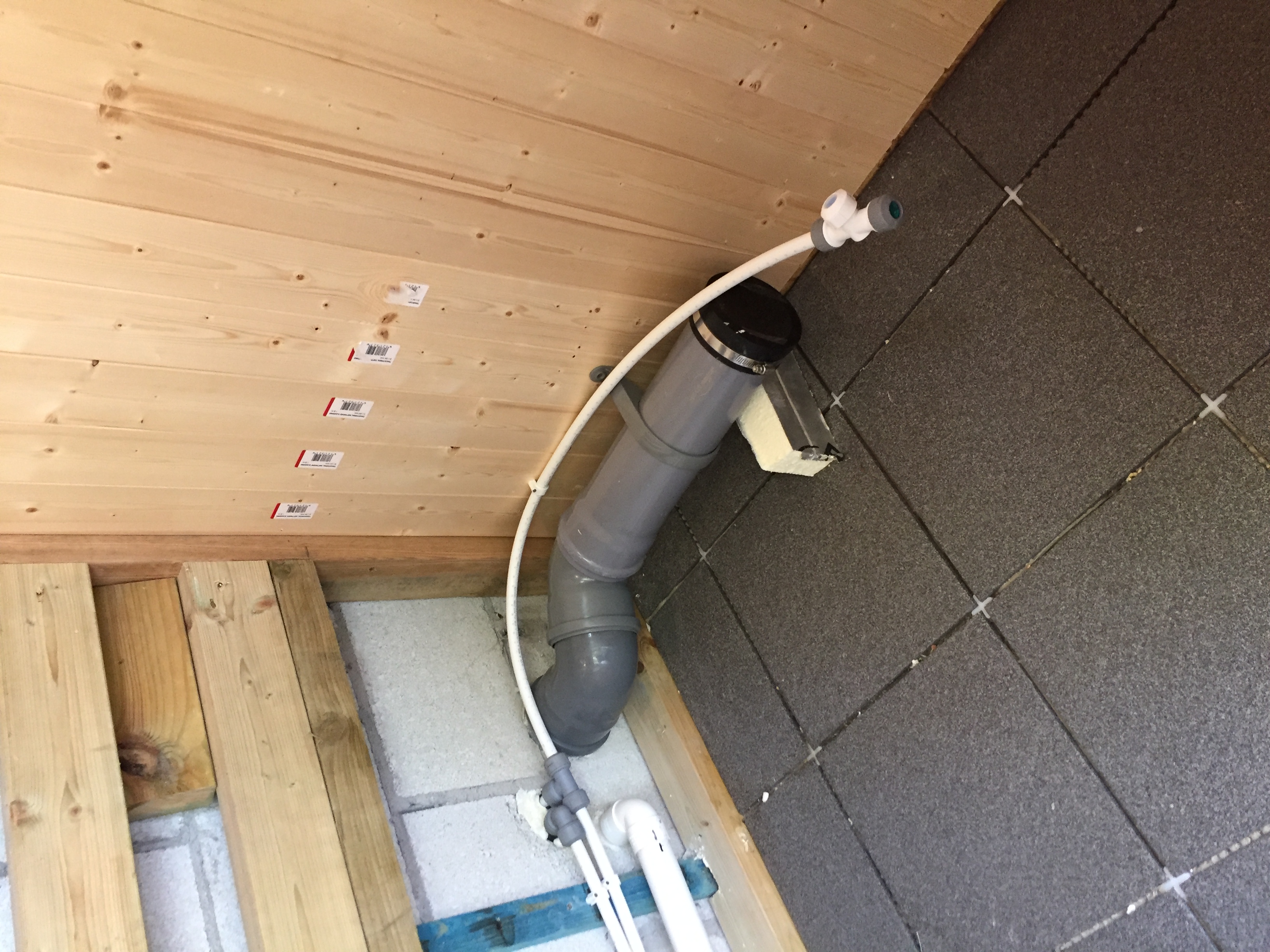

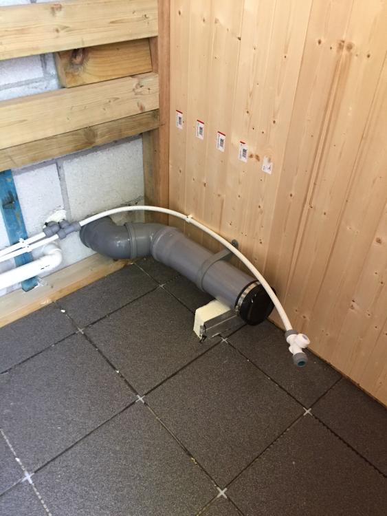

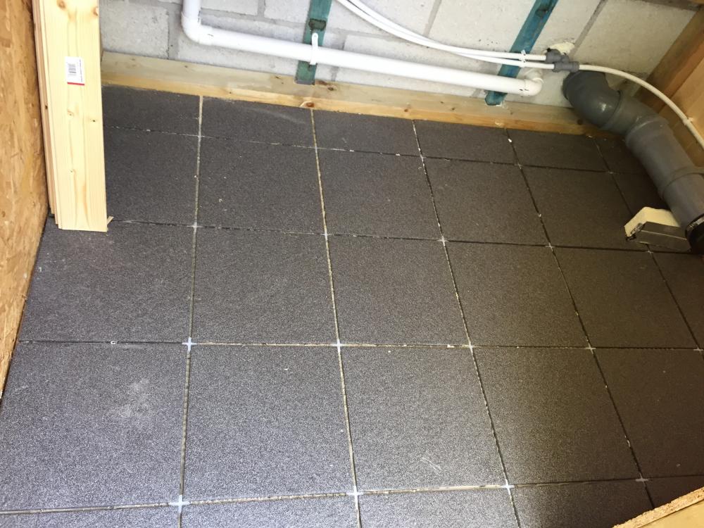

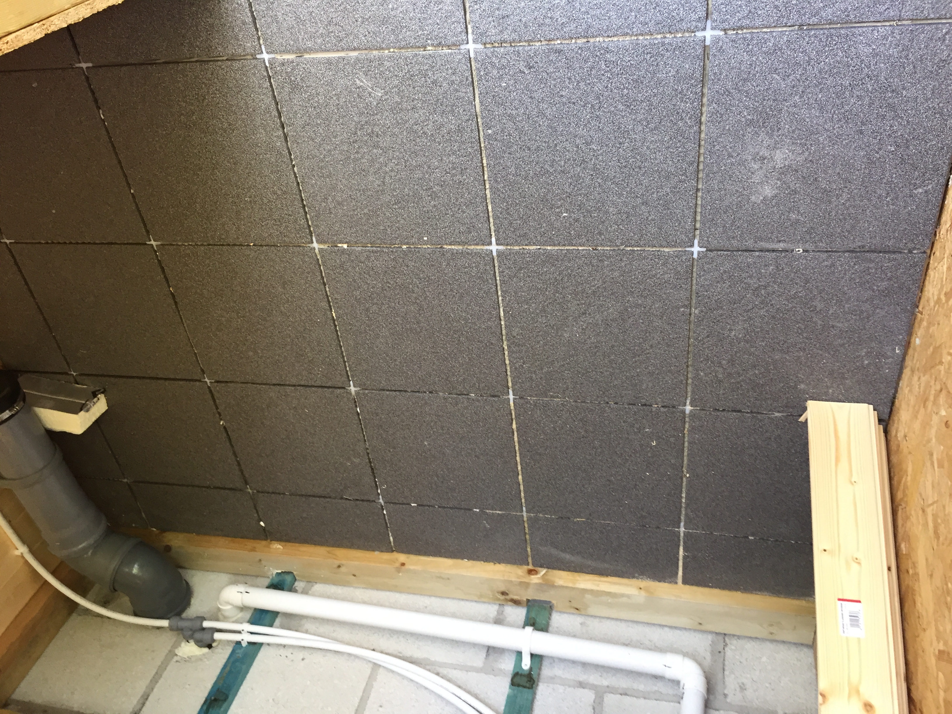

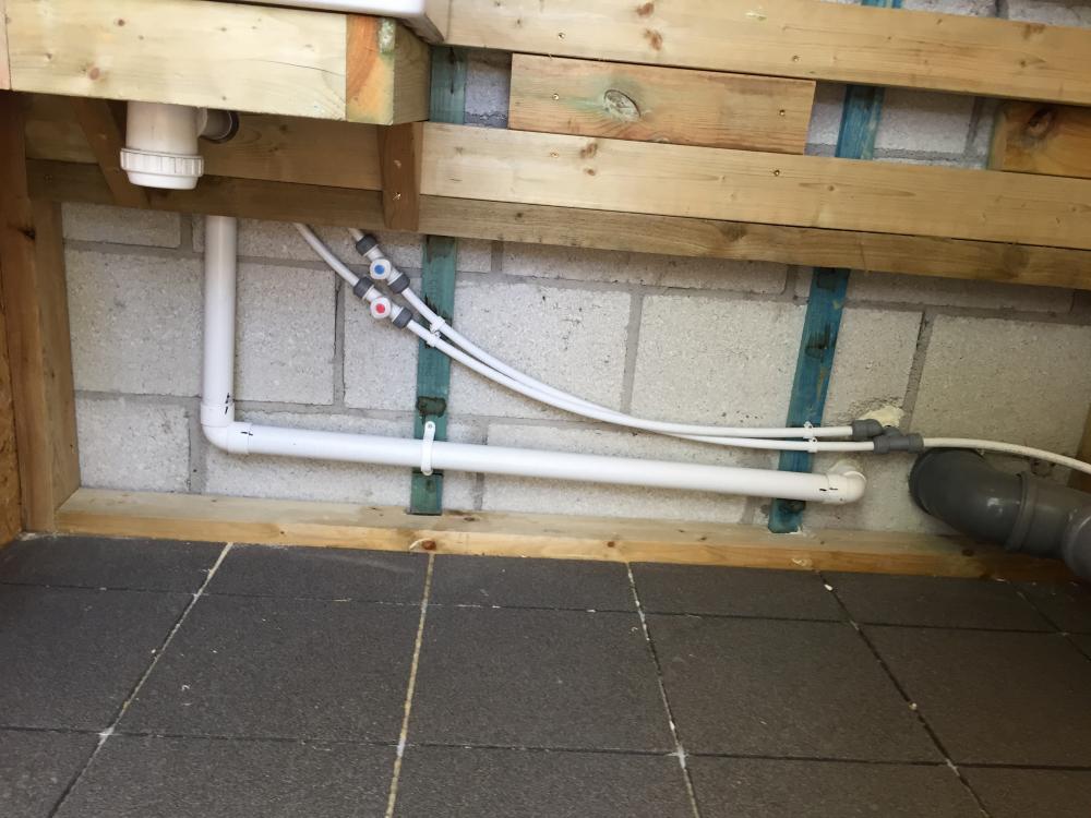

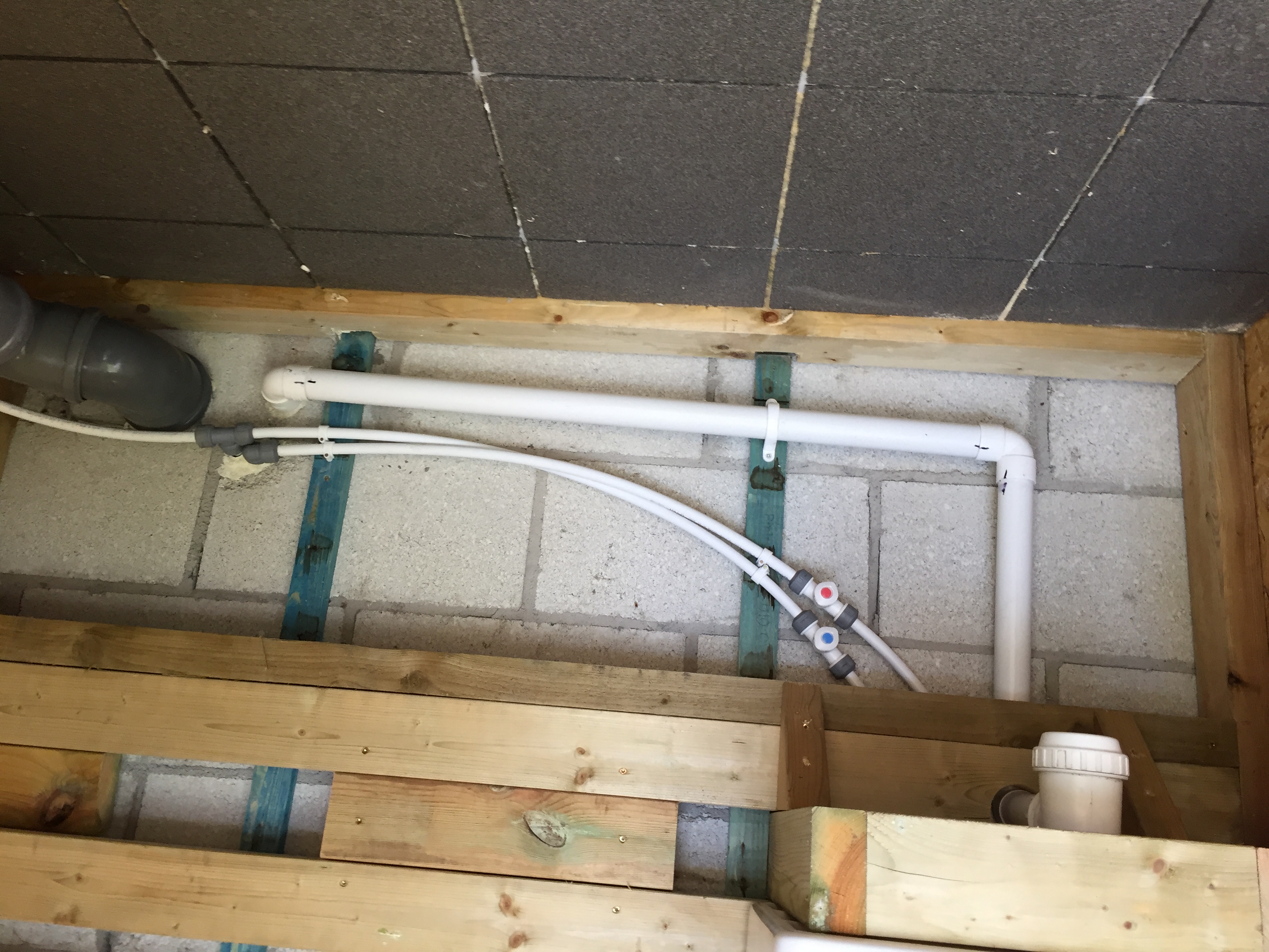

More progress on the outside toilet front. First fix plumbing finished and tiles laid.
The two 30 degree bends as suggested by our plumbing legend @Nickfromwales worked a treat. 20170417_155239341_iOS.thumb.jpg.7d745a7f690b01fea4b054e6eafc942b.jpg20170417_155247153_iOS.thumb.jpg.bc388981f284d978d4c83d58334fa335.jpg20170417_155304766_iOS.thumb.jpg.91eb219d867657fff1bbbef361938f54.jpg

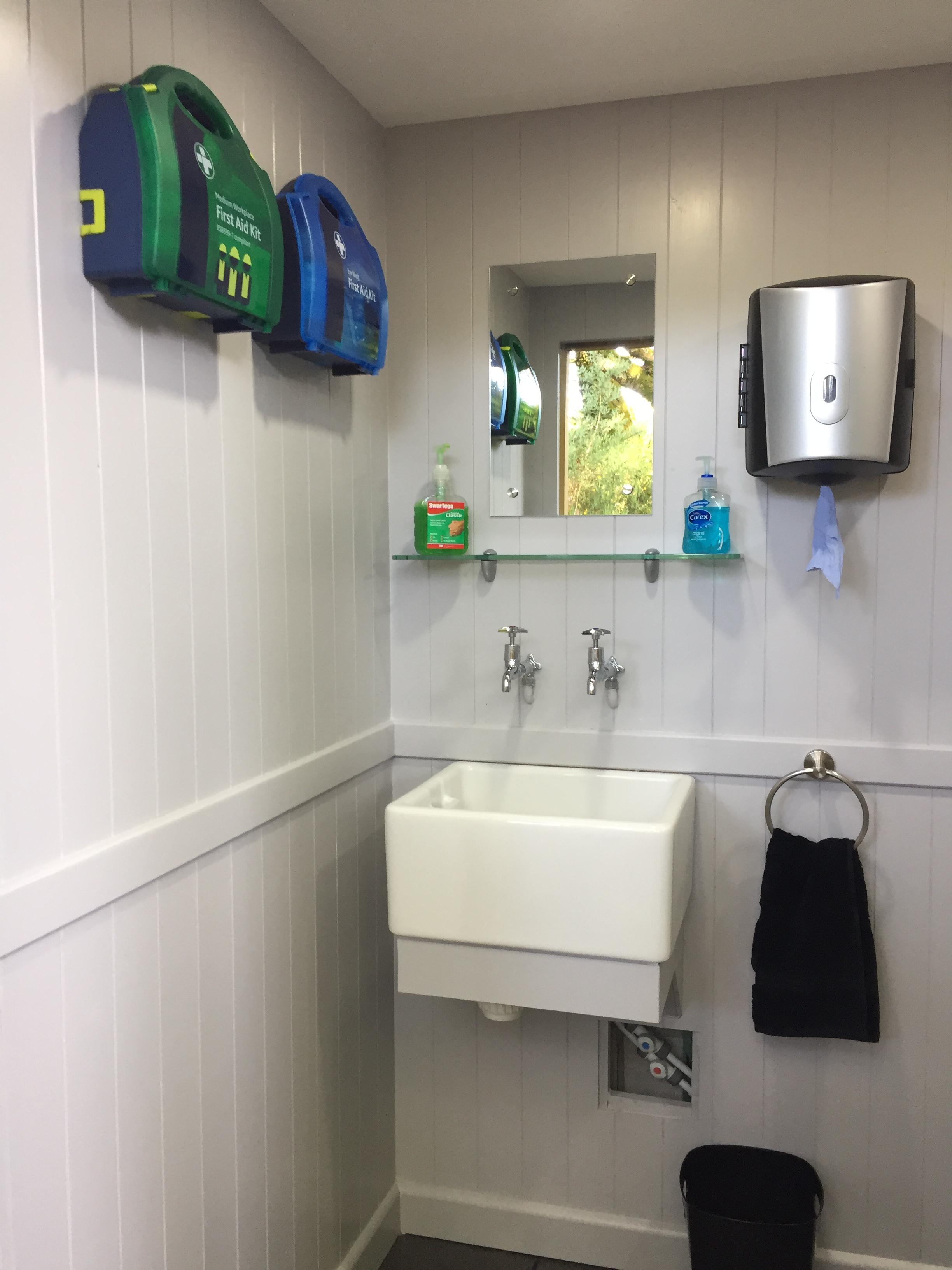

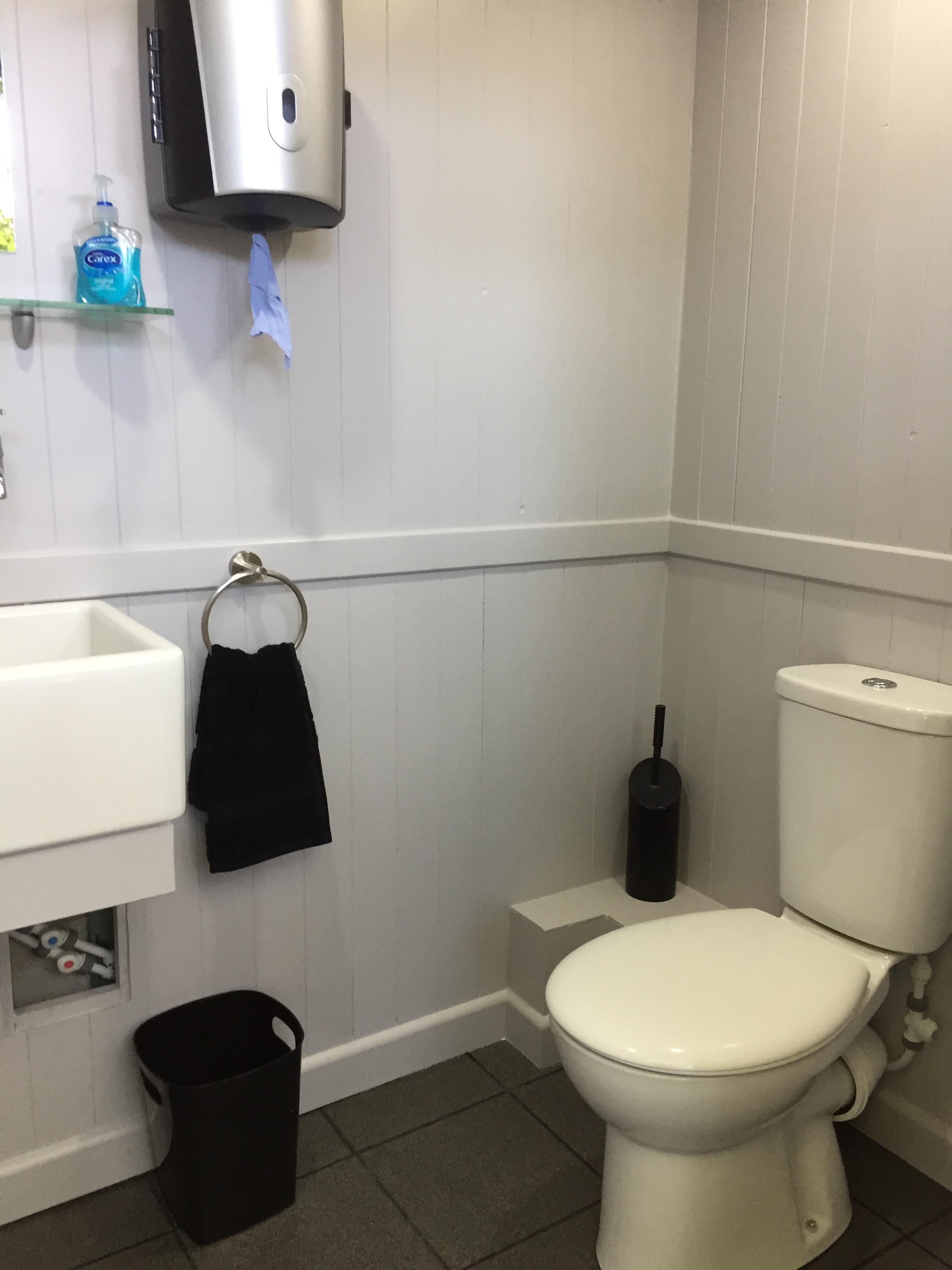

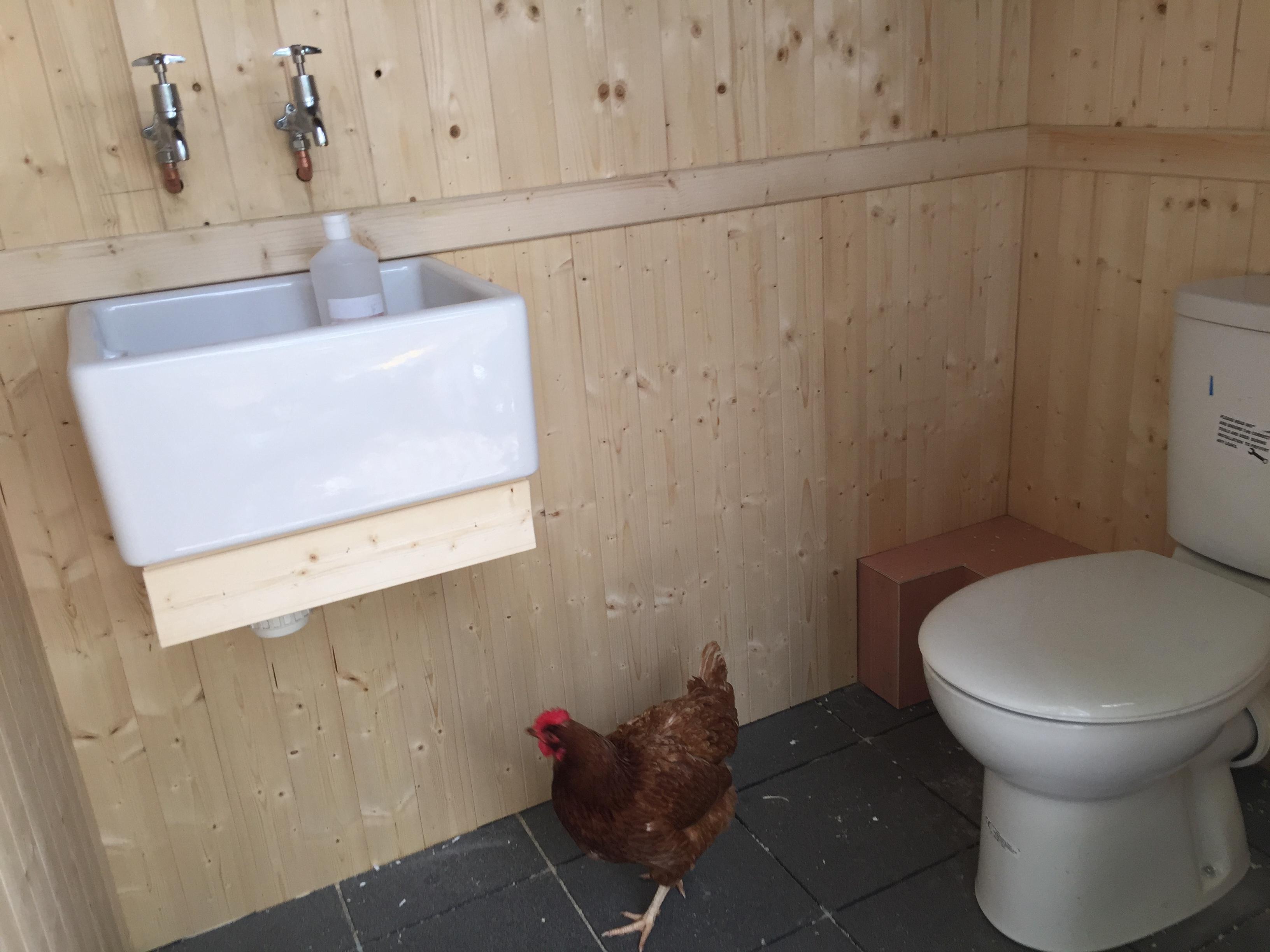

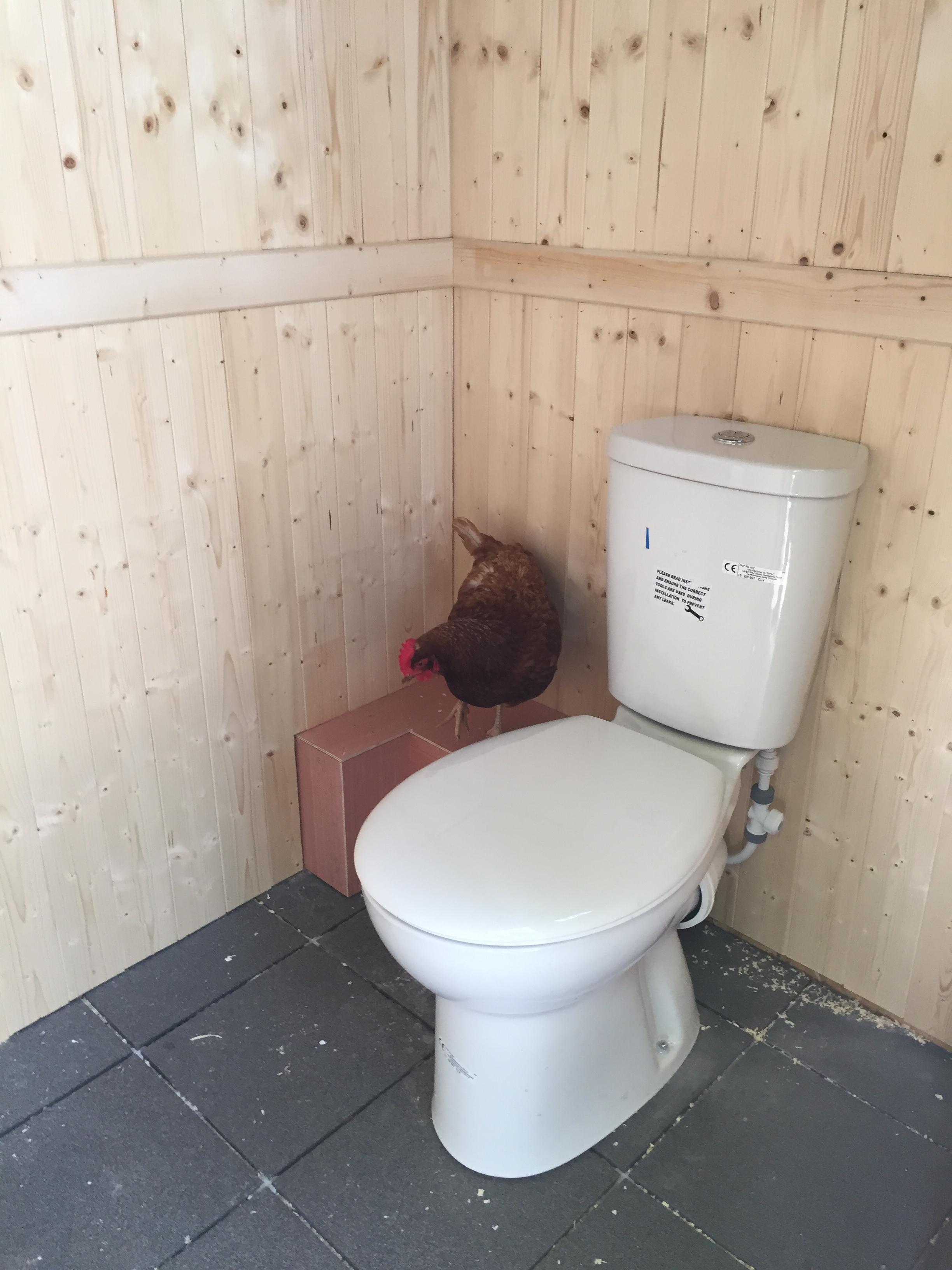

Sent the wife of to BM Bargains for a few bits to dress the outside toilet. Couldn't believe it when she said she had spent nearly TEN pounds!!! Frivolous!!! :)
The centre feed roll dispenser was shamelessly stolen from work.
Eye wash station and first aid kit are of course obligatory.
Just need to make a small door to hide the isolation valves for the taps and my work here is done :D

26 minutes ago, PeterW said:
Good choice of towel colour ..!!!
LOL. Yes, the wife was certain of the colour choice :)
