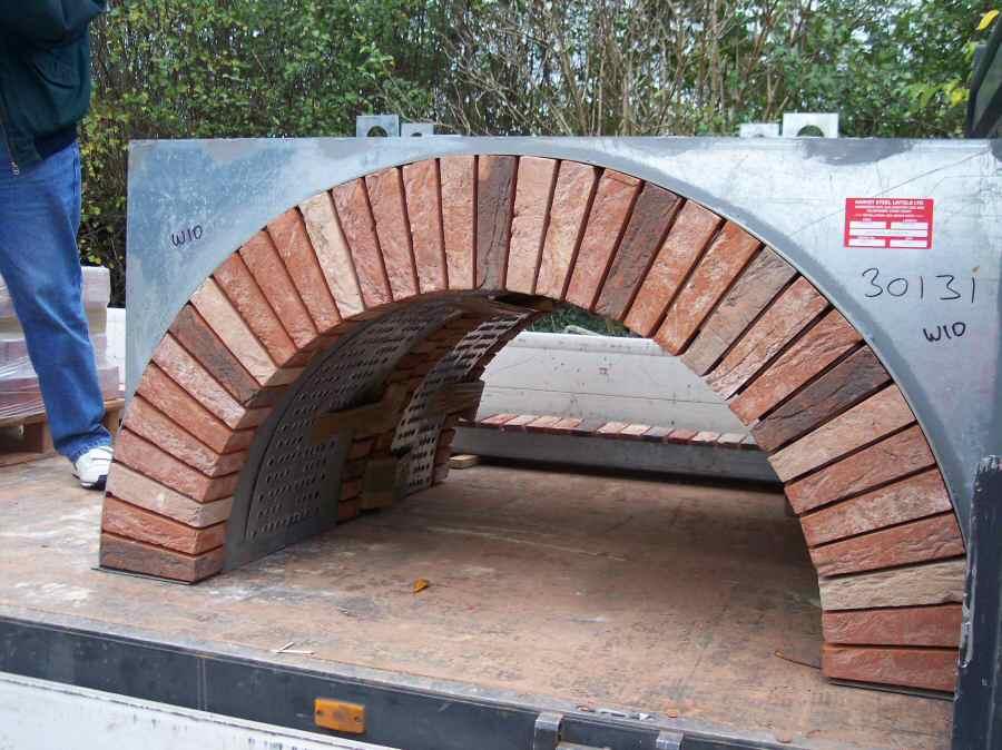

Dan1983 Posted July 30, 2021 Posted July 30, 2021 Morning guys, Looking for advice on arch formers if possible. We were originally going to use standard plastic arch formers for our ground floor windows but after choosing clotted cream windows the only way to colour match would be spraying/ painting the plastic formers which I didn’t like the idea of. I then found a picture of a house with full brick formers which looked great so trying to replicate it. Issue we have is getting the arches uniform as there is no former to work from. Has anyone had this issue? Only work around I ca think of is the decent width timber templates mate that can be removed after the arch is formed then infill the lower bricks after? This is the looks we are trying to achieve check my resolution

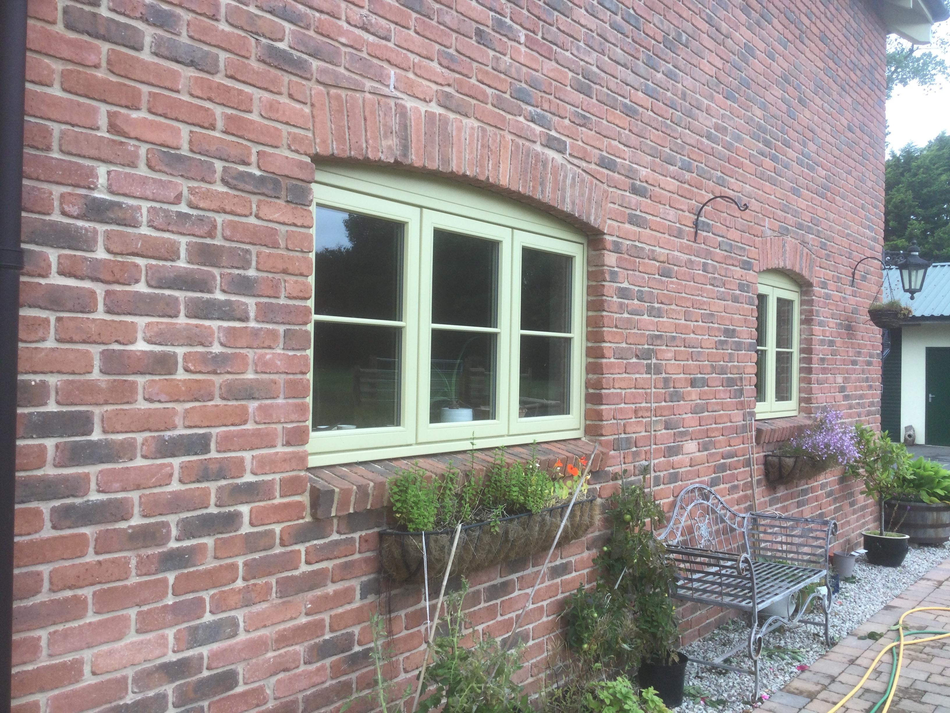

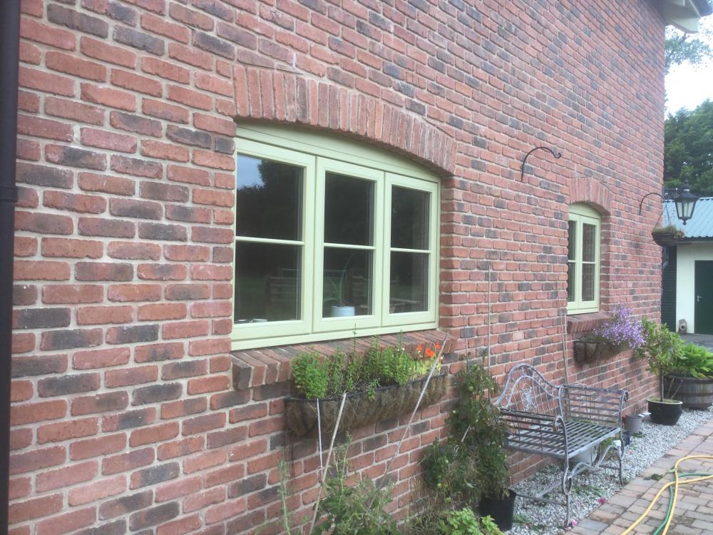

joe90 Posted July 30, 2021 Posted July 30, 2021 My bricklayer made his own former out of wood which was removed afterwards, but we didn’t infill with brick below it, just got the windows added too like below.

Mr Punter Posted July 30, 2021 Posted July 30, 2021 18 minutes ago, joe90 said: My bricklayer made his own former out of wood which was removed afterwards, but we didn’t infill with brick below it, just got the windows added too like below. I really like the recessed look. Did you make the inner leaf opening bigger to get the window to fit behind the brickwork? Did you use a cavity closer?

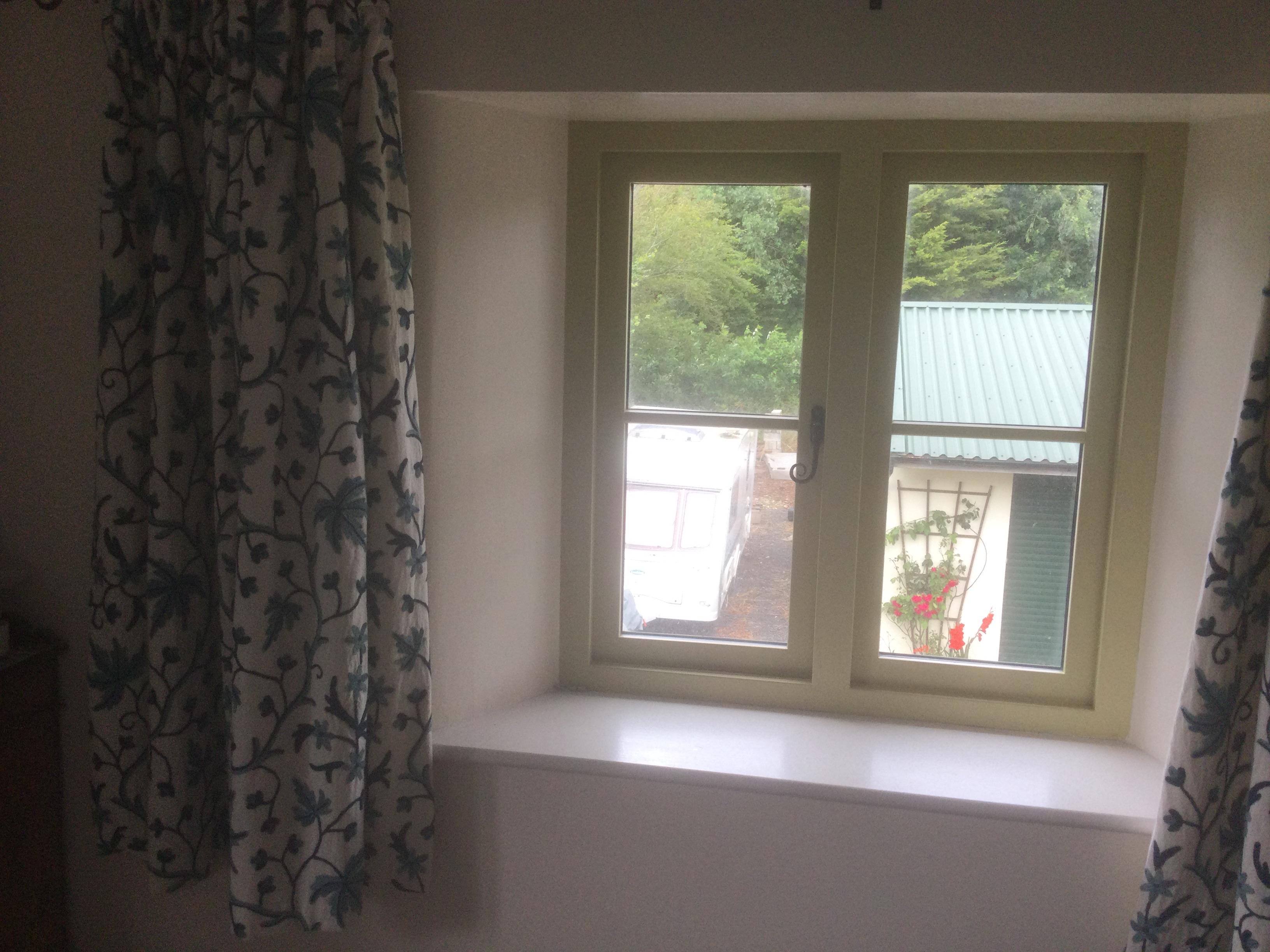

joe90 Posted July 30, 2021 Posted July 30, 2021 32 minutes ago, Dan1983 said: That looks really nice. Did the window company provide the correct colour insert or is the insert part of the window? 26 minutes ago, Mr Punter said: really like the recessed look. Did you make the inner leaf opening bigger to get the window to fit behind the brickwork? Did you use a cavity closer? I had the windows made locally, and asked for a 120mm top piece added. The windows are fitted “check reveals” style, I.e. the windows are fitted from the inside against the brickwork and slightly larger than the opening with expanding foam tape to seal them to the brickwork. The inner blockwork skin appature is larger again to enable the windows to fit through and angled, cottage style, which gives more light into the room, the cavity was closed by plasterboard.
Oz07 Posted July 30, 2021 Posted July 30, 2021 Weren't you bothered about just plasterboard to close your cavity @joe90? What's supporting behind it where it meets the widow

joe90 Posted July 30, 2021 Posted July 30, 2021 41 minutes ago, Oz07 said: Weren't you bothered about just plasterboard to close your cavity @joe90? What's supporting behind it where it meets the widow Where it meets the window I machined an angled timber fillet, screwed to the window frame and plasterboard screwed to that! Expanding foam around this area to mitigate any cold bridge.
Oz07 Posted July 30, 2021 Posted July 30, 2021 Ok so has support was wondering how you caught it. How did u fix/support window frames? The recessed does look good

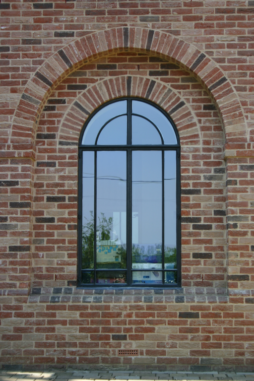

Temp Posted July 30, 2021 Posted July 30, 2021 This is what we did... Arched lintels with brick slips. Pointed up after installation. Some windows.. One or two and front door were double arch.. 1
joe90 Posted July 30, 2021 Posted July 30, 2021 45 minutes ago, Oz07 said: How did u fix/support window frames? Sat on brick cills with Stainless angle brackets and screws , put foam tape between brick and frame, squished to provide seal, expanding foam around (more airtightness). Very pleased with the results. 1
