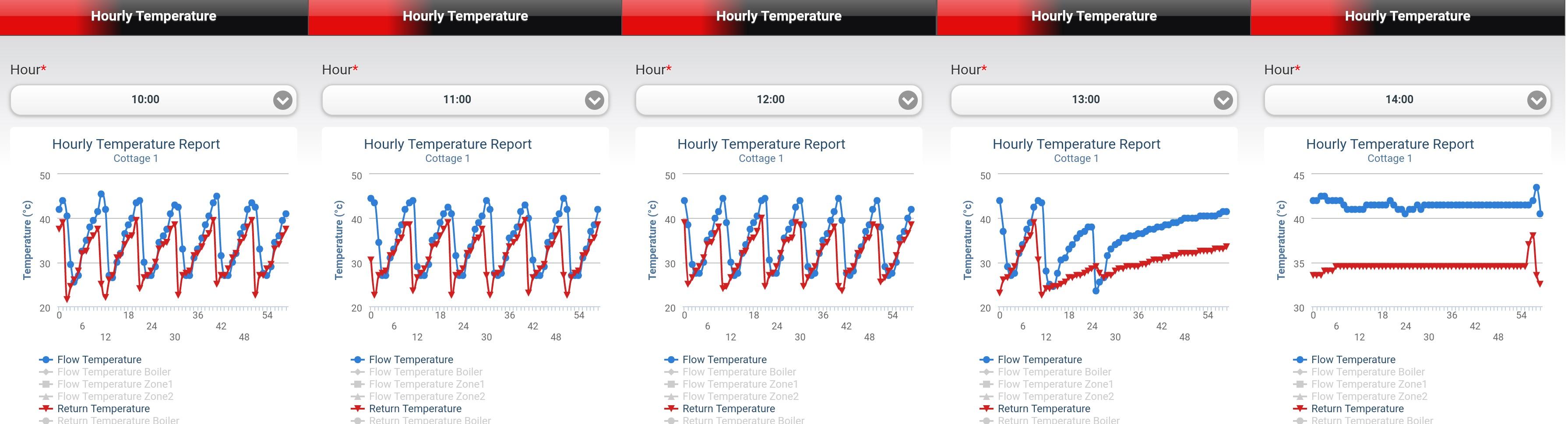

A couple of years ago, I bought a house heated by a 14kw Ecodan ASHP with a Mitsubishi pre-plumbed cylinder system, that was installed in 2015. It has zone 1 to heat 10 radiators and zone 2 to heat 3 loop wet UFH for the kitchen and utility - also heats DHW.
During the colder winter months and late frosts this year, it was clear that the UFH was failing to heat the kitchen/utility floor. The input to zone 1 is physically higher on the low loss header, so if both zone 1 and zone 2 are on at the same time, zone 1 takes the heat, and no heat travels down the low loss header to zone 2.
If just zone 2 is on, some heat goes into the zone 2, but much of it travels down the low loss header to the return. This causes the return to be almost as hot as the flow, so the Melcloud reports show the return temperature tracking the flow temperature. When it reaches the peak temperature, it cuts out and flushes with cold water from zone 1. This shows as a sawtooth effect of fast cycling - the cycling is very regular, every 10 minutes. If zone 1 is on by itself, this does not happen - the return remains lower than the flow and there is no cycling (I've attached a melcloud report showing this).
The system has been serviced, I've flushed the UFH loops out (via hose - a small amount of muck came out but not much and the flow was OK) and inserted more biocide. I've tried altering the pump speeds. To reduce any flow obstructions, I've removed the flow meters and used blanking plates. I've replaced the Heatmiser UH2 with a standard Ecodan wireless thermostat, and Salus THB23030 actuators. I still have the 10 minute cycling.
I have a feeling that the ASHP is too big for the UFH by itself - but not big enough to heat both zone 1 and zone 2 together.
I've tried asking UFH and ASHP installers and maintainers, but they look even more baffled than I do and offer no help (with all the green deal stuff, they are too busy installing new systems to bother with maintaining existing ones). I just wondered if anyone had any thoughts or ideas as to anything I could try?

Many thanks for replying so quickly.

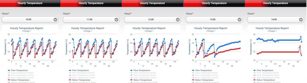

The later portions of the charts are where zone 1 cuts in and takes all the heat. If I could get zone 2 to behave like that and heat the kitchen, I would be happy!

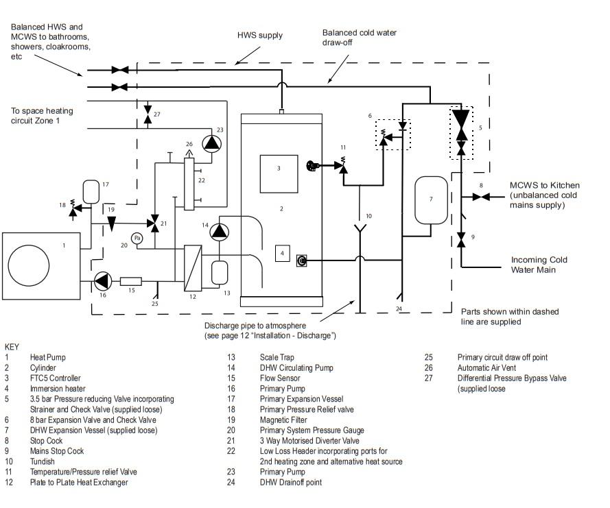

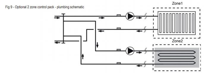

I'm not sure if I have anything as grand as an install schematic. However, it is a standard Ecodan pre-plumbed FTC5 cylinder, so I have attached a couple of diagrams that show that.
In the first one, number 22 shows the low loss header, with the two spare ports for zone 2.
The second diagram shows zone 1 and zone 2, with the pumps associated with those zones.
Does that help understand the configuration?

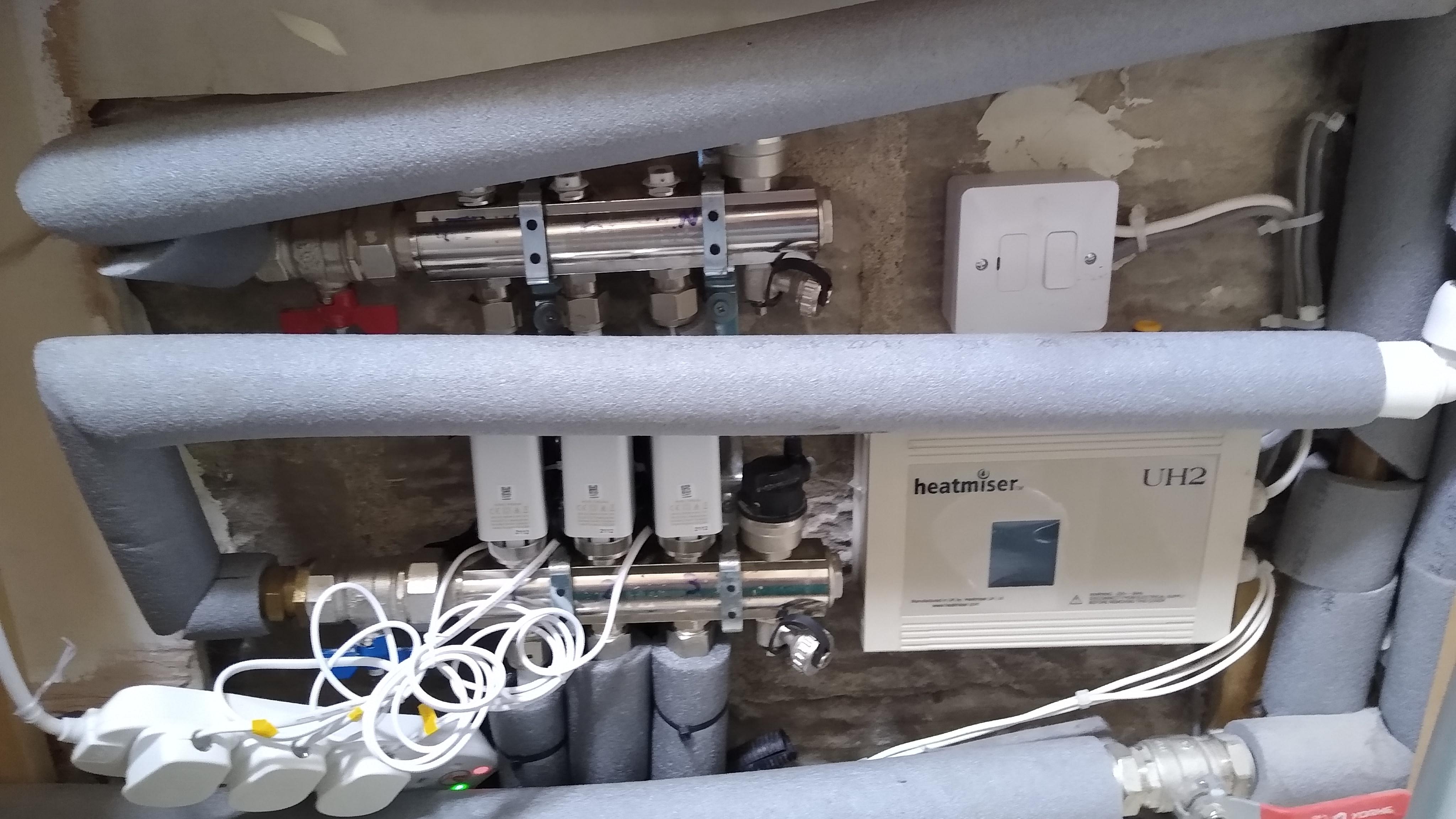

OK, thanks for the schematic, can you show us how the Salus valves are connected is it just as this: https://www.vpsunderfloorheating.co.uk/wp-content/uploads/2019/10/THB230-Quick-Guide-V008.pdf ?
Yes, I followed the instructions as carefully as I could. I've attached a photo below.
The Heatmiser is still in place, but is entirely disconnected and turned off. I'll get rid of it when I am absolutely 100% sure I'm not going to go back to it! When I do that, I'll arrange the power feed to the Salus units more neatly.
The only bit where I improvised regarding the Salus was to cable tie some foam lagging around each of the thermistors. This was just to make 100% that they were at the temperatire of the pipe and were not influenced by other hot things around them. It seemed fairly sensible.

I am becoming increasingly convinced that the UFH just doesn't have the capacity to handle the heat coming from the heat pump, and hence the fast cycling. So there are a couple of 'solutions' that I'm thinking about at the moment (but always open to instructions not to be a dolt, or other options to consider!).

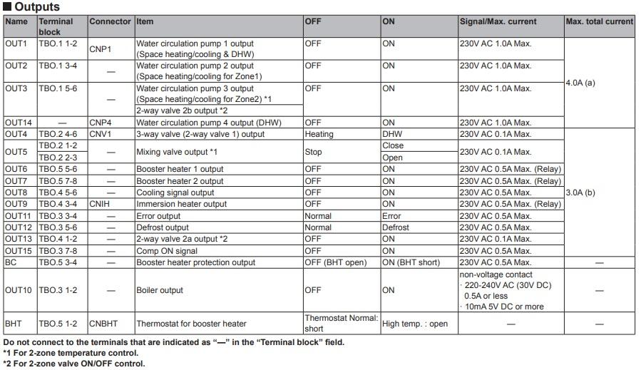

The other option I'm considering is a 'feature' of the Ecodan FTC5. I've attached a copy of the outputs for the FTC5,
For 2 zone heating with pumps for each zone, Mitsubishi say that zone 2 pump should be connected to OUT3 and zone 1 pump should be connected to OUT13 (apparently, the 0.1A is a typo!). One reason for this is that, if zone 2 is on (OUT3), then there is also power at OUT2. If the zone 1 pump were connected to OUT2 (as intuitively seems sensible), then it would also come on when the zone 2 pump (OUT3) came on.
So I'm wondering about connecting the zone 1 pump to OUT2, rather than OUT13. So when the zone 2 UFH came on, so would the zone 1 radiators. So there would be enough radiator capacity to handle the heat provided by the heat pump, and there would be no fast cycling. It is true that the heat would go to the highest point in the low loss header (zone 1) . So I'm thinking about balancing the zone 1 radiators down, so there is remaining capacity to pass to zone 2.
This doesn't seem ideal. I wonder if that might mean that when zone 1 is on by itself, the radiators might then have insufficient capacity to handle the heat - so once again heat would go down the low loss header and I'd get cycling.  The balancing seems quite sensitive. It feels like I need a variable valve that allows full flow to zone 1 when it is operating alone, but restricts the flow to zone 1 when zone 2 is operating.

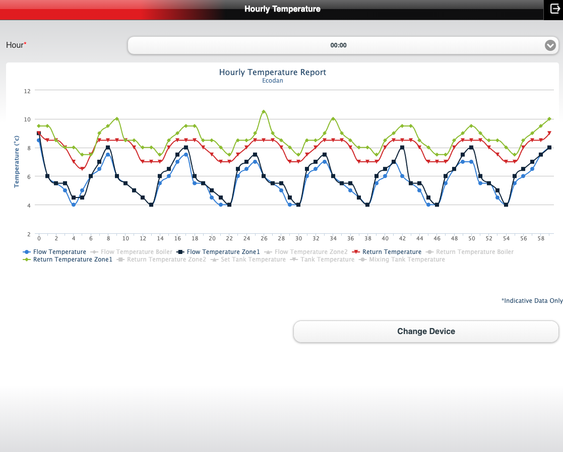

FWIW I have a similar issue with zone 1 (fancoil) in cooling mode not transferring enough cooling energy and hence the ecodan (8.5kW R32 model) is short cycling.
I have to say, I hadn't realized the Melcloud UI allowed useful hourly charts (I'd been scrapping it via Home assistant into Grafana) but similar to you I see 8-10min temperature cycling. This is what people would call short cycling, right?

The Ecodan documentation says that the flow rate for the heating primary for a 14kw Ecodan is between 17.9 and 40.1 L/min. The service says mine has a flow rate of 18L/min.
I have three loops on the UFH, each with a flow meter that goes up to 4l/min. So the total is 12L/min as a maximum (it is actually below that - say about 10. I did remove the flow meters and put blanking plates in to remove any obstruction. Actually that increased the rate of the cycling. I think the hot water was travelling so fast that it wasn't losing heat fast enough.
I think I have hit a case of very bad heating system design :(
