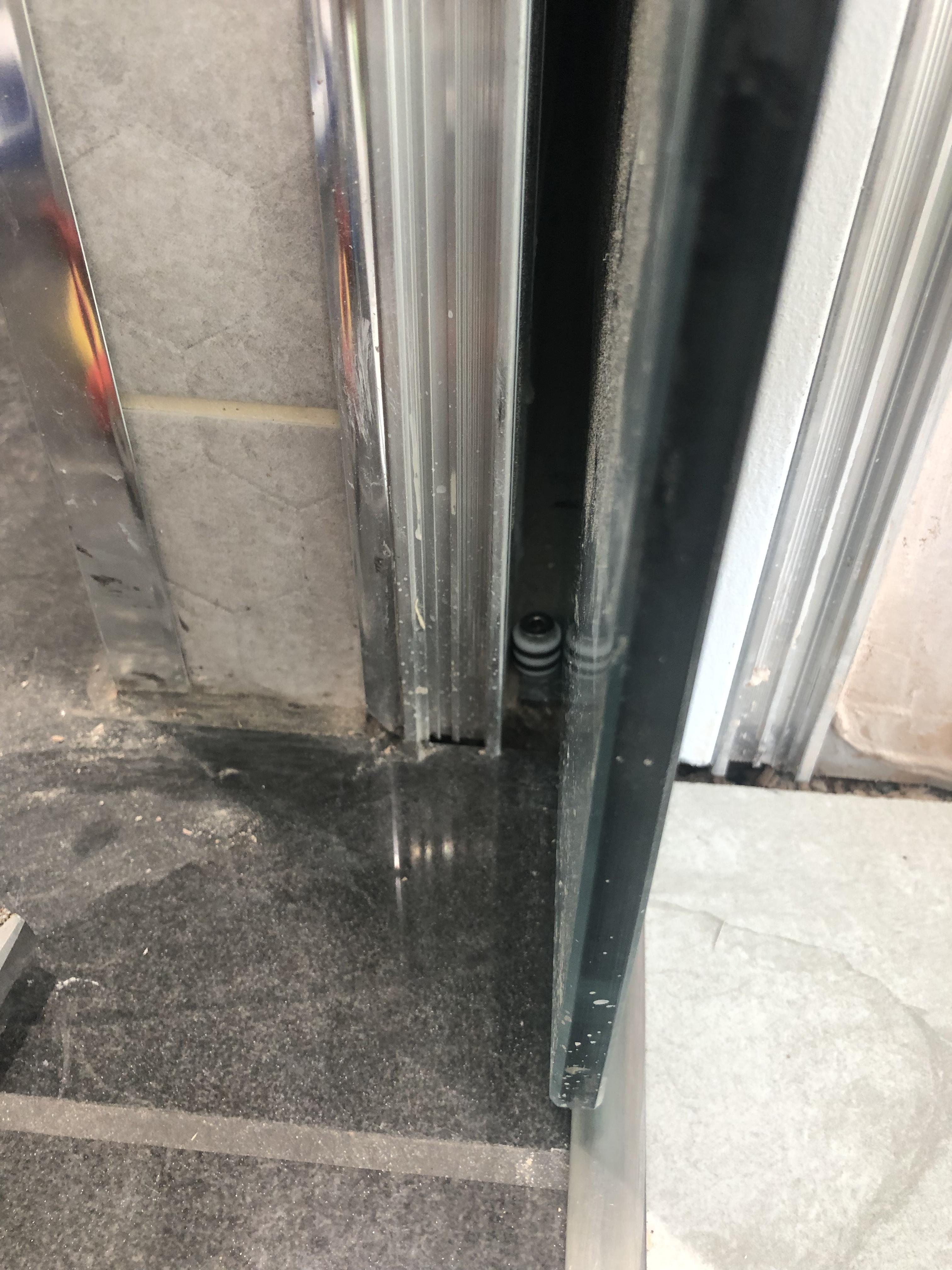

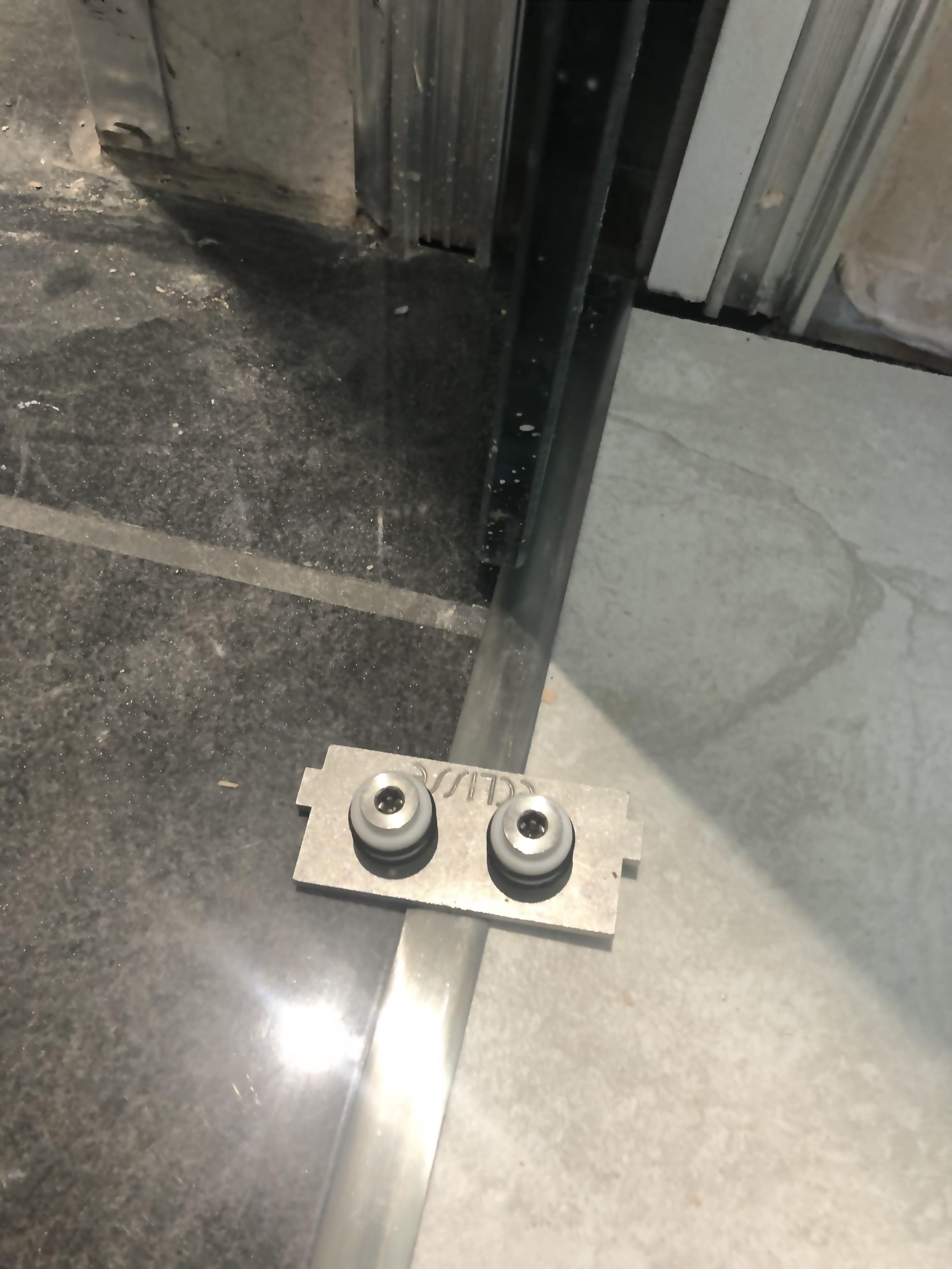

Pocster Posted July 20, 2021 Posted July 20, 2021 Hate this door - worst thing on the entire build . Anyway ! This supplied piece was meant to be fixed in the frame at the base to stop the door to stop wobbling as it slides out . As everything was a PITA I left it out - until now ? It won’t fit . There’s no way I am taking the door off . Whilst I might stick brushes down the sides to fill the vertical gaps and stop crap going in there I still need to fit a “ anti wobble “ device at the base . Any sensible suggestions welcome apart from ct1 sticking it as in the photo !!
markc Posted July 20, 2021 Posted July 20, 2021 You definitely need it, or you could fit a couple of plastic slide pads in the slot but they will leave marks on the door as it slides past them. Take the door out and do it properly

Mr Punter Posted July 20, 2021 Posted July 20, 2021 (edited) Yes I think you may want to trim the metal threshold. The lugs on the side of the plate look a bit crap. I guess they were to locate it in the frame, for the benefit of those installers who follow the instructions... If it looks really crap you could maybe get something from a shower that would work, but your glass looks quite thick. Edited July 20, 2021 by Mr Punter
joe90 Posted July 20, 2021 Posted July 20, 2021 Why has that base plate got funny stick out bits at the ends. Cut em off!!!, cut the threshold strip so it sits flat on the tiles, drill and countersink and use two stainless screws into the floor/tiles. ?

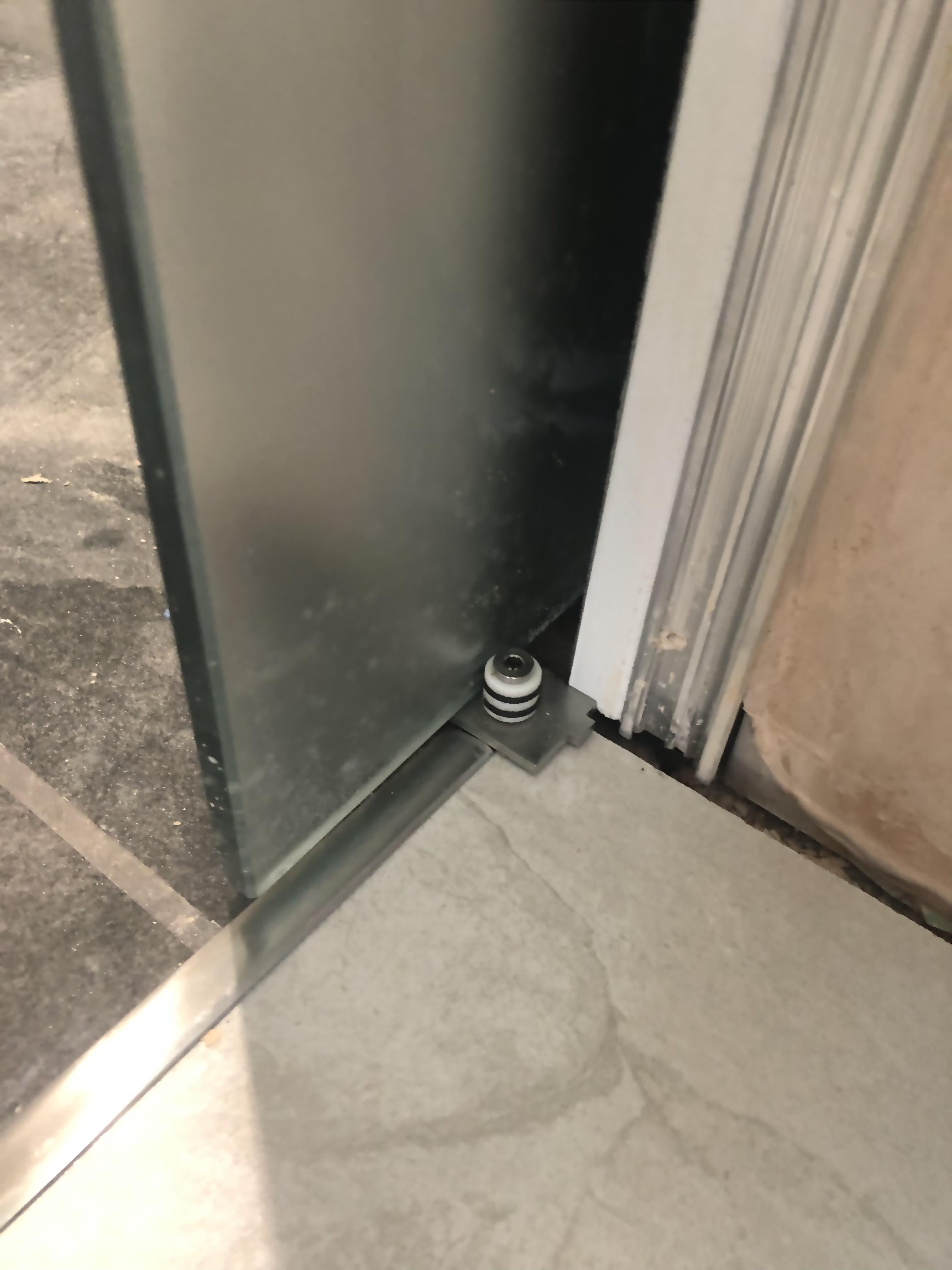

Temp Posted July 20, 2021 Posted July 20, 2021 (edited) 2 hours ago, pocster said: Might cut that metal b’stard . Ct1 the base of it and tweezer it into place . Requires extreme ninja like skills though . Looks like the wheels are too big to do that? Edited July 20, 2021 by Temp
Pocster Posted July 20, 2021 Author Posted July 20, 2021 5 minutes ago, Temp said: Looks like the wheels are too big to do that? Yeah . I found a slightly smaller wheel . So 1 ‘ as is wheel ‘ and one smaller wheel will *just* fit ( less than 1mm of play ) ??? 1
Temp Posted July 20, 2021 Posted July 20, 2021 If you rotate the plate slightly it might be possible to close up even the 1mm gap.
Pocster Posted July 20, 2021 Author Posted July 20, 2021 3 minutes ago, Temp said: If you rotate the plate slightly it might be possible to close up even the 1mm gap. Yes . Getting it in the frame and placed correctly will require God like skills 1
joe90 Posted July 20, 2021 Posted July 20, 2021 If you did make up your own wheels and plate to fit in the pocket how would you fix it with zero space to get your fingers/drill/screws (unless to CT1,d it)?
Pocster Posted July 20, 2021 Author Posted July 20, 2021 23 minutes ago, joe90 said: If you did make up your own wheels and plate to fit in the pocket how would you fix it with zero space to get your fingers/drill/screws (unless to CT1,d it)? Ct1 only answer ?

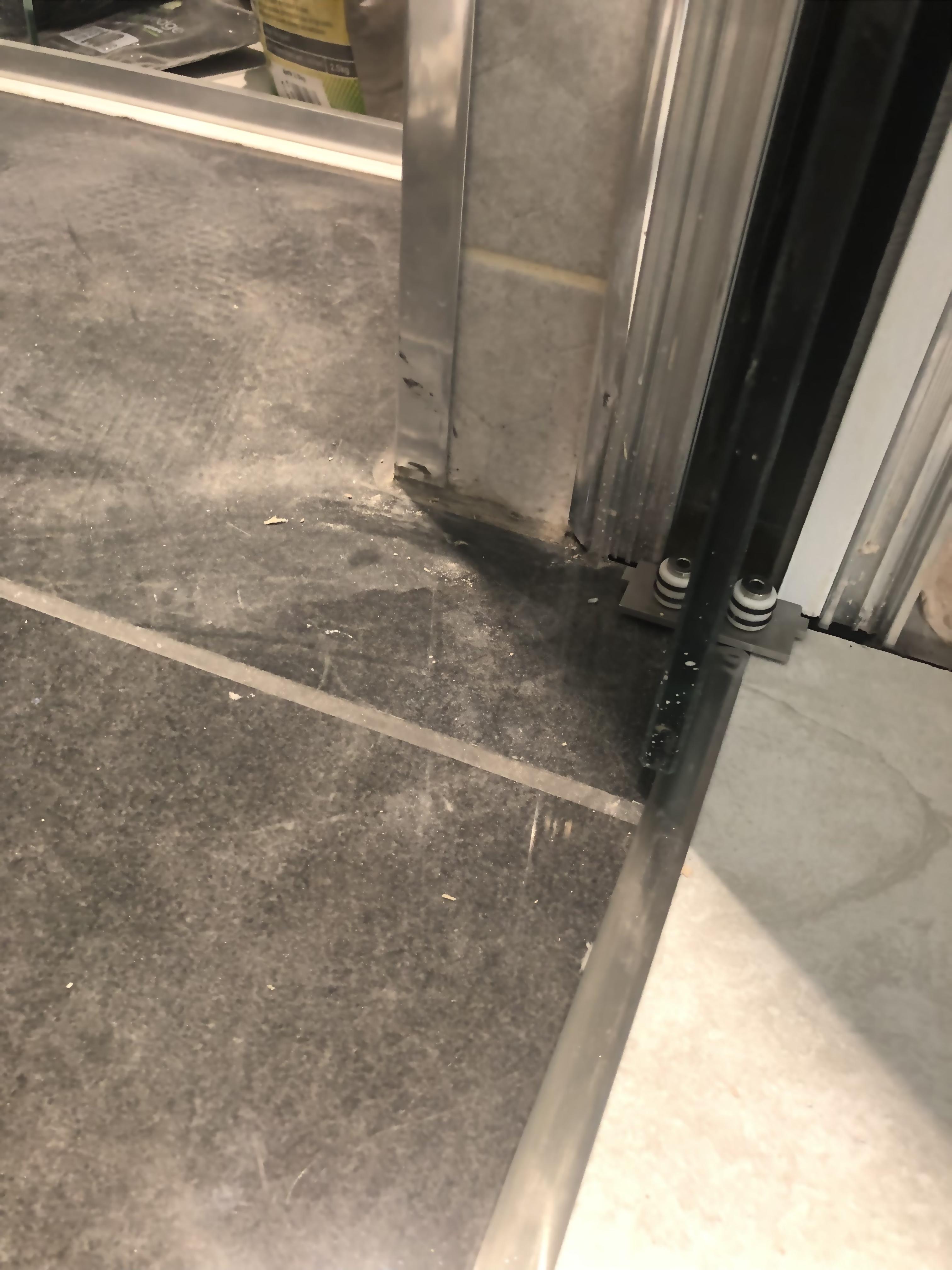

Pocster Posted July 21, 2021 Author Posted July 21, 2021 Tom Cruise here , I’ve borrowed pocsters account for a bit . After hours of prep , some dry run thru’s - we finally went for it . Absolute silence on the set as I do the most extreme and skilful stunt I’ve ever performed. Remember this scene from my next movie “Mission Impossible: Glass door dilemma “ ( rated 18 - due to extreme scenes of a DIY nature ) 2

Dave Jones Posted July 21, 2021 Posted July 21, 2021 we used a kit from howdens on a pair of oak sliders, it had a small metal pin that you fixed into the bottom edge of the door and it located in a small runner inside the 'pocket' part on the floor. worked ok, still a bit of flap at full extension but workable. 1
