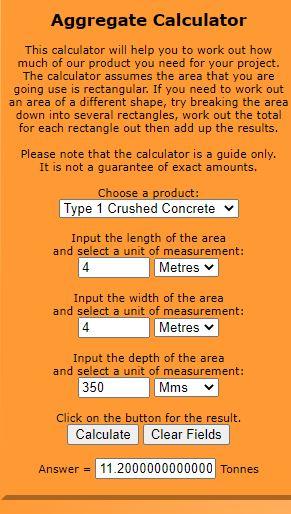

I have the same question, but how do I calculate how much hardcore we will need.
I used to be good at maths, but then I got old
Footprint area in sqm x 0.35m = (roughly) cu m of hardcore for footprint
Can use for any area, to get ballpark figure
1 cu m of crushed concrete hardcore = 0.7 tons
Once you work out the cu m required, (say x) you divide by 0.7 to get the number of tons you require
I'd check that I'd say your closer to double that weight. Especially if  to see small for backfilling floors
Grab lorrys are typically 18.5 tonnes payload
Good rule of thumb for type 1 is 2 tonnes per m3 , some lighter, limestone i think is 2.2 .
As Roman said, concrete crusher run is typically 1.6t per cube depending on how much dust is in it.
biggest mistake most people make with excavations is not factoring in how much expansion occurs when soil is removed. 1 cube in the ground fills almost 2 cube in a truck or skip

Not exactly.
when you dig up rock or soil it bulks up with jagged edges and lots of air between so the density is reduced.
For gravel or pure sand it will not bulk much, but the more jagged the product the more air is between the lumps, 0.7 is a decent estimate for concrete or clay..
So 1m3 of solid concrete becomes 1.4m3 of pile of concrete. If you send it away you fill the lorry with 0.7 concrete and 0.3 air.
They or you crush it, and the density varies a lot depending on if it is all one size or there are smaller bits and dust to fill the gaps.
If completely graded, like type 1 stone, it is very much denser. Then if you compact type 1 well, it is almost like concrete or rock again.
If you crush on site to put back the same volume, you will have surplus hardcore.
If you buy  it in, you can have a choice of qualities, and densities....ask the supplier what the conversion is.
You pay them by the ton, and use the conversion between 1.8 and 2.2 ish to convert to m3 you need.

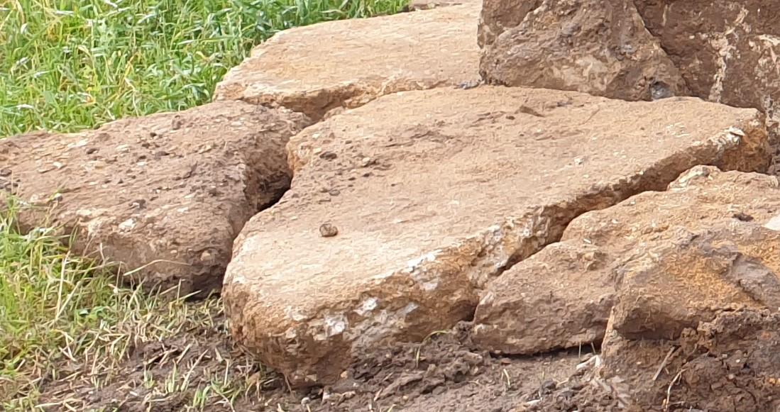

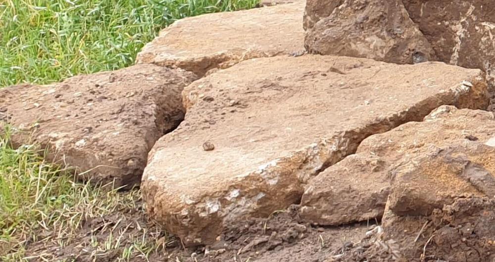

I would love to have left the floor, but as we cannot go up and had quite a lot of roof at 1.8m we had to go down.
What we have in the remove / crush pile is pretty much solid 6"+ thick concrete.
Obviously, there is mud on the rubble, but not mixed in.
This little lot is a side pile that is too heavy for our digger to lift and put in the main pile.
We have this currently from approx 20m * 4m = 80m and will ultimately have about 200 sqm.
There is a small area which is already low enough as the roof is sloped.
The plan is then to put in mot type 1 sort of layer, sand, dpm etc. etc. to raise the floor back up to 20cm lower than where we started.
After removing the rubble we dug out old sand / mud and stones all of which were used or stored elsewhere.
Most of it has become the build drive as the deliver lorries were getting stuck coming up the slope.

The amount of mud on your concrete is trivial. I was commenting on muck deliberately mixed through from a separate pile.
Likewise the odd bit of plastic and steel is to be expected, but not branches., toilet seats and areas of steel mesh.
