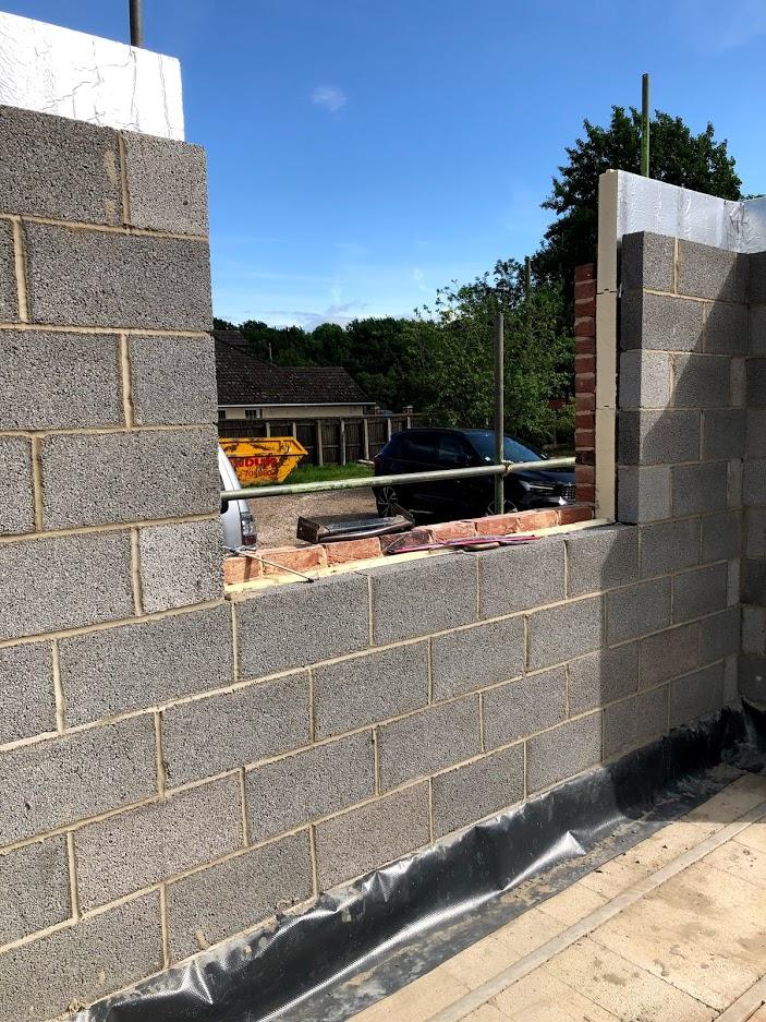

crispy_wafer Posted July 16, 2021 Share Posted July 16, 2021 Should I fit something to close the cavity round windows when building with a full fill cavity, BC said no need, however I seen other builds with it closed off so thinking for the sakes of a few pounds it would tidy it up. Also, where the Insulation comes down the angled roof truss to meet the wall insulation. I get that this butts up to the wall cavity insulation, then we seal and try to make airtight, does anything need to go in between to two insulation boards? Link to comment Share on other sites More sharing options...
nod Posted July 16, 2021 Share Posted July 16, 2021 I can’t understand BC saying that You will need to fit a standard CC Tack in place then silicone around the inner edge prior to the windows beeing fitted 1 Link to comment Share on other sites More sharing options...
tonyshouse Posted July 16, 2021 Share Posted July 16, 2021 I hate cavity closers, they will give you more thermal bridging than what you have and worse draughts and they cause cracking where they join the blocks. if you are doing dit and dab then draughts will be a massive problem I did something similar to you and used thermal board to close my cavities, (normal plasterboard on my canted reveals) then wet plastered everything, no problems 11 years on 1 Link to comment Share on other sites More sharing options...
Scoobyrex Posted July 21, 2021 Share Posted July 21, 2021 On 16/07/2021 at 10:14, tonyshouse said: I hate cavity closers, they will give you more thermal bridging than what you have and worse draughts and they cause cracking where they join the blocks. if you are doing dit and dab then draughts will be a massive problem I did something similar to you and used thermal board to close my cavities, (normal plasterboard on my canted reveals) then wet plastered everything, no problems 11 years on What do you mean by thermal board ? a link to an example if possible. Thanks Link to comment Share on other sites More sharing options...
Oz07 Posted July 21, 2021 Share Posted July 21, 2021 Did you ever do a detail drawing of your reveals @tonyshouse? We're your Windows behind the face brickwork? Did you build plywood box? Link to comment Share on other sites More sharing options...
tonyshouse Posted July 21, 2021 Share Posted July 21, 2021 On tonyshouse website if you dig, yes windows behind reveals, no plywood boxes 1 Link to comment Share on other sites More sharing options...
Dave Jones Posted July 22, 2021 Share Posted July 22, 2021 using made to measure sub-frames is much better. The brickies love them as they give them a true plumb level to work the reveals so they dont need to use a level and they come with ties that fix into the brickwork so they wont move. cost about £18 per window. https://subframes.co.uk/ 1 Link to comment Share on other sites More sharing options...
