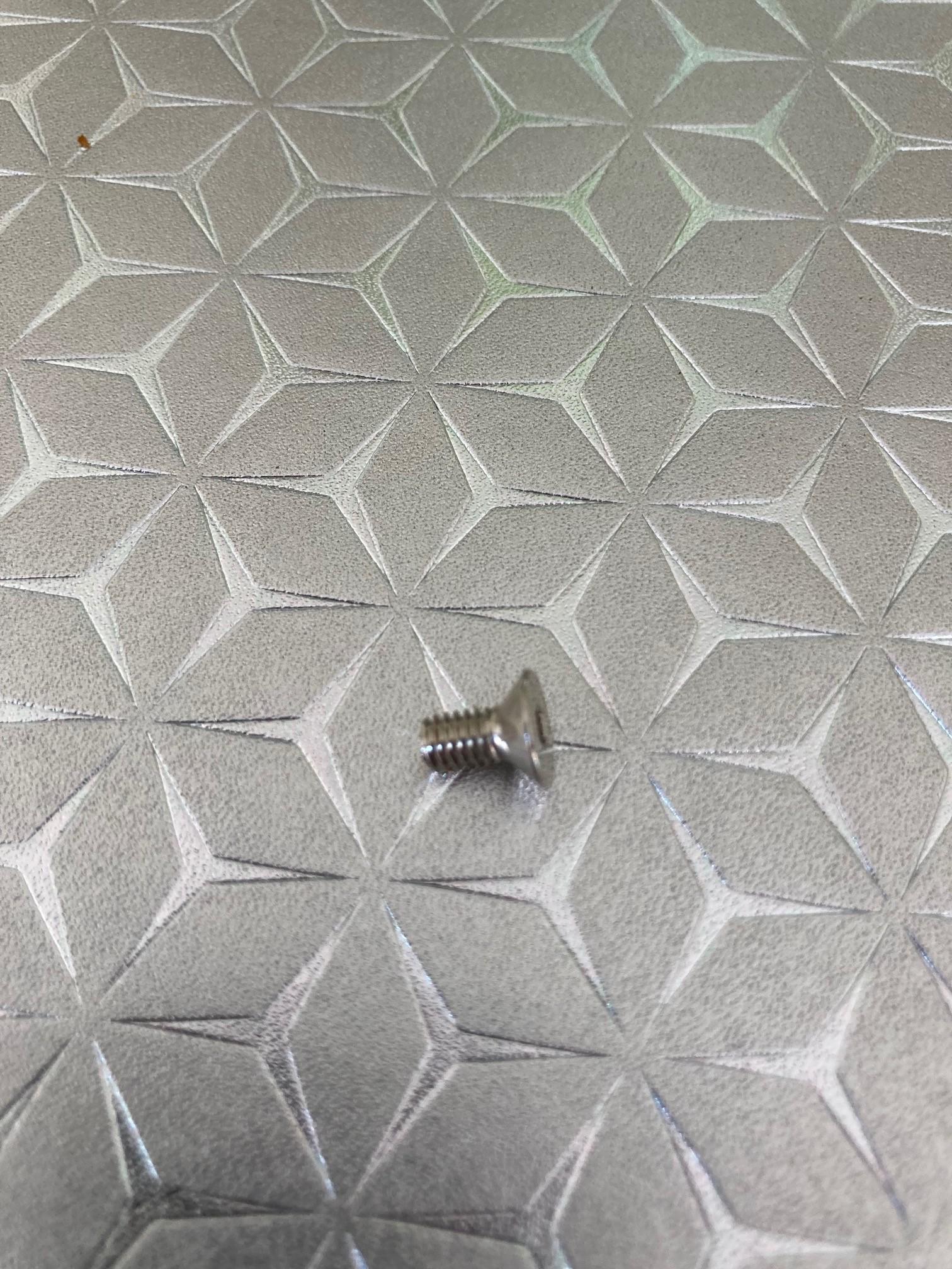

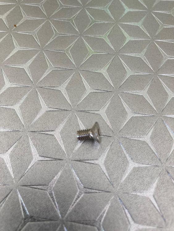

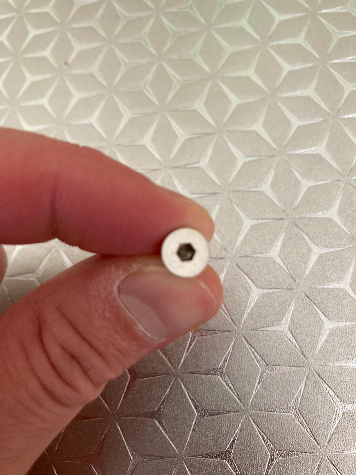

I have some old Laura Ashley curtain poles where the screws that secure the pole to the brackets have been lost / missing. Here is one of the ones I still have. Does anybody know where I can source these from?

thats a readily available countersunk screw. available from any industrial supply place. ask a mechanic for your local supplier.
or if you take another pic with it on a rule or tape measure i will give you the details to get off ebay or amazon etc.

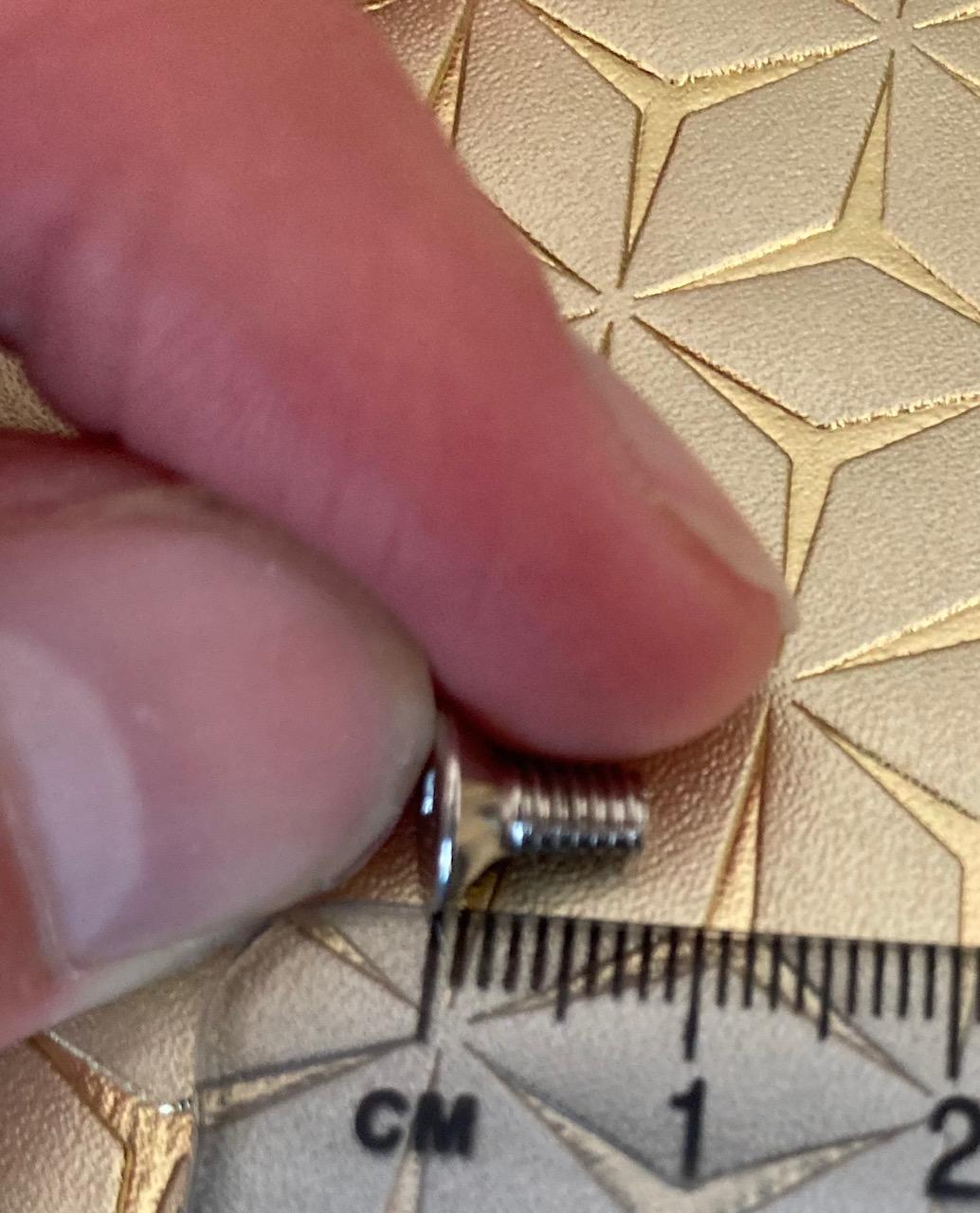

Thanks Mark.

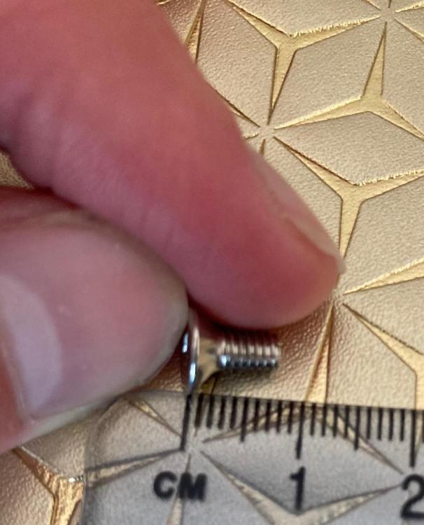

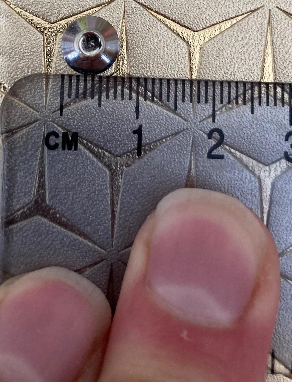

See requested photos attached.
A little smaller than I thought.

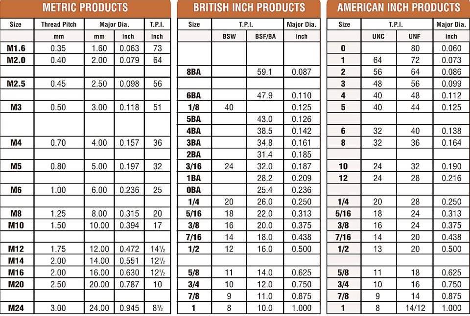

It may be an M3 x 8mm Counter sunk Socket (Internal Hex) (but it could be an M3.5 or M4)
https://www.westfieldfasteners.co.uk/Bolts-Screws-Metric/Socket-Head-Countersunk-Screw-M3x8-A2-Stainless.html
You have to buy 60 from the link above, you'll likely find smaller amounts on eBay.
Can you measure the thread diameter, is it 3mm, 3.5mm or 4mm?
As above, I reckon it’s M3

Looks like M3..
https://www.ebay.co.uk/itm/M3-x-8-mm-CSK-C-S-A2-STAINLESS-STEEL-COUNTERSUNK-HEAD-SCREWS-HEXAGON-HEX-SOCKET/291820450318?hash=item43f1dab20e:g:Yd0AAMXQTghRNiUK&pageci=310f8fb6-95c5-4e0b-9d4a-d597c6e5d6ff&redirect=mobile
If the screw feels very loose then don't over tighten. Try M4.
M3.5 isn't a standard size but might be some available.

I measured the shaft size and to my rather untrained eyes it looks to be 3mm.
To check if it’s M3.5 or M3 just remove a face plate screw from a light switch and try it carefully in the hole. They are M3.5.
/ if it's long enough to get through the faceplate and  down to the box...

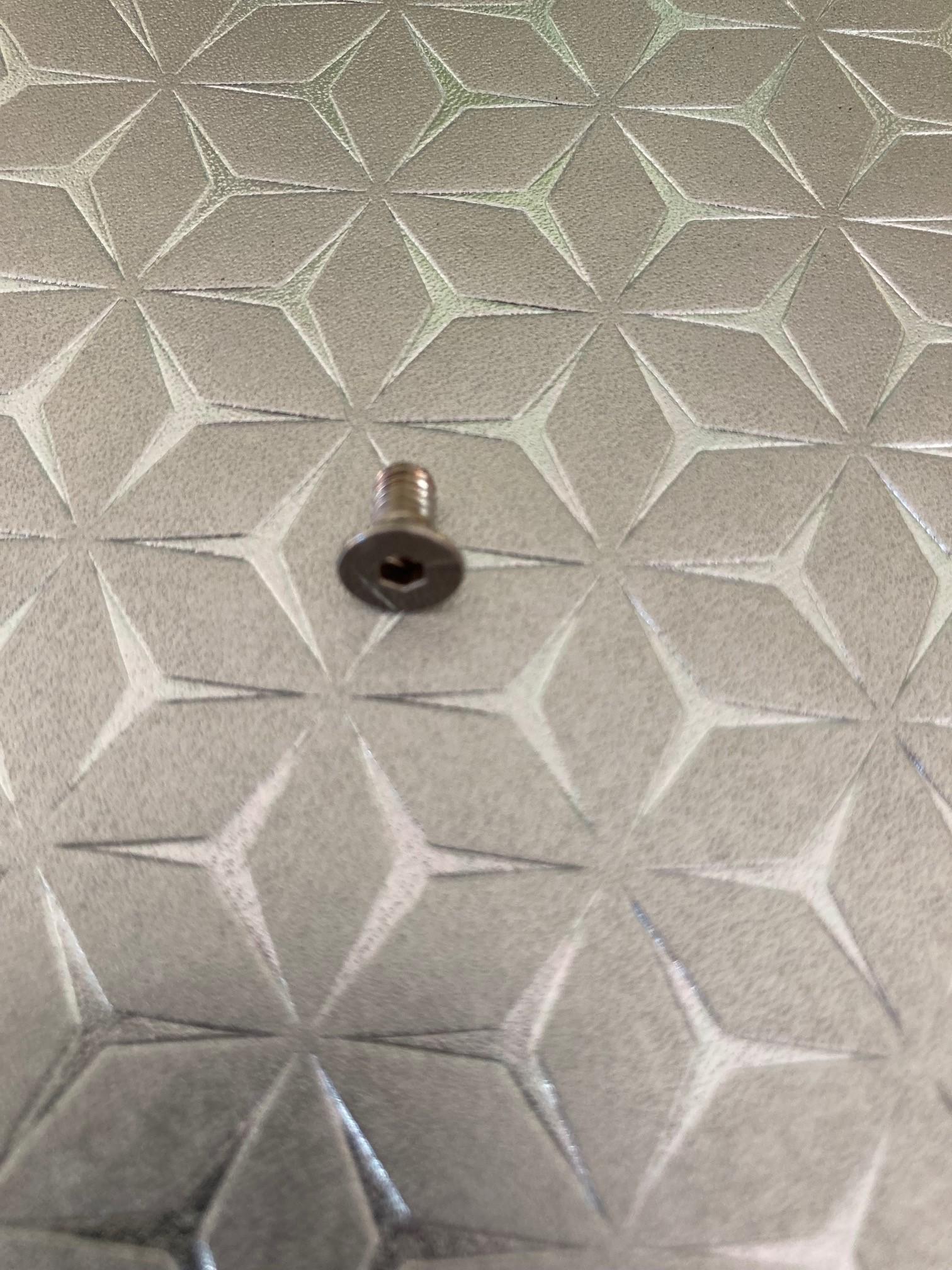

It wouldn't reach the back box for sure but having pulled a spare socket screw, I can see it looks a whisker narrower. Maybe it is 3.5.

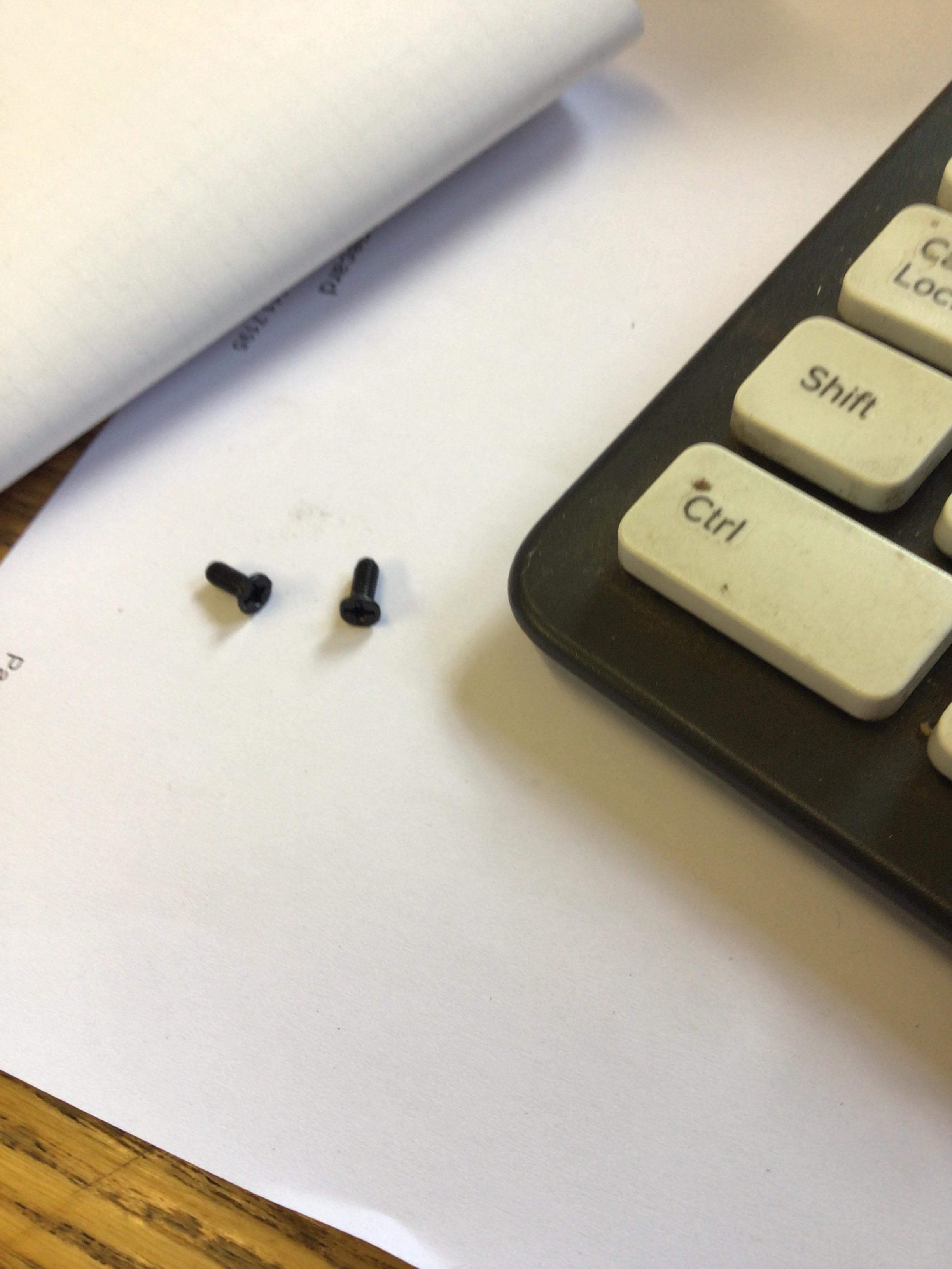

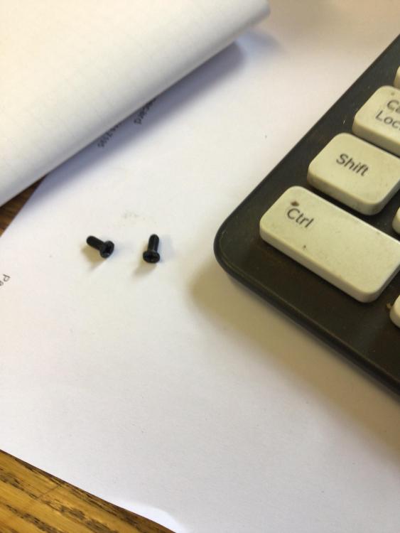

@steveoelliott had a look in my workshop, I have 2 M3x8 in black with Philips head. If they are any use pm your address and I will send them.
Thanks Mark... Actually after comparing with some grub screws mine are definitely m4's. Do you have any of these kicking about? If not I'll purchase some online.
only cap heads in M4
No worries thanks a lot. At least I know what I need to order now anyway.
