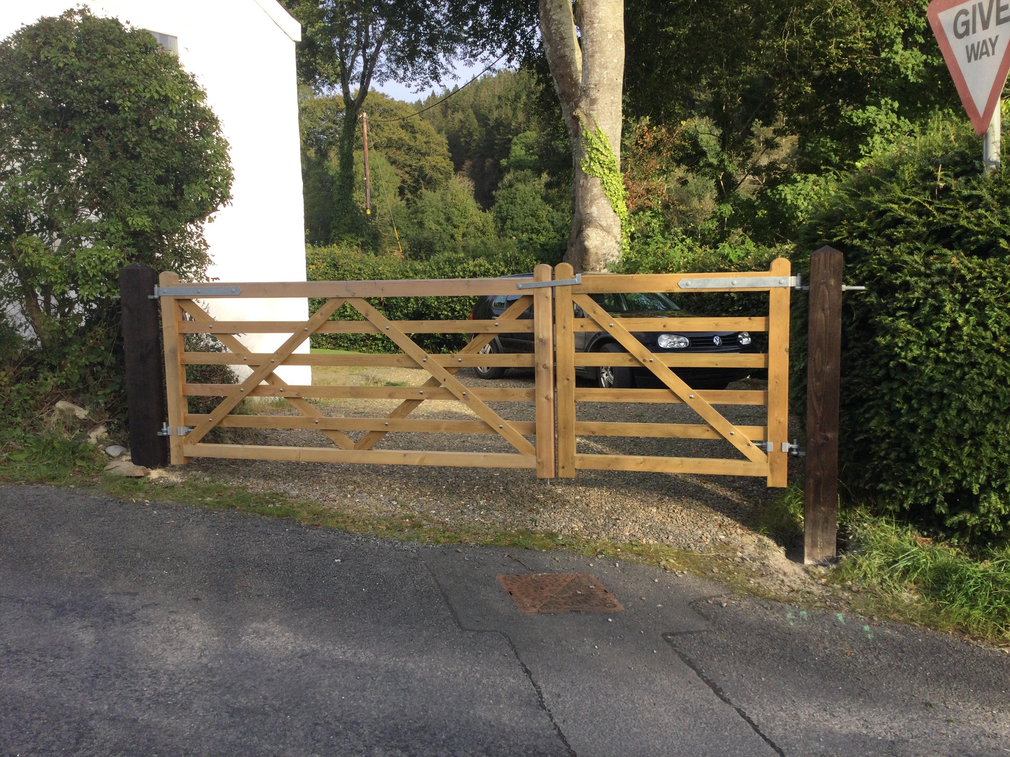

zoothorn Posted September 20, 2021 Author Share Posted September 20, 2021 20 hours ago, joe90 said: Well done zoot . Looks really good ? Hi John. Problem. Progressing more today 2nd hole dug, post in all ready, stones around base, braced etc.. So I pour buckets of water in... & water dissapears, like theres a big plug hole. 3 full buckets.. just disappearing. Shoot. What do I do? Link to comment Share on other sites More sharing options...
zoothorn Posted September 20, 2021 Author Share Posted September 20, 2021 (edited) I must do today. Can anyone else think how this postcrete is even possible now? @Onoff or maybe @PeterWmaybe you could lend an idea? Thanks zoot Edited September 20, 2021 by zoothorn Link to comment Share on other sites More sharing options...
PeterW Posted September 20, 2021 Share Posted September 20, 2021 Chuck the post mix in, put the water in. go make a brew, couple of chocolate digestives go back, hang gate. Link to comment Share on other sites More sharing options...
markc Posted September 20, 2021 Share Posted September 20, 2021 Cheers Peter, I was just writing something similar Link to comment Share on other sites More sharing options...
joe90 Posted September 20, 2021 Share Posted September 20, 2021 Sorry missed this, yes as per Peter said, Chuck it in, add a bit of water afterwards and stir it in if necessary . Link to comment Share on other sites More sharing options...
zoothorn Posted September 20, 2021 Author Share Posted September 20, 2021 5 hours ago, PeterW said: Chuck the post mix in, put the water in. go make a brew, couple of chocolate digestives go back, hang gate. Well I sort of did this.. but i just still cant get this put water on powder thing, i mean without mixing it. So i mixed it, but thank god it didnt FOff once some powder in. Great. Done. Weird stuff (when you have your bics, i have a mild panic attack. E x p e r i e n c e). Thanks. Last thing to scratch my head over, is the large gap I have under my join of gates. Meaning my rod stopper whatnot, going into the ground, on the bigger 8' gate only ( i think is all i need? )seems like its gonna struggle to reach more than an inch into ground. And does it go into a concrete small whatnot...? IE do i need to dig out a bit, concrete it, put my finger in to make a hole & lie outside all night with the owls? Link to comment Share on other sites More sharing options...

Onoff Posted September 21, 2021 Share Posted September 21, 2021 48 minutes ago, zoothorn said: Hi Peter.. yes pin! Ive got just about enough/ 2" to go in ground. It has a metal 2" tube ( & small mystery plate w' hole in middle in packet).. so I assume this is set in the concrete thingy area Ive got to do as last job. Anyway, all that time measuring until my brain hurt seems to have paid off: That looks fantastic! ??? Link to comment Share on other sites More sharing options...

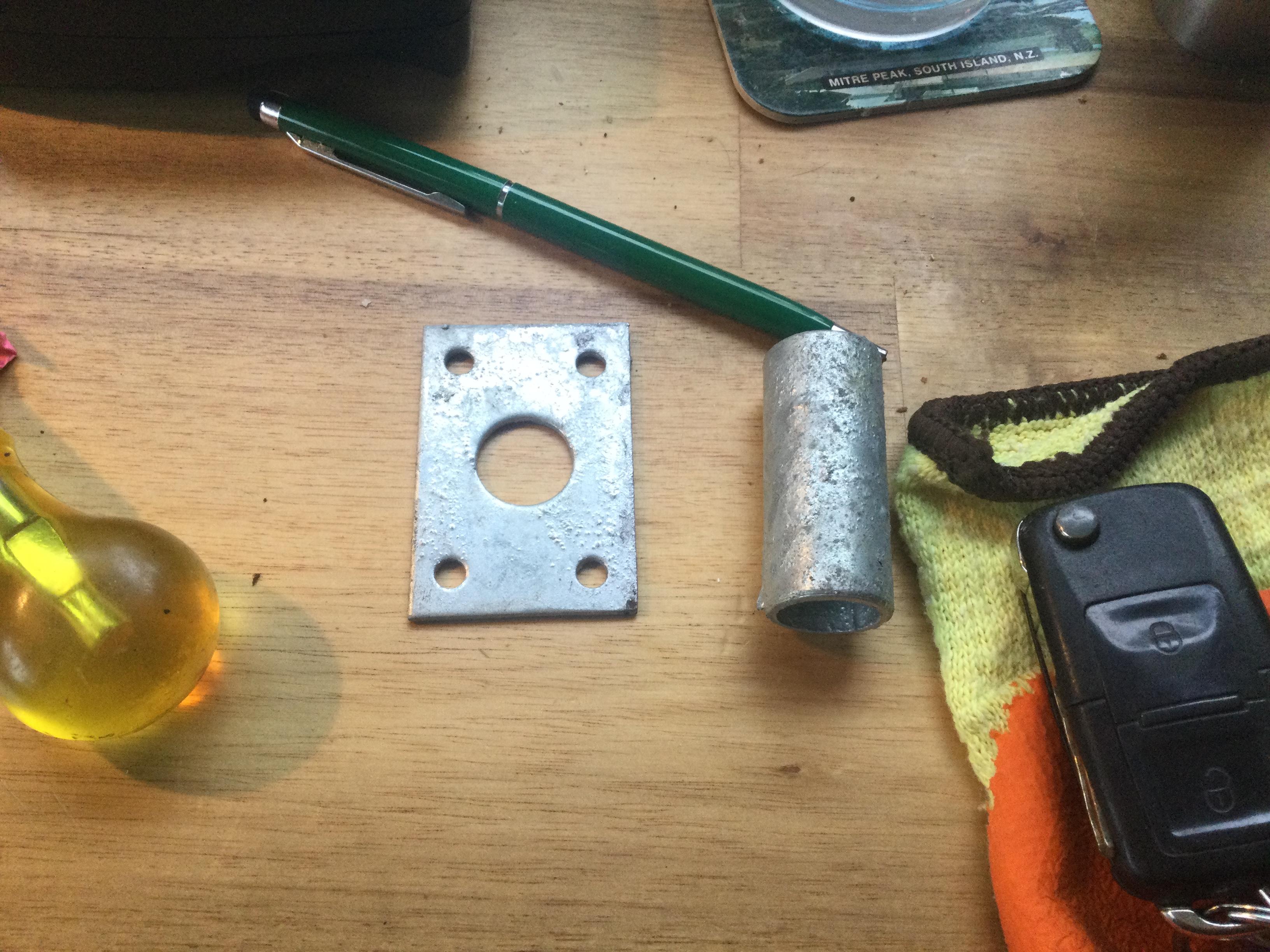

zoothorn Posted September 22, 2021 Author Share Posted September 22, 2021 14 hours ago, Onoff said: That looks fantastic! ??? Cheers Onoff. I think my most 'pro' level of work yet tbh.. Im getting a bit better. Could you say what to do with the centre ground pin recess concrete bit? I have a 2" tube & a plate left in packet.. but Im scratching my hesd looking at them. I realise tube goes upright set in ground only. thanks zoot Link to comment Share on other sites More sharing options...
Gone West Posted September 22, 2021 Share Posted September 22, 2021 15 hours ago, zoothorn said: Anyway, all that time measuring until my brain hurt seems to have paid off: Well done, that looks very smart. Link to comment Share on other sites More sharing options...
Onoff Posted September 22, 2021 Share Posted September 22, 2021 43 minutes ago, zoothorn said: Cheers Onoff. I think my most 'pro' level of work yet tbh.. Im getting a bit better. Could you say what to do with the centre ground pin recess concrete bit? I have a 2" tube & a plate left in packet.. but Im scratching my hesd looking at them. I realise tube goes upright set in ground only. thanks zoot Got a photo of the tube and plate? I'd be casting those into a little concrete plinth set level with the ground. However, you want to avoid sharp edges on that bit of concrete or it'll rip the side out of your car tyre! Knock up a bottomless, little wooden box with some bead round the top to create a chamfer maybe. Link to comment Share on other sites More sharing options...
PeterW Posted September 22, 2021 Share Posted September 22, 2021 @zoothorn that looks spot on ..! Well done ..! Post a photo of the last bits and we will see if we can help Link to comment Share on other sites More sharing options...
Onoff Posted September 22, 2021 Share Posted September 22, 2021 Do take care if bending down, weeding, hedge trimming etc that you don't smack your head on those studs sticking out of the posts. Are they M16 (needed a 24mm spanner)? If so I've some plastic nut covers that might help stick on the end, with a nut, I could post you. Tbh I don't know if it's normal to cut them down? Link to comment Share on other sites More sharing options...

zoothorn Posted September 22, 2021 Author Share Posted September 22, 2021 8 hours ago, Onoff said: Got a photo of the tube and plate? I'd be casting those into a little concrete plinth set level with the ground. However, you want to avoid sharp edges on that bit of concrete or it'll rip the side out of your car tyre! Knock up a bottomless, little wooden box with some bead round the top to create a chamfer maybe. Hi Onoff. Yes here.. i get the idea of the mini plinth level with ground. I need to find/ follow a clip tho, as its not registering fully with me. Link to comment Share on other sites More sharing options...
zoothorn Posted September 22, 2021 Author Share Posted September 22, 2021 6 hours ago, PeterW said: @zoothorn that looks spot on ..! Well done ..! Post a photo of the last bits and we will see if we can help Hi Peter.. must say Im pretty chuffed. The brown posts look like hardwood maybe, but will fade soon/ gotta keep painting to keep up the charade.. Just put a pic of the plate & tube/ last bits. Link to comment Share on other sites More sharing options...

joe90 Posted September 22, 2021 Share Posted September 22, 2021 44 minutes ago, zoothorn said: Yes here.. i get the idea of the mini plinth level with ground. I need to find/ follow a clip tho, as its not registering fully with me. the plate is for screwing to whatever in on the floor (paving slab etc), the metal tube is for burying in concrete. I always find the hole fills with crud so use a plastic sleeve surrounded by cement but much deeper than needed, it will fill up with “stuff” but you can use a long drill to remove it once in a while. Link to comment Share on other sites More sharing options...
zoothorn Posted September 22, 2021 Author Share Posted September 22, 2021 5 minutes ago, joe90 said: the plate is for screwing to whatever in on the floor (paving slab etc), the metal tube is for burying in concrete. I always find the hole fills with crud so use a plastic sleeve surrounded by cement but much deeper than needed, it will fill up with “stuff” but you can use a long drill to remove it once in a while. Ive got pretty good at getting significant wads of fluff out my bellybutton John now Ive just turned 5 0 ( shock horror ) so I should be quite adept at this. Tbh its finding an ideal bit of placcy tube.. not quite so easy for me, but I do get your point/ the idea. Thanks, zoot Link to comment Share on other sites More sharing options...
PeterW Posted September 22, 2021 Share Posted September 22, 2021 23 minutes ago, zoothorn said: Tbh its finding an ideal bit of placcy tube.. not quite so easy for me, but I do get your point/ the idea. Thanks, zoot Ping me your address on a PM and I’ll chuck a piece in the post Link to comment Share on other sites More sharing options...
Onoff Posted September 22, 2021 Share Posted September 22, 2021 I've a selection of stainless steel tubes here in different diameters. Happy to send you a length. I could even weld a big flat washer on top. It'd last indefinitely. What diameter is the gate pin? Link to comment Share on other sites More sharing options...
