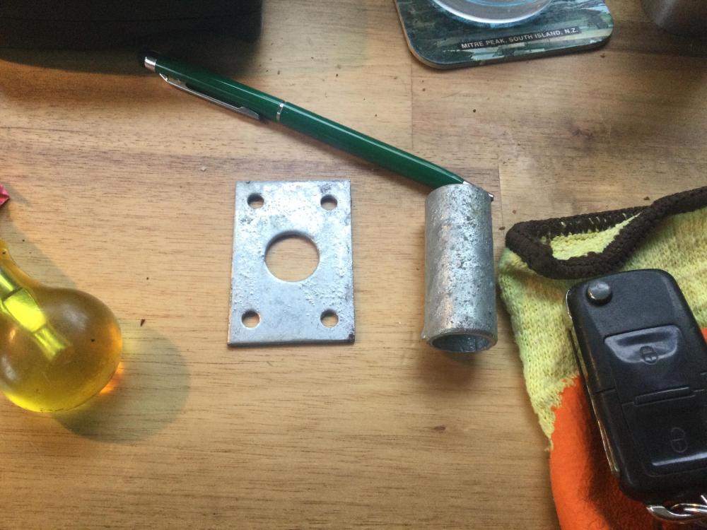

zoothorn Posted September 24, 2021 Author Share Posted September 24, 2021 On 22/09/2021 at 19:25, Onoff said: I've a selection of stainless steel tubes here in different diameters. Happy to send you a length. I could even weld a big flat washer on top. It'd last indefinitely. What diameter is the gate pin? Ah didnt measure that ( im away/ stress break/ more n'bour nastiness ) but i did measure my metal 2" tube.. 17mm inside dia, 21 mm outside. Grateful, zoot Link to comment Share on other sites More sharing options...
zoothorn Posted September 29, 2021 Author Share Posted September 29, 2021 On 22/09/2021 at 19:25, Onoff said: I've a selection of stainless steel tubes here in different diameters. Happy to send you a length. I could even weld a big flat washer on top. It'd last indefinitely. What diameter is the gate pin? Hi Onoff. Just back & to do last bits/ finish this gate pin hole thing. The diameter of pin is 5/8" = 16mm. Im not sure exactly what the idea is here: do I dig a hole, fill with concrete level with ground surface, then put a bit of tape or something over the tube end ( so concrete wont go up it ) then push this into concrete, put pin down into it to seat its position, overnight-? Then the plate.. erm goes ontop after its set? I cant see what this is for tbh. thanks zoot. Link to comment Share on other sites More sharing options...

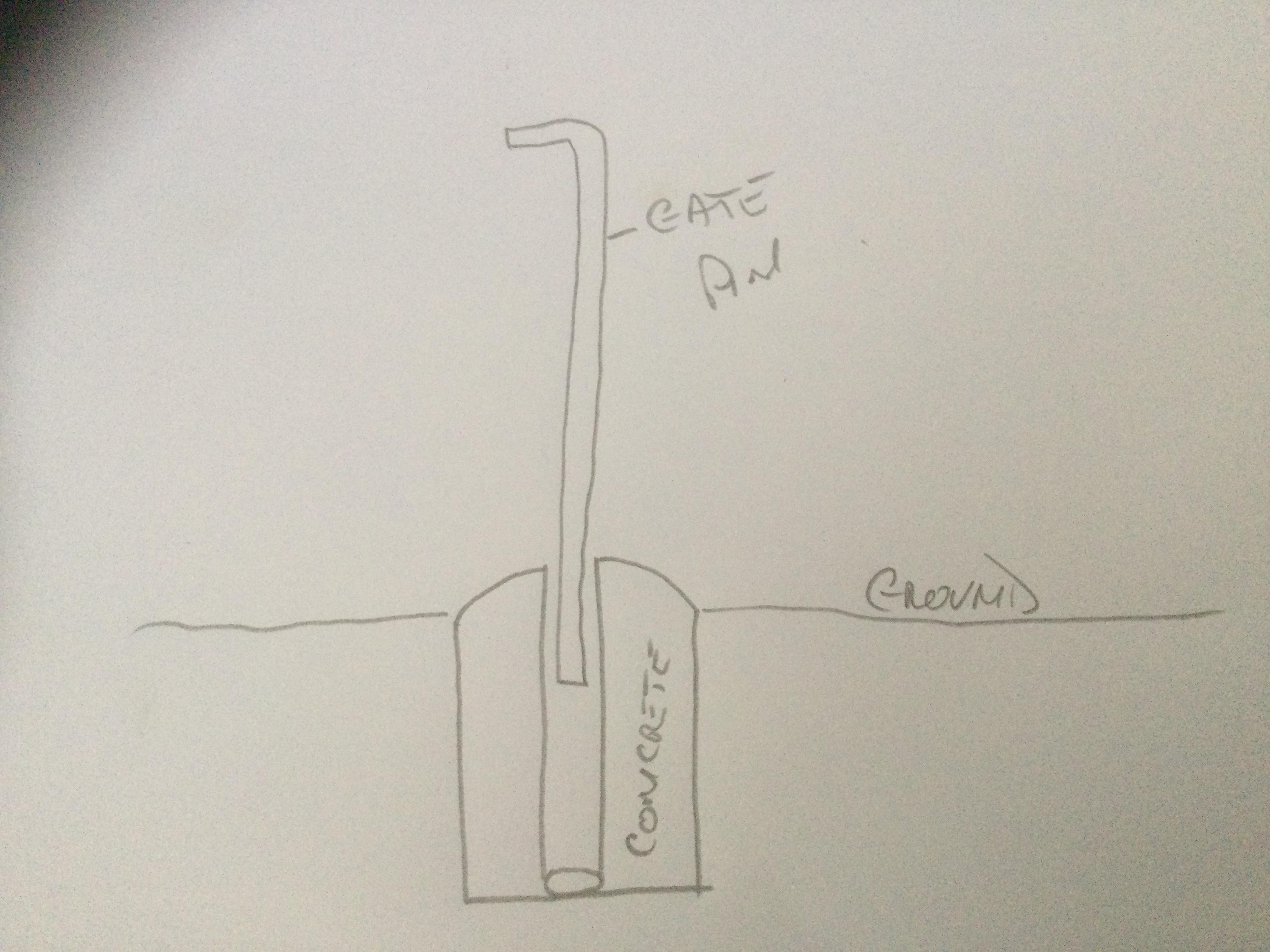

joe90 Posted September 29, 2021 Share Posted September 29, 2021 I would dig small hole, insert tube, hold in place with pin on bottom of gate, propped not to move, backfill with concrete/postcrete and smooth as per diagram, to stop water/crap draining into the hole. Link to comment Share on other sites More sharing options...
zoothorn Posted October 1, 2021 Author Share Posted October 1, 2021 On 29/09/2021 at 16:07, joe90 said: I would dig small hole, insert tube, hold in place with pin on bottom of gate, propped not to move, backfill with concrete/postcrete and smooth as per diagram, to stop water/crap draining into the hole. Hi John. Thanks alot for this, sorry only just spotted the reply. Been so blustery not ideal to keep gates firmly set to do this final job. So maybe put a bit of tape over the btm of the 2" long tube, insert into a 5" x 5" x 2" (D) hole filled with concrete ? I can nab a big handful of hardcore to mix with my cement & sand.. ithink this makes concrete. Maybe take out the big stones. Then press plate on, smooth of edges off downwards whilst setting ? Im sure simplest job for you, but even this is not so for me! Thanks zoot. 1 Link to comment Share on other sites More sharing options...

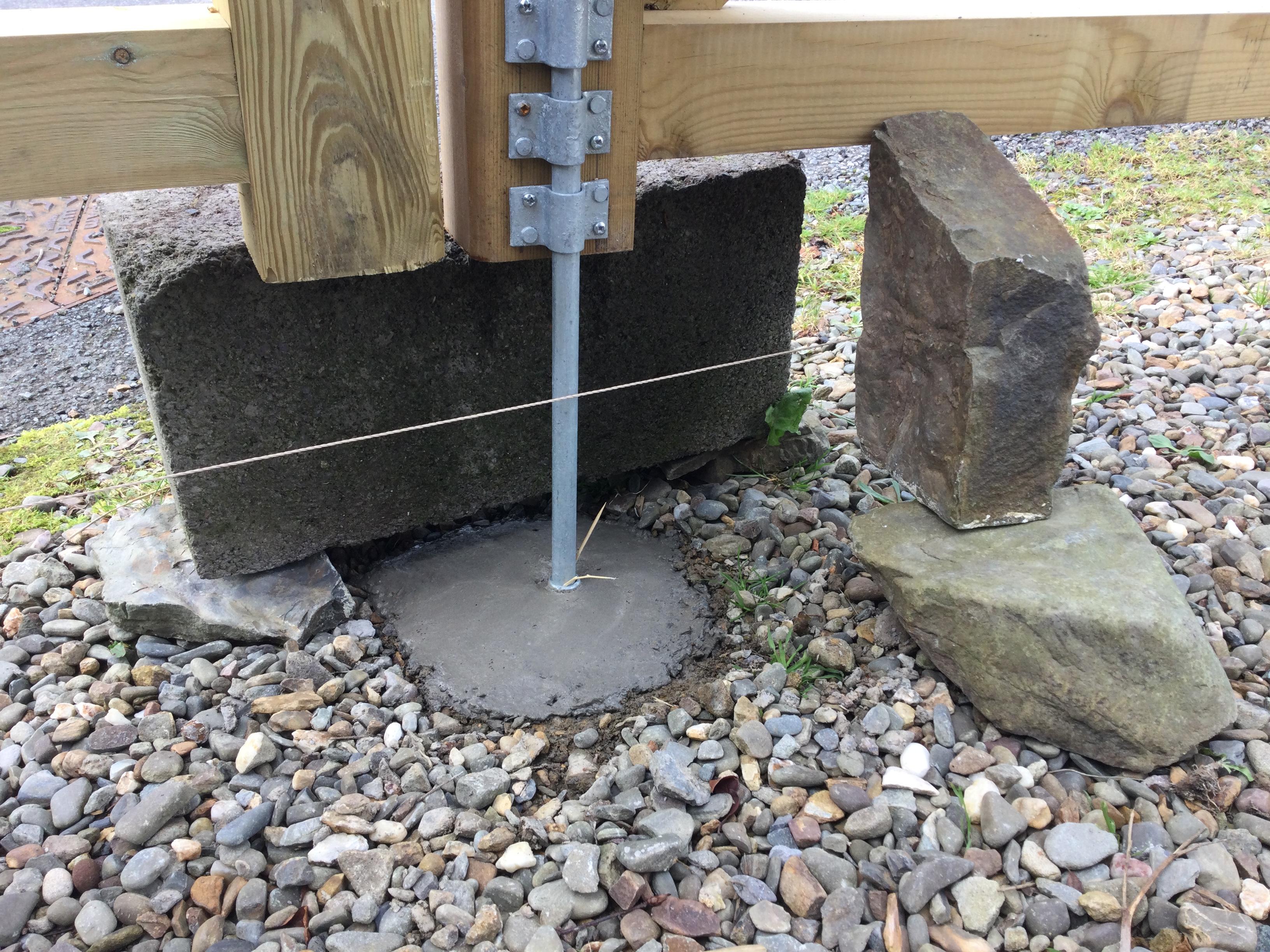

zoothorn Posted October 6, 2021 Author Share Posted October 6, 2021 1 hour ago, joe90 said: Wot he said ? B'stard job. No idea howmuch water, so quite a soup.. then lost my pipe tube in the soup. Fell off the bloomin pin when i lowered the sod in. I did a huge great big swear echoed off the valley walls see. I needed a shelf for me pipe to sit on. But used cocktail sticks jammed it to the pin to hold it elevated whilst it hsrdens.. hope it'll work. but what a bodge job! @Ferdinand thanks that post idea a better idea for holding the bigger gate in place, once open into the drive.. not doing another pin in soup job ever ever everererer again. Link to comment Share on other sites More sharing options...
zoothorn Posted October 6, 2021 Author Share Posted October 6, 2021 Stupidly overkill. Now its going off.. where does this 2" square plate thing go? Or am i too late/ leave the bloomin thing off. Link to comment Share on other sites More sharing options...
markc Posted October 6, 2021 Share Posted October 6, 2021 Does it have a hole right diameter for drop bar? If so it goes into top of concrete to keep the hole tidy Link to comment Share on other sites More sharing options...
zoothorn Posted October 6, 2021 Author Share Posted October 6, 2021 1 hour ago, markc said: Does it have a hole right diameter for drop bar? If so it goes into top of concrete to keep the hole tidy It has a hole markc ideal for drop bar, but oddly not so the tube can pass through it. So as i couldn't dare put tube superflush into me 'crete, or crete would overflow into it p*ssing on me parade, ive set my tube just protruding above me 'crete, by thickness of the plate, & levelled a shelf for it. Just then to enlargen the plate hole so it'll fit over it. Prolly wrong idea, but couldnt think any other way. 1 Link to comment Share on other sites More sharing options...
joe90 Posted October 6, 2021 Share Posted October 6, 2021 (edited) @zoothorn thats fine, don’t sweat, it will work as it is, well done, it’s not a bodge job ? (mixing small amounts of concrete is more difficult to get right than large amounts) Edited October 6, 2021 by joe90 Link to comment Share on other sites More sharing options...
Onoff Posted October 6, 2021 Share Posted October 6, 2021 Fill the tube ends with expanding foam is a trick for next time.....or a cork.....or anything you can dig out later. Link to comment Share on other sites More sharing options...
zoothorn Posted October 6, 2021 Author Share Posted October 6, 2021 11 minutes ago, Onoff said: Fill the tube ends with expanding foam is a trick for next time.....or a cork.....or anything you can dig out later. Hi Onoff. No but the pin needs to go in the tube, while it sets. Hang on.. you mean stick the pin in, & adhere it to the tube, with foam? Anyway nevermind my matchsticks are holding, but its a bit on a squiff. Link to comment Share on other sites More sharing options...
