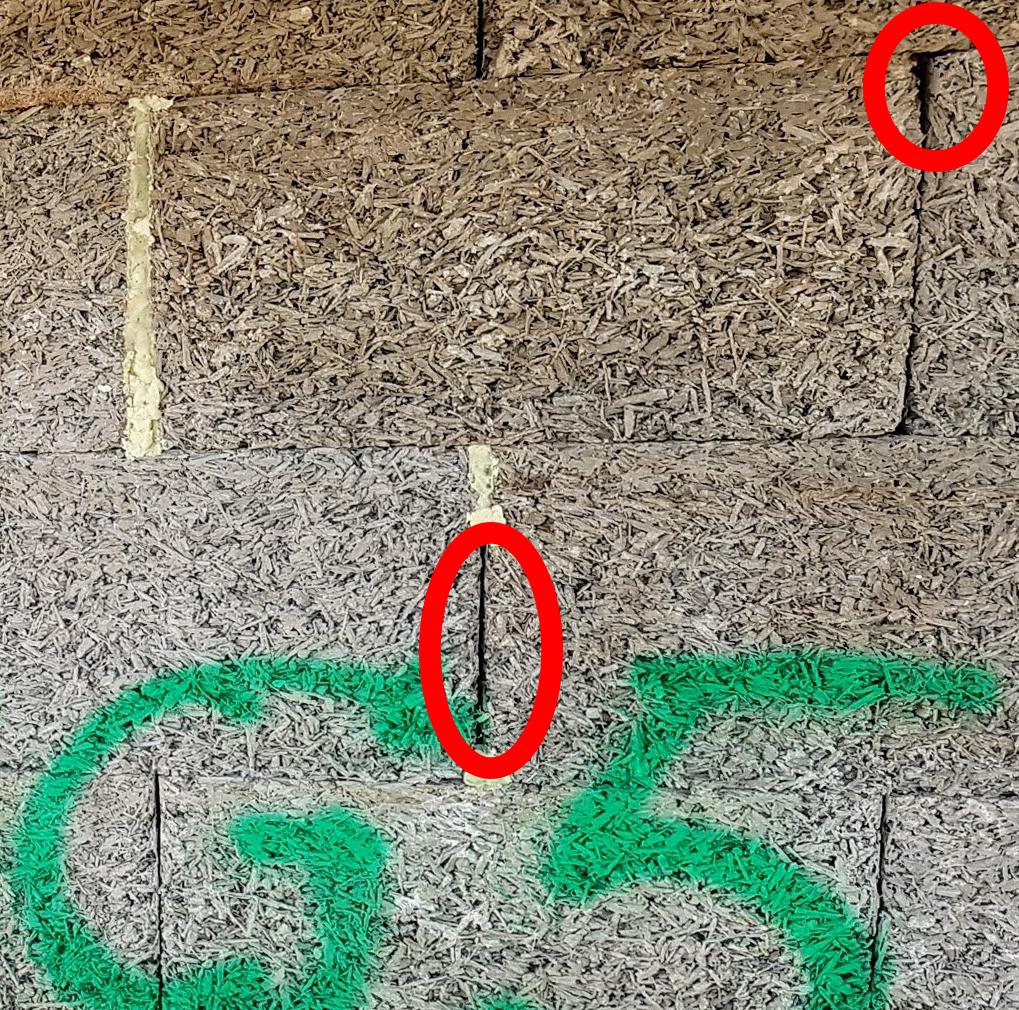

Adrian Walker Posted June 30, 2021 Share Posted June 30, 2021 9 hours ago, MTC said: In process of buying plot and looking at building a ICF barn clad in timber. Have a look at Velox http://icfsystems.co.uk/. The major problem with a block woodcrete ICF system (Durisol, Isotex, etc) is that they have gaps. Link to comment Share on other sites More sharing options...
ToughButterCup Posted June 30, 2021 Share Posted June 30, 2021 3 hours ago, Adrian Walker said: ...The major problem with a block woodcrete ICF system (Durisol, Isotex, etc) is that they have gaps. Could you explain the comment about gaps, please @Adrian Walker, thanks. Could you explain; where the gaps occur, the extent to which the gaps are problematic, and if it is possbile to remediate the gaps? Ian Link to comment Share on other sites More sharing options...
Happy Valley Posted June 30, 2021 Share Posted June 30, 2021 The Polysteel Warmerwall that we are using doesn't have any gaps. They are glued together and use clips between the built in wire mesh. The window and door openings are shuttered with wood and braced. If there were gaps how do you pour the concrete?? Link to comment Share on other sites More sharing options...
ToughButterCup Posted June 30, 2021 Share Posted June 30, 2021 (edited) 14 minutes ago, Happy Valley said: ... If there were gaps how do you pour the concrete?? Precisely the question that I asked, spent about a week investigating. I'm on a phone now, when I get back to the office I'll dig out some photos, and come back. The short answer is that gaps up to about 15mm mend themselves during the pour: the stone jams itself in the gap. Bigger gaps need a bit of old board screwing on the outside, and the pour jams itself tight in the gap there. I'll be interested to see what @Adrian Walker has to say on the matter. Edited June 30, 2021 by ToughButterCup 1 Link to comment Share on other sites More sharing options...
ToughButterCup Posted June 30, 2021 Share Posted June 30, 2021 Here you are: some gaps caused by the usual issue - lack of care with the blocks : dropping one on the corner, or poor product handling. This image was taken after the pour. As you can see concrete hasn't leaked. So, foam gun in hand, I beetled round after the pour shoved some foam in where I thought the gap was excessive. As this photo shows, I missed some bits To the extent that my limited experience of one ICF is correct, gaps, if they occur are all remediable. There is no good reason to state that all Durisol has a problem with gaps and (and is claimed above) no grounds whatever to say that, where they occur, gaps are a major problem. Link to comment Share on other sites More sharing options...

SteamyTea Posted June 30, 2021 Share Posted June 30, 2021 2 hours ago, ToughButterCup said: If Durosol made cars or boats, life would be so much better won't it. 15mm gaps FFS, what is that about. Link to comment Share on other sites More sharing options...
ToughButterCup Posted June 30, 2021 Share Posted June 30, 2021 (edited) Bad day @SteamyTea ? In one or two places (where I laid the blocks) there are 15mm gaps, which didn't matter, because the 10mm chippings in the mix blocked the gap easily. I am no sales person for Durisol: it's one of a few similar products. But it shouldn't be criticised on the basis of my unprofessional work. If memory serves me right, I was totally knackered while building the parapet along the top of our flat roof - the 'outside' temperature there is always the same as the 'inside' . Had the gap been 30mm, it would not have mattered. Edited June 30, 2021 by ToughButterCup Link to comment Share on other sites More sharing options...

Adrian Walker Posted June 30, 2021 Share Posted June 30, 2021 (edited) 6 hours ago, ToughButterCup said: Could you explain the comment about gaps, please @Adrian Walker, thanks. Could you explain; where the gaps occur, the extent to which the gaps are problematic, and if it is possbile to remediate the gaps? Ian As ToughButterCup showed the blocks butt up to one another and create a small gap between them. I have often seen daylight looking out before any coating (plaster, render, etc) has been applied. The woodcrete insulation is good, but just like a woolly jumper you also need to wear a windcheater to get the full benefit of the insulation. Velox uses woodcrete but has a continuous concrete layer and hence before any coating has a much better airtightness. The biggest loss of heat in a house is air convection currents caused by poor airtightness. Edited June 30, 2021 by Adrian Walker Typo Link to comment Share on other sites More sharing options...
