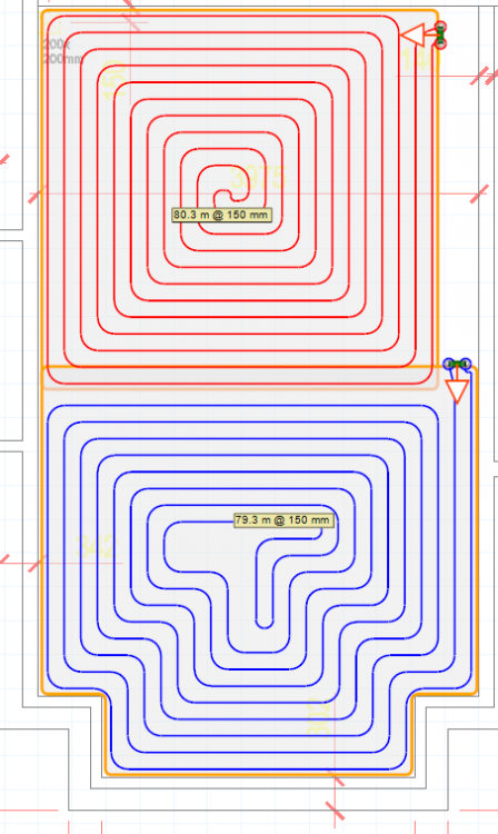

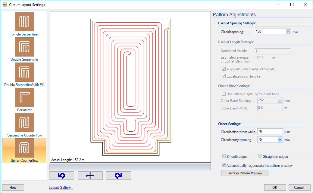

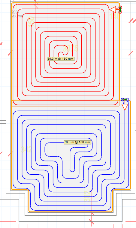

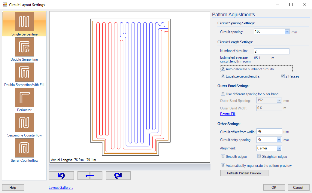

MortarThePoint Posted July 8, 2021 Author Share Posted July 8, 2021 Playing with LoopCAD and the "Spiral Counterflow" circuit layout setting. It only uses one circuit, whereas for the "Single Serpentine" it allows you to set how many and for the first room I am designing it defaults to 2. That's a nuisance as I'll have to manually divide each room that has more than one circuit and hope to get the areas balanced. Not too bad (see third image) though need to factor in the feed from the door (adds about 2*3m) as It doesn't work to have a narrow pan handle on the area. I haven't balanced the lengths very well below as, once I have added the feeds, they will be about 86m and 92m. That's not too bad, balanced to within 10%. Link to comment Share on other sites More sharing options...
Thorfun Posted July 8, 2021 Share Posted July 8, 2021 9 hours ago, MortarThePoint said: That's a nuisance as I'll have to manually divide each room that has more than one circuit and hope to get the areas balanced. exactly why my cynical mind said On 04/07/2021 at 21:19, Thorfun said: they probably design serpentine layout as standard as it's easier in the loopCAD software. ? ? 1 Link to comment Share on other sites More sharing options...
MortarThePoint Posted July 13, 2021 Author Share Posted July 13, 2021 (edited) Wunda have done an excellent spiral design, so clearly either use different software or a particularly diligent designer. Edited July 13, 2021 by MortarThePoint Link to comment Share on other sites More sharing options...
