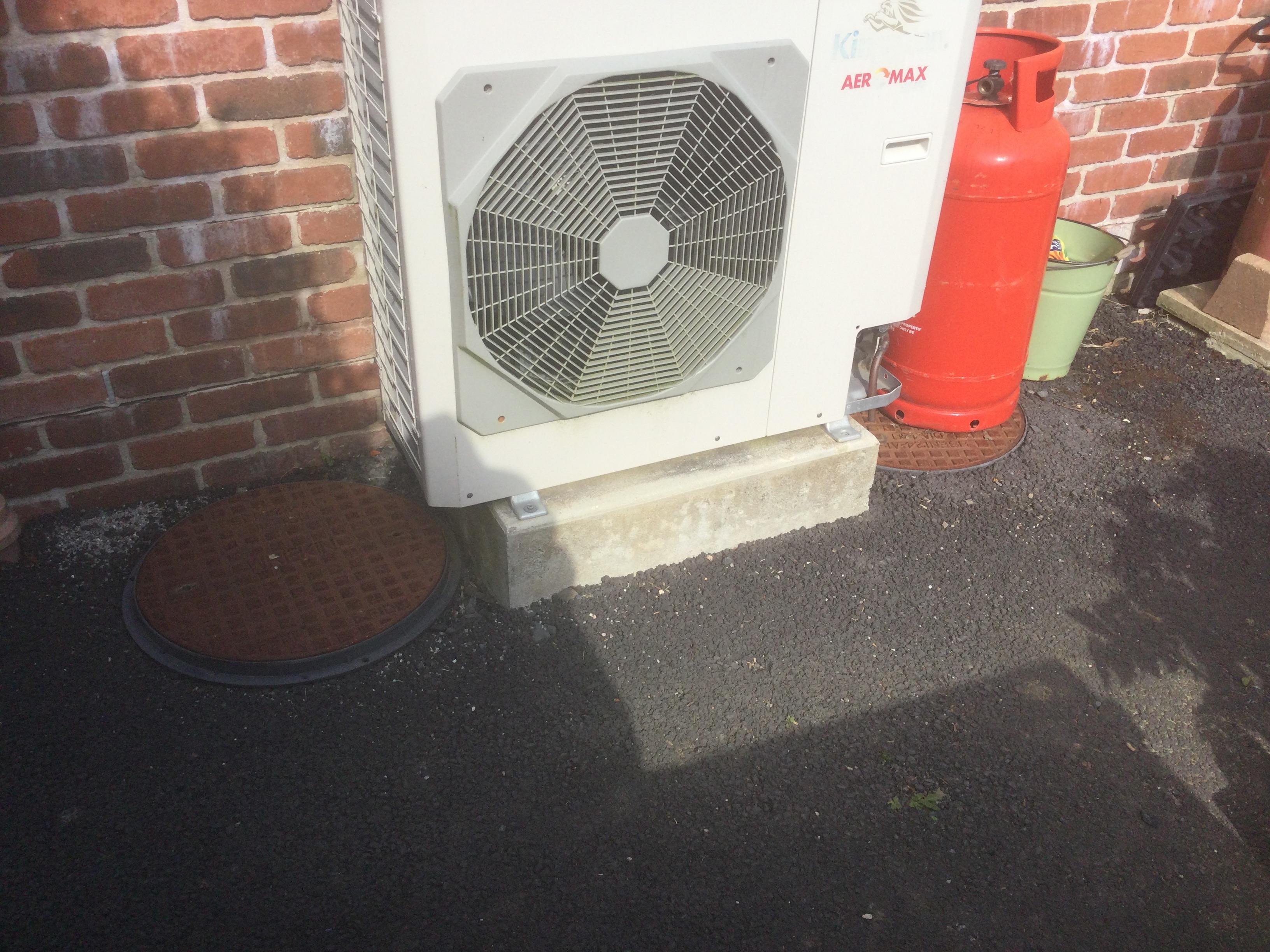

I'm installing a 16kw air source heat pump next week, and need to put in a spot to anchor it. I'm wondering if people can comment on how they've installed them and what has worked? I'm aware this ASHP will put off a lot of water (60-100l a day) and there's an inlet for sewer/waste water (it's a combined one system) about 4ft away from the installation point I've chosen. Should I put down some combination of sand, gravel and top off with cement? Or just small cement bits for the footings for the ASHP mount points? And what about water drainage? I can run some 40mm pipe from top of the pad, or a kind of soakaway. I'm just not quite sure whether 100l is too much to just drain in place. The ASHP is downslope slightly from the sewer inlet which is only about 2" below ground, so it's likely I'd need to run pipes above ground from ASHP. Would love to hear what you've done, and what has worked - and photos if you have 'em!

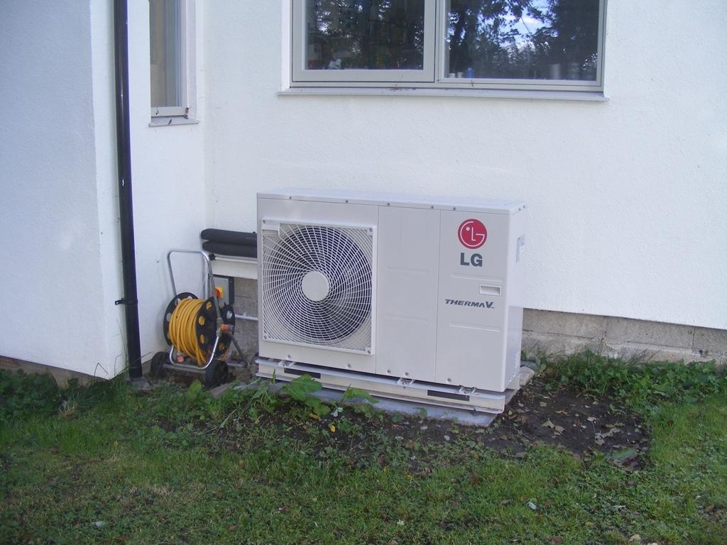

Mine (only 5kW) just sits on 2 paving slabs bedded on sand on compacted hardcore, and any condensate just runs into the surrounding ground.

I concur with @ProDave you don’t want water/condensation entering those air bricks. I built a concrete pad for mine with gravel down the back fir drainage.

Good point - it's funny what you don't think about even when you're staring straight at it! So I'll excavate down a bit (maybe 6"?) put down hardcore (how much? maybe 3"?), compact it, and then put down sand (1" maybe?). Manufacturer requirement is 150mm (6") away from the wall, so maybe I will also move the site further forward from the wall than that (maybe 12"?).
General consensus that it's not worth trying to run a pipe for drainage?

No. And they have not moved.
The area behind and to the left hand side is just filled in with stones so acts as a French Drain for condensate.
