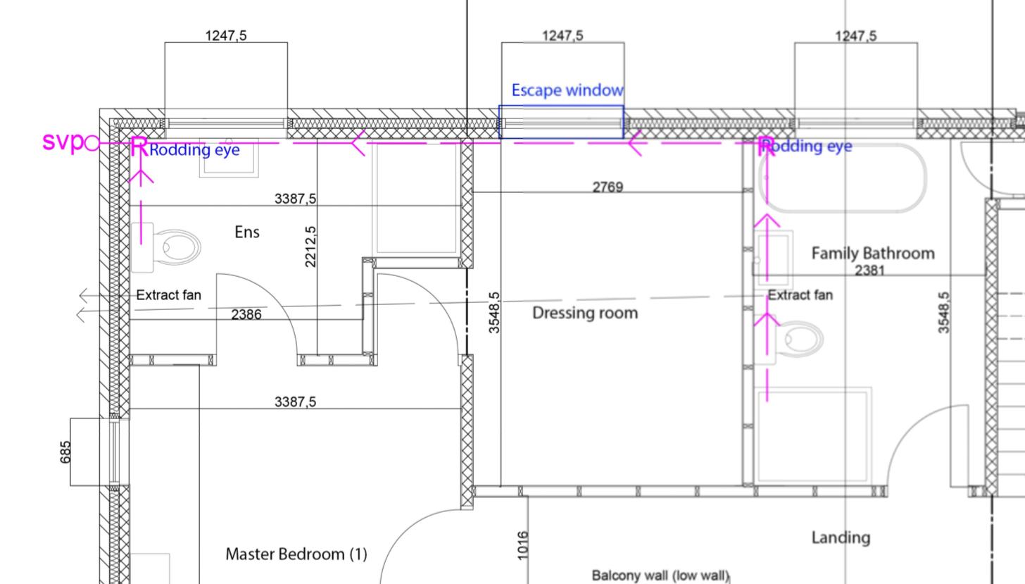

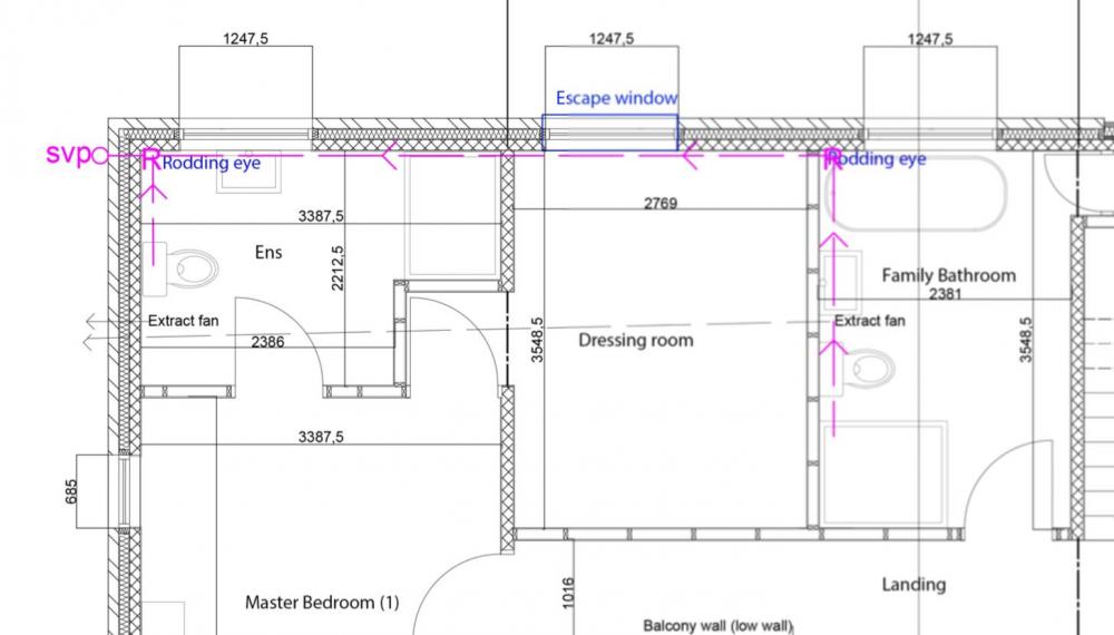

Bonner Posted June 14, 2021 Share Posted June 14, 2021 If I may jump on this thread ... We have started building before I noticed what looks like an external soil pipe! Is this normal in a new build? Can I just move this inside the corner of the en-suite? Does it need a 110mm pipe through the roof if so? The room below is a study, would someone be able to hear things going down the pipe? ? Link to comment Share on other sites More sharing options...
Mr Punter Posted June 14, 2021 Share Posted June 14, 2021 16 minutes ago, Bonner said: If I may jump on this thread ... We have started building before I noticed what looks like an external soil pipe! Is this normal in a new build? Can I just move this inside the corner of the en-suite? Does it need a 110mm pipe through the roof if so? The room below is a study, would someone be able to hear things going down the pipe? ? I am not sure how this will work. Does the WC waste from the family bathroom go round a 90 bend and all the way out to the corner? Is this in the floor zone or boxed in? The rodding eye in the corner of the bath looks hard to access. Link to comment Share on other sites More sharing options...
Bonner Posted June 14, 2021 Share Posted June 14, 2021 Only drawing I have to be honest ? We are just getting out of the ground so need to ensure we get the drains through the slab in the right place. Then work out the first floor runs later ... Only got drawings for BC so lacking a few details Link to comment Share on other sites More sharing options...
Bonner Posted June 14, 2021 Share Posted June 14, 2021 Yes, the idea seems to be running drains to the corner so at least we don’t have an external soil pipe on the front! I would prefer not to have an internal drop from the family bathroom as it would be in the middle of the kitchen wall. Expect the pipes will be under the floor (parallel to 254mm pozi-joists) but no idea how the rodding eye would work? @Nickfromwales, any suggestions, internal or external SVP in that corner or somewhere else? Link to comment Share on other sites More sharing options...
