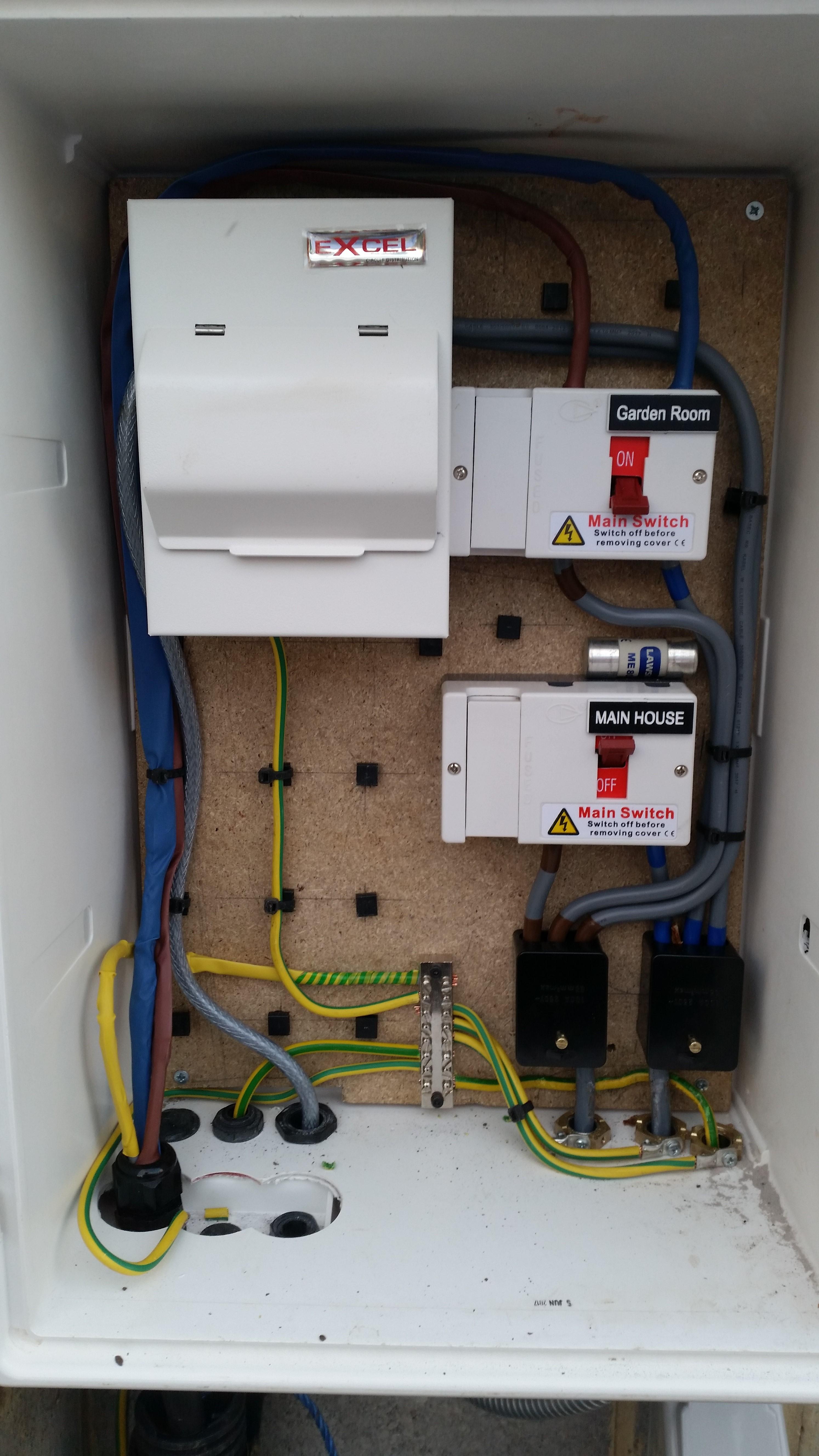

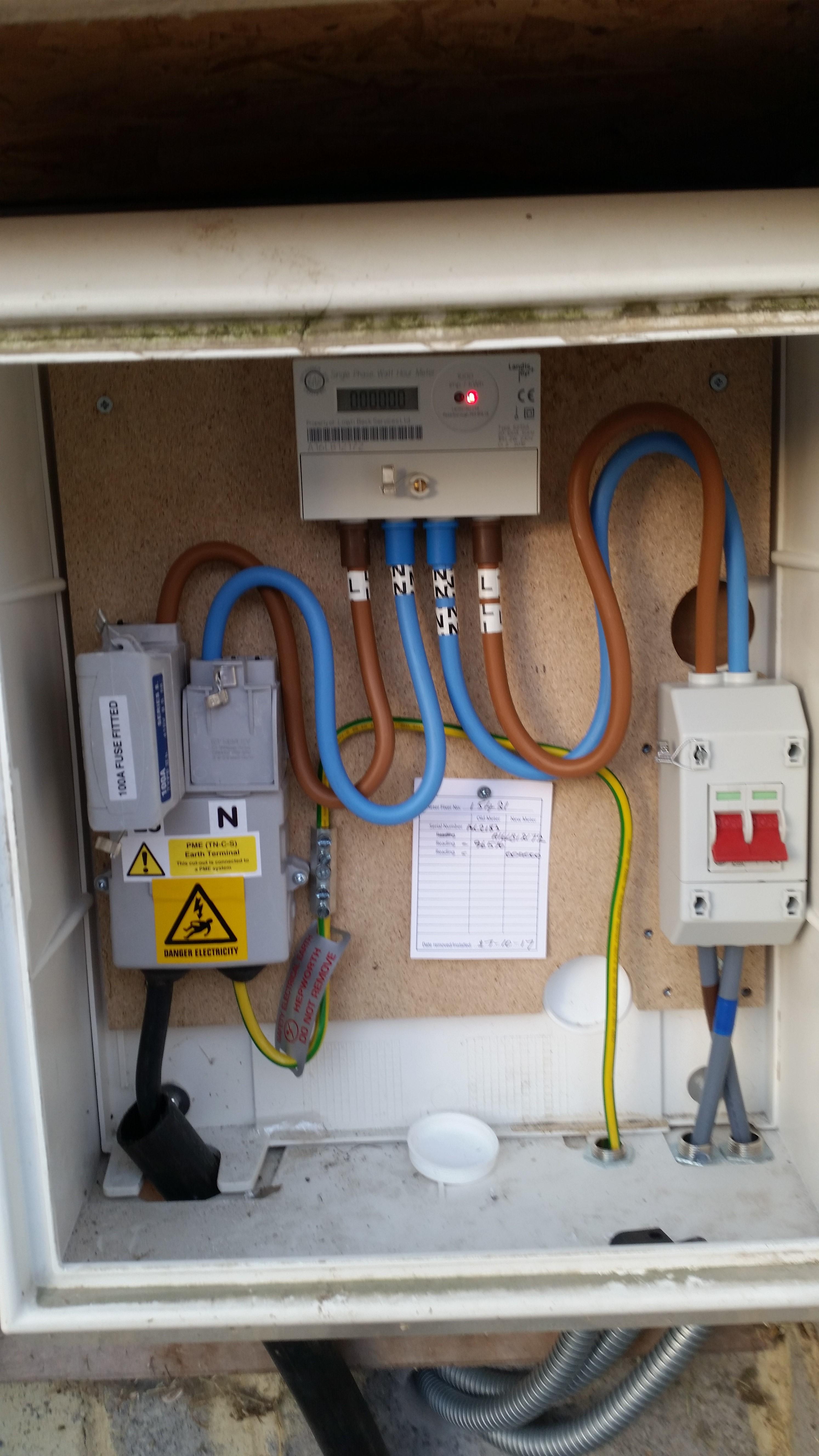

MikeSharp01 Posted June 13, 2021 Share Posted June 13, 2021 You can, subject to appropriate skills / certifications and safety approaches, do what you like after the meter but generally NOT in the meter box. Many of us here have put second meter boxes adjacent to the main one, taken a feed into that and then split it out using and isolating switches to the various consumer units around the building. Here are our two, when the meter was installed I got the power company (In out case UKPN) to install to the isolator, bottom right and then we could do the work in the second cabinet with the power isolated anytime we like. The second cabinet has the two building isolators and a local service (garden power sockets & lighting, car charging and drainage services) consumer unit. 1 Link to comment Share on other sites More sharing options...
ProDave Posted June 13, 2021 Share Posted June 13, 2021 If there is room in the meter box I would do it,. You split the tails with a pair of single pole 5 way henley blocks (those black things bottom right of first picture above) I hate, and never use the 2 pole henley blocks Dangerous things imho. The split tails feed into a 2 way RCD mini consumer unit then out to your outside stuff. Ig it is feeding a socket I would use a 16A mcb. The big BUT here is to do this you need to be competent and understand how to isolate the tails out of the meter in order to do this safely. That is the bit where you are probably better off getting a sparky to do it. Link to comment Share on other sites More sharing options...

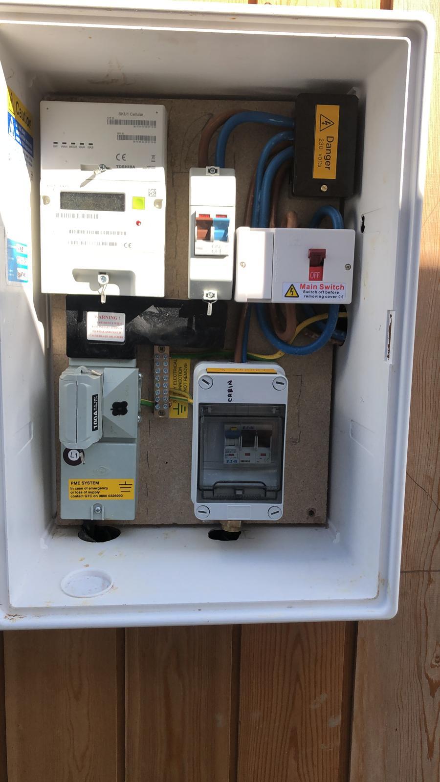

Nickfromwales Posted June 13, 2021 Share Posted June 13, 2021 (edited) Additional mini CU in there for outbuilding and EV car charger point. No issues there whatsoever, fill your boots. That's a double-pole Henley block in that pic, and great for instances where every ounce of space is precious. They've been around for years, and I'm a fan of them as bunches of single pole ones take up lots of footprint / space. Look how neat that is with the double pole one Bingo bango. Edited June 13, 2021 by Nickfromwales 1 Link to comment Share on other sites More sharing options...

ProDave Posted June 14, 2021 Share Posted June 14, 2021 9 hours ago, Nickfromwales said: Additional mini CU in there for outbuilding and EV car charger point. No issues there whatsoever, fill your boots. That's a double-pole Henley block in that pic, and great for instances where every ounce of space is precious. They've been around for years, and I'm a fan of them as bunches of single pole ones take up lots of footprint / space. Look how neat that is with the double pole one Bingo bango. Looks great. My guess is all "your" kit was added after the meter was in? I suspect if you put all that kit in the empty box first then waited for the DNO to come and fit the meter they would have had a hissy fit. P.S the reason I dislike double pole Henley's is I found one once damaged. The web separating the two blocks is not very thick and I found a broken one where the two blocks were very close indeed to touching each other. Just keep an eye on that and treat them carefully. That is never going to be an issue with singles. Link to comment Share on other sites More sharing options...
Nickfromwales Posted June 14, 2021 Share Posted June 14, 2021 I made sure the DNO had instructions to install their equipment tight to the left hand side. Everything was measured and drawn out so I knew it would all fit, prior to sending cables x,y & z to that location prior to the meter installation. Agree the integrity of those DP Henley blocks need to be preserved during installation, but there’s no denying that in some instances the effort is not just worth it….but completely unavoidable. Link to comment Share on other sites More sharing options...
