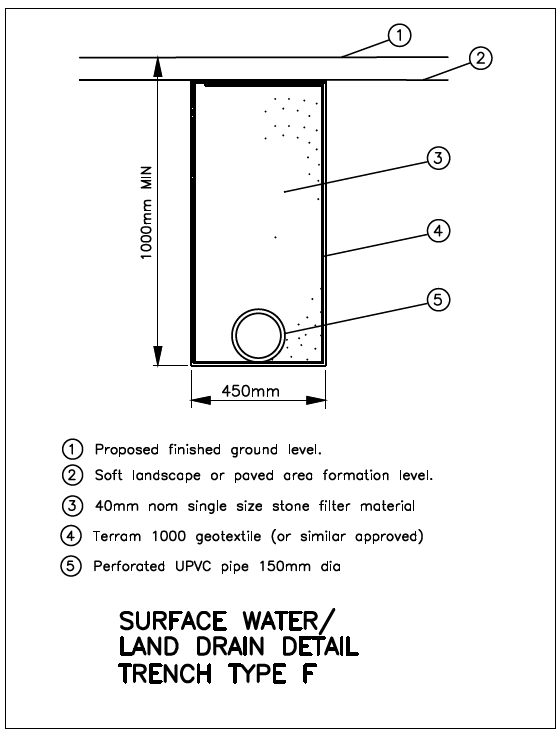

Tony K Posted June 9, 2021 Share Posted June 9, 2021 Evening all. My SB is built into the corners of my small plot, and has required me to excavate the footprint down about 800mm. Inside this area a host of steel screw piles have been inserted, and we are now beginning to create the slab. It's clay soil. The recipe for the slab is 50mm of concrete blinding laid on the soil, then 225mm of cordex (collapsible void former) on top, then the rebar gets attached to the pile heads, before the whole area is filled with concrete. Despite draining the surface several times, and the recent hot weather, the surface remains very boggy. We believe that though the clay is largely impermeable, some small amount of water is getting through - a white line is visible towards the base of the excavation walls which I presume is salt or something. Above the line the clay walls are bone dry, whilst below they are damp. This makes it hard to dry out the surface, and when we walk in it we sink in up to our ankles in places. This makes it hard to progress. We need the blinding to be solid enough to walk about on for a month or so while we build the rest of the slab, but as it stands the blinding will be pushed down into the bog when we walk on it. Possible solutions range from digging a ditch along the side and trying to drain from it, to extra deep blinding, to boarding the area prior to blinding it. One friend has suggested use of some kind of coir matting with crushed concrete over the top, though neither of us has any experience of this. Anyone faced and solved this problem before? Any ideas gratefully received as usual! Thanks Link to comment Share on other sites More sharing options...

Tony K Posted June 10, 2021 Author Share Posted June 10, 2021 8 hours ago, Temp said: My builder used loads of limestone hardcore to stabilise our clay site. He effectively built a road along one side so vehicles wouldn't churn up the place. Thanks @Temp We had considered this option. Not cheap, but might be worth it. A geotextile firm I spoke to this morning didn't have any obvious solution they could offer. Link to comment Share on other sites More sharing options...
Jilly Posted June 10, 2021 Share Posted June 10, 2021 (edited) I'm on clay too and it veers from what you describe, knee deep mud, to setting like concrete. Is there any chance there could be an underground spring keeping the land wet at the moment as it's been pretty dry and we are in a concrete phase? I would second placing the aggregate over a geo textile (coir will rot eventually) and I'm led to believe its better to do this job when the ground is drier as it seems to work better, as when it's wet, the clay can seem to swallow it (without the geo textile). It might be worth speaking to a local drainage engineer. Edited June 10, 2021 by Jilly Link to comment Share on other sites More sharing options...
Ralph Posted June 10, 2021 Share Posted June 10, 2021 We had to put down tons of hardcore and dig a drain to get the water away. Ended up putting in a pipe and filling in that ditch with hardcore to keep the water away. There was no way the machinery would have coped with the level of clay mud. Link to comment Share on other sites More sharing options...
George Posted June 10, 2021 Share Posted June 10, 2021 With clay sites you have to put stone down - think about where patios/gardens will be so you can just put it down and leave it. Dig down 150mm and stone up. Any type 1 stone would work as well as limestone. A 6" layer of stone won't sink unless something really heavy is on top. I'd also consider encircling the house with a French drain, or at least sloping the ground away, but that depends more on the surrounding elevation/geography whether that's really necessary. 1 Link to comment Share on other sites More sharing options...
joe90 Posted June 10, 2021 Share Posted June 10, 2021 5 minutes ago, George said: I'd also consider encircling the house with a French drain, +1, my builder did this, we are on heavy yellow clay and the water table can almost reach the ground level in winter. We encircled the house and the garage with French drains and piped it into a nearby ditch and have had no problems since. Link to comment Share on other sites More sharing options...
Tony K Posted June 10, 2021 Author Share Posted June 10, 2021 Thanks all. I'll try leveling the surface with the digger and creating a moat around its edges, just inside the excavation walls. I will pump any water away from that moat over the weekend and see if the main surface dries out properly. Then I'll consider extra material and possibly a matting underneath. Link to comment Share on other sites More sharing options...
IanR Posted June 10, 2021 Share Posted June 10, 2021 6 hours ago, George said: I'd also consider encircling the house with a French drain, +2 We installed a perimeter drain all the way around our build, going to below the foundation level. There were numerous seams in the clay with water constantly running through them. Link to comment Share on other sites More sharing options...
Tony K Posted June 10, 2021 Author Share Posted June 10, 2021 I doubt I could have a French drain around the house. It's built into the corners of an urban plot, so I've no space outside for it, plus the design has the slab backfilled around the edges in what I think they call a fit and forget arrangement. I will set up a temporary moat drain inside the footprint and try to save the cost of extra hardcore etc. Link to comment Share on other sites More sharing options...

Dave Jones Posted June 11, 2021 Share Posted June 11, 2021 talk to the people you use for muck aways they often sell cheaper recycled stone. Dig down 250 if you can and base of 150mm of 40-70mm clean, roll or wacker than top it off with 100mm of type 3 (recycled is good). Link to comment Share on other sites More sharing options...
