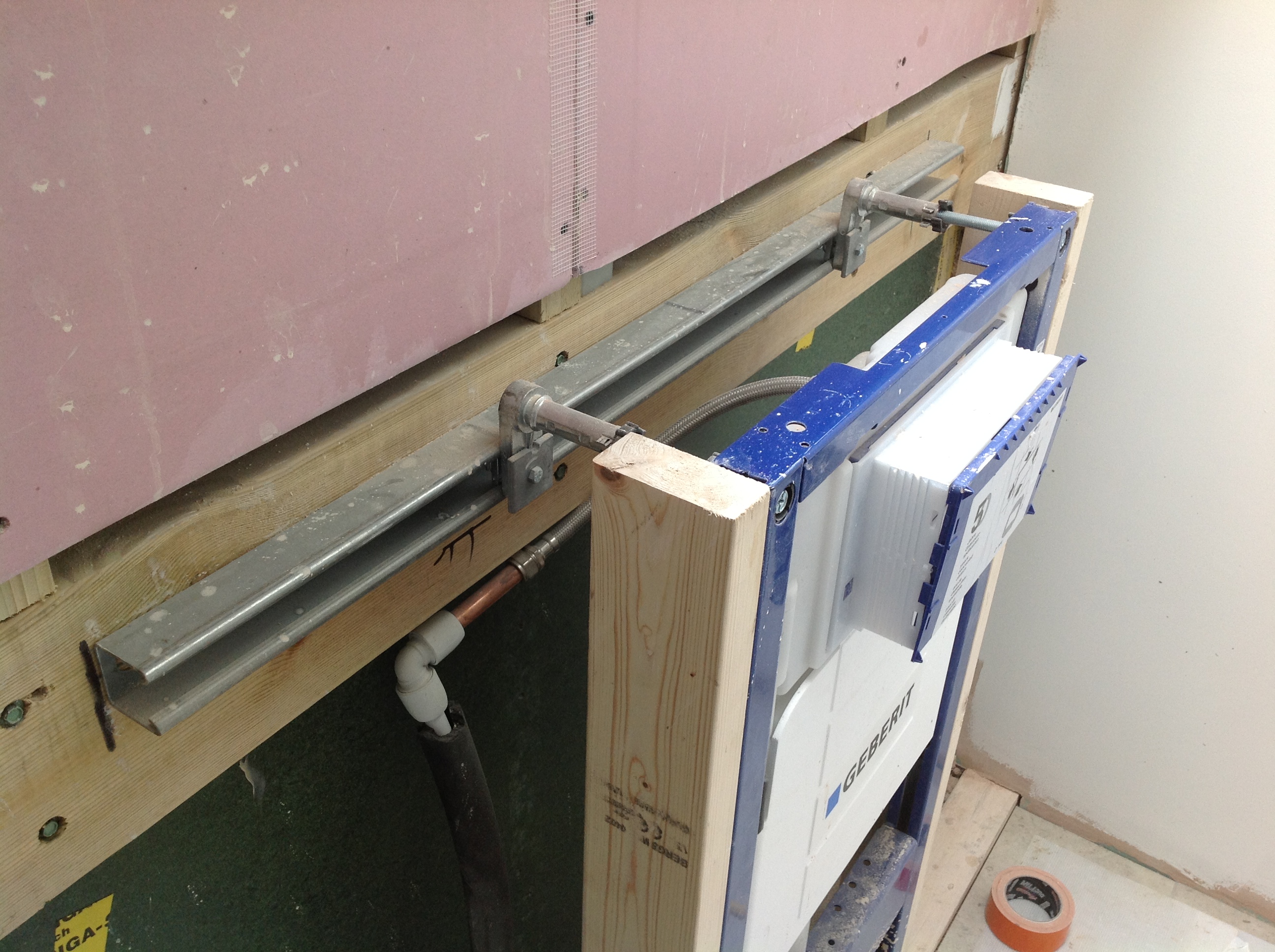

ryder72 Posted March 8, 2017 Posted March 8, 2017 The build up on our MBC single stud timberfrme house is 140mm stud filled in with PIR insulation, airtight membrane, 70mm PIR insulation, 38mm studs, plasterboard. We need to get 3 WH toilet frames fitted. MBC's recommend is to fix the frame to the 38mm studs which line up with the 140mm studs and are screwed together with 150mm screws (effectively around 42mm deep fixing into the 140mm stud). My plumber is not at all happy with this idea mainly because this fixing is through a 70mm PIR insulation layer and instead wants to put in one 60mm timber between the 140mm studs and a second one between the secondary 70mm insulation layer. This will ensure that the whole structure is connected right through and very secure. Does anyone have a view on a robust way to fix this?

TerryE Posted March 8, 2017 Posted March 8, 2017 Keep it simple stupid. Timber fixing the studs to the 140mm studs through the top PIR will do bugger all in terms of compromising the thermal characteristics and is nice and simple -- so I would vote for the MBC suggestion. One thing that I would question is the 38 mm. If you are using the Geberit-style cisterns then they need 100mm depth though I think that you can get shallower ones. I didn't think that you'd want to start cutting these into the 70mm PIR layer but one reflection, I'd consider doing this if it were my house. So I would just fix the Wall Hung frame direct to the underlying MBC suggests.

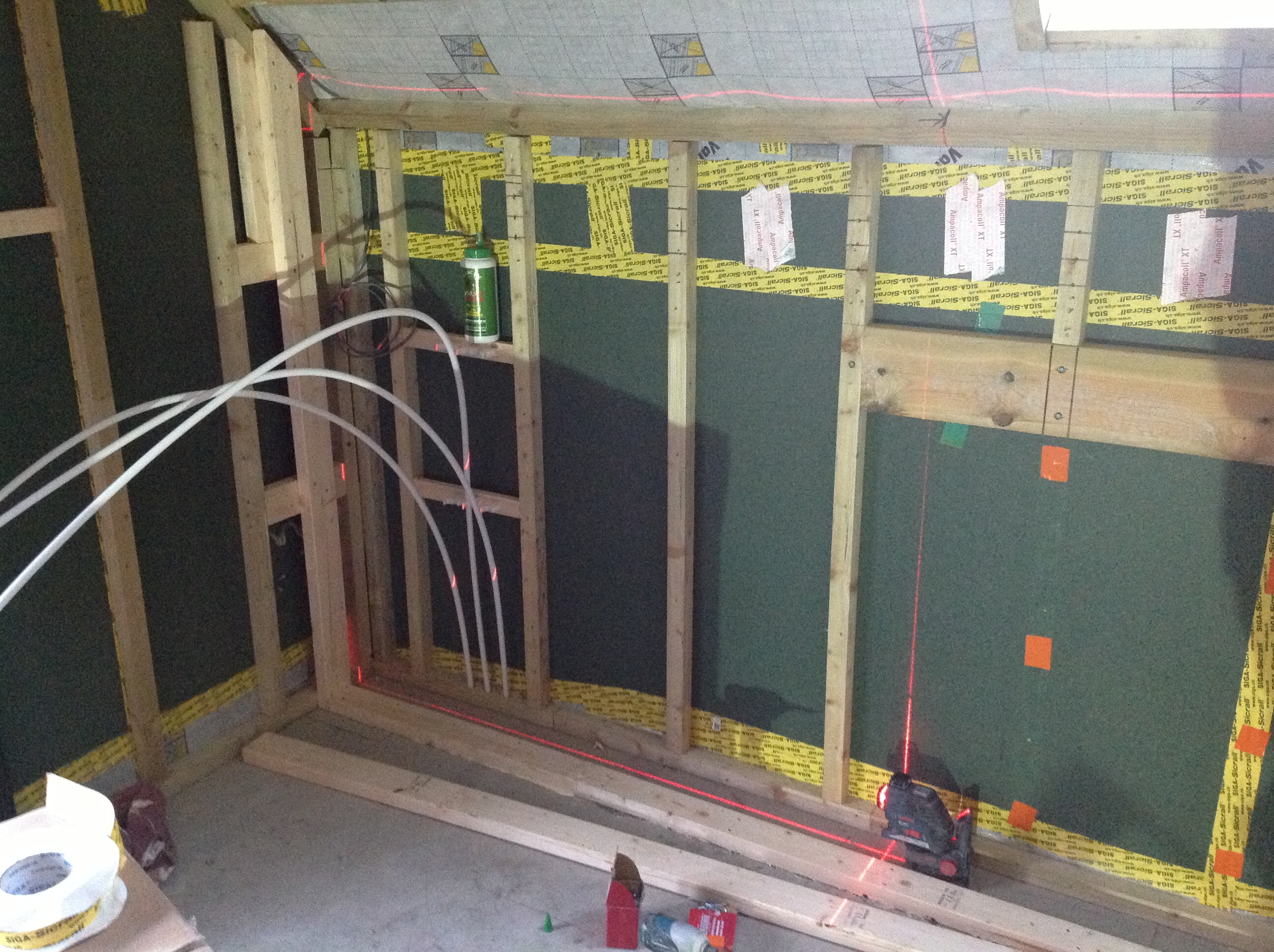

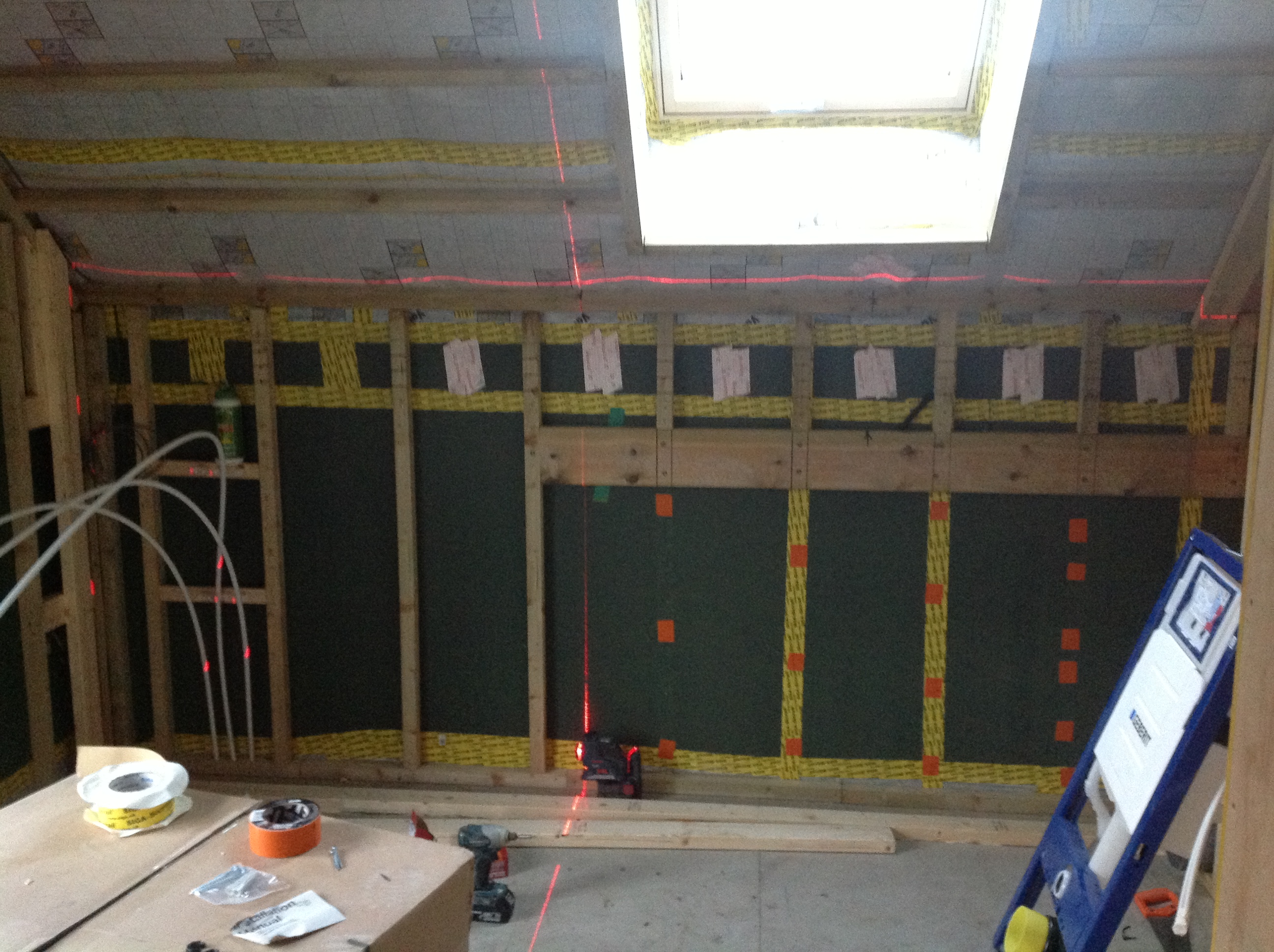

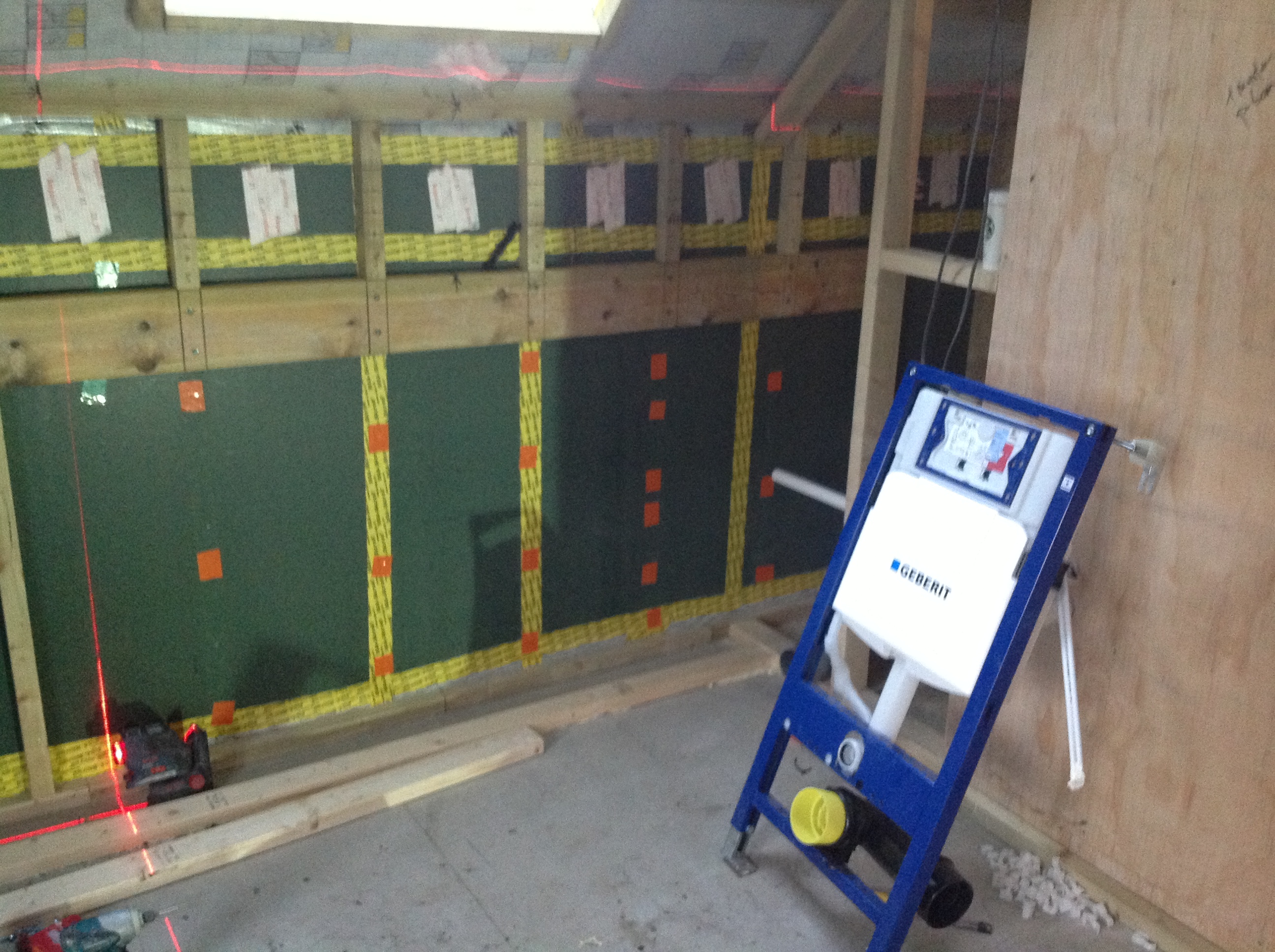

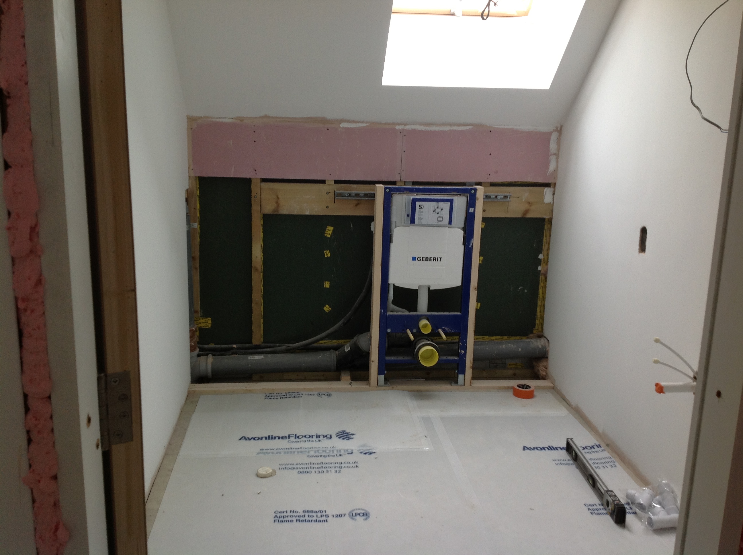

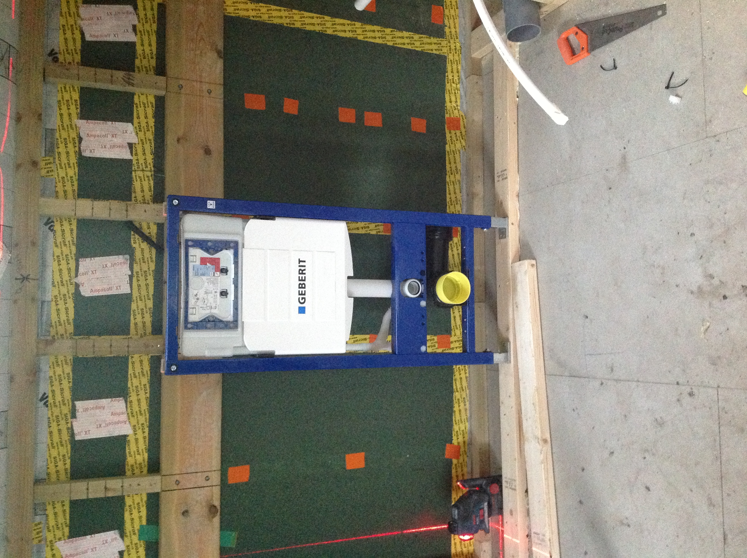

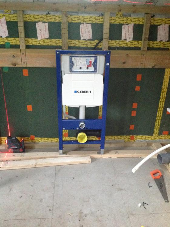

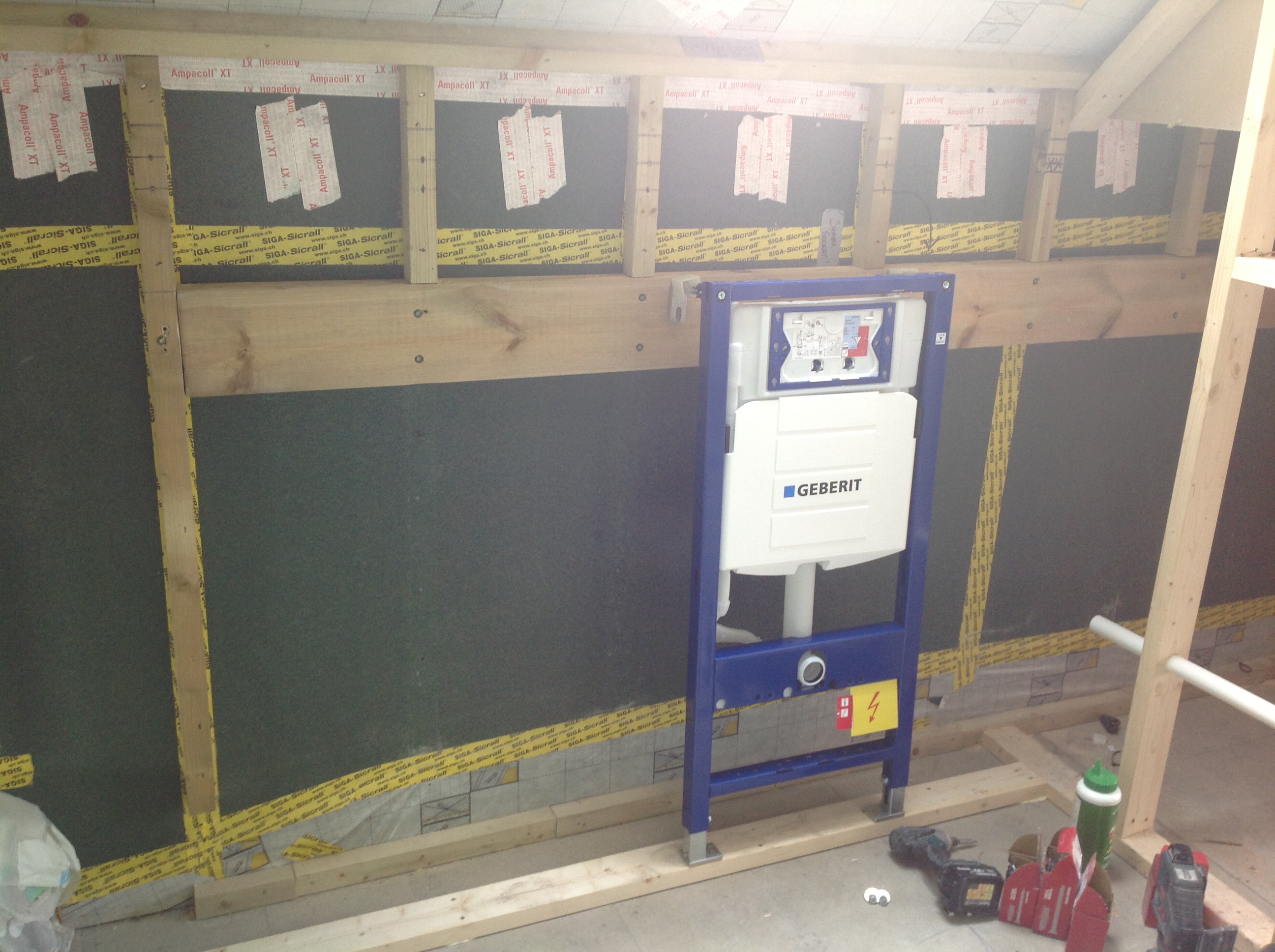

Nickfromwales Posted March 8, 2017 Posted March 8, 2017 This is how I did them . Have a look, and I'll add some details tomorrow. 2
Nickfromwales Posted March 9, 2017 Posted March 9, 2017 @ryder72 Will your WC's be as I've pictured, eg, part height with a shelf top, or will your framework be floor to ceiling ? Do any cables or other services already reside in the counter batten spaces in the bathrooms ? I need those questions answered tbh so I can advise further, without going off down the wrong route, but at the moment I'd be looking at removing the 70mm PIR and removing all the 38mm counterbattens, and then over boarding the whole wall with 25mm ply, screwed through to the 140mm frame with 120mm self cutting heavy duty wood screws, repeated at 200mm centres. Then fix the frames directly to the plywood. ( The point that takes all the stress is the top fixings of the frame which go back to the wall, and there's a lot of 'pull' on those. If those dont get fixed properly then the frame will move and the plasterboard and tiles will move with it ). After the frames are fixed, refit the 70mm PIR over the plywood, around the WC frame, and you'll then gain around 83mm of floor space back to the room too. Is that an option? 2

Nickfromwales Posted March 9, 2017 Posted March 9, 2017 Let's answer the op then. If the 38mm battens are through fixed at regular intervals where the WC fixings reside, then I see no issue, but it is a lot to ask at such small points TBH. Adding a horizontal wall plate, as I've done with 7" timber in my pics, would straddle 3-4 of the 140mm frame studs and give you some serious rigidity. Show your plumber the pics and see if he is OK to cut sections of the counter battens out and fit a similar plate arrangement. For belt and braces I then fitted the 40x40mm UniStrut and punched timber locks through the UniStrut, wall plate, air tightness OSB layer and into the frame studs. To demonstrate how good these fixings were, I stood on the front edge of the extra long projecting WC pans, after mounting them to the frames temporarily through a disposable plywood baffle ( to represent the PB and tile layer ) and bounced up and down on them. You could park a car on them ( 3 X WC's on that same elavation ). 1
ryder72 Posted March 17, 2017 Author Posted March 17, 2017 I will post some pics of what we have done later today. For reference- BEtween 140 studs we have 1 layer of 70mm PIR. In front of this is fixed a 140*38mm timber between the vertical studs so we have the weight of the frame/toilet/user to atleast 3 vertical studs. In front of this will be the membrane will be a 70mm PIR layer and then 38mm studs. We will be cutting out the PIR and replacing it with more 140mm timbers fixed horizontally to the studs or previously fixed timbers ensuring there is complete timber to timber contract into which the frame will be fixed. Having looked at Nicks solution, I can see how this would have also worked if the 140mm timber went across multiple studs, but I also suspect I might not have got it past 4 studs given what else is going on in the bathroom Thanks very much for your help guys.
