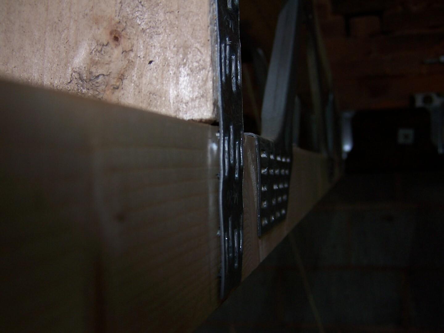

I sent over pictures and simply asked if the fixings were ok. His reply was that it's really difficult to get things perfect on their machine. My understanding there was that he thought they weren't perfect.

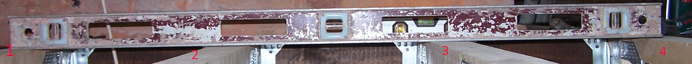

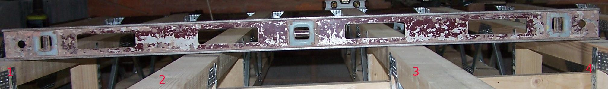

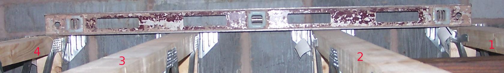

Here are pictures showing the upward bow in joist 3. Joist 2 in these pictures is the corkscrew. I've numbered the joists in the pictures to indicate when I switched direction.

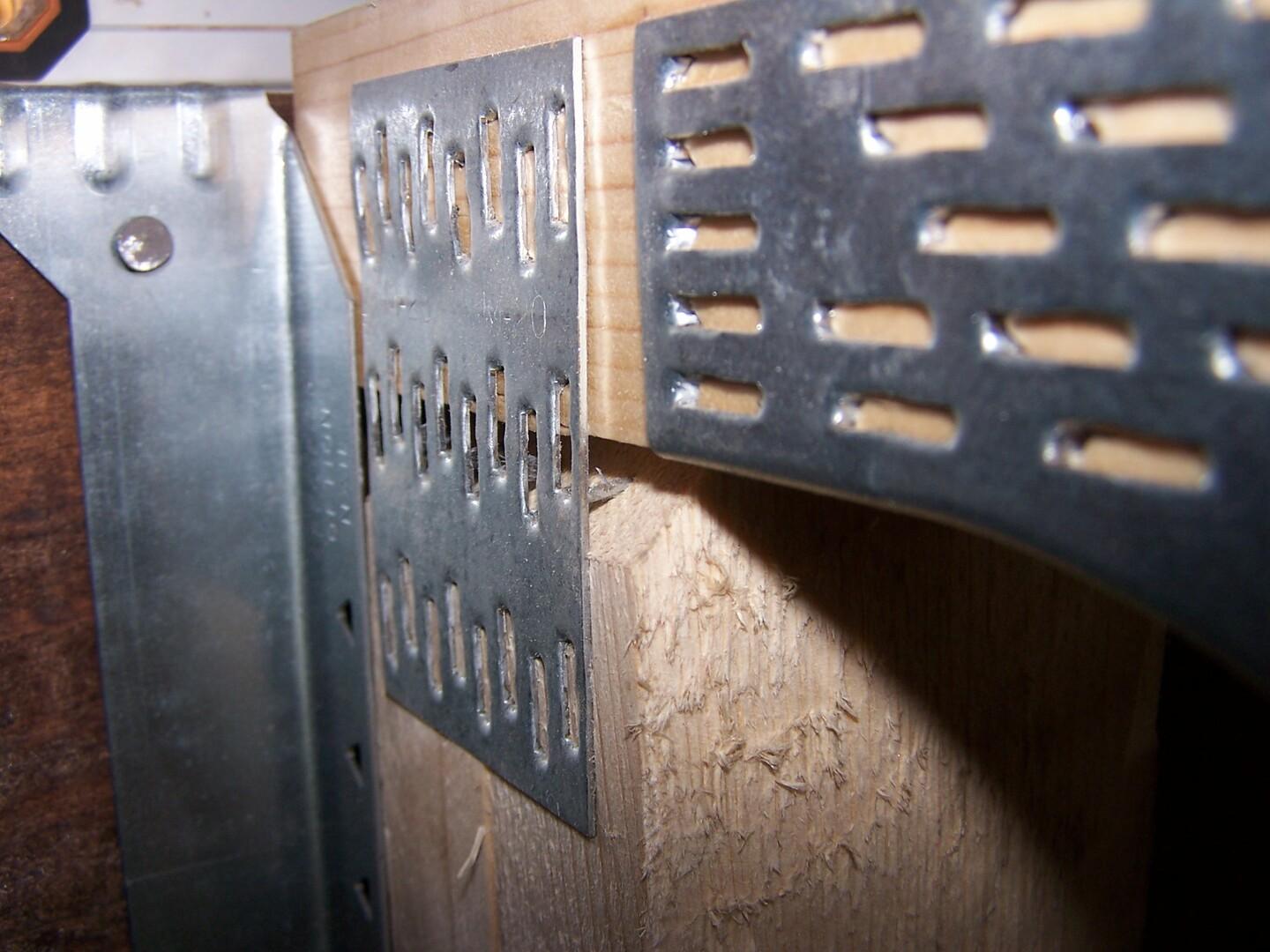

Some pictures of the fixings shortly.
I cant see anything wrong with them, as mentioned previously they are wood and wood moves. Once the noggins and floor are fixed it will all act as one unit instead of individual components.

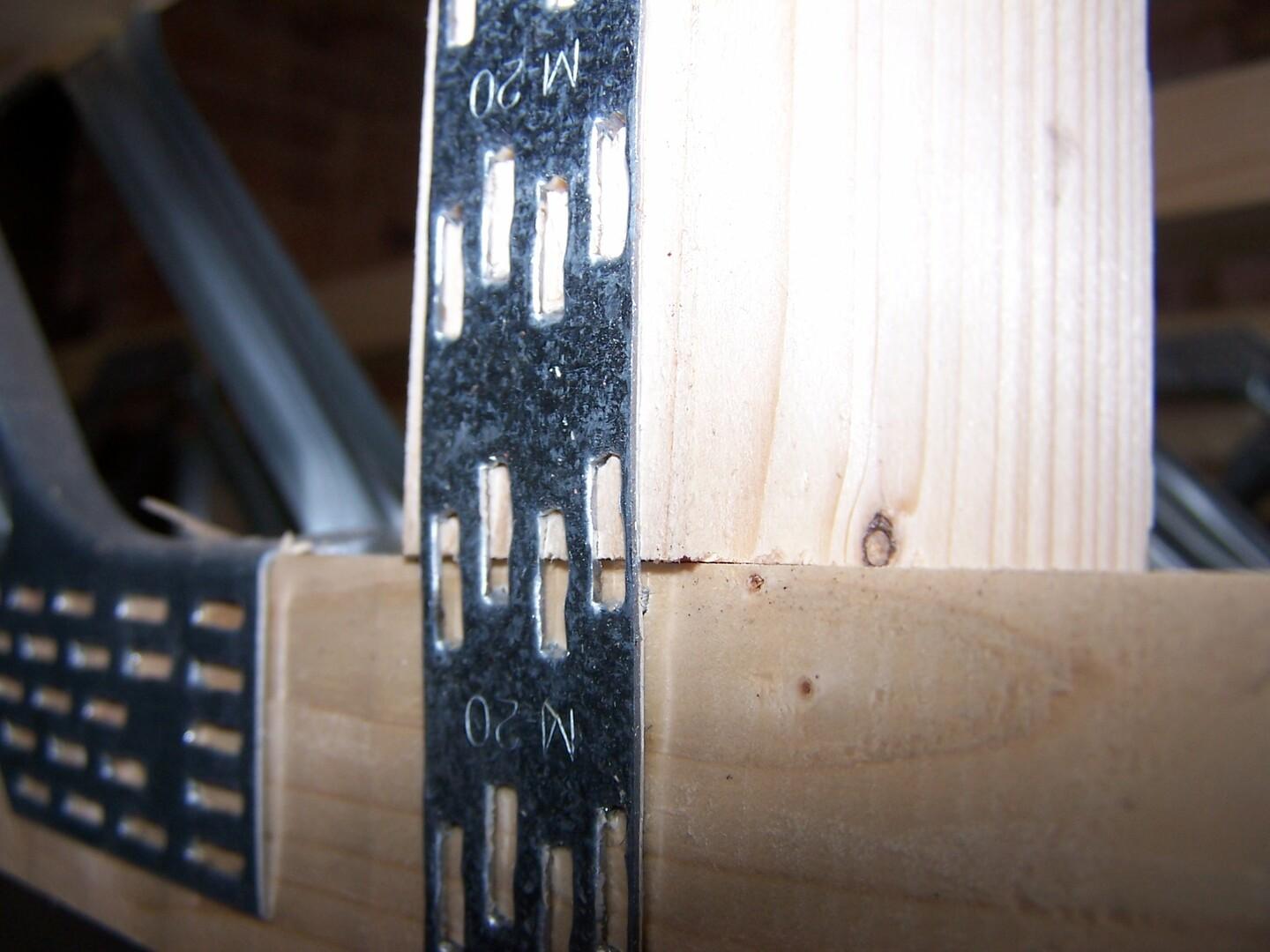

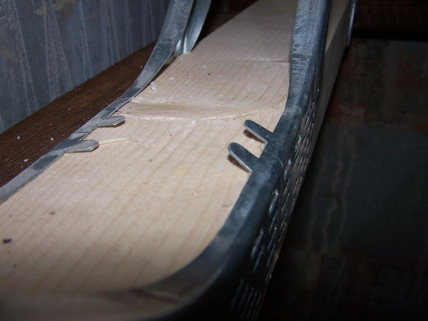

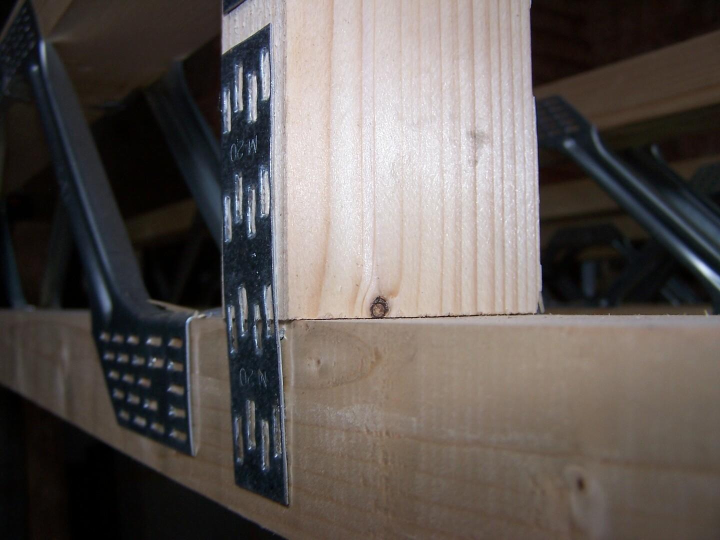

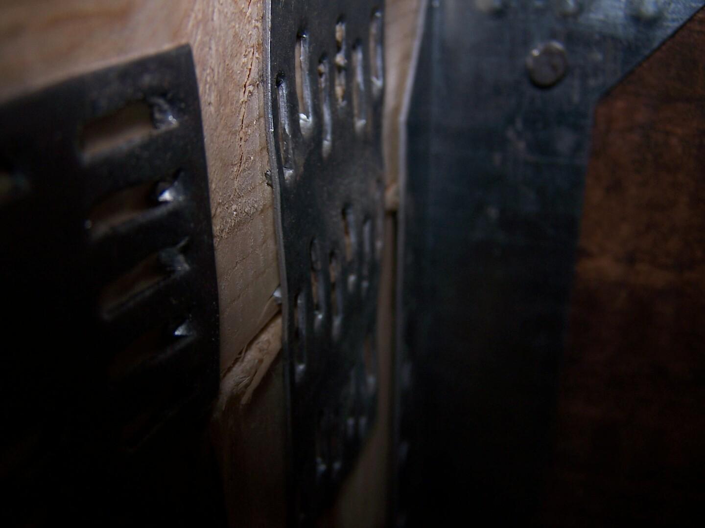

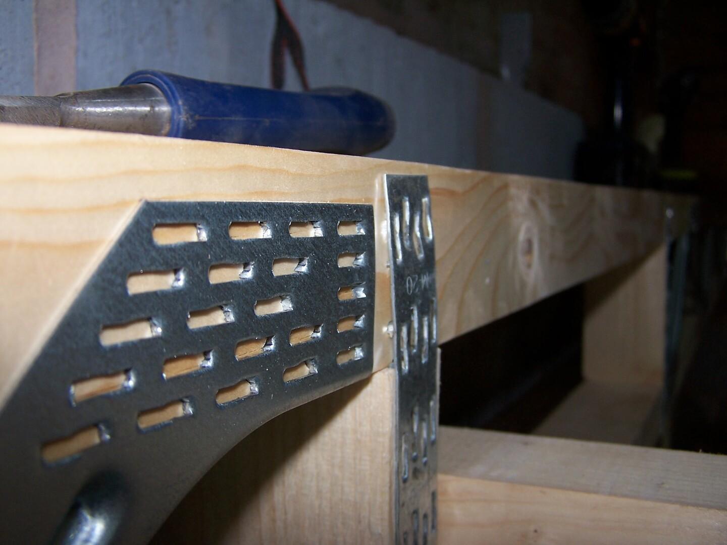

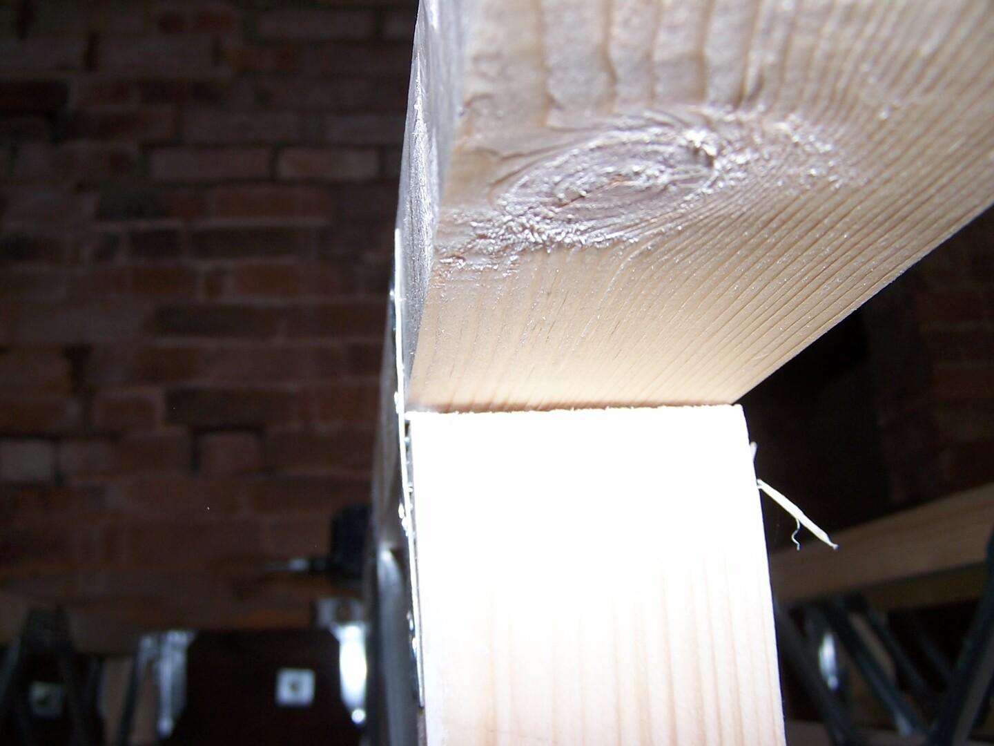

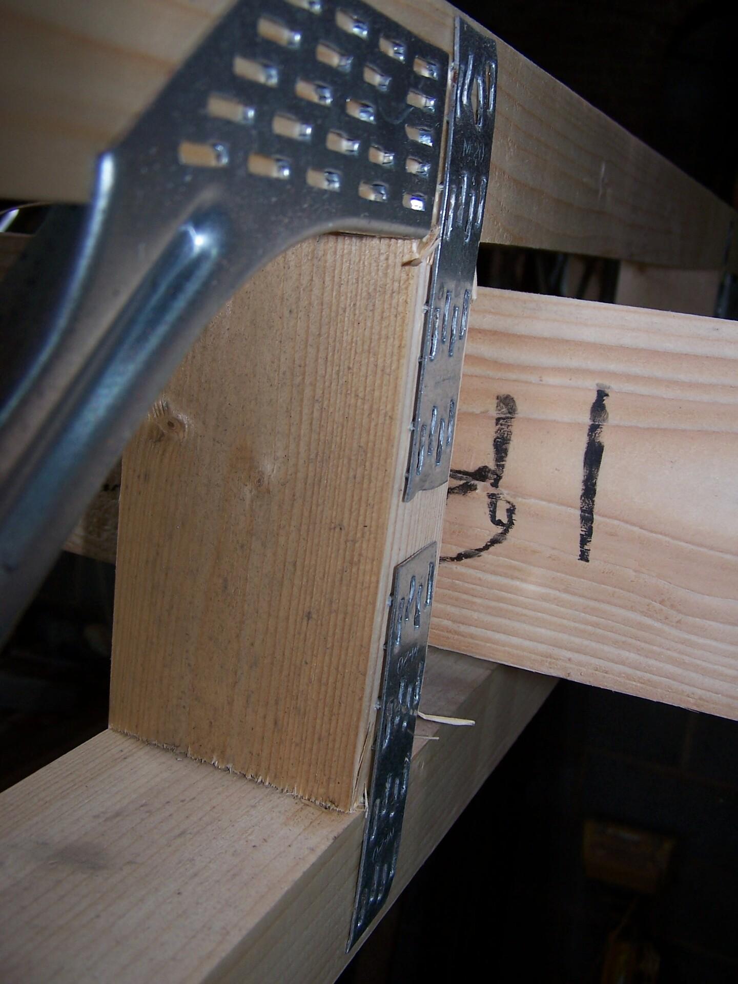

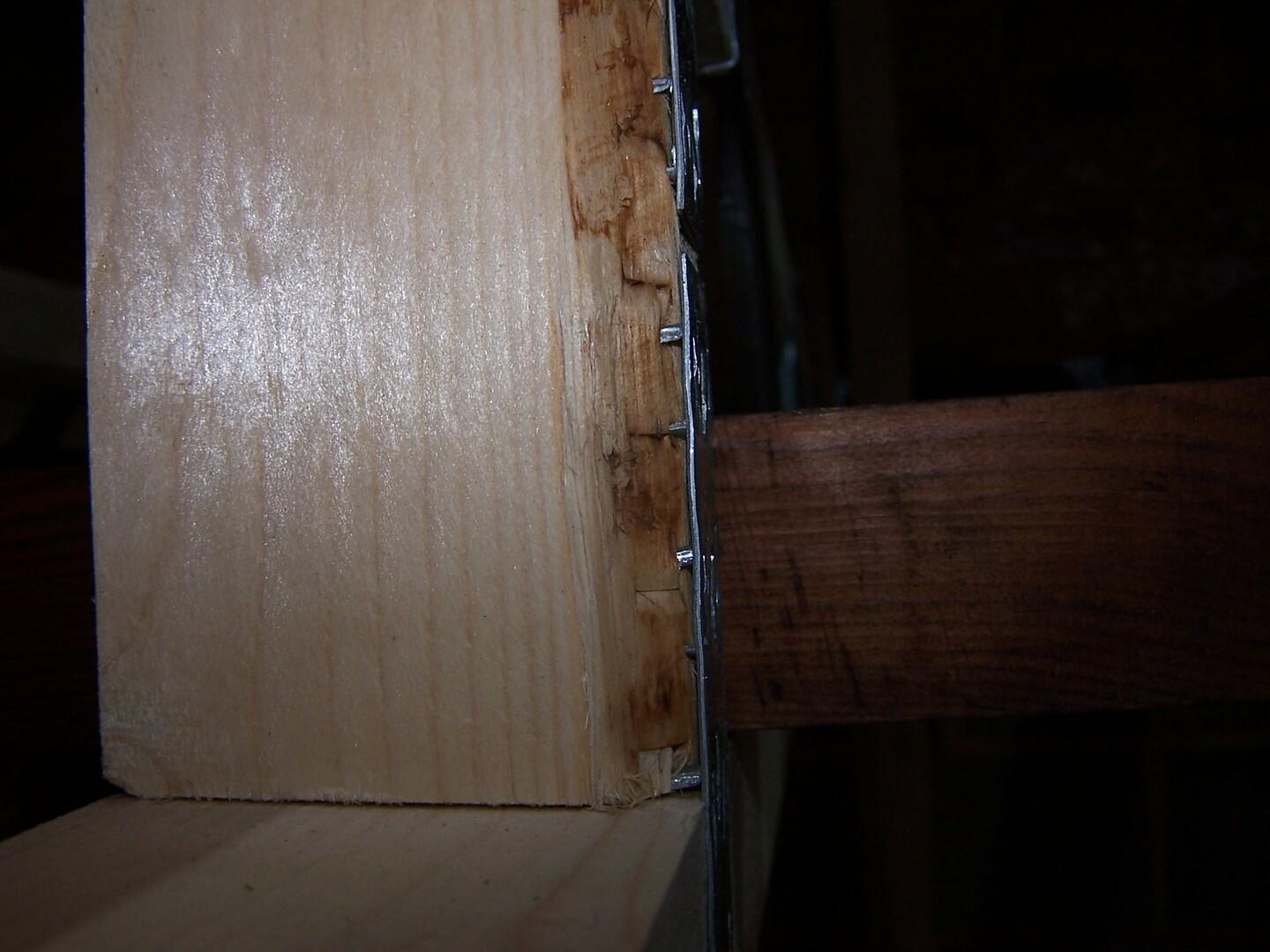

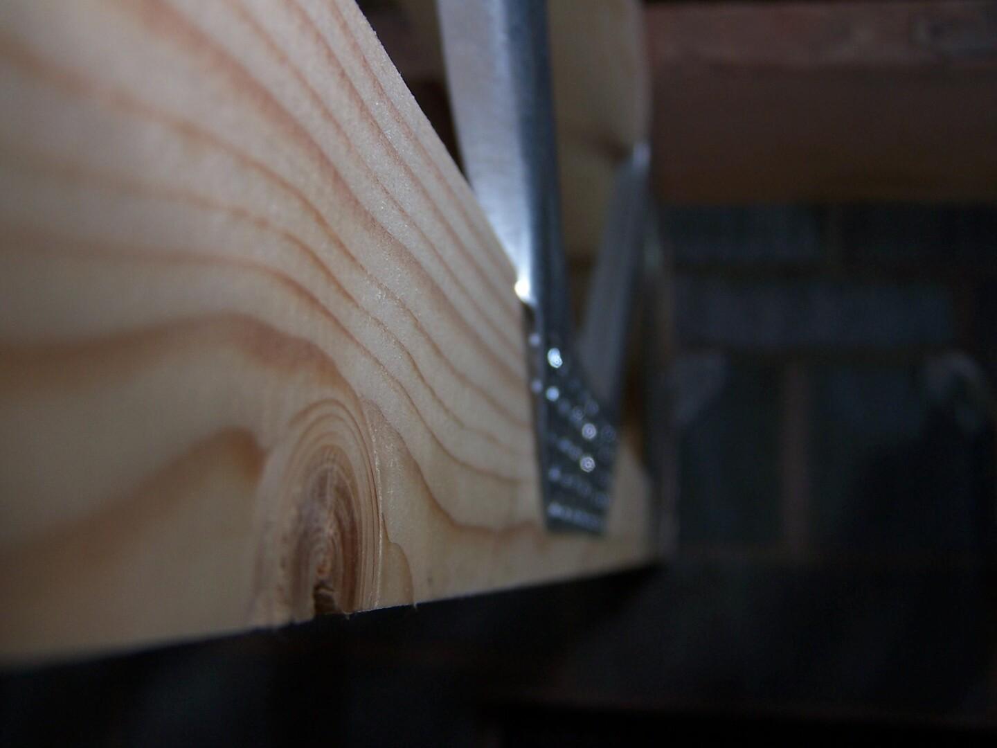

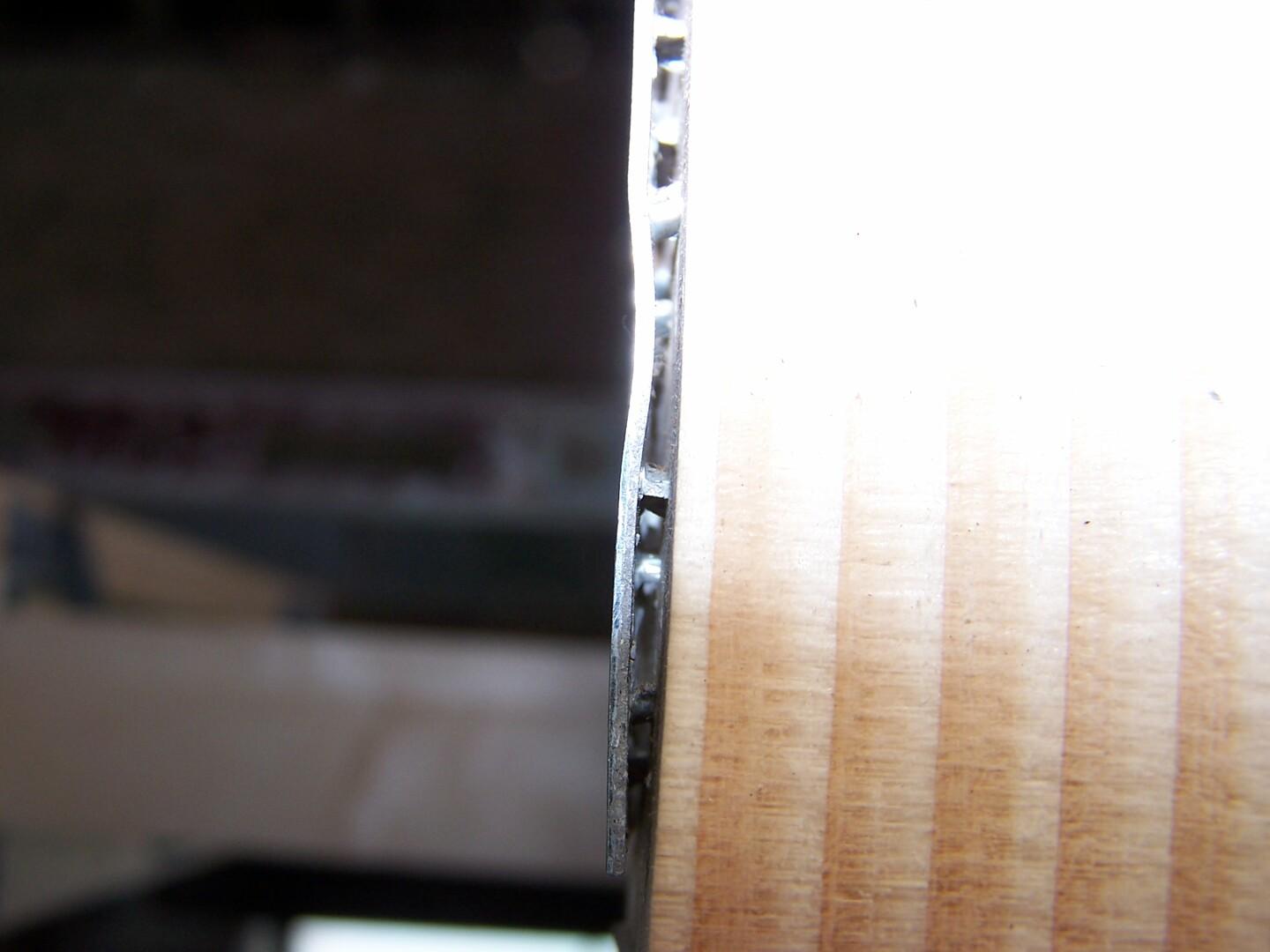

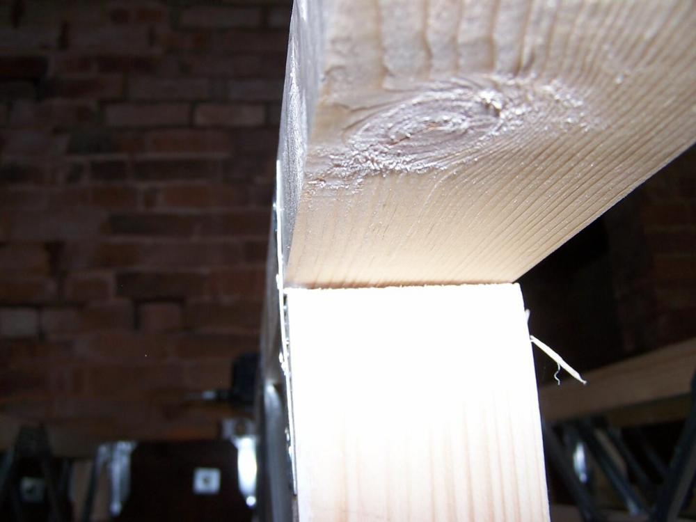

Here are a few examples of what I consider imperfections. The camera doesn't show them to be as stark as the eye.
They don't look great.  I have never really thought about joist quality varying by manufacturer.  Is this Mitek?  Could you ask them to confirm that they are to standard?
@Digmixfill that strongback hasn’t been correctly installed and nailed to all the joists by the looks of it - that needs resolving and then you need the floor noggins (use Z Clips) and then the boards glued and screwed.
Then decide how much deviation you have in the floor as it will be negligible.

I'm running noggings wall to wall at 1/3rd span. Then I'll add the end chord restraints with zclips. After that i'm going to place noggings in the lower chords to fix any joist twist. Finally I'll nail the strongback in place. Overkill I know.
Caberdek, screw and glue after that.

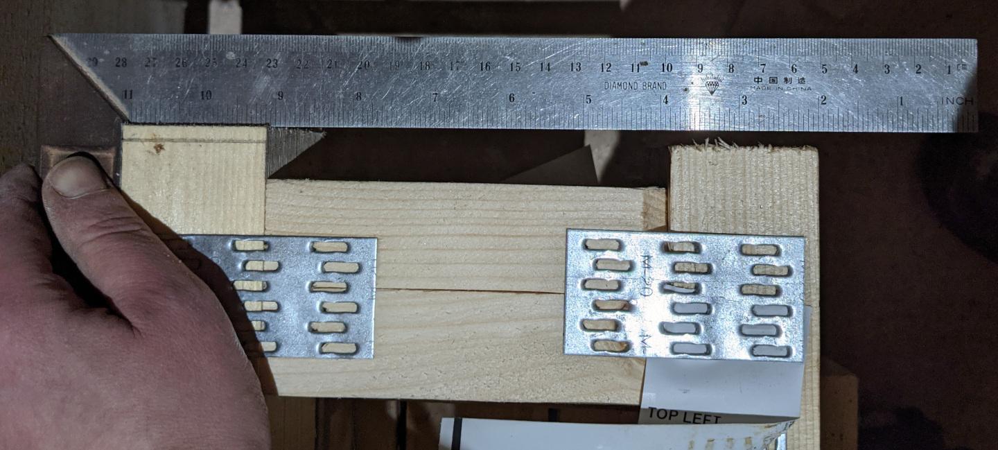

Yes Mitek. Long before I ordered the posis I asked Mitek what their tolerances were. An engineer replied back to say +/- 1mm for length. Most of the posis here arrived as parallelograms, way out of tolerance. At the masonry end they are fixed with Simpson FMS straps, so even if Mitek offered to replace them all it would be a pain to remove them.
The tolerance on a block is +/-6mm so why are you stressing about this ..?? Get the strong back in properly then do edge noggins and get the floor down and I reckon you will be +/-2mm across the floor.
I'm not stressing about this. I've squared them up, sorted for best match to length required and they're in place.
The individual chord lengths were within the +/- 1mm length, but top and bottom chord on some were offset by > 5mm.
Do you think it unreasonable for me to expect a joist to have at least on square end?
