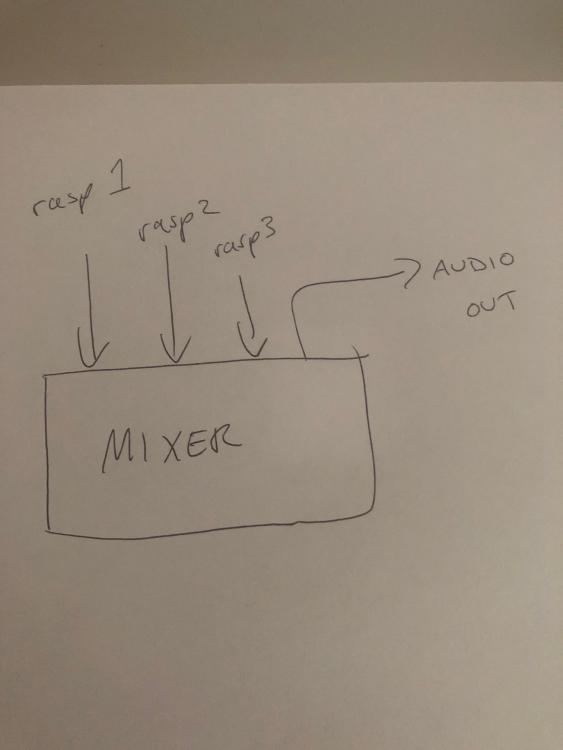

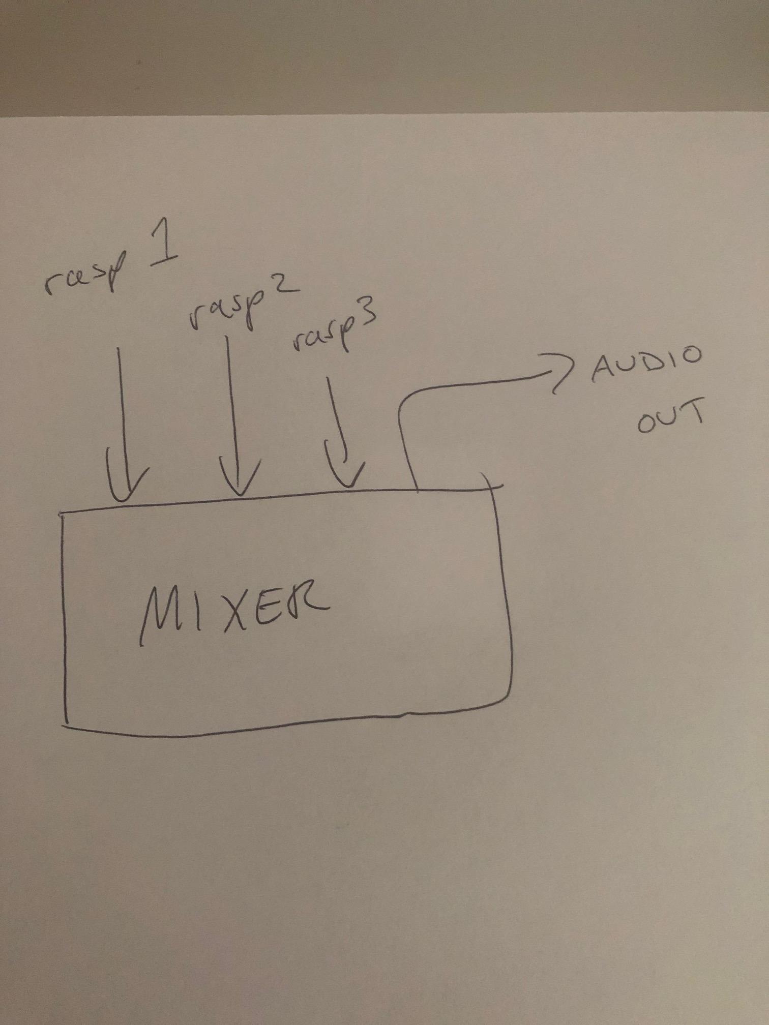

Pocster Posted June 7, 2021 Posted June 7, 2021 I've had a few reasonable successes at various ways for a doorbell sound to pause or interrupt any audio playing on the whole house audio system. But none work exactly how I wish. SO! Is this type of thing possible? 3 Raspberry pi's with amps provide the audio input - but just one set of speakers for output. It would be nice that some of the input's can be 'mixed' and some are muted. For example If rasp1 is the doorbell audio that could be mixed and be audible with say rasp2 i.e. doorbell audio and music simultaneously . But if rasp3 plays ( this is a voice announcement ) I would want it to silence rasp2 i.e. so just the announcement is made no audio from rasp2. I can see various cheap ebay/amazon type mixers but not sure if I can 'configure' which inputs can be mixed/muted. Anyone understand what I am asking???

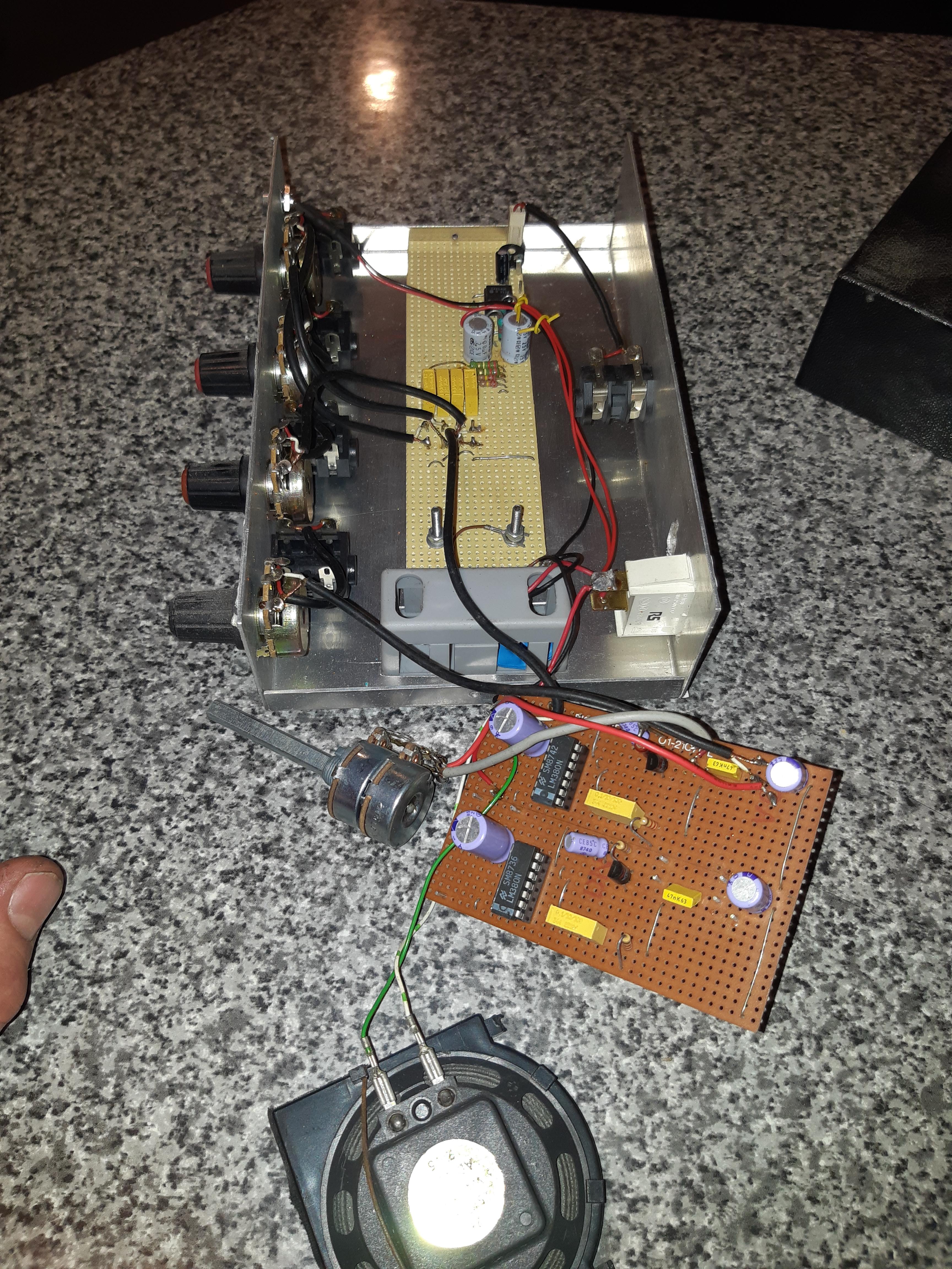

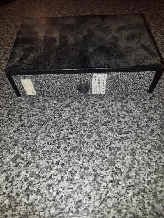

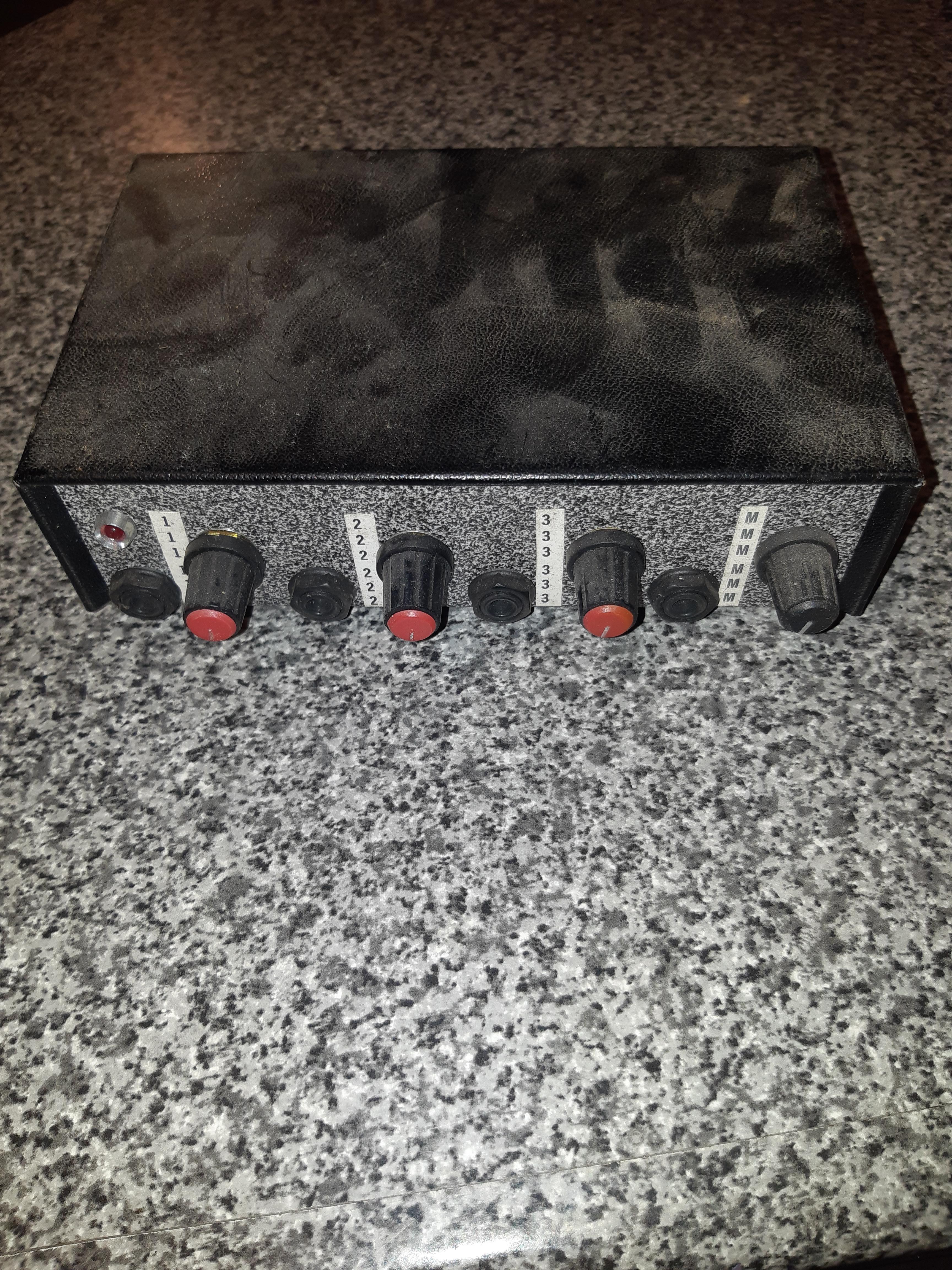

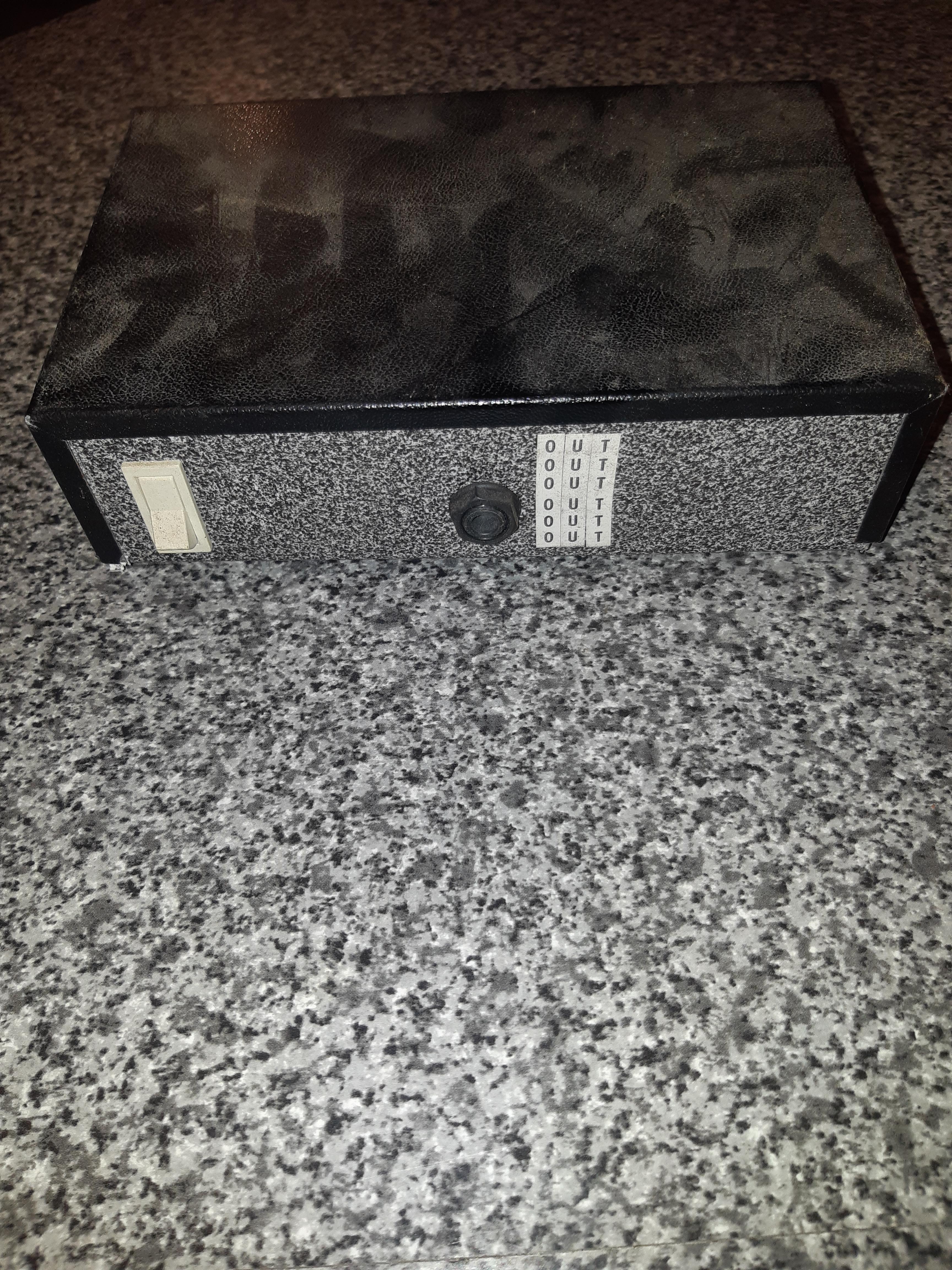

Onoff Posted June 7, 2021 Posted June 7, 2021 Gotta love a posho with too much money, over complicating things! Here's one I made earlier...like 40 years earlier. Based round a CA3140E op amp. Looks like I added a little amp at some time... What's a little hum between friends? ? 2
