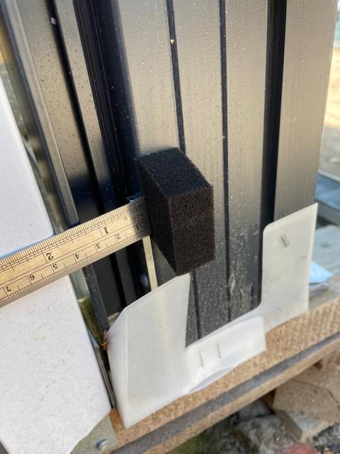

...so now speaking from experience....
Plan A was to use the Illbruck TP600 product mostly in the 8 to 15mm size (and 20mm width). I bought 19 rolls ?. Stored it for at least 24 hours in the fridge, then took one roll at a time to the window in a cool bag. Ambient temperature was 15 to 20 deg C. The experience was really poor - despite the cooling, the product expended so rapidly I could not get decent lengths in correctly. As I cut off a length from the roll, I applied a clip and put the remainder back in the cool bag. I ended up wasting a significant portion of each roll. In the end I used it only for gaps that were 10mm+ and uniform gaps at that.
I purchased more of the Pro Clima CONTEGA FIDEN EXO product, which expended much more slowly - giving time to get the product into the gap effectively and neatly. When fully expanded, the Pro Clima CONTEGA FIDEN EXO product has a darker appearance that the TP600 and if anything feels to be more impregnated.

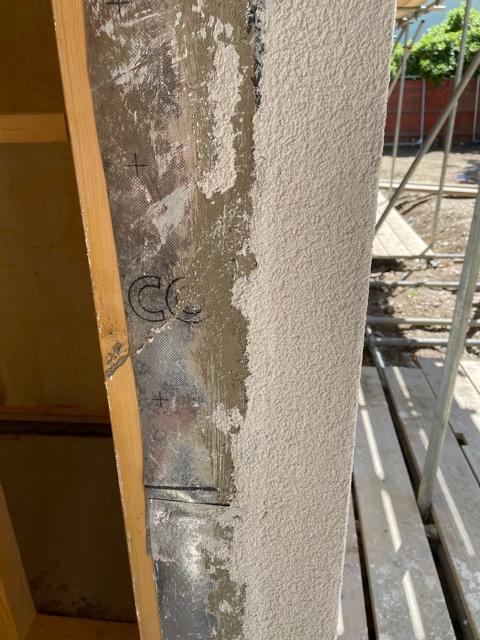

A note on gap sizes:
Our gaps were designed to 12mm for most windows (with wider cill gaps in some cases). In practice the gaps tended to be slightly smaller as the render could be slightly proud of the timber frame opening, especially where the render overlapped with breather membrane in the window reveal as pic...
So basically the gap to seal could be as low as 6mm in practice and in some sections even narrower. With the Pro Clima CONTEGA FIDEN EXO product I bought in a wider variety of sizes: 7 to 12mm, 5 to 10mm, 3 to 6mm (and 2 to 3mm but did not use).
A note in Velfac V200E windows - I should start by saying I'm very happy with the quality of the windows. One challenge though when applying compriband is it needs to be pushed some way into the gap - because there is a void behind the outer aluminium profile and the wooden window frame behind it (see pic) and the compriband needs to adhere to the wooden frame. This is especially challenging when the actual gap is less than the 12mm designed.

I agree that with Velfac the Compriband is easier with bigger gaps you can get your fingers in, or dry fit the frame, remove, apply tape, chuck back in the hole but on a hot day with a heavy window it can be tricky.  I have used a wide blade scraper to help.
Link to comment
Share on other sites
Yea at some points I was using a 6 inch steel rule and a scriber to compress the compriband to tease it into the gap - but even that is tricky when the gap is so small you can't see what you are doing.

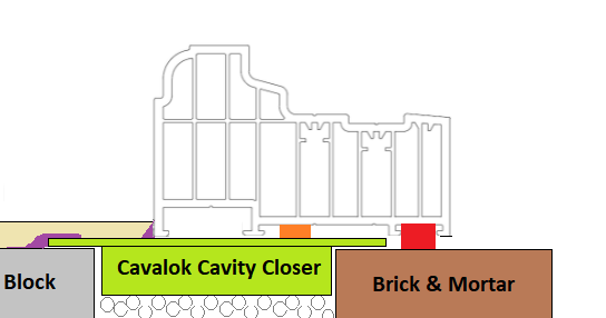

I am a little unsure which width of tape to use. Thickness is fine and to match the tolerance allowed around the frame, but how wide should the tape be? Seems little point for it to be full frame width (~100mm) as all the weather based action is on the outside.
Below is a section of our frame (Residence 9) and I have mocked up some outer leaf brickwork and the cavity closer and inner leaf blockwork. To Seal I have added the following:
  1. RED: 15mm width (5-12) expanding foam tape between two 'hooks' of the extrusion. This forms the weather seal
  2. ORANGE: (optional?) 15mm width (or wider?) (4-9) expanding foam tape (extra insulation?)
  3. PURPLE: Passive Purple airtightness paint or alternatively an airtightness tape
  4. CREAM: Wet skim plaster
Cavity is filled with blown beads insulation.

Thinking about the ORANGE tape, there are two other obvious options below. It could contribute to air tightness, but ultimately the cavity closer also needs to be sealed to the blockwork which obviously can't be achieved by any tape on the frame.
Make it wider:
Move it to where there is another 'pocket' which I think is for the fixing lugs:
Link to comment
Guessing that the lambda value of these sorts of tapes is similar to EPS or Mineral Wool which is 0.03 W/mK. a 15mm wide strip would have a U-valve of 0.03/0.015 = 2W/m2k so may be some value in going wider, but the frame would trap air pockets as well which are similar to the chambers in the frame itself.
The https://www.expandingfoamtape.co.uk/ stuff is vapour permeable which supposedly reduces condensation, not sure how though.
