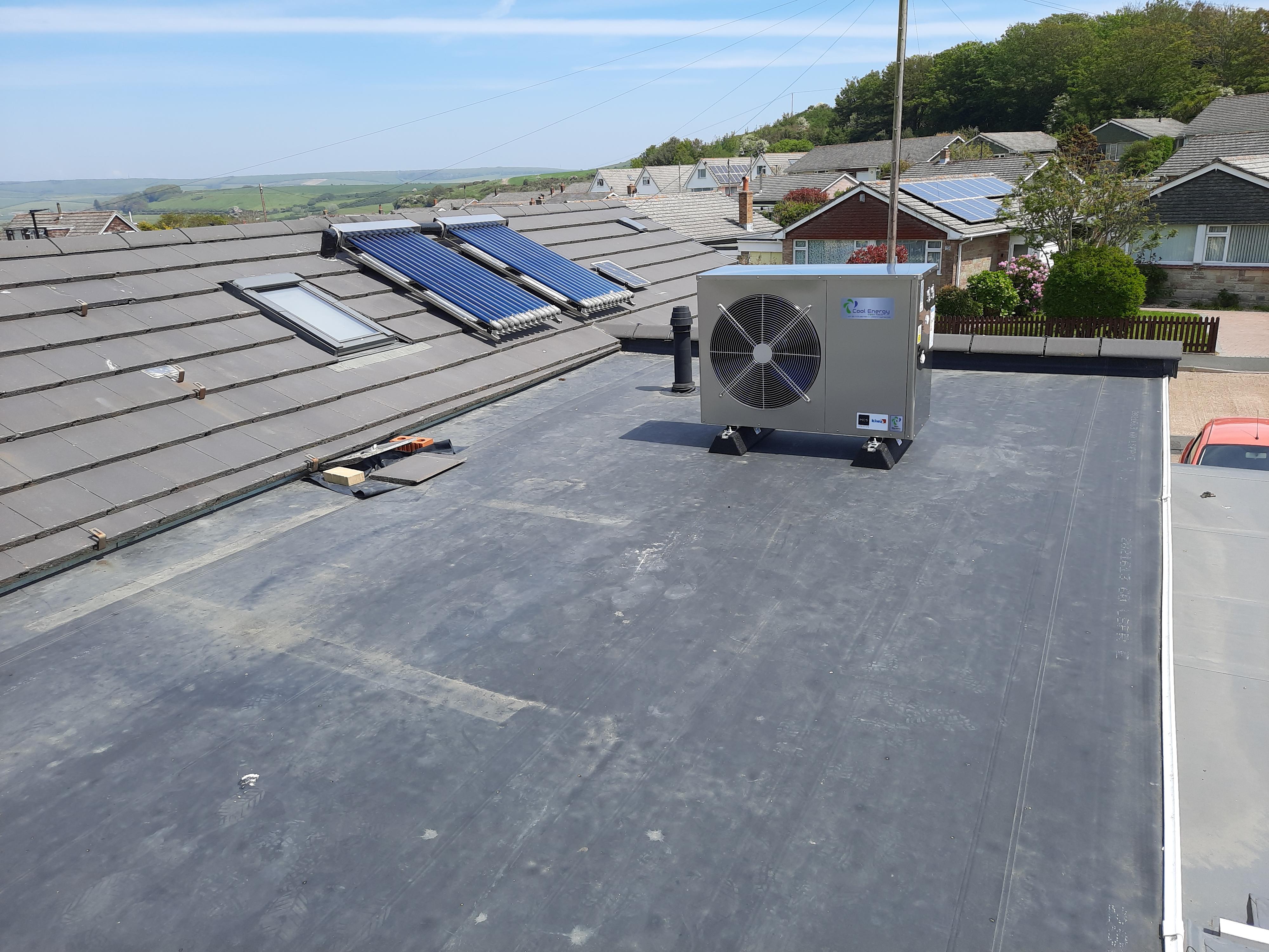

Marvin Posted June 1, 2021 Share Posted June 1, 2021 So, ASHP on flat roof. Boiler going. Now, where the hell do I put the heat pump supply rotary isolator? Link to comment Share on other sites More sharing options...

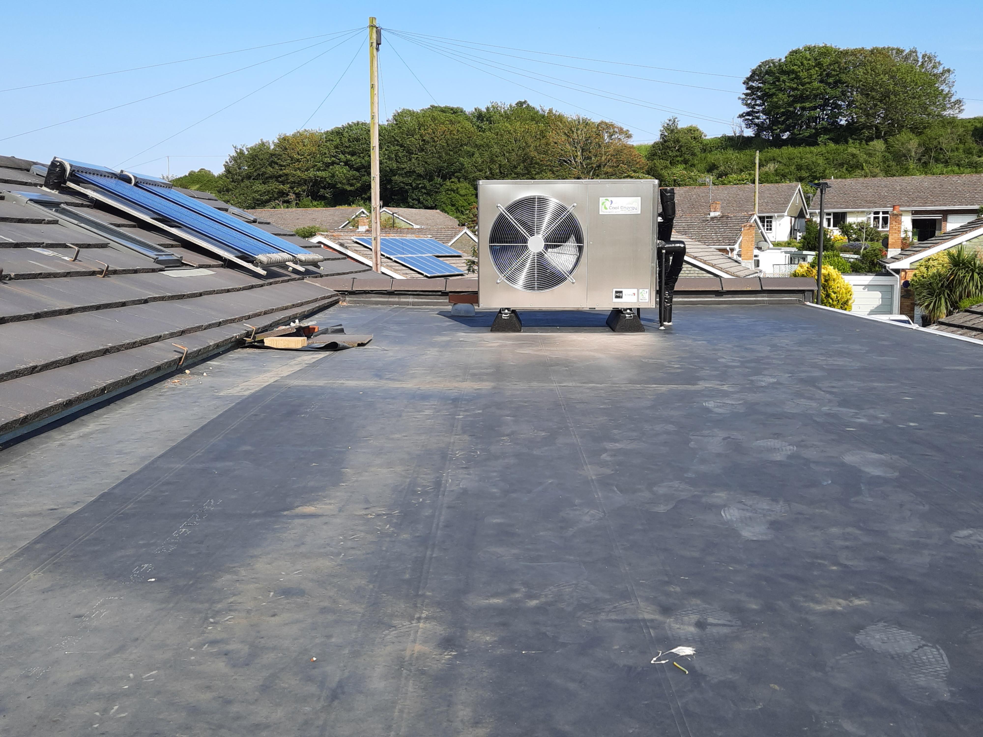

Marvin Posted June 1, 2021 Author Share Posted June 1, 2021 Other view... Link to comment Share on other sites More sharing options...
dpmiller Posted June 1, 2021 Share Posted June 1, 2021 I recognise that ASHP... Just screw the isolator to the side of the unit 1 Link to comment Share on other sites More sharing options...
TonyT Posted June 1, 2021 Share Posted June 1, 2021 As above. or have the isolator internal with appropriate signage, advising of this 1 Link to comment Share on other sites More sharing options...
SteamyTea Posted June 1, 2021 Share Posted June 1, 2021 Is that the best place to site the ASHP, is there a solid wall below it? Link to comment Share on other sites More sharing options...
Marvin Posted June 2, 2021 Author Share Posted June 2, 2021 9 hours ago, SteamyTea said: Is that the best place to site the ASHP, is there a solid wall below it? Good question. Yes the only place below the flat roof that does have a wall across the span. I am also not sure about the insulation being crushed, the EPDM being worn by vibration or the vibration entering the building but will react to these if they arise. Link to comment Share on other sites More sharing options...

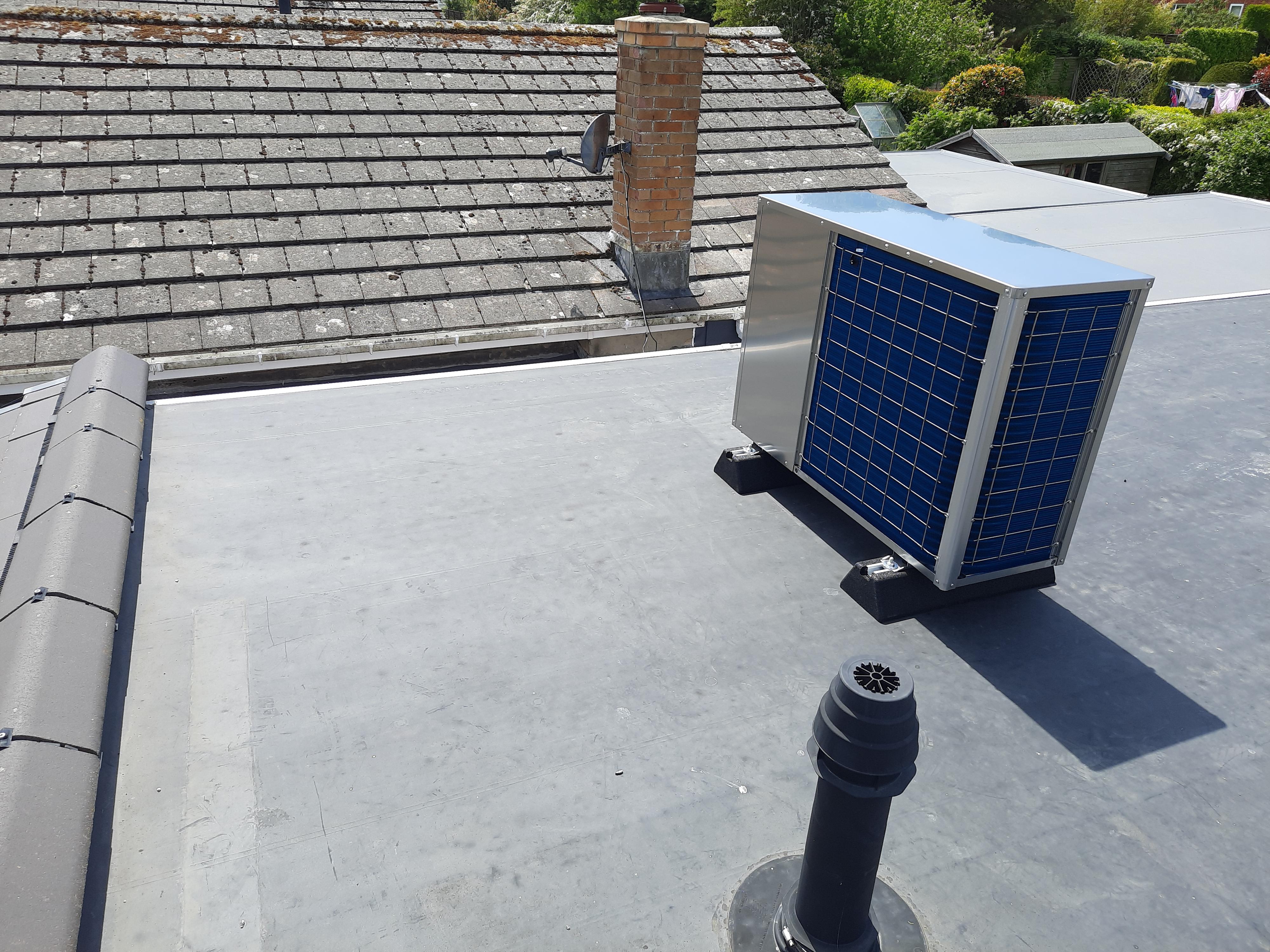

Marvin Posted June 23, 2021 Author Share Posted June 23, 2021 Coolenergy ASHP up and running from yesterday. Link to comment Share on other sites More sharing options...
Marvin Posted June 23, 2021 Author Share Posted June 23, 2021 Runs very quietly. Almost no noise from the unit outside. Fridge/freezer makes more noise inside. 1 Link to comment Share on other sites More sharing options...

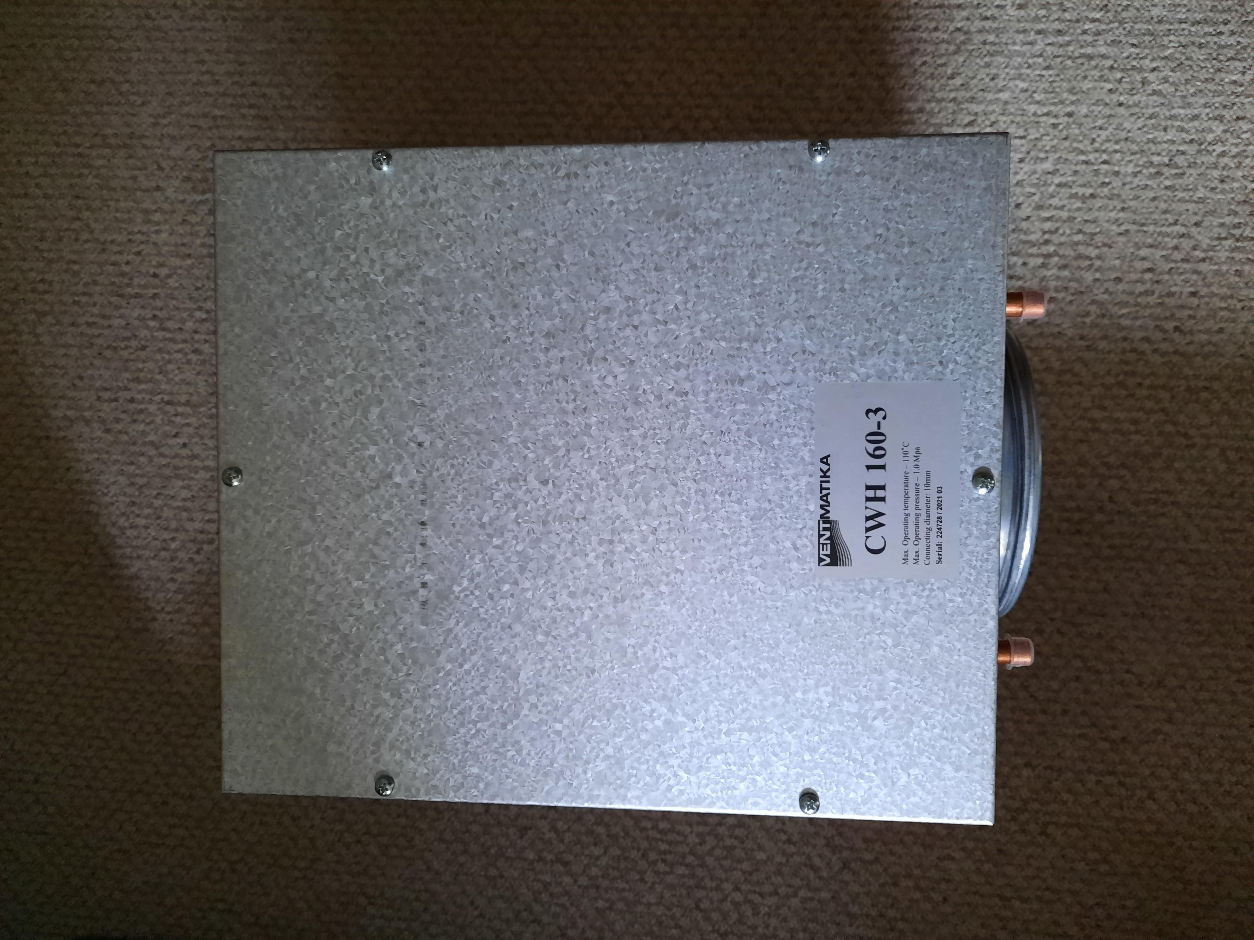

jfb Posted June 24, 2021 Share Posted June 24, 2021 1 hour ago, Marvin said: We're running it using radiators and a coil in the MVHR system What is the coil in the MVHR? Does that do both cooling and heating via the MVHR? And presumably require extra pipework to the MVHR? Link to comment Share on other sites More sharing options...

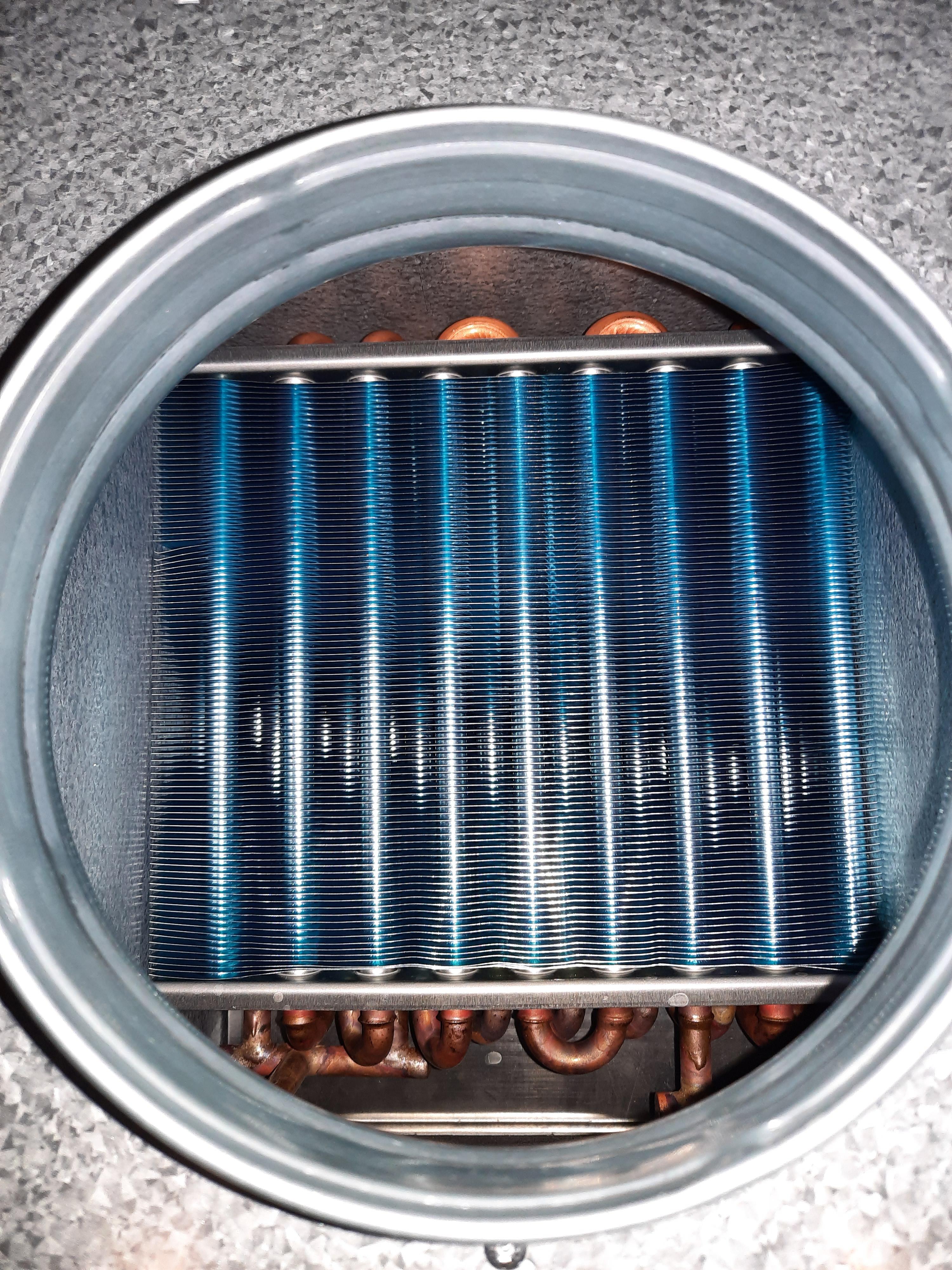

Marvin Posted June 24, 2021 Author Share Posted June 24, 2021 Inside coil box Link to comment Share on other sites More sharing options...
Marvin Posted June 24, 2021 Author Share Posted June 24, 2021 Coil Box Link to comment Share on other sites More sharing options...

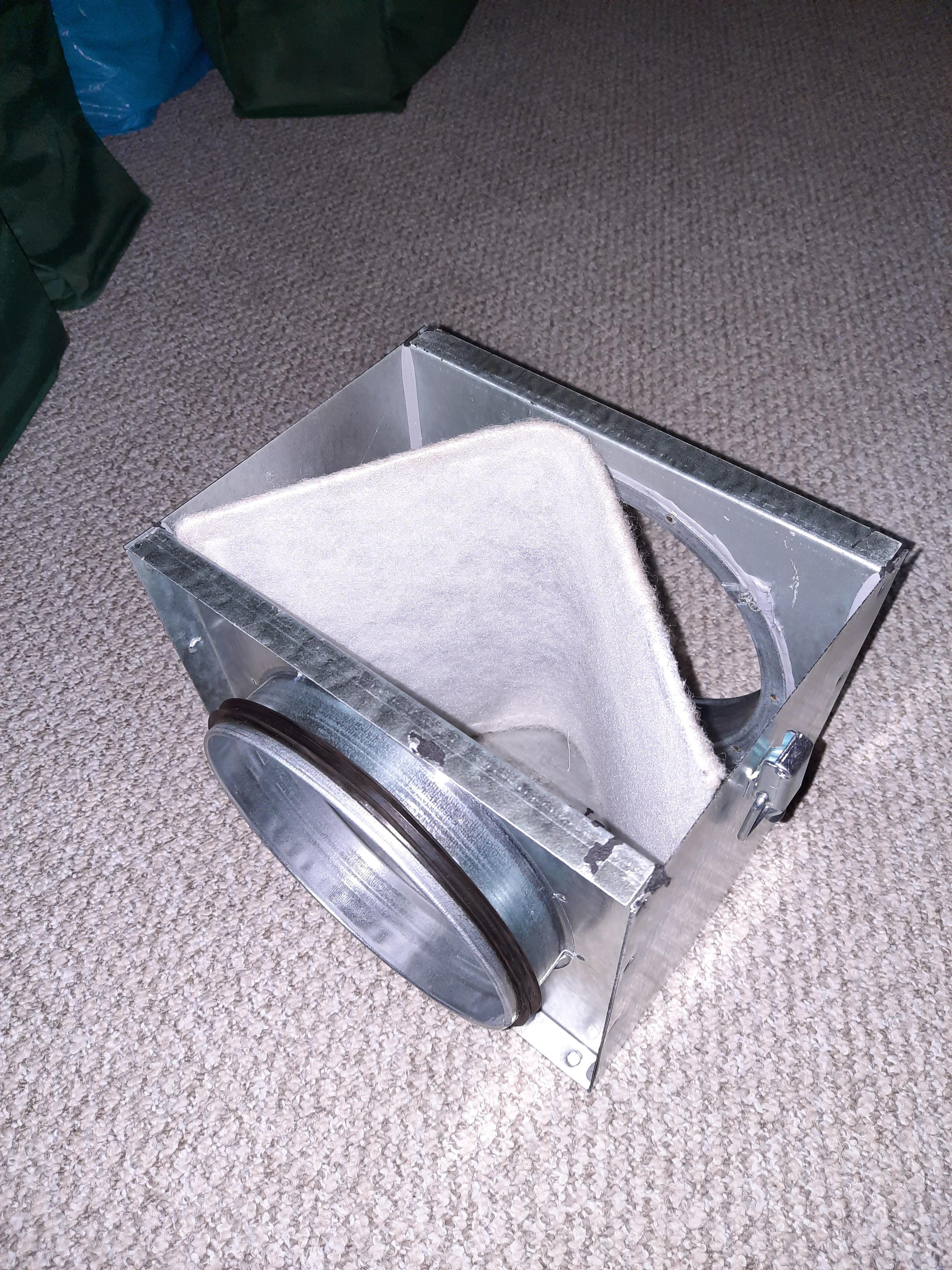

Marvin Posted June 24, 2021 Author Share Posted June 24, 2021 filter box Link to comment Share on other sites More sharing options...
Marvin Posted June 24, 2021 Author Share Posted June 24, 2021 Only just got the ASHP running. Purchased and will be adding one of these coils: Duct water heater.pdf Had to add an air filter as the water coil will be positioned just before the entrance to the MVHR box on the inlet pipe. This should allow condensation to flow out of MVHR box through the drain point. Yes pipework to MVHR. Yes warm and cool as set on ASHP. Advised to have separate port valves to both radiators and coil. If the coil works ok, then when cooling, I can turn the temperature down lower than I would for radiators, and just run the coil and this would avoid the risk of condensation on the radiators because I should be able to leave them off. (enough cooling from coil hopefully) That's the cunning plan! We shall see. Link to comment Share on other sites More sharing options...
A_L Posted June 24, 2021 Share Posted June 24, 2021 53 minutes ago, Marvin said: Had to add an air filter as the water coil will be positioned just before the entrance to the MVHR box on the inlet pipe. I may misunderstand your layout, but if the coil is between the outside and the MVHR heat exchanger how will you, unless you have a summer bypass, prevent the outgoing air heating the cooled incoming air? Similarly if the coil heats incoming air the the outgoing air will cool it in the heat exchanger. Is the condensate drain not only on the outgoing side of the heat exchanger? Link to comment Share on other sites More sharing options...
joth Posted June 25, 2021 Share Posted June 25, 2021 (edited) 13 hours ago, Marvin said: Advised to have separate port valves to both radiators and coil. If the coil works ok, then when cooling, I can turn the temperature down lower than I would for radiators, and just run the coil and this would avoid the risk of condensation on the radiators because I should be able to leave them off. (enough cooling from coil hopefully) That's the cunning plan! We shall see. Have you insulated all the supply side MVHR ductwork into each room? If not, you'll need to keep the temperature on the coil not so cold anyway, to avoid condensation forming in/on the ducts. Edited June 25, 2021 by joth Link to comment Share on other sites More sharing options...
Marvin Posted June 25, 2021 Author Share Posted June 25, 2021 3 hours ago, joth said: Have you insulated all the supply side MVHR ductwork into each room? If not, you'll need to keep the temperature on the coil not so cold anyway, to avoid condensation forming in/on the ducts. Good question. ALL 4 lines of ducting insulated everywhere within the building/ loft. Link to comment Share on other sites More sharing options...
Marvin Posted June 25, 2021 Author Share Posted June 25, 2021 16 hours ago, A_L said: I may misunderstand your layout, but if the coil is between the outside and the MVHR heat exchanger how will you, unless you have a summer bypass, prevent the outgoing air heating the cooled incoming air? Good question. Yes we have a summer bypass. Link to comment Share on other sites More sharing options...
Marvin Posted June 25, 2021 Author Share Posted June 25, 2021 16 hours ago, A_L said: Similarly if the coil heats incoming air the the outgoing air will cool it in the heat exchanger. Is the condensate drain not only on the outgoing side of the heat exchanger? I don't know. I will contact the manufacturer and see if I can add a drain on the other side.... Link to comment Share on other sites More sharing options...
Marvin Posted June 25, 2021 Author Share Posted June 25, 2021 3 hours ago, Marvin said: I don't know. I will contact the manufacturer and see if I can add a drain on the other side.... Manufacturer technical department states the existing condensate drain will remove condensation produced when either the inlet air is colder than the exhaust air, or when the exhaust air is colder than the inlet air. so all good from that point of view. Link to comment Share on other sites More sharing options...
