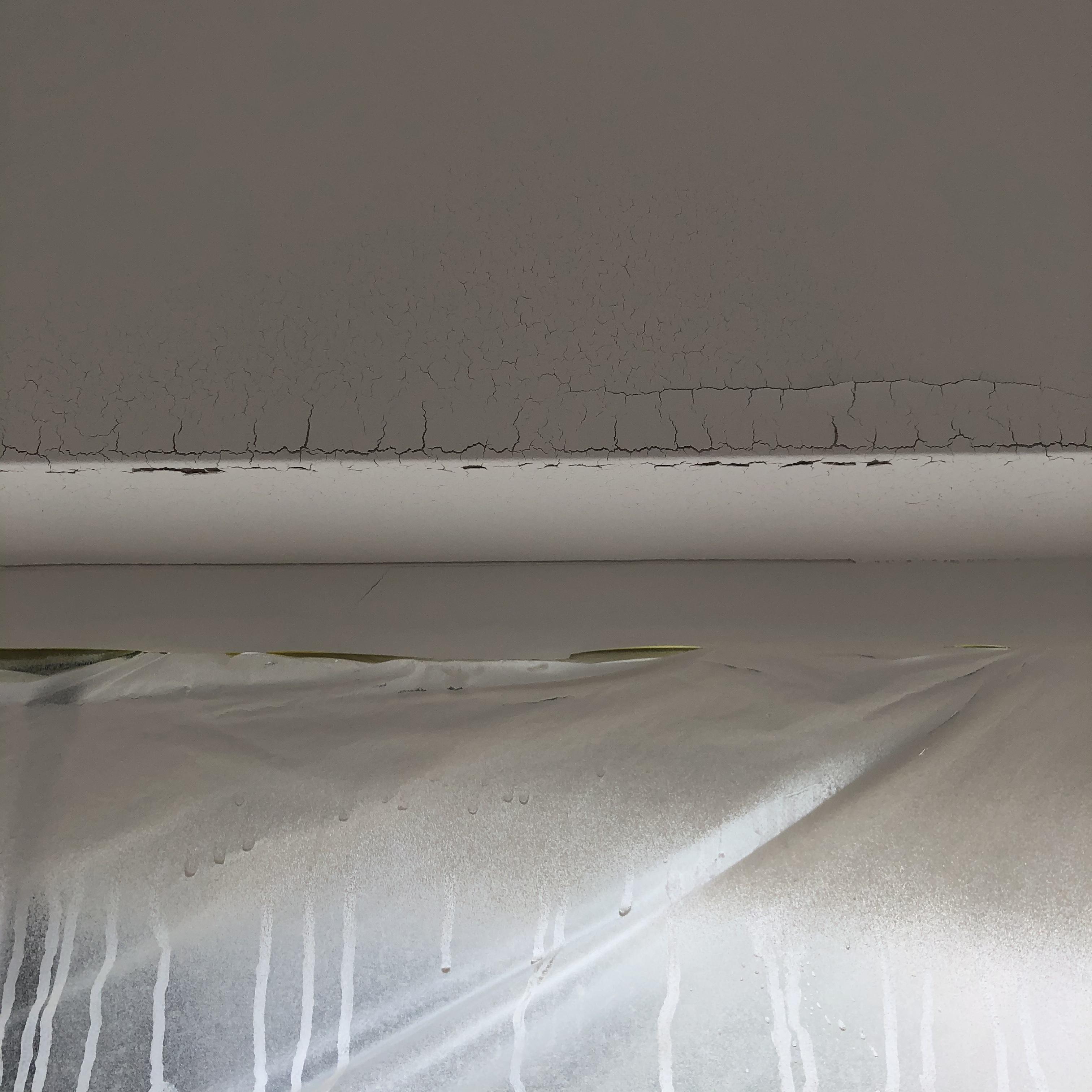

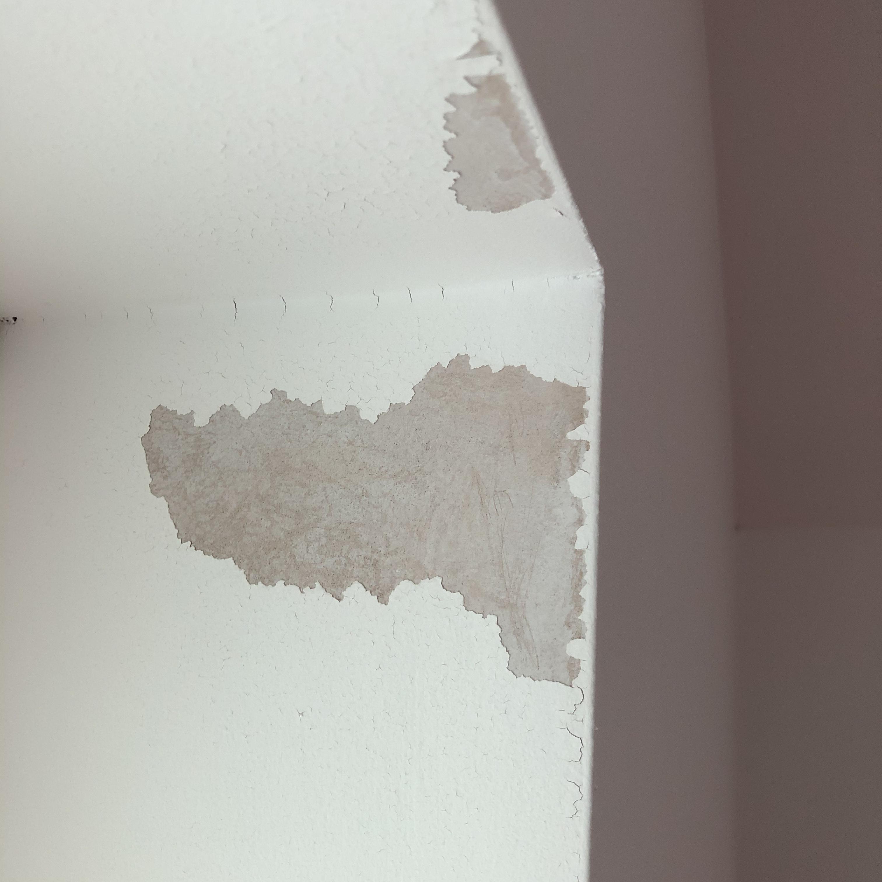

Pocster Posted May 29, 2021 Share Posted May 29, 2021 Aasrrgghhh ! Assume either went on to thick or simply dried out too fast . What’s best ? Respray this ? Dilute the paint ? Gentle and carefully just use a brush ?? Link to comment Share on other sites More sharing options...

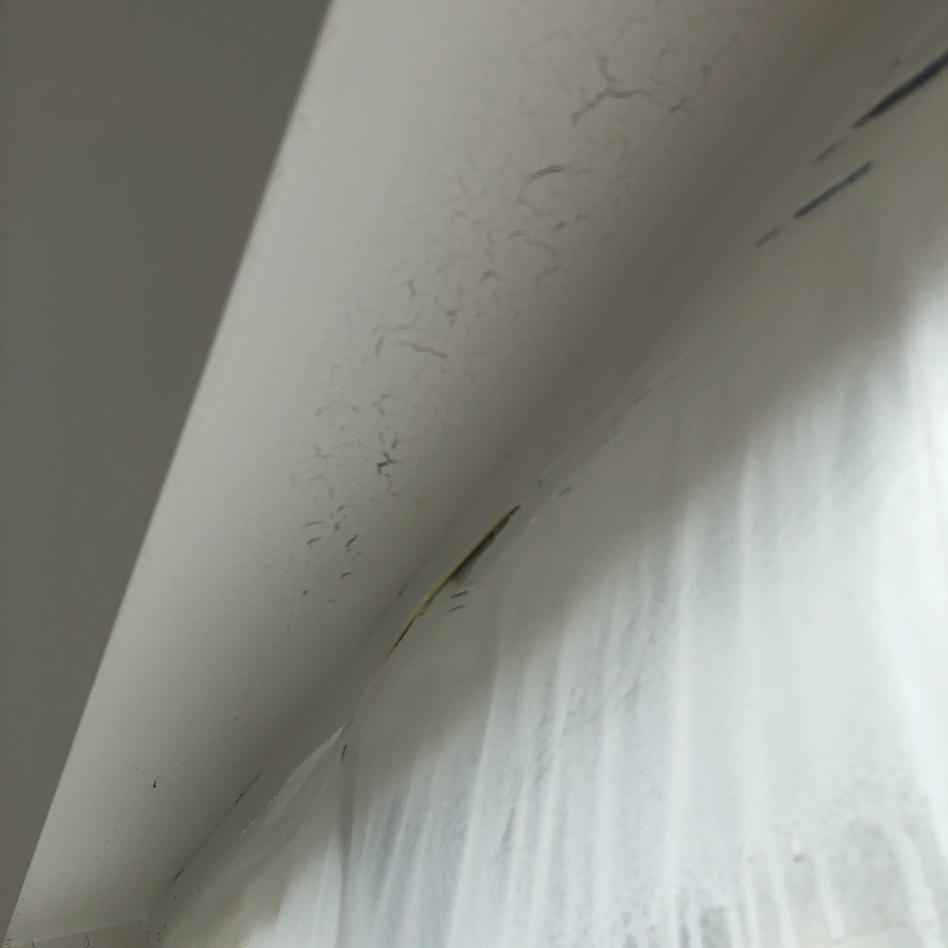

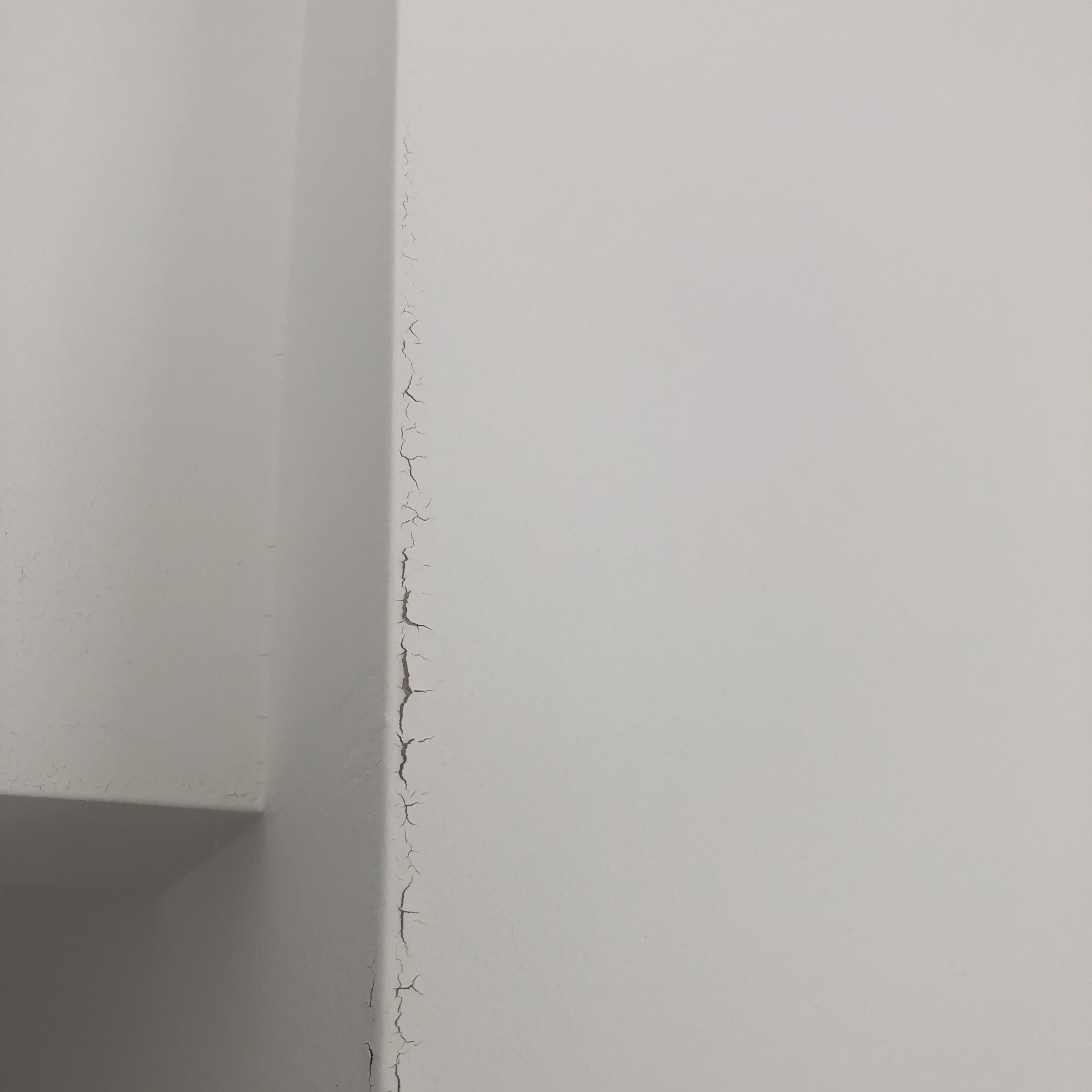

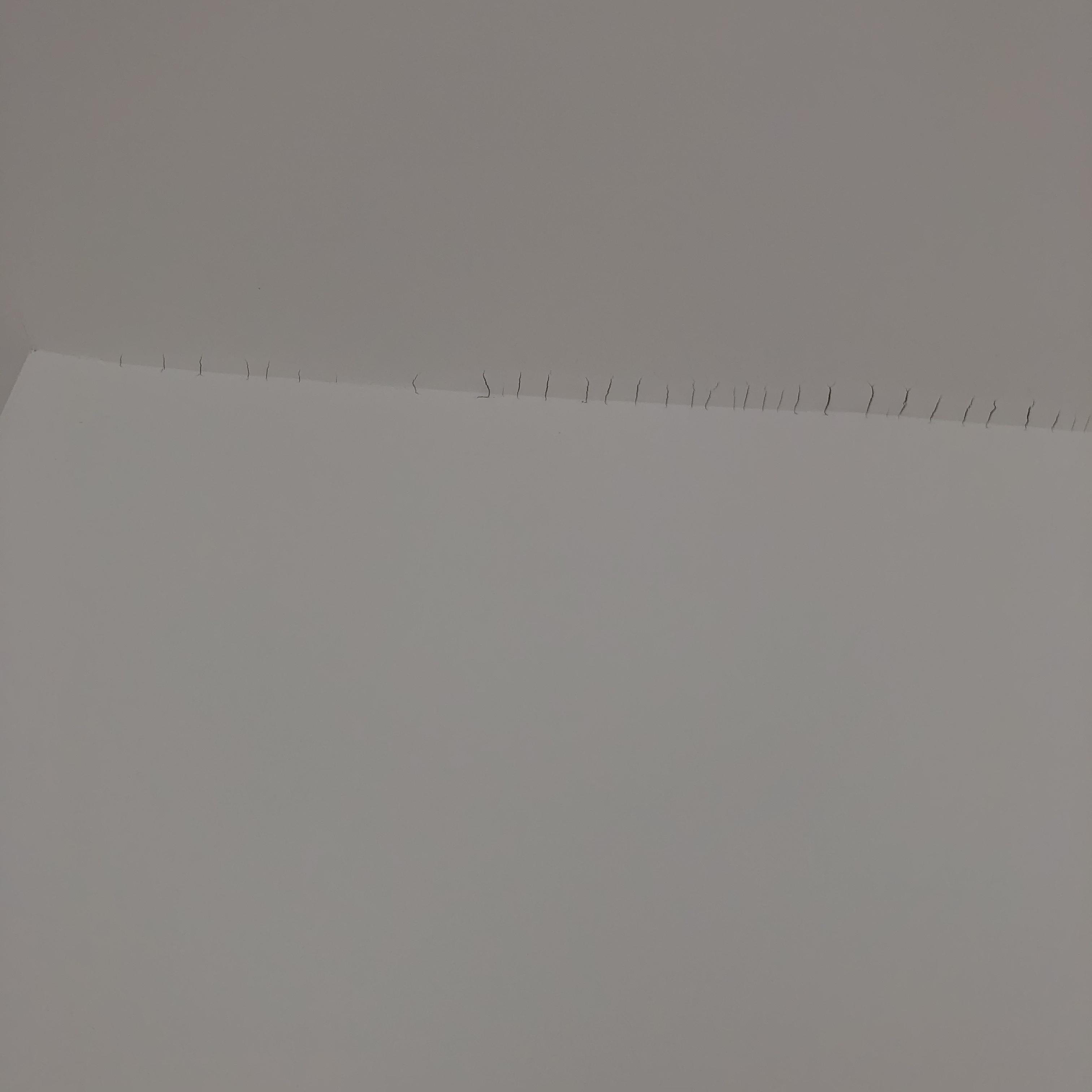

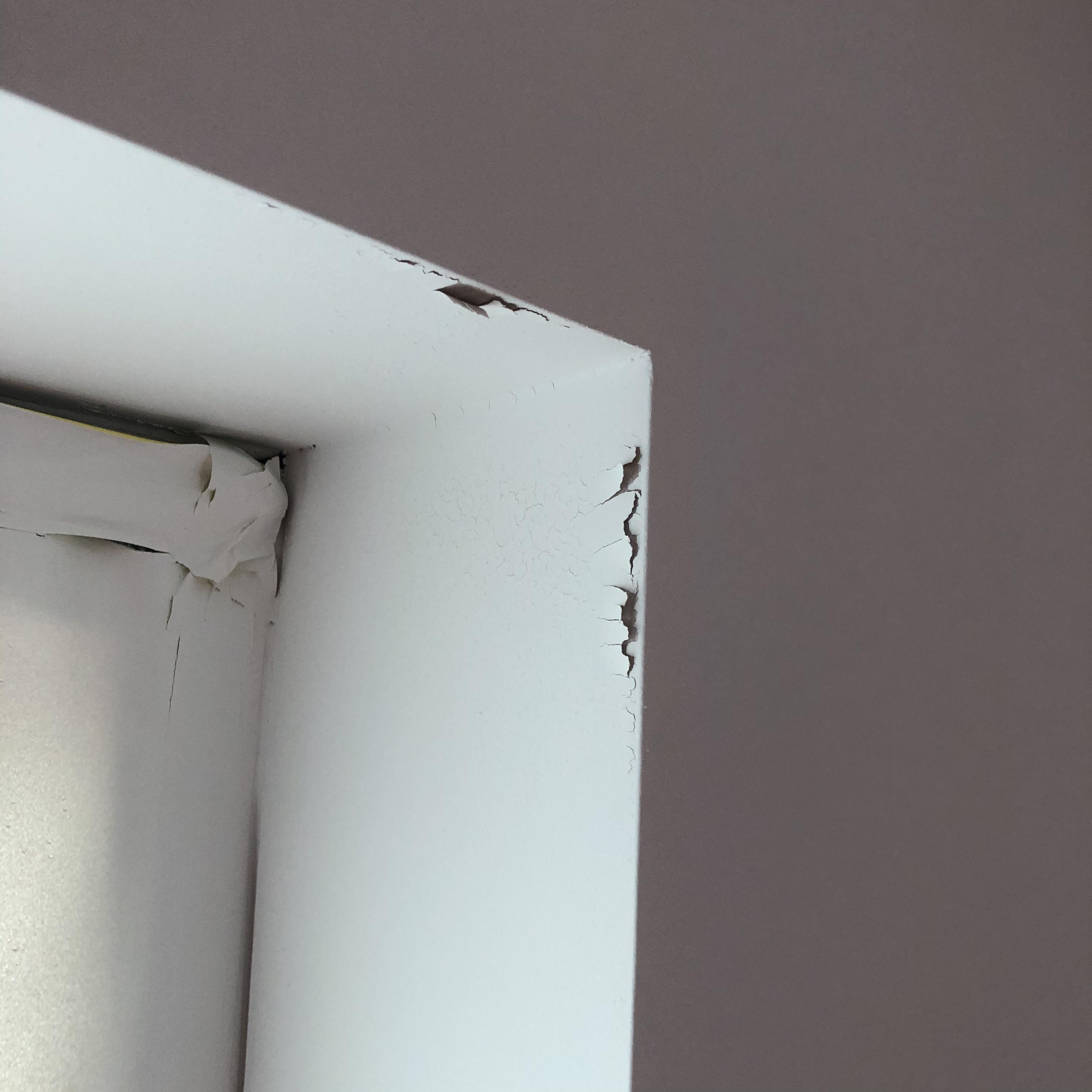

Pocster Posted May 29, 2021 Author Share Posted May 29, 2021 Seems worse around doorways and corners -.... Link to comment Share on other sites More sharing options...
Pocster Posted May 29, 2021 Author Share Posted May 29, 2021 Get a blunt chisel and remove loose parts - then respray ?? Link to comment Share on other sites More sharing options...
Pocster Posted May 29, 2021 Author Share Posted May 29, 2021 Tempted to remove loose around one window . Then respray with my baby sprayer . Leave it until Monday and see if that solves the issue Link to comment Share on other sites More sharing options...
SuperPav Posted May 29, 2021 Share Posted May 29, 2021 That's an adhesion issue. Is it going onto fresh, very smooth plaster? I had very similar failure on the underside of a staircase, nearly drove me insane. The only way around it was to get back to the plaster by scraping, and roller on LOTS of very very light watered down coats. I even went as far as roughly scouring the plaster with a bit of wire wool and brush. Any attempt to put anything remotely thicker just led to little flakes peeling clean off the smooth bits. I guess the same applies when spraying - lots of thin coats. 1 Link to comment Share on other sites More sharing options...
Pocster Posted May 29, 2021 Author Share Posted May 29, 2021 8 minutes ago, SuperPav said: That's an adhesion issue. Is it going onto fresh, very smooth plaster? I had very similar failure on the underside of a staircase, nearly drove me insane. The only way around it was to get back to the plaster by scraping, and roller on LOTS of very very light watered down coats. I even went as far as roughly scouring the plaster with a bit of wire wool and brush. Any attempt to put anything remotely thicker just led to little flakes peeling clean off the smooth bits. I guess the same applies when spraying - lots of thin coats. I did mist coat everything with a basic white paint first . Difficult to do “ thin coats “ with a sprayer !! . I’ll scrape back one window reveal ... Once back to the plaster will mist coat that bit ( with a brush ) Worried about diluting the final coat paint as it might run - but guess that’s best . Link to comment Share on other sites More sharing options...
SuperPav Posted May 29, 2021 Share Posted May 29, 2021 Once you've built up enough mist coats (maybe 4-5) - you should be able to put on a proper thick final coat without it peeling off.. It's a fine line though. Brushing also seems to be the least likely to lead to peeling while applying - rollering is the worst as it essentially is pulling the paint off the surface. A sprayer might actually be good for that last thicker coat.. You could also just run a medium grade sander over it (e.g. 180grit) - this has the effect of flicking off any bits which are loose, while also roughing up the plaster and any good paint for slightly better adhesion for subsequent coats. Either way, you have my sympathies here! 1 Link to comment Share on other sites More sharing options...
andy Posted May 29, 2021 Share Posted May 29, 2021 I had this exact issue @pocster and for me the problem was too thick mist coat and probably next coat too. Scraped off affected walls with glass scraper (slow job!) right back to plaster, easyfill where needed to repair then a new mist coat (wall still quite pink, 30-40% water). Next coat was undiluted and covered almost all plaster colour followed by a final coat but again quite thin. There is a definite knack to spraying! 1 Link to comment Share on other sites More sharing options...

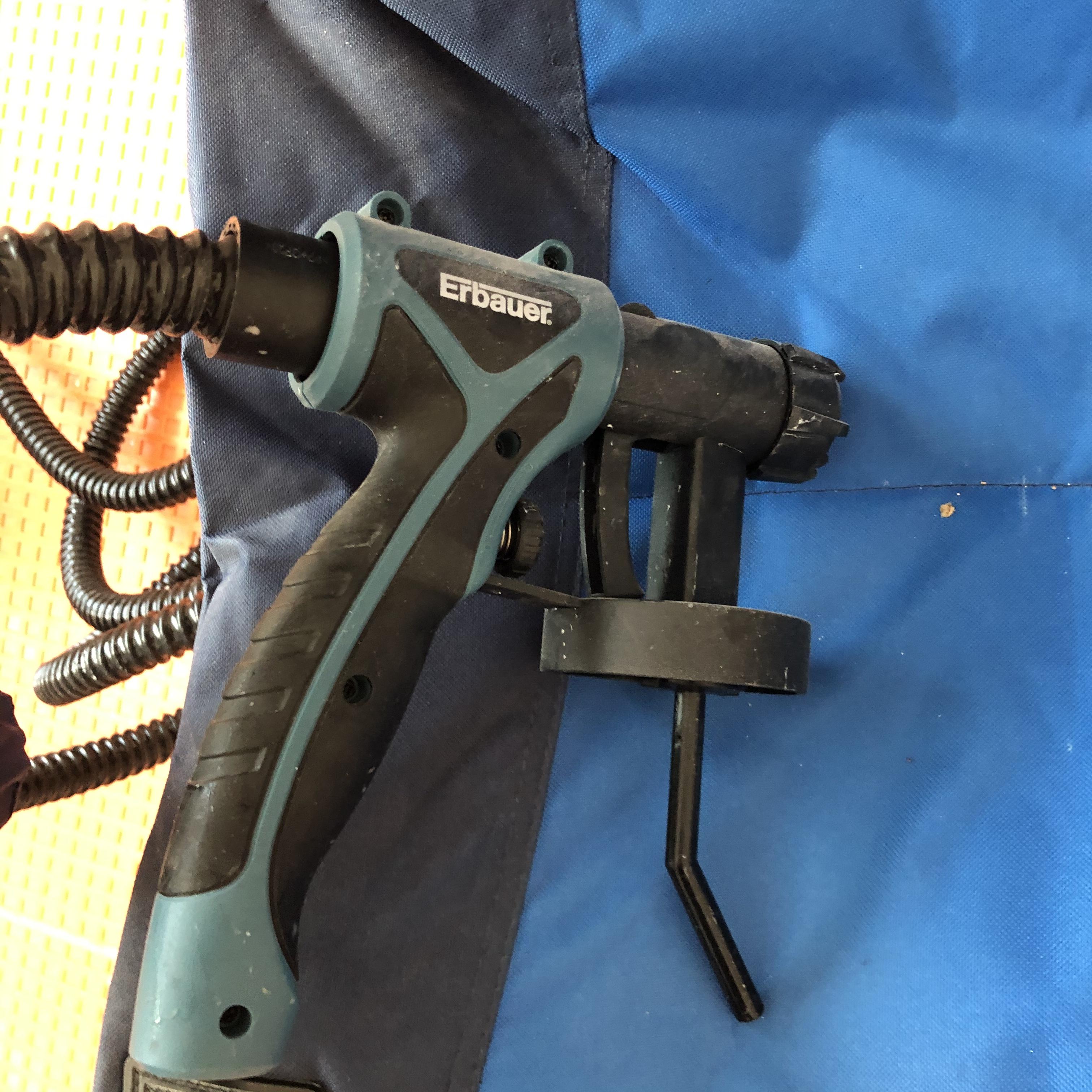

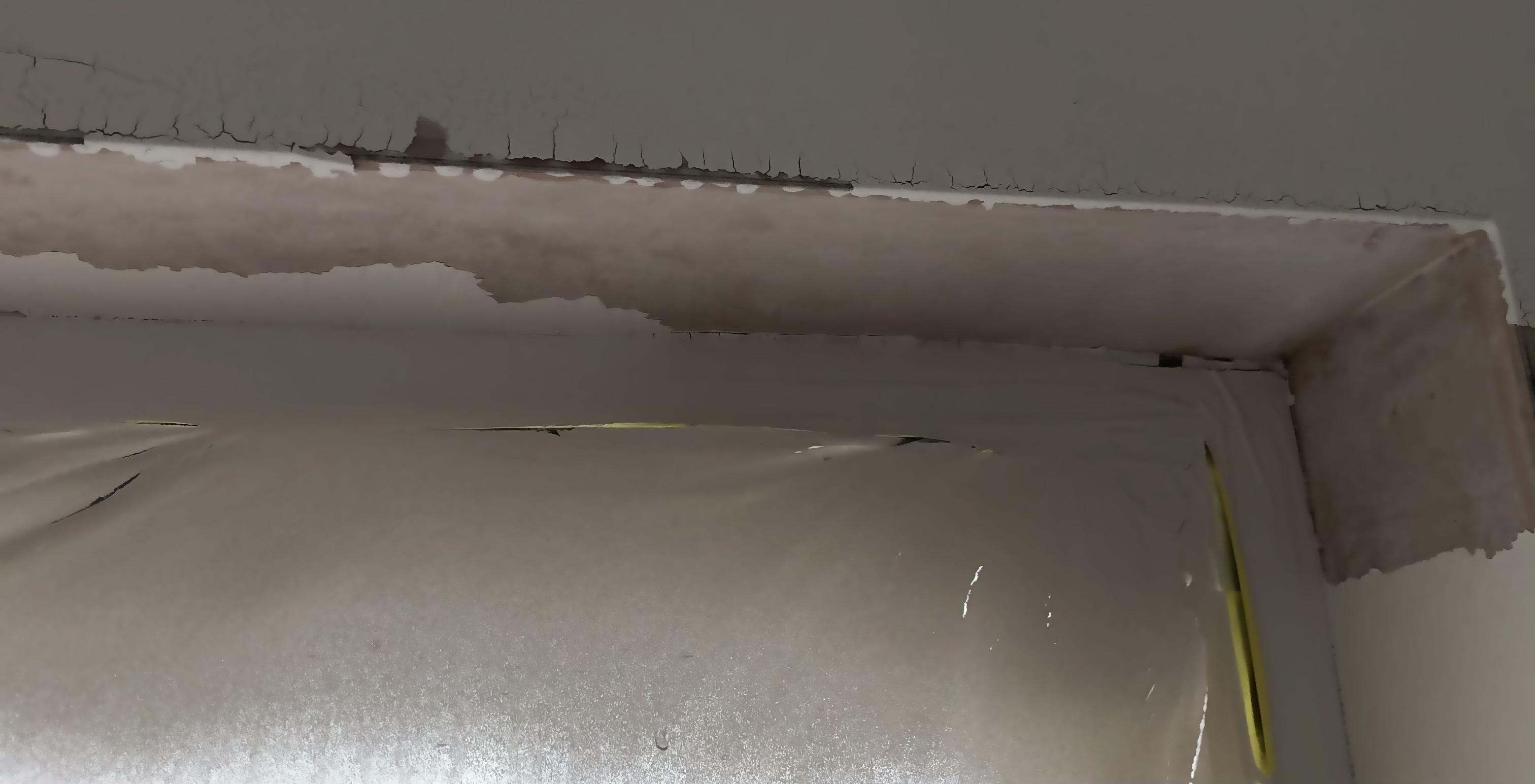

Pocster Posted May 29, 2021 Author Share Posted May 29, 2021 Scrapped back paint . Plaster underneath still has mist coat . Tried baby sprayer . Blocked instantly. Had to dilute paint 5 to 1 to get it to spray . Runs now of course !! Will wait 10 mins between each spray and see if I can build it up Link to comment Share on other sites More sharing options...
andy Posted May 29, 2021 Share Posted May 29, 2021 I gave it 6-8 hours between coats, not sure building up will work? 1 Link to comment Share on other sites More sharing options...
Pocster Posted May 29, 2021 Author Share Posted May 29, 2021 13 minutes ago, andy said: I gave it 6-8 hours between coats, not sure building up will work? I agree now ! Problem with baby sprayer as it’s so diluted it just runs . I’ll leave it like this for now . I need to get the girth Wagner out for the hallway once skimmed - so might go over this bit with the ‘ proper ‘ sprayer . Just a pita cleaning the Wagner beast. ! Link to comment Share on other sites More sharing options...

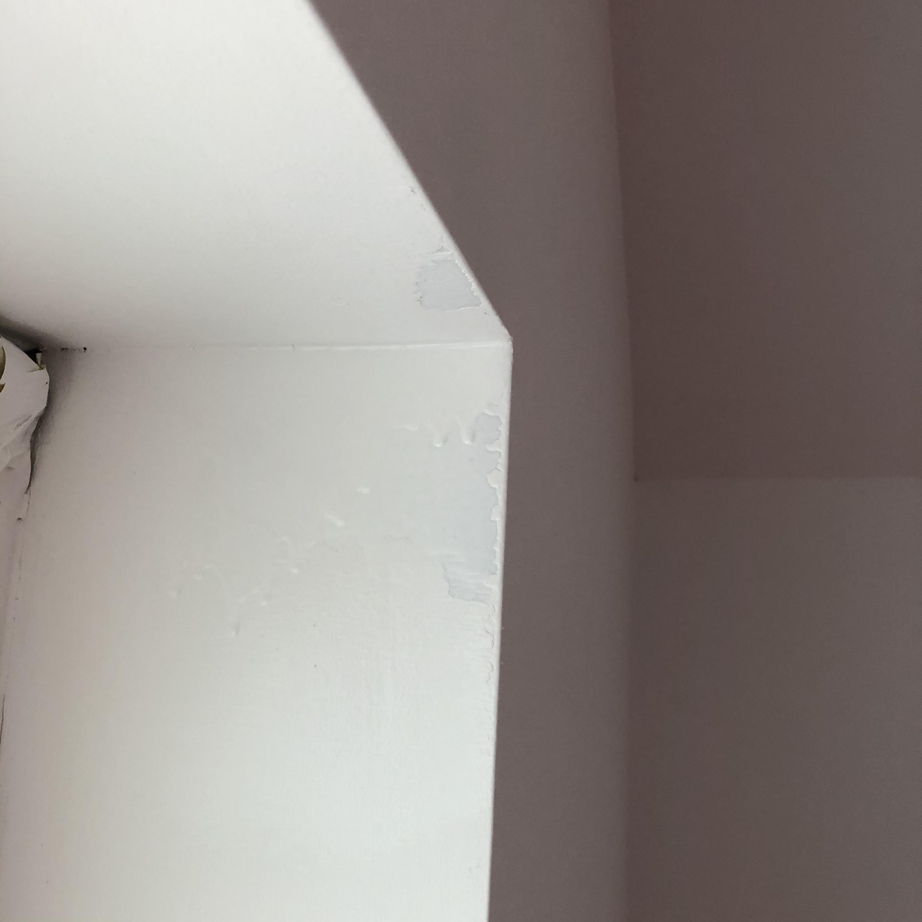

Pocster Posted May 29, 2021 Author Share Posted May 29, 2021 Scrapped this window reveal . Comes off easy with a blunt chisel . More worried about the peeling paint above it on the wall . Don’t want to scrape the whole wall !! ??? Link to comment Share on other sites More sharing options...

scottishjohn Posted May 29, 2021 Share Posted May 29, 2021 (edited) did you "tack rag" the surface before starting? -as any loose dust etc will stop adhesion I just asked my plaster master mate his question was --"are you sure the plaster was FULLY dried out," as in weeks maybe 2 0r 3 weeks -longer if in winter and hard plastered onto block walls which could have been be wet as well -definately not plastered on friday and painted on monday hope it helps Edited May 29, 2021 by scottishjohn 1 Link to comment Share on other sites More sharing options...
Pocster Posted May 29, 2021 Author Share Posted May 29, 2021 (edited) 21 minutes ago, scottishjohn said: did you "tack rag" the surface before starting? -as any loose dust etc will stop adhesion I just asked my plaster master mate his question was --"are you sure the plaster was FULLY dried out," as in weeks maybe 2 0r 3 weeks -longer if in winter and hard plastered onto block walls which could have been be wet as well -definately not plastered on friday and painted on monday hope it helps Not sure what “ tag rag “ is - will Google . Plaster about 2/3 weeks old so dry for sure . Really only around Windows mostly - so with polythene on *assume* hotter than the rest of the house - drying too fast ??? Appreciate you asking a plasterer Edited May 29, 2021 by pocster Link to comment Share on other sites More sharing options...
Pocster Posted May 29, 2021 Author Share Posted May 29, 2021 (edited) Got my laser temp pointer thing . Windows definitely very warm . Also the front bedroom with minimum issues is lots cooler . Yesterday when spraying quite warm ( but not hot ) - today 23 degrees . But as I say walls / ceilings perfect . I’m sure it’s got something to do with heat ( hottest day of the year so far !! ) . Hmmmmmmmm Edited May 29, 2021 by pocster Link to comment Share on other sites More sharing options...
dpmiller Posted May 29, 2021 Share Posted May 29, 2021 you didn't annoy the plasterers did ya? Polished up with a plastic bag will do this... 1 Link to comment Share on other sites More sharing options...

scottishjohn Posted May 30, 2021 Share Posted May 30, 2021 On 29/05/2021 at 10:35, pocster said: Aasrrgghhh ! Assume either went on to thick or simply dried out too fast . What’s best ? Respray this ? Dilute the paint ? Gentle and carefully just use a brush ?? why does it look black under the white --was it painted already? Link to comment Share on other sites More sharing options...
Pocster Posted May 30, 2021 Author Share Posted May 30, 2021 Just now, scottishjohn said: why does it look black under the white --was it painted already? Just the photo . The plaster underneath is mist coated . Not black ? Link to comment Share on other sites More sharing options...
scottishjohn Posted May 30, 2021 Share Posted May 30, 2021 using old out of date plaster?-which then never sets right without actually seeing it he could not be more specific was another suggestion from my master plaster 1 Link to comment Share on other sites More sharing options...
Pocster Posted May 30, 2021 Author Share Posted May 30, 2021 40 minutes ago, scottishjohn said: using old out of date plaster?-which then never sets right without actually seeing it he could not be more specific was another suggestion from my master plaster Nah . I know it’s new because I got it . I’m still going on the fact perhaps it just dried out too quick as it’s around the window returns . Polythene on windows . No airflow ( all locked up and don’t live on site ) . Hottest day of the year so far was the next day . I might of course be completely wrong ? Link to comment Share on other sites More sharing options...

Pocster Posted June 1, 2021 Author Share Posted June 1, 2021 (edited) Went into paint shop They claim that it looks like the plaster wasn’t fully dry . It was left 2/3 weeks before I mist coated it . He then said perhaps the whole lot will crack and flake !! ? - thanks !! Edited June 1, 2021 by pocster Link to comment Share on other sites More sharing options...
