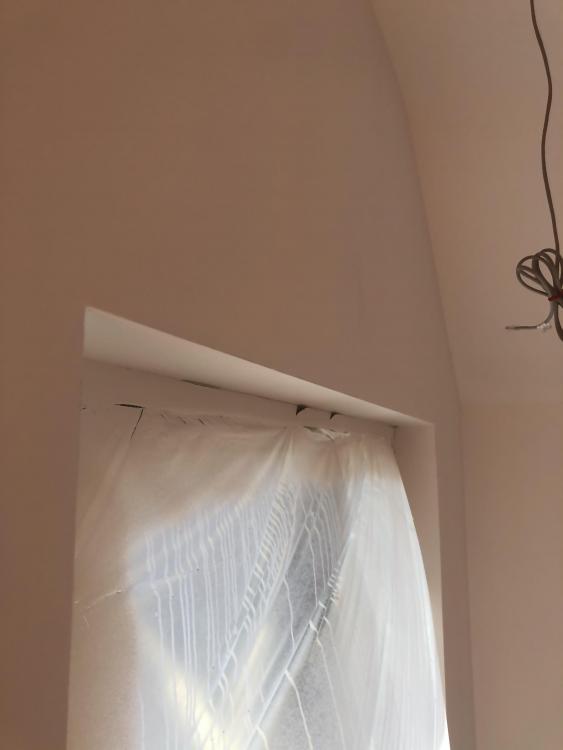

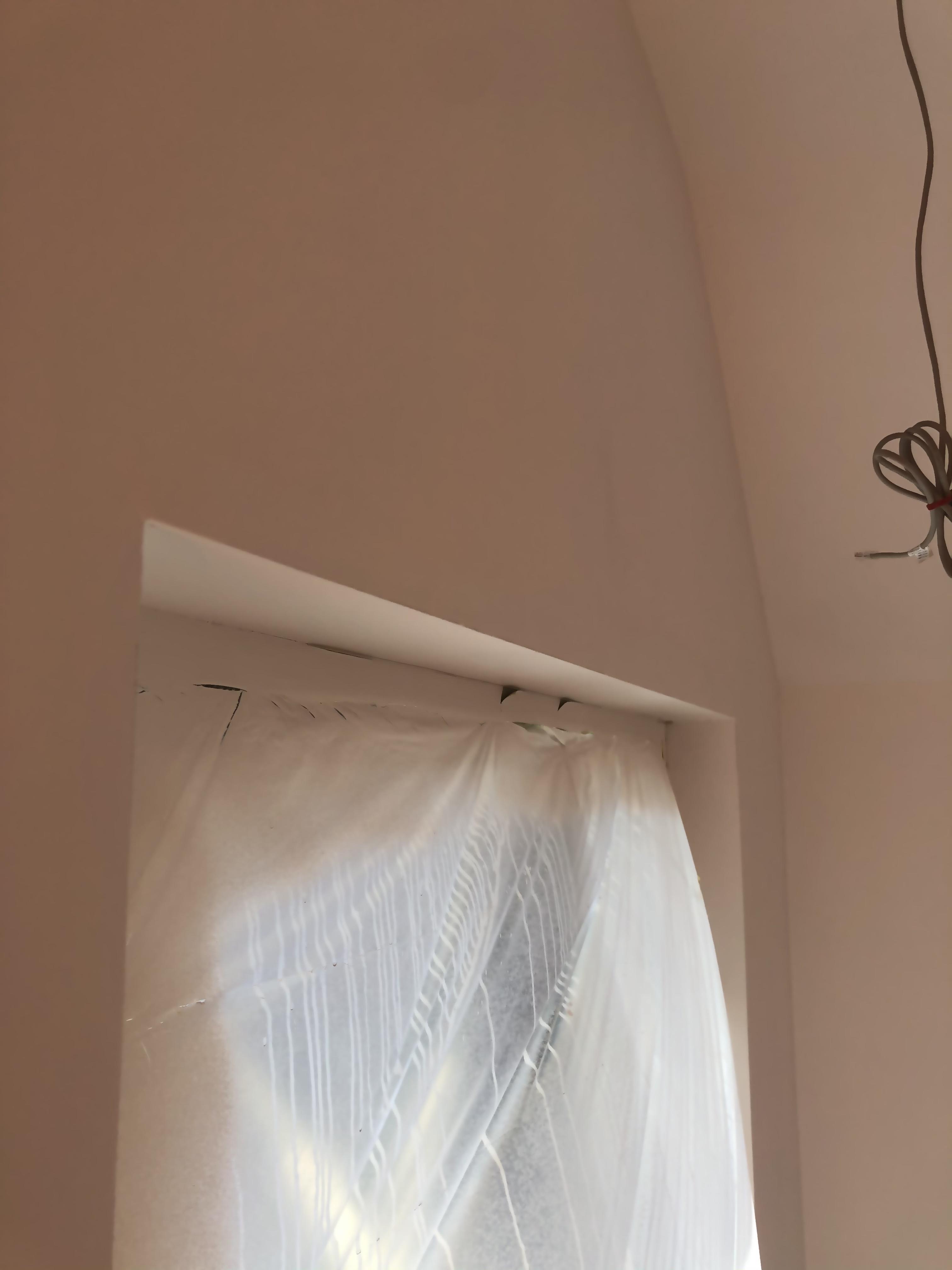

11 minutes ago, pocster said:
Went into paint shop
They claim that it looks like the plaster wasn’t fully dry .
It was left 2/3 weeks before I mist coated it . He then said perhaps the whole lot will crack and flake !! ? - thanks !!
I’m not convinced by his argument
Painted plenty of newly plastered walls before ....
What a pita. All the site sprayers i have seen over the years have always sanded all the walls and ceilings before any spraying. One of those fancy round sanders on a pole with a big round head. Hope you get it sorted.
Guy in the shop didn’t seem particularly knowledgeable tbh . He sold me the Graco extension for the Wagner sprayer .

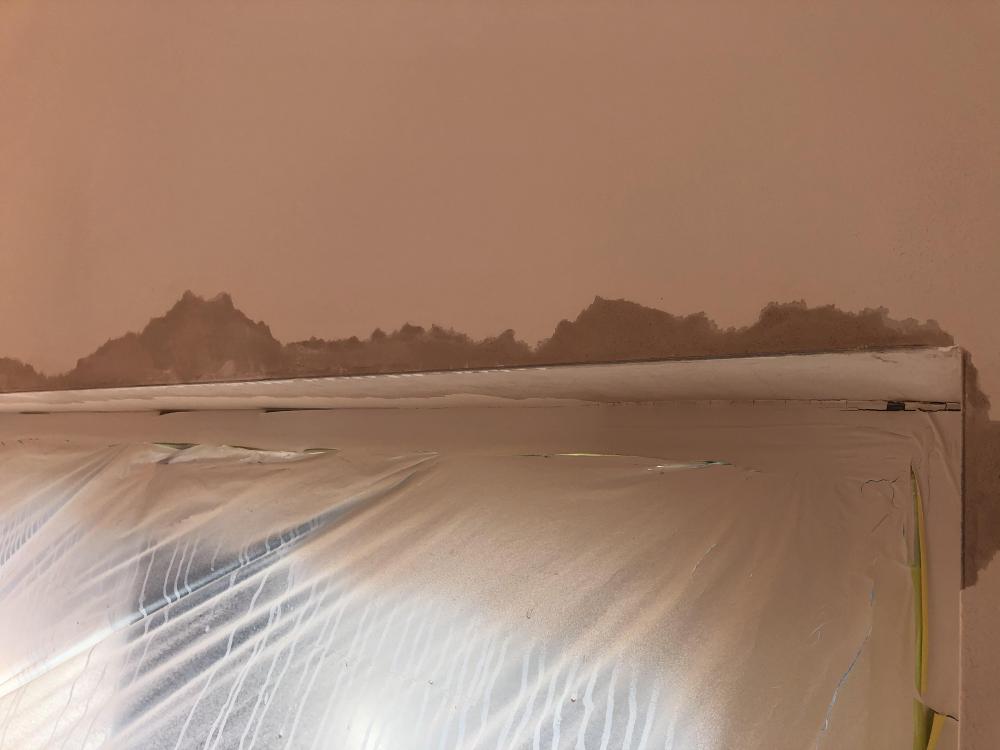

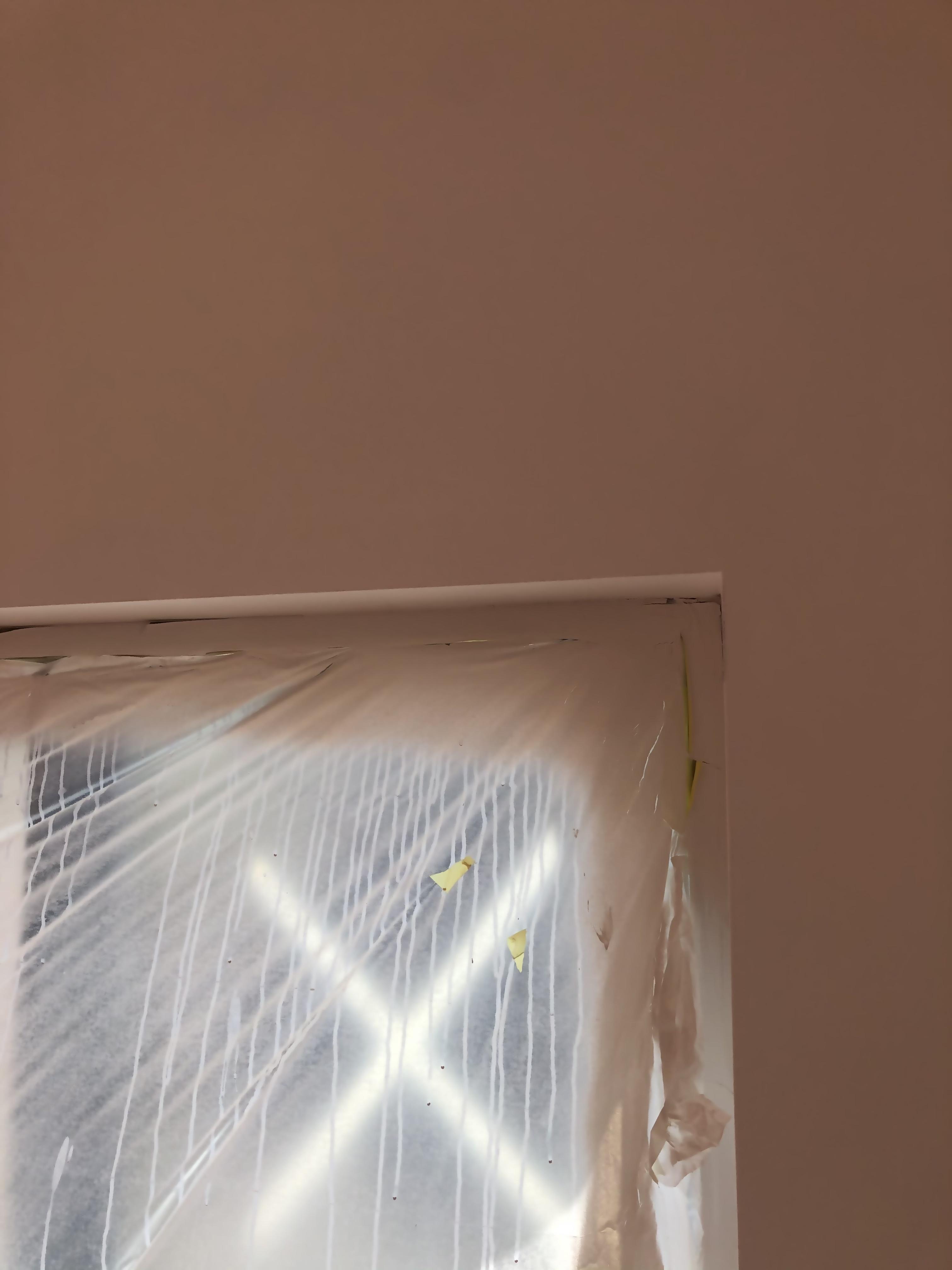

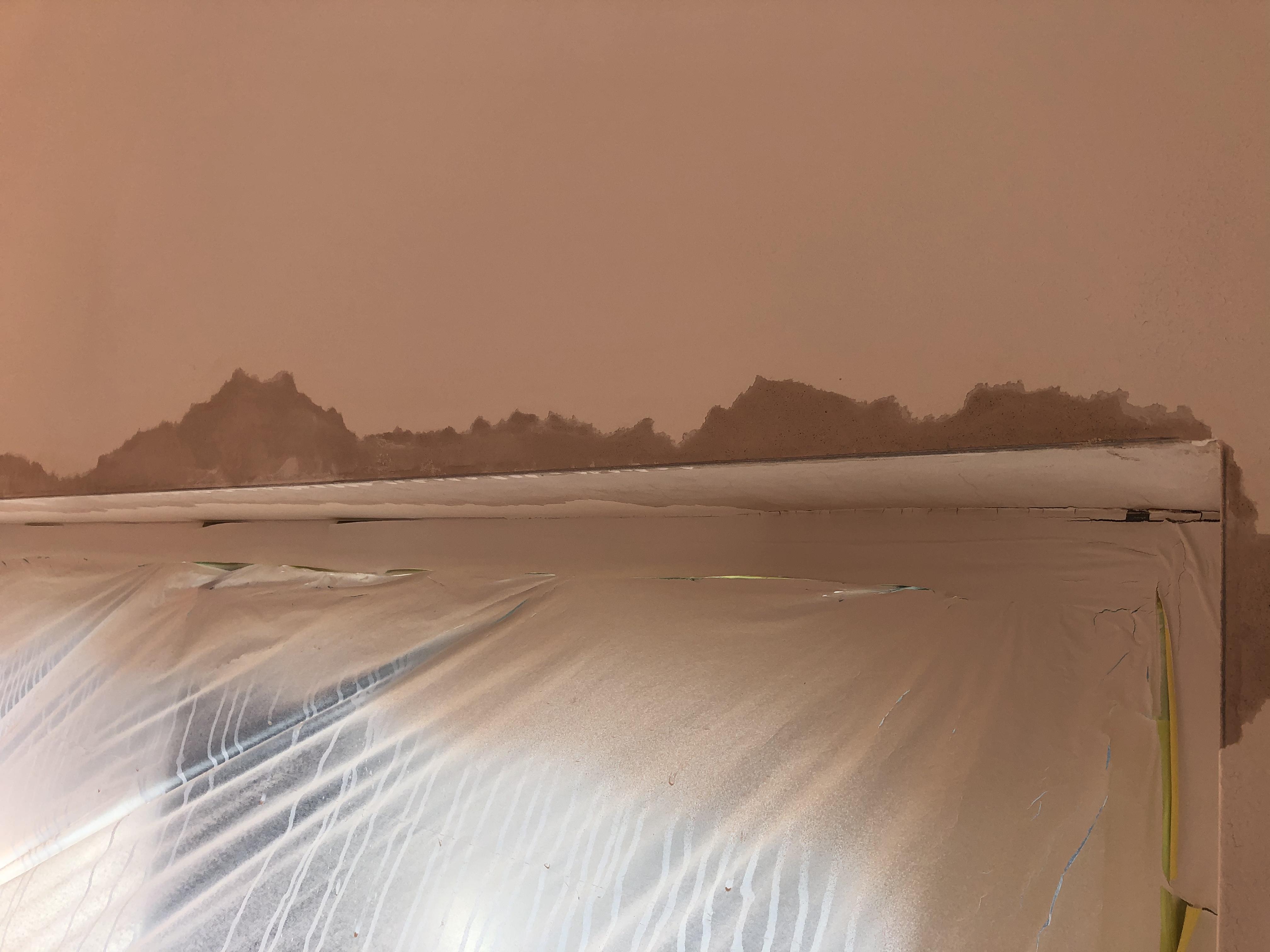

Gently removed loose paint with a blunt chisel around another window . Gently sanded the paint ‘edges’ to ‘blend’ it into the plaster . Can feel the edge though ( always assume if I can’t feel it then it’s good enough )
Will wipe down to remove dust .
Then roller water downed coat of the vinyl mat ...
Watery emulsion again ( just for luck ); applied with roller .
Hot today . Touch dry in 10 mins .
So 30 mins later go for Mat vinyl with roller . Not looking too bad at all ! . Hard to judge properly as drying out - tomorrow will be the true test of my method
