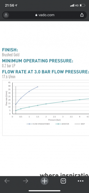

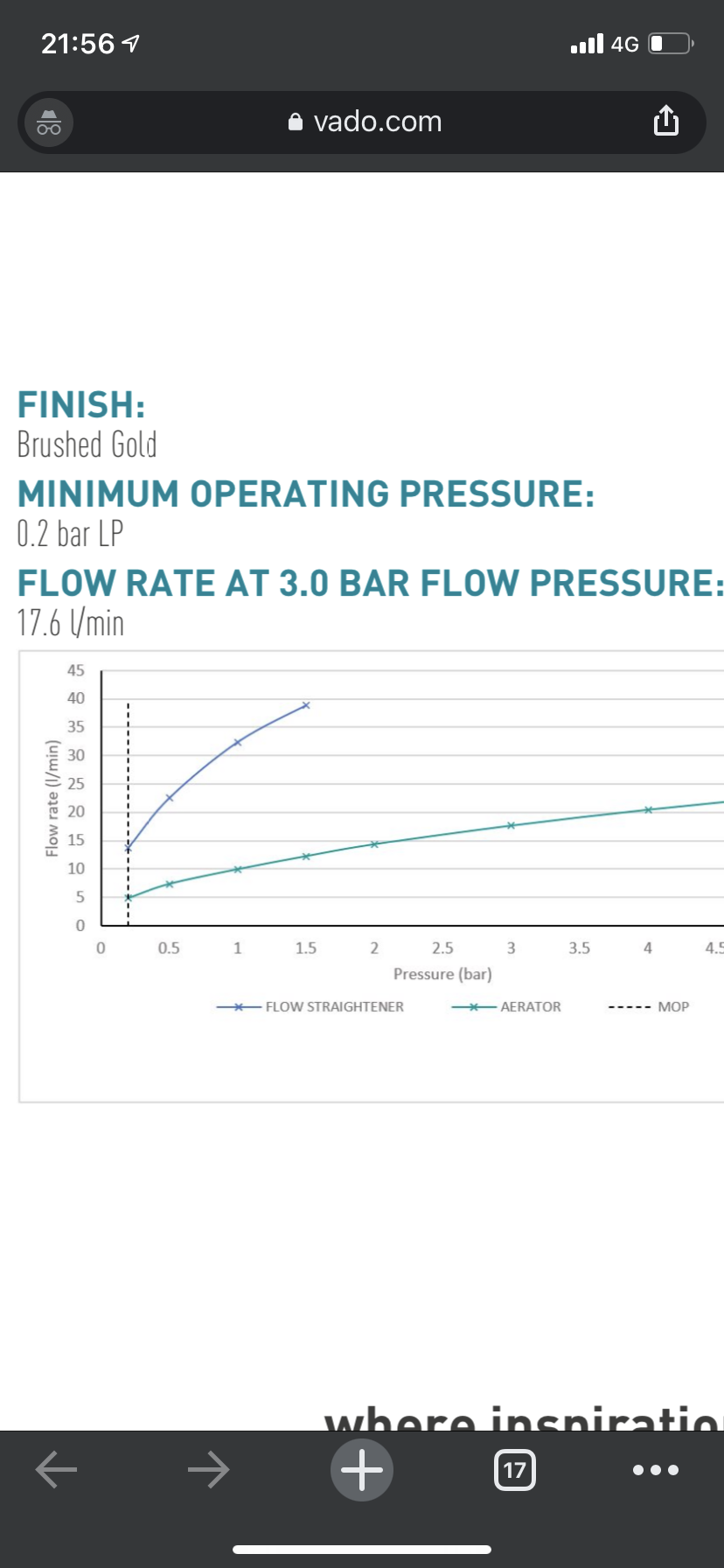

Adsibob Posted May 16, 2021 Posted May 16, 2021 I’m considering a Vado bath filler. It’s flow performance graph is pictured below. Despite the tap’s official rating at 3 bar being 17.6 litres per min, the graph shows a much steeper second curve that would appear to reach almost 40 litres per min way before 3 bar. flow rate is important to me as the bath I’m filling is HUGE. Can someone explain what the “flow straightener” curve is please and how I can achieve the 40l/m rate? For background, I will have an UNvented cylinder and mains pressure is between 2.8 and 3.1 bar. Haven’t laid pipes yet, so could choose what diameter to optimise bath filler flow.

Temp Posted May 16, 2021 Posted May 16, 2021 The filler might allow 40L/min but what you actually get will depend on the supply to your house and the internal pipework. In short you can't do better than a pipe with nothing at all on the end. So perhaps test that first?

Adsibob Posted May 16, 2021 Author Posted May 16, 2021 17 minutes ago, Temp said: The filler might allow 40L/min but what you actually get will depend on the supply to your house and the internal pipework. In short you can't do better than a pipe with nothing at all on the end. So perhaps test that first? There is no internal pipe work at the mo. We ripped it out and are starting from scratch. Soo can spec whatever gets a good recommendation here. The (very) old connection to the mains supply gave us about 18 per minute max, sometimes less. We are widening the connection, but haven’t done that yet, so can’t test. I thought pressure was more relevant than flow as it’s an unvented hot water tank. Pressure is 2.8 to 3.1.

Temp Posted May 17, 2021 Posted May 17, 2021 You should get better flow rates by upgrading. 4 hours ago, Adsibob said: https://www.vado.com/product/6000/specifications-pdf The installation manual say.. https://www.vado.com/origins-ind-ori140-brg Maintenance The mixer is supplied with an aerator fitted as standard. To improve the flow rate in low pressure conditions this aerator can be changed for the plastic flow straightener provided. Carefully unscrew the mixer nozzle taking great care not to damage the plated finish. Remove the aerator and washer. Place the flow straighter into the nozzle followed by the Washer. Screw the nozzle back onto the spout. To ensure max flow rate i'd be thinking about a 32 or 40mm incoming main and 22mm or 28mm copper to the tank and from tank to bathroom. My builder was clueless about plumbing but knew a man that claimed to be an expert witness for all things plumbing. We wanted two quite high flow rate showers with rain heads and he recommended 28mm pipe from our thermal store to a manifold with isolating valves located between the two bathrooms. From the manifold we ran 22mm to the showers and 15mm to everything else (wash, basin WC etc). The latter could probably be smaller.
Marvin Posted May 17, 2021 Posted May 17, 2021 7 hours ago, Adsibob said: Forgive me, I'm a complete novice at this. I will have a large unvented tank in the loft (i.e. one floor above the bathroom in question). And the mains from the street was 18 litres a min previously, but I'm hoping it will increase slightly when we widen the size of the connection. Otherwise people wouldn't bother widening these pipes, surely. Ok. So now the question is about storage capacity and recovery rate. If you need to fill 250 litres for the bath in say 15 minutes, not only do you need the correct, tap, water pressure and pipework, but also the right amount of water storage of both cold and hot water. In simple terms you turn the hot tap on and hot water comes from the hot tank, but at the same time cold water enters you hot tank to replace the hot water filling your bath. Therefore 250 litres of hot water in 15 minutes equalls 250 litres of cold water in 15 minutes. If the mains cannot supply it at this rate then you need to store it in a tank in the building. Whilst the cold water is draining from the cold storage tank the mains will be trying to fill it back up again, and the time taken to fill it is called the recovery rate. More maths, but don't forget you have to take into account any other use of water in the building whilst this is going on otherwise the recovery rate will be longer. M
