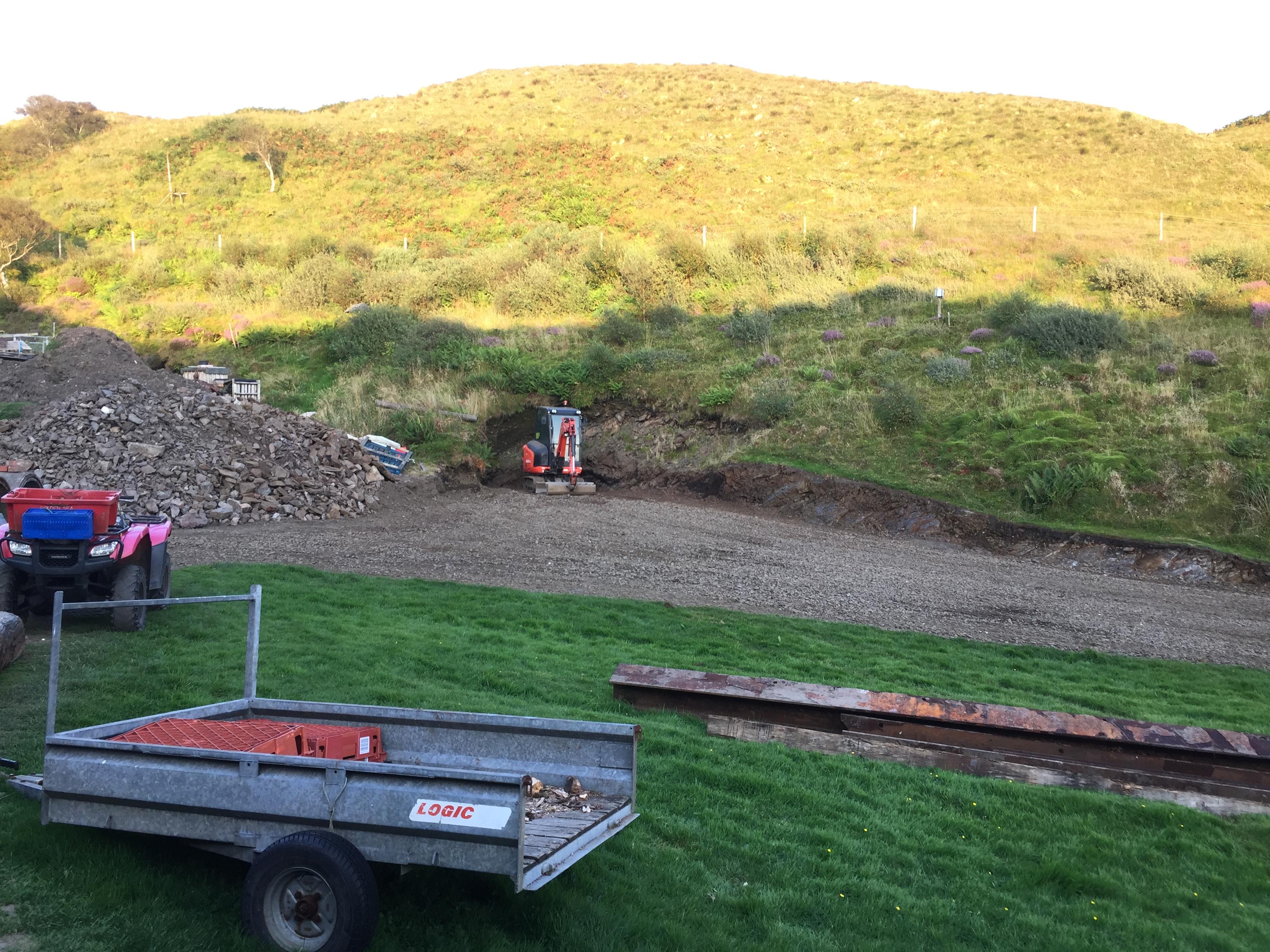

this is what I do and am fortunate to have hillsides of good shale to excavate as required.
I did this area last year and it extends 50m to the right (out of photo) where the road goes, all the materials were won from where the digger is and the small cutting to the right of it.
took me about 5 days with a dumper and digger but it’s super solid and only cost me the £400 in hire fees plus the fuel and my time.

Looks good.
I have been impressive by how our rotten rock driveway has done, no pot holes over the five years.
If I was self building and looking to acquire a croft, checking for rotten rock would be on my checklist with utilities.
