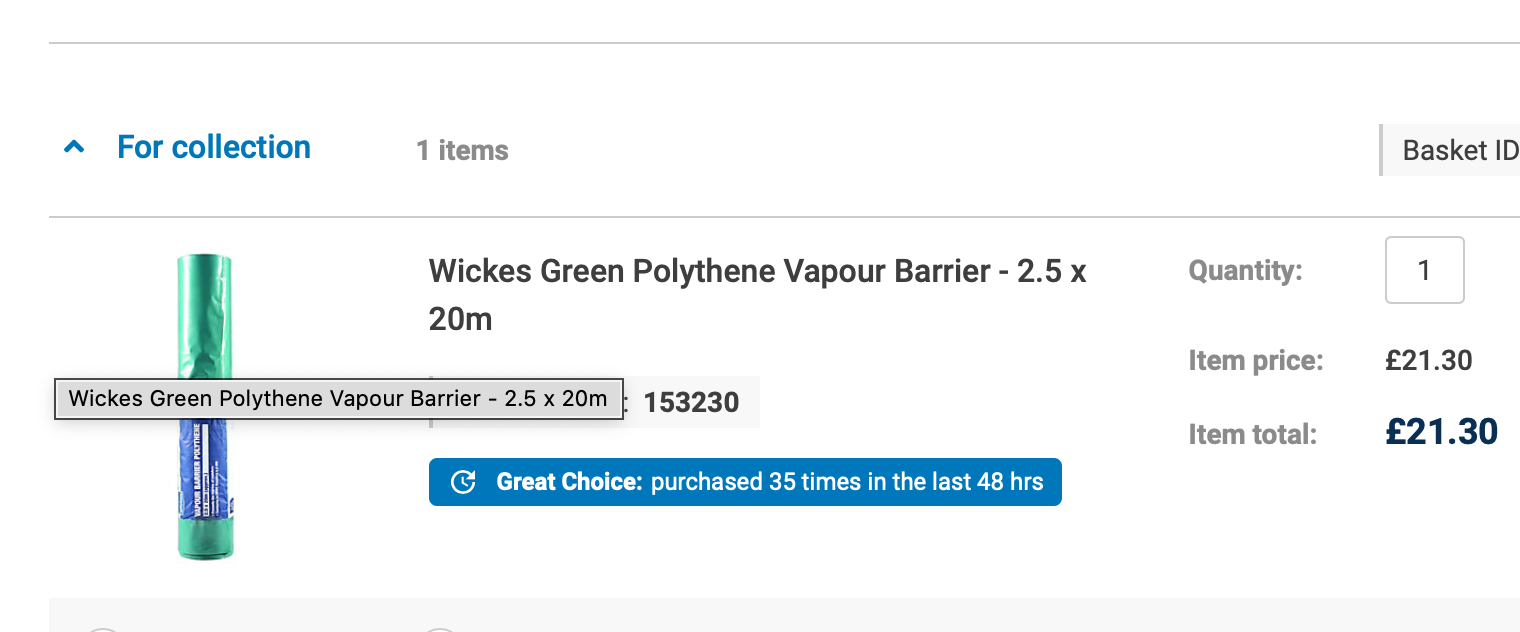

Omnibuswoman Posted May 14, 2021 Author Posted May 14, 2021 Thank you all for your excellent contributions. I have now ordered the wood (a rather eye-watering £2400, but it is quite a big shed!) and have a couple of outstanding questions... The timber store couldn't supply the 30 sheets of 2.4x1.2 11mm OSB 3 that I wanted. He said it is really hard to get hold of OSB at the moment, and offered me 9mm pine plywood sheets instead. Will these be adequate? Or should I go on a search of the south west for OSB? I found this product at Wickes: Is this the correct product for the membrane between the stud and the cladding? Insulation - looks like I will use mineral wool. Will 50mm depth suffice, or should I be stuffing the frame with 100mm? The workshop won't be an office or anything, I'm more interested in stopping it freezing over in winter and boiling in summer - it is basically a rather large shed. Many thanks!

SimonD Posted May 14, 2021 Posted May 14, 2021 1 hour ago, Omnibuswoman said: I've managed to track down 30 sheets of OSB from a local builder's merchant. £25 a sheet plus VAT - almost £1k!! But I'd rather get it right and have the workshop outlive me than see it decay and feel that I could have done better. The chap from the BM said prices have doubled recently....? Yikes, that's expensive! But yes, OSB supply is a problem. Is the pine plywood you've been offered definitely a structural grade? Probably Elliottis pine if it is, I'd guess. The pine plywood should be fine for sheathing, it's been used for donkeys for sheathing. The only times you need to worry about mould is if the moisture content in the wood becomes too high, but then you're likely to get problems with the osb too. If your shed is built right, it'll be dry enough and ventilated enough so no need to worry. Don't whatever you do put that vapour barrier you linked to above on the outside. You need a breather membrane. Your builders merchant should have something on the shelf that'll do the job. I'd recommend you go for 100mm insulation at least. HTH. 1
Omnibuswoman Posted May 15, 2021 Author Posted May 15, 2021 Many thanks HTH. I have cancelled the OSB order and reordered the pine ply, which he assures me is structural, and is 60% of the cost of OSB. I have identified Tyvek as a popular breathable membrane choice, which seems it will do the job. Quick question: is it important not to have the insulation touching the ply or the membrane, or does it not matter? Thanks! M

Marvin Posted May 16, 2021 Posted May 16, 2021 Breathable membrane let's the moisture out of the studwork = outside side of the stud wall makeup. Plastic sheet stops moisture entering the studwork = inside side of the stud wall.

Omnibuswoman Posted May 16, 2021 Author Posted May 16, 2021 3 minutes ago, Marvin said: Breathable membrane let's the moisture out of the studwork = outside side of the stud wall makeup. Plastic sheet stops moisture entering the studwork = inside side of the stud wall. thank you. Should I put a layer of plastic sheeting between the ply and the stud, or just tape up the ply joins?
Marvin Posted May 16, 2021 Posted May 16, 2021 Outside to inside: Cladding Batten Tyvek Thin ply Studwork Insulation and services in studwork. Plastic sheeting Internal finish say plasterboard or ply or OSB. There are discussions about the plastic required by building regs but not mandatory for sheds 1
