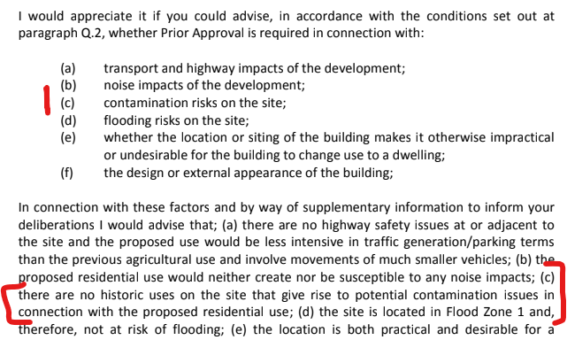

kxi Posted May 5, 2021 Posted May 5, 2021 For the Class Q approval I don't recall being required to have a contamination report, and checking now I see the planning consultant addressed this like this: In the planning officer's report they said: "The council's environmental health officers have been consulted and raise no objection. From the planning history there appears to be no historic uses which may give rise to concern'" I suspect a high % of class Q barns involve an asbestos fibre cement roof. Ours had a 385m2 1960s asbestos roof that was removed by a demolition contractor experienced with this, but not a specialist asbestos remover. If you don't know the full history of the property you may want a contamination survey done for your own sake in any case. 1
IanR Posted May 5, 2021 Posted May 5, 2021 Our LPA takes a very different view on all change of use from non-resi to resi. It requires the Phase 1 to get the history, and a walk-over to determine if there are any potential risks. If any risks are found then a Phase 2 is required. I assumed this was the norm, as every Class MB/Q and "normal" Barn conversions I researched had the same conditions attached. 1
