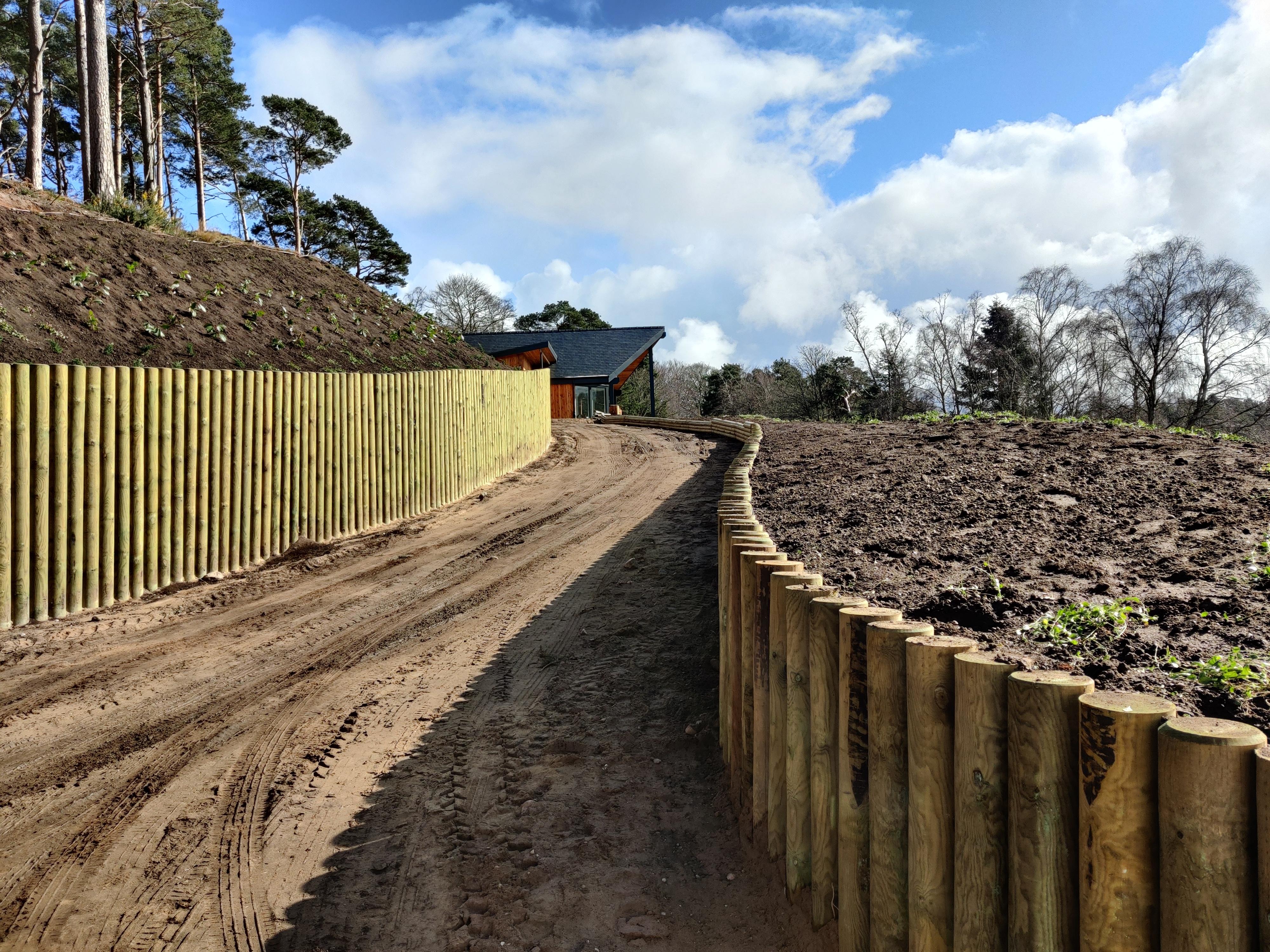

JohnMo Posted April 3, 2022 Share Posted April 3, 2022 We used 150mm round posts, about a metre under ground and 2m above for the tall ones, about 900mm above and 600mm below ground for the short ones. Below ground is set in concrete. Membrane is used at back off the posts, allow water out and keep soil from washing out. 4 Link to comment Share on other sites More sharing options...
Gus Potter Posted April 3, 2022 Share Posted April 3, 2022 @JohnMo That does look good I think, once it's planted up and weathered a bit..better still. Does not look like you are retaining the full 2.0m height on the high side though so probably not that much load on it. Could be a haven for insects and solitary bees especially in the winter as the soil at the back keeps things a bit warmer. Link to comment Share on other sites More sharing options...
JohnMo Posted April 3, 2022 Share Posted April 3, 2022 The right side is closer to 1m the left closer to 2m, the soil level is about 200 to 300mm below top of pole of the left retaining wall. There is a flat area about 2m wide, it then rises up 6 to 10m of very compact sand covered in soil. Link to comment Share on other sites More sharing options...
