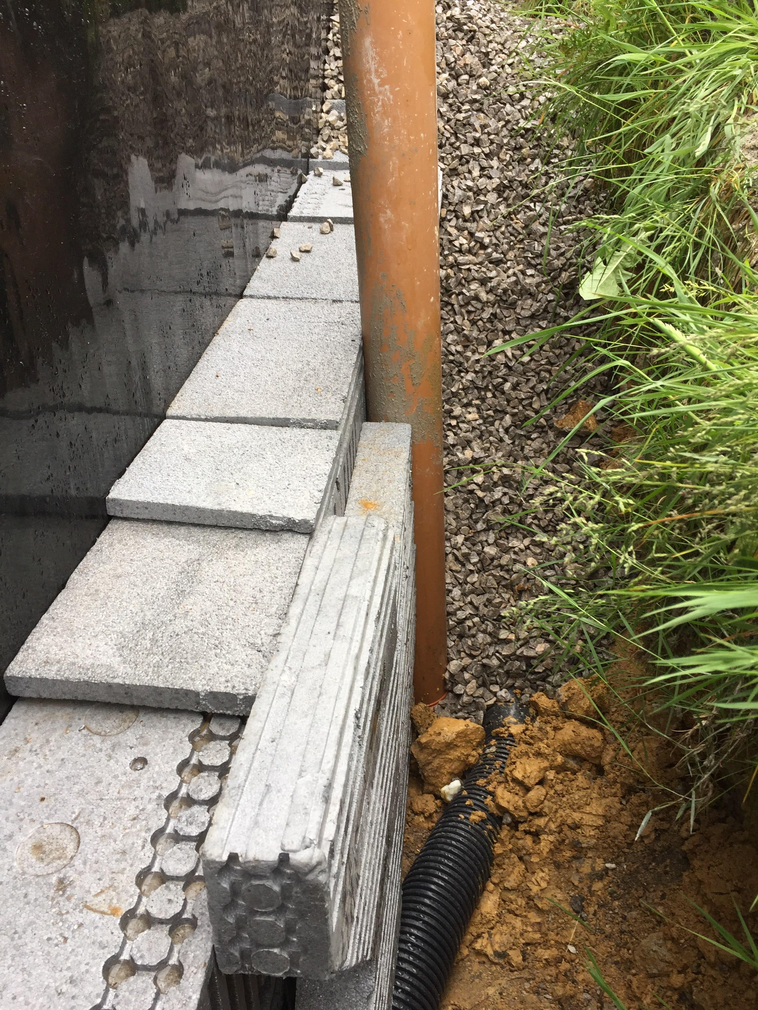

Adam2 Posted April 24, 2021 Posted April 24, 2021 We are building a large pile of EPS off-cuts, many with the plastic web embedded. I understand that recycling is not really an option. Would appreciate hearing what you've done/are planning to do. I have one possibility so far which may be hopeless, let me know ? Our garage will be a double skinned wall with lightweight blocks and externally rendered, interior plasterboard on battens. We could fill the cavity with EPS offcuts. If we did this I guess we'd need a membrane of some sort to improve air-tightness. We weren't planning to insulate the garage as it's on a raised platform so will have no floor insulation - it's not part of the house - attaches to a side wall with an exterior door in between it and the house. Is this likely to have any meaningful benefit - will the hassle of fitting be worth it?

willbish Posted April 24, 2021 Posted April 24, 2021 I buried all my off cuts in a small retaining area against the side of the house. Was really time consuming but I thought as I'd paid for the insulation I may as well experience the benefit of it. 2
recoveringbuilder Posted April 24, 2021 Posted April 24, 2021 We offered ours for free and had 3 different people take a vanload each, the rest we put in the slab for the garage. 1
