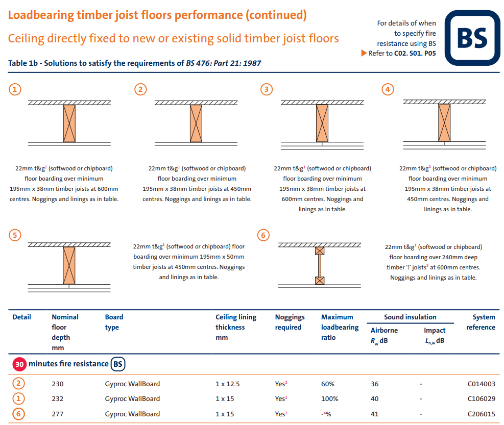

MortarThePoint Posted April 21, 2021 Author Posted April 21, 2021 56 minutes ago, Mr Punter said: 15mm board on ceilings with 600mm centres please. If you don't, it is nog-tastic. Would I want this for fire resistance as well? I think 3 storeys requires 30 minutes and on 600mm joist centres the table below says 15mm if using Wallboard. That said, the White Book where that table comes from has lots of different and somewhat confusing tables. I'm going to get bored of carrying heavy sheets of plasterboard through the scaffolding.

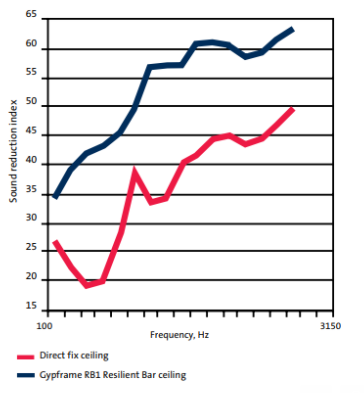

MortarThePoint Posted April 22, 2021 Author Posted April 22, 2021 (edited) Mounting the plasterboard on Resilient Bar (or Resilient Channel as the US call it) could be a useful approach. It reduces my centres to 400mm or 450mm and also helps reduce sound transmission: I think this may be based on two layers of plasterboard, but one would still give benefit. https://onlineinsulation-sales.com/resilient-bar-rb1-45mm-x-16mm-x-30m-138-p.asp Edited April 22, 2021 by MortarThePoint
