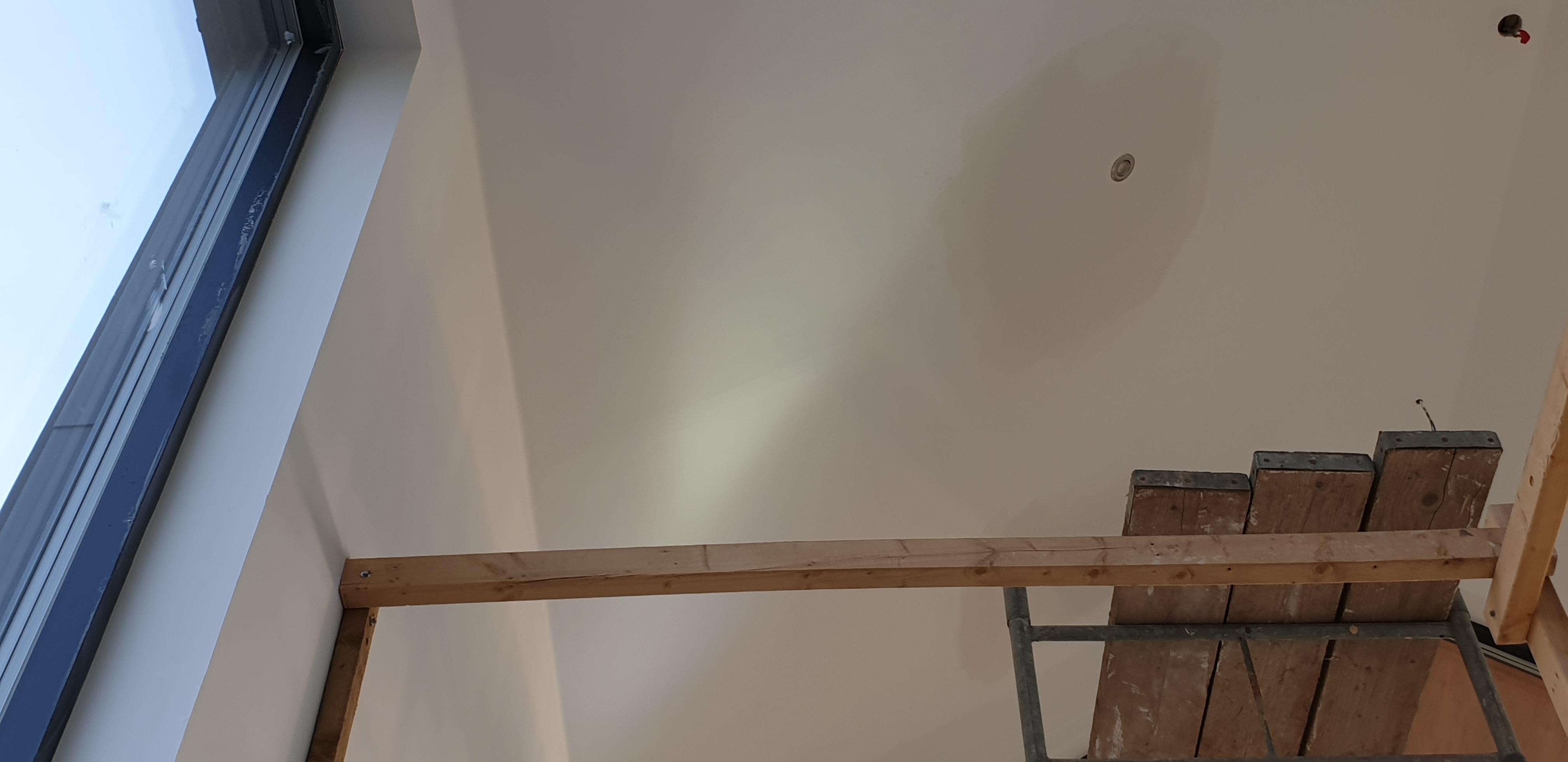

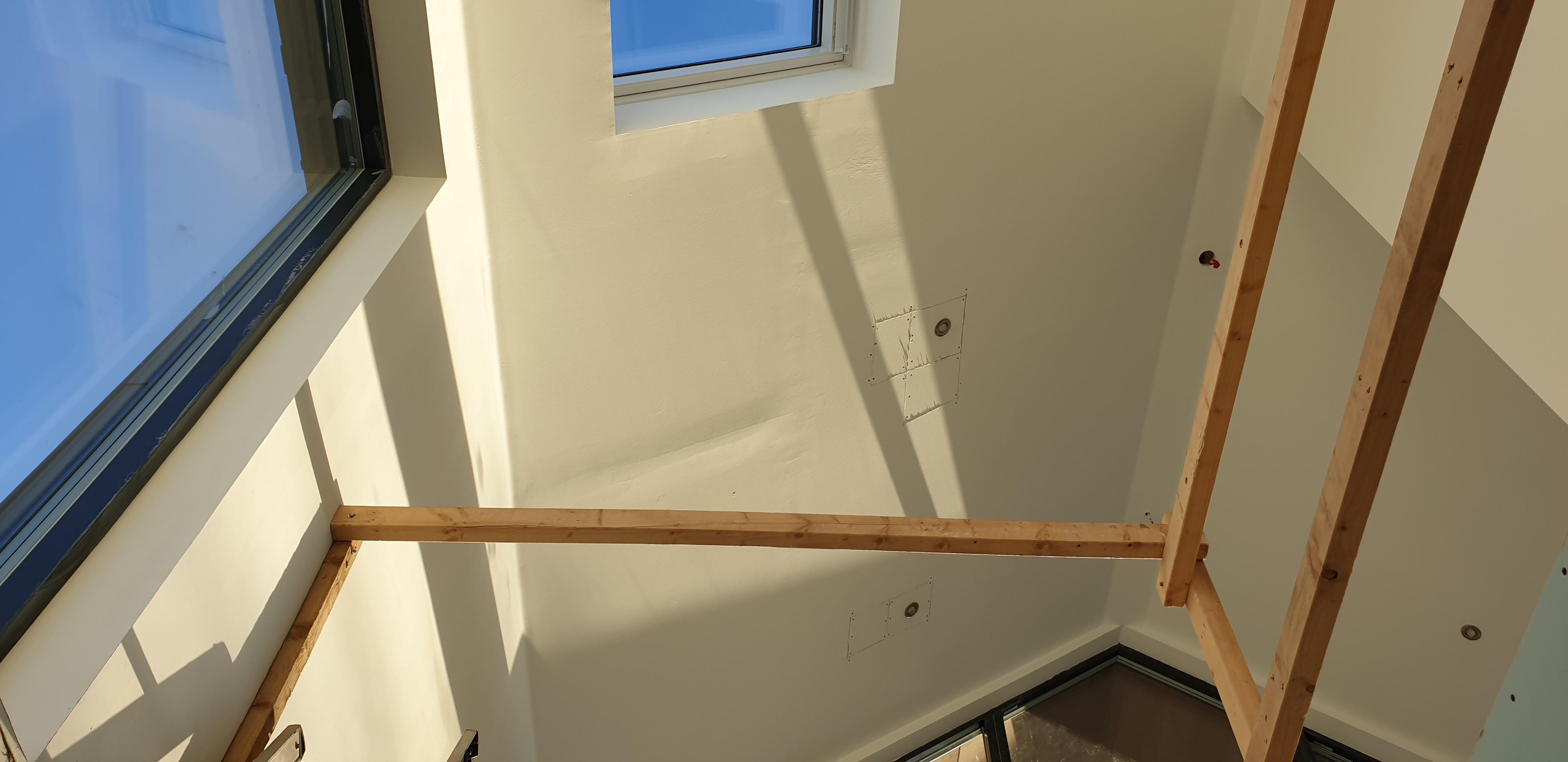

Ralph Posted April 22, 2021 Posted April 22, 2021 On 20/04/2021 at 22:13, Declan52 said: A simple straightedge like a level across the wall will show up bad work. Sunlight can cast shadows across a wall to really highlight dips and bumps and rough trowel work. A bright light/ torch will also work but just not as effective. It should also feel nice and smooth. Below you can see the the difference between shining a torch and sunlight to show up issues. New houses here are generally taped rather than plastered.
TryC Posted April 24, 2021 Author Posted April 24, 2021 On 22/04/2021 at 14:17, Ralph said: Below you can see the the difference between shining a torch and sunlight to show up issues. New houses here are generally taped rather than plastered. oh wow, yes, I can see it now, I'm not a professional and I know that looks bad! thanks for sharing!
Ralph Posted April 26, 2021 Posted April 26, 2021 On 24/04/2021 at 13:27, TryC said: oh wow, yes, I can see it now, I'm not a professional and I know that looks bad! And the thing is, depending on the angle of the sun it looks perfect most of the time.
