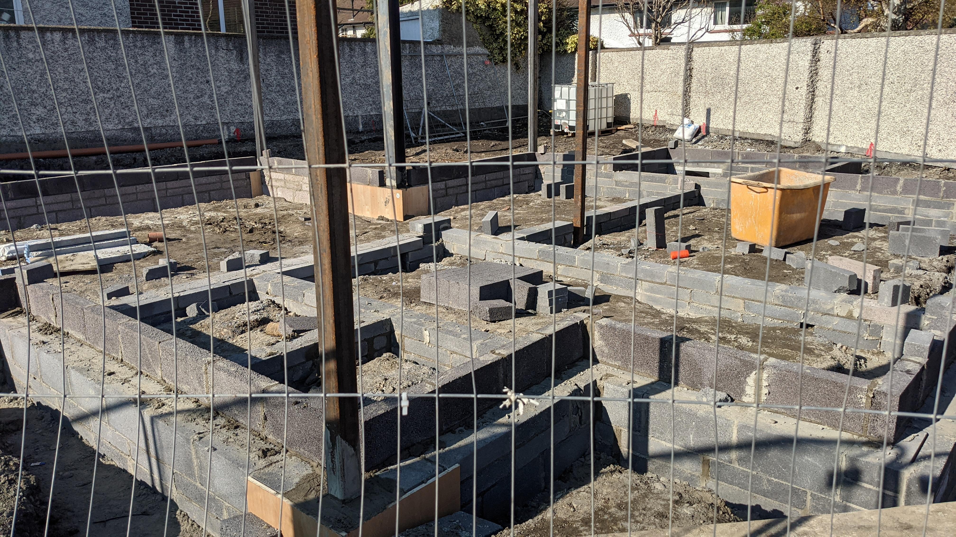

moldy Posted April 17, 2021 Posted April 17, 2021 I noticed 2 of the steel posts have a rusty appearance (see attached photo). They have since been primed without removing the rust. Is that ok? How long is steel expected to last?
Conor Posted April 17, 2021 Posted April 17, 2021 If those steels are in the outside course of block work, they need to be either galvanised or bituminous painted. 1
moldy Posted April 17, 2021 Author Posted April 17, 2021 On 17/04/2021 at 09:02, Conor said: If those steels are in the outside course of block work, they need to be either galvanised or bituminous painted. Expand Does it need fire protection too? What's used for that?
Mr Punter Posted April 17, 2021 Posted April 17, 2021 On 17/04/2021 at 09:40, moldy said: Does it need fire protection too? What's used for that? Expand Probably not if they are inside the blockwork. If they could be exposed to flame they normally have plasterboard, other fire rated board (like Superlux) or intumescent paint. 1
Conor Posted April 17, 2021 Posted April 17, 2021 On 17/04/2021 at 09:40, moldy said: Does it need fire protection too? What's used for that? Expand As they will be embedded in masonry that will have a high moisture content, they need protection from corrosion otherwise they will corrode and eventually (decades) fail. Your engineer would have specified this requirement. No fire protection needed as they aren't exposed to a flame risk. 1

catrionag Posted June 3, 2021 Posted June 3, 2021 On 03/06/2021 at 12:13, markc said: If steel is encased it doesnt need anything (think of rebar inside concrete). If its exposed then it can be either coated or not. Most new bridges are now left unpainted because it has been found that the rust layer protects better than deteriorating paint. Expand Agree. Picture above looks fine to me - just surface rust, and that will eventually form a protective layer that will stop any further penetration unless it's really exposed to the elements or you're right on the coast & getting salt spray 2
George Posted June 3, 2021 Posted June 3, 2021 On 03/06/2021 at 12:13, markc said: Most new bridges are now left unpainted because it has been found that the rust layer protects better than deteriorating paint. Expand That's only for alloys known as 'weathering steels'; in appropriate conditions the rust develops into a protective patina. It needs to be used carefully - particular attention to water shedding details and corrosion losses built into the thickness of the steel. It's a pig to weld, too. But agree on the post - surface discolouring isn't serious and once encapsulated, shouldn't corrode any more. 2
