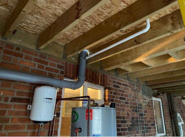

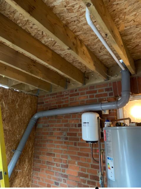

Ben100 Posted April 13, 2021 Author Share Posted April 13, 2021 Sorry for the slow reply. I needed to install the pipe work to show what I mean! As you can see, both the soil pipe and waste pipe are dropping directly down about 1m from the traps. Is this ok? And where should I install the vent? I was thinking of installing a vent pipe out to the roof, in the same length of vertical soil pipe which the waste pipe connects to. Link to comment Share on other sites More sharing options...

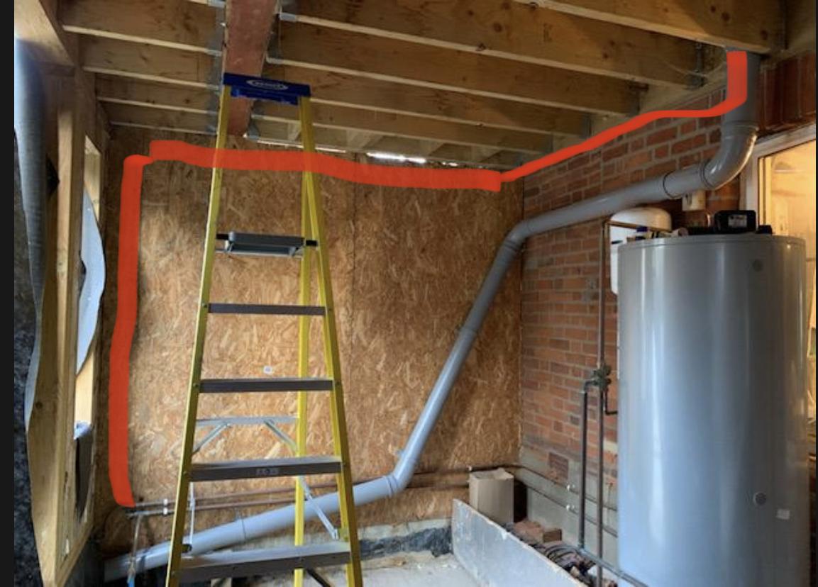

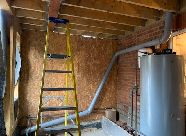

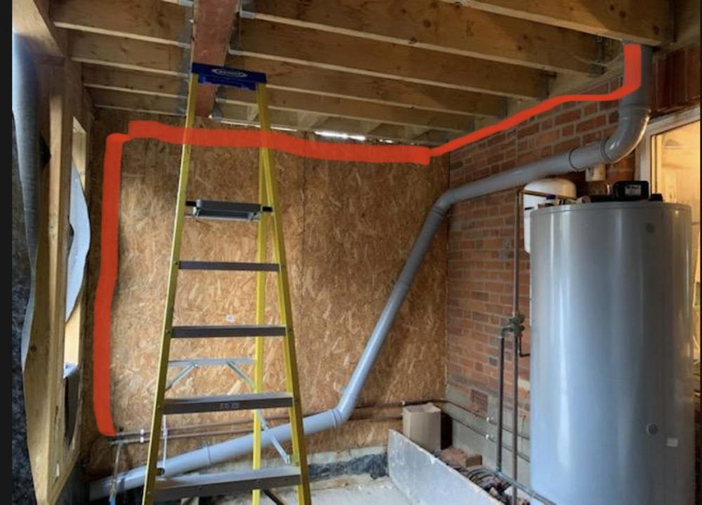

Ben100 Posted April 14, 2021 Author Share Posted April 14, 2021 On 11/04/2021 at 21:24, PeterW said: You will need to put a long radius bend on the bottom of the pipe and secure it properly as it will be under load as you flush down the pipe. What’s the full layout ..?? thanks. I’ve uploaded some pictures above showing the layout ☝️ Link to comment Share on other sites More sharing options...
PeterW Posted April 14, 2021 Share Posted April 14, 2021 That’s really not ideal... should track around the ceiling at 1:80, then when it reaches the far corner it drops down vertically. The other waste should go into the horizontal run not that vertical drop. Link to comment Share on other sites More sharing options...
Ben100 Posted April 14, 2021 Author Share Posted April 14, 2021 35 minutes ago, PeterW said: That’s really not ideal... should track around the ceiling at 1:80, then when it reaches the far corner it drops down vertically. The other waste should go into the horizontal run not that vertical drop. Ok, what’s the reason for this way? The reason I’ve installed it like this is because I didn’t want to come down by the outside wall window. Also, on the other side of the outside wall the pipe makes a 90 degree turn, so I was worried about a big fall before hitting the 90. Link to comment Share on other sites More sharing options...
markc Posted April 14, 2021 Share Posted April 14, 2021 The 45 degree slope and the lower one are both too steep, you risk having the solids stick in the pipe because the water will run too fast. 1:80 slope ensures the solids are carried by the water and they float along Link to comment Share on other sites More sharing options...
Ben100 Posted April 14, 2021 Author Share Posted April 14, 2021 2 minutes ago, markc said: The 45 degree slope and the lower one are both too steep, you risk having the solids stick in the pipe because the water will run too fast. 1:80 slope ensures the solids are carried by the water and they float along Right, got it. I’ll change the 45 to a straight drop and out along the floor at a 1:80. Cheers! Link to comment Share on other sites More sharing options...
markc Posted April 14, 2021 Share Posted April 14, 2021 3 minutes ago, Ben100 said: Right, got it. I’ll change the 45 to a straight drop and out along the floor at a 1:80. Cheers! i would be careful to support the lower bend well because the fall will cause a hammer effect and could separate the fittings. also im not sure thats acceptable to have a vertical followed by horizontal inside the house.. someone else may be able to shed more light on the regs etc. Link to comment Share on other sites More sharing options...

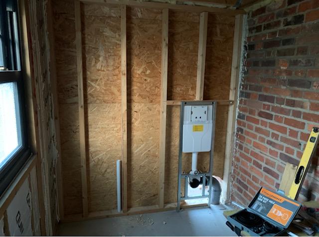

Nickfromwales Posted April 15, 2021 Share Posted April 15, 2021 On 14/04/2021 at 17:02, markc said: i would be careful to support the lower bend well because the fall will cause a hammer effect and could separate the fittings. also im not sure thats acceptable to have a vertical followed by horizontal inside the house.. someone else may be able to shed more light on the regs etc. Nothing wrong with that, but if BRegs were eye-balling this they'd want robust access for rodding / maintenance where the adverse changes in direction were. As long as the first invert at 1000mm turns to horizontal, an air bereak will occur and there is still no need for a stub-stack or 110mm air admittance valve. Basin anti-vac will suffice. 2 Link to comment Share on other sites More sharing options...
Nickfromwales Posted April 16, 2021 Share Posted April 16, 2021 Oh, and beef up the timber work for that WC frame. That ain't enough beef there me ol' china mug Or ban any olympic pie-eaters from that bathroom........ Link to comment Share on other sites More sharing options...
