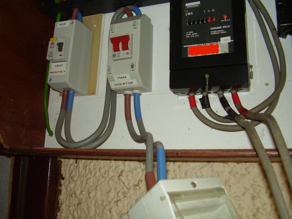

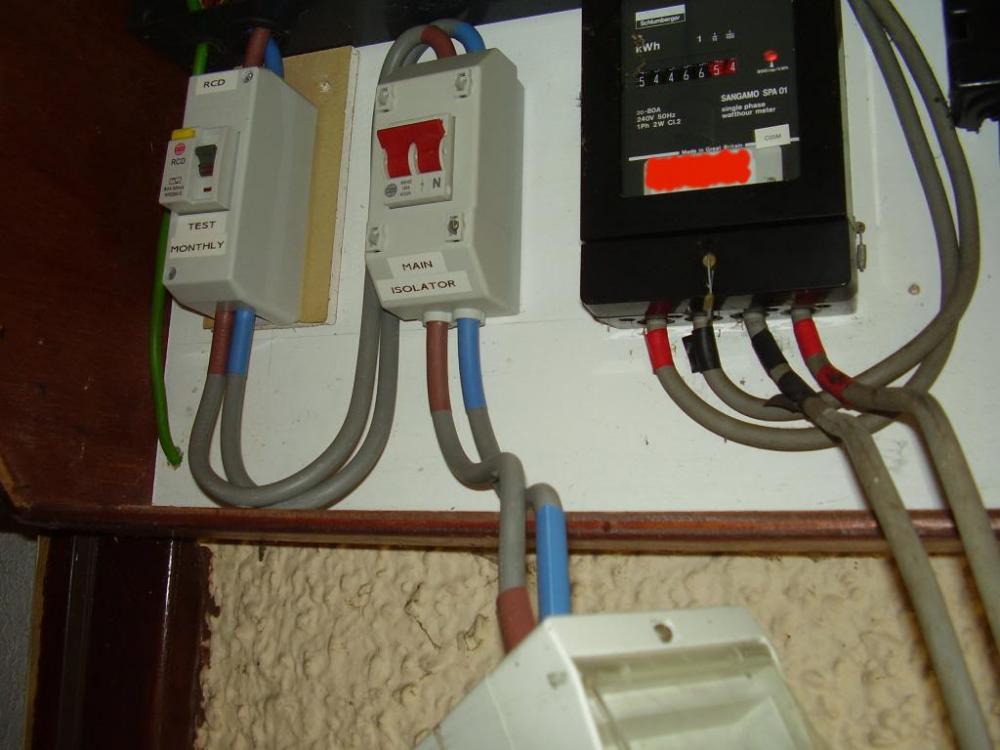

Onoff Posted February 23, 2017 Posted February 23, 2017 Here the ORIGINAL, up front RCD (hanging down) had gone u/s. Using it as a temporary isolator I fitted a permanent Wylex REC2 along with the new RCD. The blue/brown is heat shrink not tape. Thus no visit from the seal fairy required. The meter monkey just nenewed the tails from head to meter then used the supplied tails from the REC2. (Garibaldis and chocolate Hobnobs usually work).
ProDave Posted February 23, 2017 Posted February 23, 2017 I would have thought in the process of the move, the DNO would fit new coloured tails between the head and the meter. Make sure the electrician fits new coloured tails from the CU ready to connect to the meter. The change of colours bugged my on our present house. When I started wiring it, you could only buy red/black. By the time I finished wiring it, you could only buy brown/blue, so it's a mix if the two, with the obligatory "2 colours sticker" I hope you get a better "meter monkey" than my neighbour got. Spot the error.
Jeremy Harris Posted February 23, 2017 Posted February 23, 2017 Why's he labelled the tails the wrong way, and are those tails double insulated? When I got wind of harmonisation and the colour change I went and bought a couple of reels of the old cable. Still have it in the loft. Not saying I'd use it, but it might be handy for anyone doing work on an older house who may not want to be too obvious that the work was done after the change...........
Steptoe Posted February 23, 2017 Posted February 23, 2017 1 minute ago, JSHarris said: Why's he labelled the tails the wrong way, and are those tails double insulated? When I got wind of harmonisation and the colour change I went and bought a couple of reels of the old cable. Still have it in the loft. Not saying I'd use it, but it might be handy for anyone doing work on an older house who may not want to be too obvious that the work was done after the change........... apart from the fact the work wouldnt be compliant, and thus a notice of deviation would be required, for which there would be no justification .
ProDave Posted February 23, 2017 Posted February 23, 2017 42 minutes ago, JSHarris said: Why's he labelled the tails the wrong way, and are those tails double insulated? When I got wind of harmonisation and the colour change I went and bought a couple of reels of the old cable. Still have it in the loft. Not saying I'd use it, but it might be handy for anyone doing work on an older house who may not want to be too obvious that the work was done after the change........... That's the "fault" he labelled the tails backwards. Yes they are double insulated, the DNO up here often uses tails where both the inner core and the sheath are coloured according to function. It's a well known fact that you used to be able to sell red/black cable on ebay for more than the price of new cable. I tried it once, I had some 10 metre lengths of 2.5mm red/black t&e that I pulled out of a rewire, and indeed they sold for more than the cost of new cable.

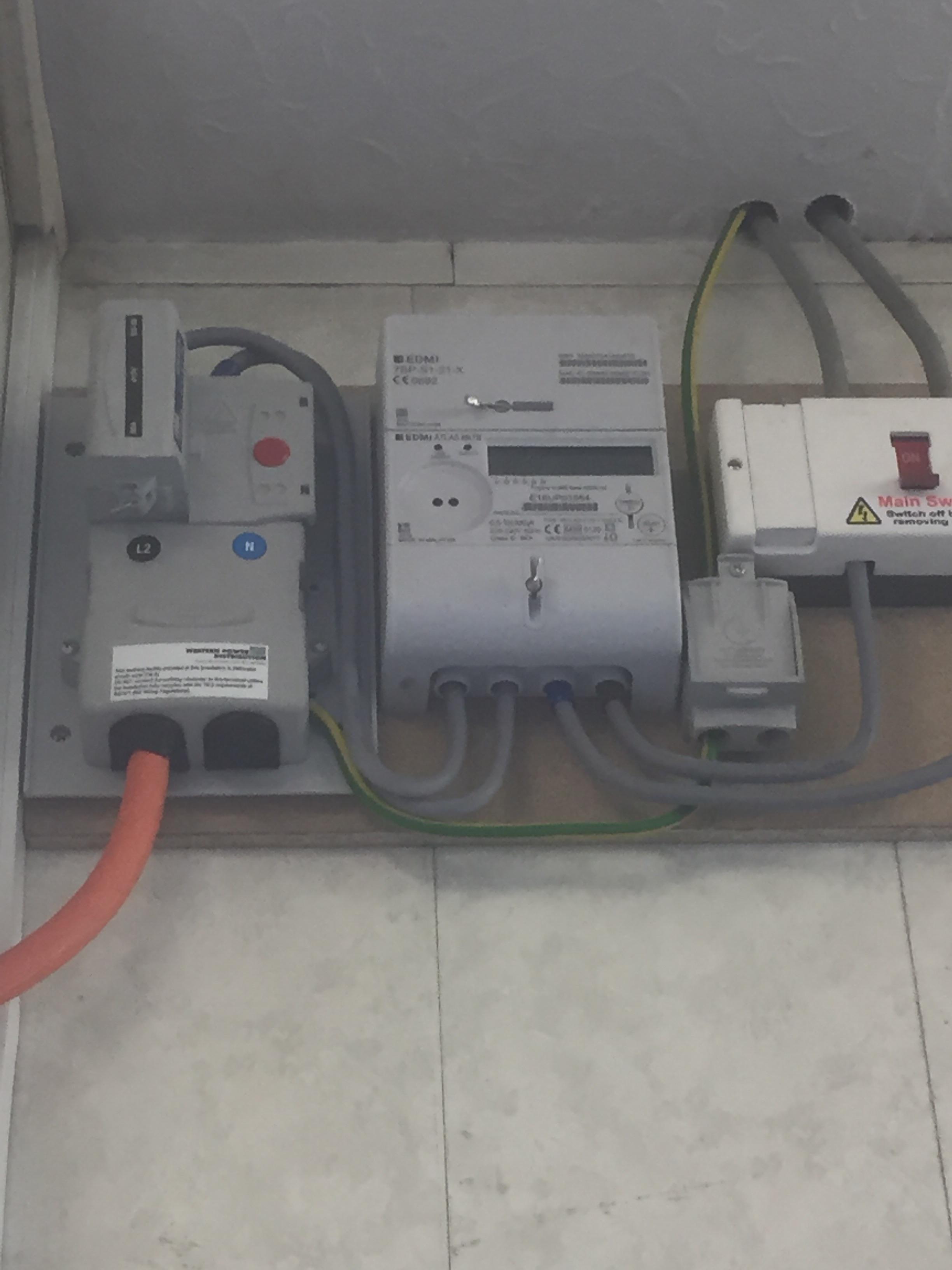

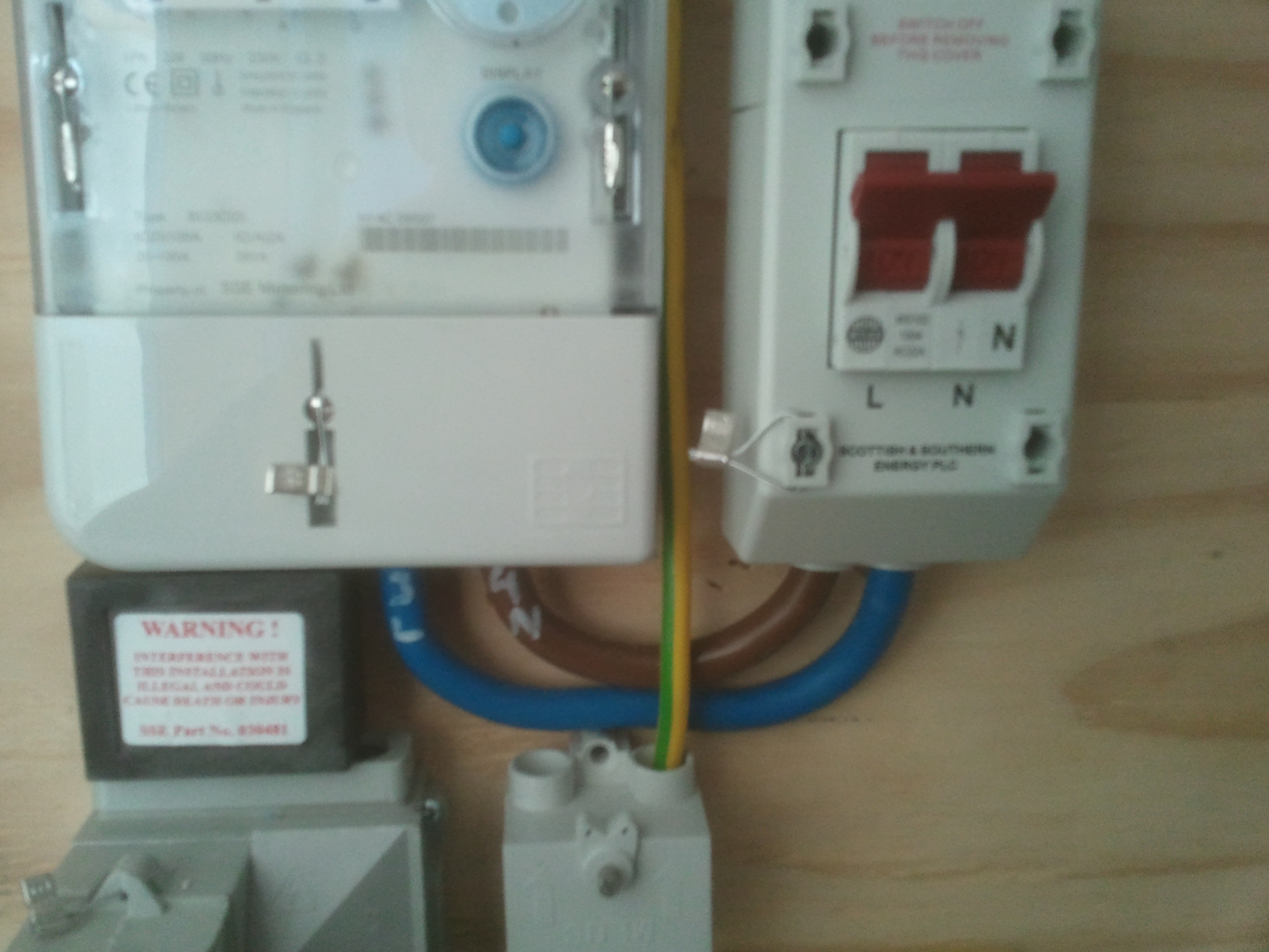

Gone West Posted February 24, 2017 Posted February 24, 2017 13 hours ago, JSHarris said: I like the idea of using double insulated tails with the outer the same colour as the inner; it's always puzzled me why most of the stuff available uses a grey outer and then needs a label or colour coded sleeve to be added. The tails I've recently bought are double insulated with grey outer and either brown or blue inner.
Jeremy Harris Posted February 24, 2017 Posted February 24, 2017 (edited) 5 minutes ago, PeterStarck said: The tails I've recently bought are double insulated with grey outer and either brown or blue inner. Same here. For years that seems to have been standard around here; I can't ever recall having seen tails with an outer sheath the same colour as the inner sheath, which is odd, as it's such a good idea that you'd think it would have quickly superseded the grey stuff that's been around for years. Edited February 24, 2017 by JSHarris
Steptoe Posted February 24, 2017 Posted February 24, 2017 13 hours ago, JSHarris said: I like the idea of using double insulated tails with the outer the same colour as the inner; it's always puzzled me why most of the stuff available uses a grey outer and then needs a label or colour coded sleeve to be added. I should have put the reels of old cable up on ebay, as I've never had either a reason or desire use it in all the years I've had it sat here; it was an impulse buy that ended up being thwarted by the regs. Might stick on ebay when I clear out the loft before we move, perhaps with a note that using it would be non-compliant to cover my backside. IIRC there's at least two full reels up there, maybe three. 21 minutes ago, PeterStarck said: The tails I've recently bought are double insulated with grey outer and either brown or blue inner. Common misconception The tails are NOT double insulated They are insulated and sheathed, there is a big difference. Having 'common colour' tails is a fairly common thing BTW, I've even changed some old red&black common colour this week.

Jeremy Harris Posted February 24, 2017 Posted February 24, 2017 (edited) 2 hours ago, PeterStarck said: The tails I've recently bought are double insulated with grey outer and either brown or blue inner. Thought I'd have a look around to see how common double insulated tails with the right outer sheath colour are, and how easy they are to buy. The quick answer is, not that easy!. The usual online places, like TLC: https://www.tlc-direct.co.uk/Main_Index/Cable_Index/Tails_Meter_New/index.html , Screwfix: http://www.screwfix.com/p/prysmian-meter-tails-1-core-grey-25mm-x-1m-reel-double-insulated-pack-of-3/95832 Quickbit: https://quickbit.co.uk/meter-tails-double-insulated-cable , Discount Electrical: http://www.discount-electrical.co.uk/section.php/108752/1/6181y-double-insulated-meter-tails etc, that I've used in the past, all only seem to stock tails with the grey outer sheath, but City Electrical Factors seem to stock double insulated tails with blue or brown outer sheath, which may be of help to anyone looking for this stuff: https://www.cef.co.uk/catalogue/categories/cables-and-accessories-double-insulated-tails-6181y . My experience with them locally has been that their prices were a bit high when I got a price for all our cable, fittings etc, plus you need a trade account to buy from them (not a problem, I found, they seemed happy enough to let me have one for a self-build). Edited February 24, 2017 by JSHarris
