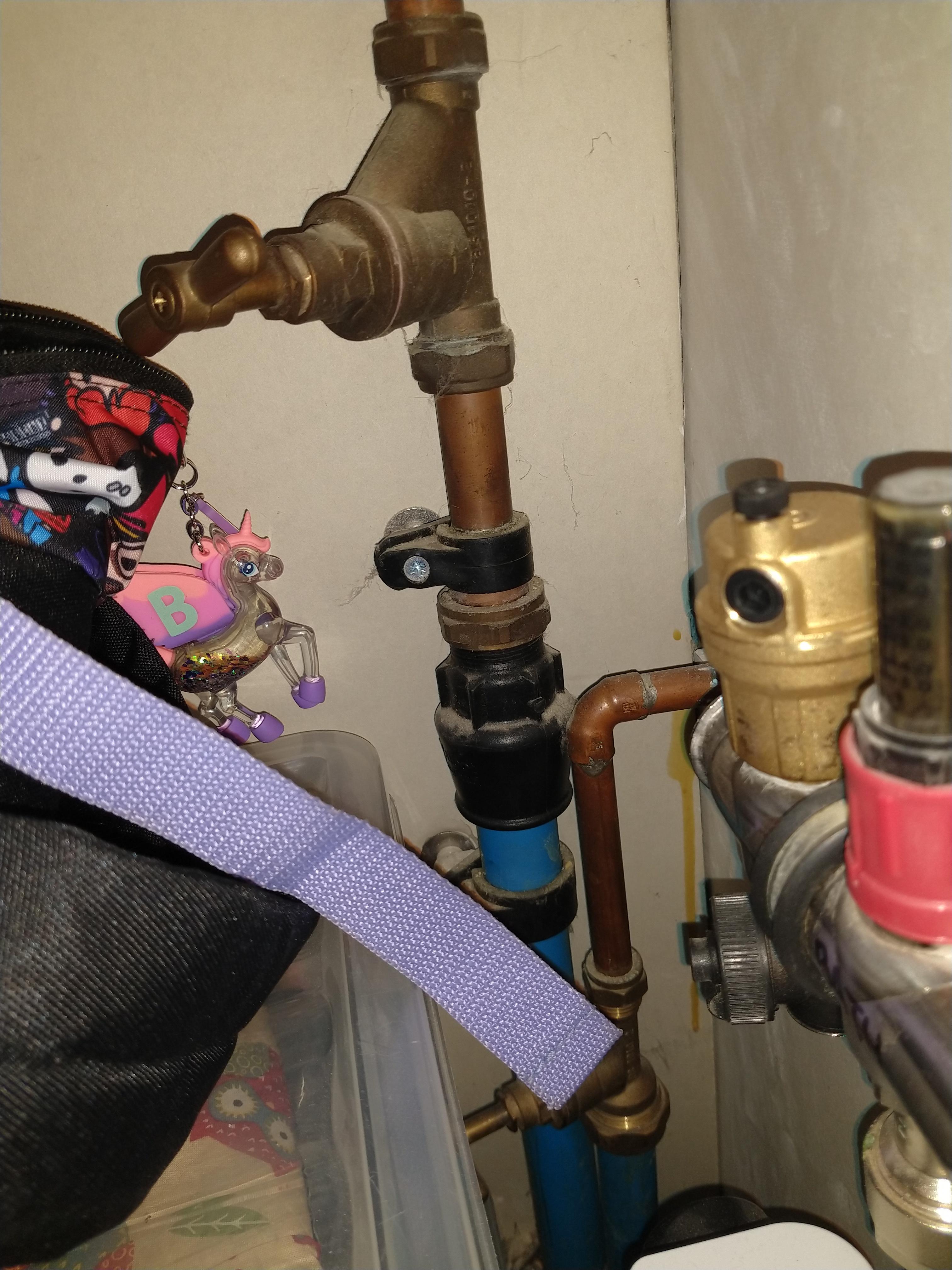

PI build Posted April 8, 2021 Share Posted April 8, 2021 We are having a 32mm MDPE mains supply fitted and SES our water supplier does not allow any fittings before the shut off valve. Are plastic valves suitable for this? I found one source that suggested they were not. Link to comment Share on other sites More sharing options...
PeterW Posted April 8, 2021 Share Posted April 8, 2021 Nothing wrong with plastic / ABS type stop valves, they are essentially what is in the bottom of every isolation chamber on every street. Just buy decent quality. Link to comment Share on other sites More sharing options...
andy Posted April 8, 2021 Share Posted April 8, 2021 Well technically of course they are fine but our new connection Southern Water insisted it had to be a brass stop cock, wouldn’t consider anything else. Link to comment Share on other sites More sharing options...
PI build Posted May 8, 2021 Author Share Posted May 8, 2021 Thanks for all the replies. We spend ages looking for a valve with for 32mm MDPE inlet and 28mm Copper outlet with compression fittings, then found out that Plasson make a compression copper adapter set so you can fit a 28mm copper pipe to a 32mm MDPE compression outlet. Our supply pipe installation has now been approved by our water supplier Link to comment Share on other sites More sharing options...

PI build Posted July 2, 2021 Author Share Posted July 2, 2021 Hi Hilldes, Just noticed you referenced my post, we got the parts from City Plumbing. Stop cock looks like this: Still waiting for SES to connect us to the water main. I think we are at the bottom of the queue as they are connecting for free to bypass the existing lead pipe. Link to comment Share on other sites More sharing options...
