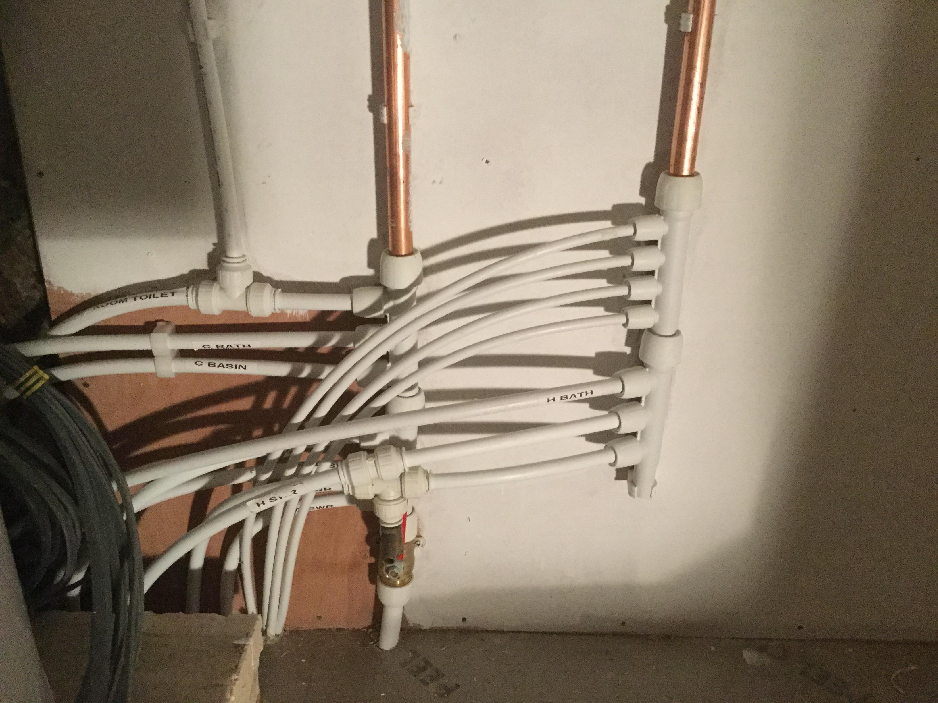

andy Posted April 27, 2021 Share Posted April 27, 2021 Having finished mine off recently, I would definitely: 22mm hot and cold manifold. Isolated feed to all outlets from there - I went 22mm to 1 shower and bath and 15mm to everything else but that was cos I didn't have 10mm, probably makes sense to where flow not needed. Armaflex lagged everything - I used the self-sealing split stuff, really good but does need taping too where you go round corners. Probably overkill and took ages but hey, it's done now Continuous runs of Hep2O from manifold to outlet (or very close) - no way I would do anything different or use any other pipe. Absolute no brainer I feel here. Long 28mm runs to/from ASHP - due to circumstances these were needed but hell to work with, definitely design out if possible in future... Think that's the main bits from my recent adventures in plumbing. 1 2 Link to comment Share on other sites More sharing options...
Conor Posted April 27, 2021 Author Share Posted April 27, 2021 (edited) Thanks everybody. 10mm hot and cold pipes to all WCs and basins 15mm to showers/baths and kitchen sink. Tee off in kitchen and utility for appliances, boiling water tap etc. 22mm supplies to the manifolds / UVC. At a quick count that means approx 30 individual pipes. I've not seen anything bigger than a 4 port manifold. Do you have to make your own from 22x15mm / 22x10mm tees?! Edited April 27, 2021 by Conor 1 Link to comment Share on other sites More sharing options...
joe90 Posted April 27, 2021 Share Posted April 27, 2021 (edited) You can make your own from copper but I used a few of these https://www.screwfix.com/p/hep2o-plastic-push-fit-reducing-4-port-closed-spigot-manifold-22-x-10mm/2901R?tc BEWARE, you can connect them together but can’t get the remount tool in to get them apart, ask me how I know ?, also I did not have individual shut off valves on each run, just a 1/4 turn isolator on the 22mm feeds into the manifold. How often would you need to isolate a single feed for any length of time? I did tee two toilets rather than buy another manifold, the bottom tee is to a drain tap. Edited April 27, 2021 by joe90 Link to comment Share on other sites More sharing options...
