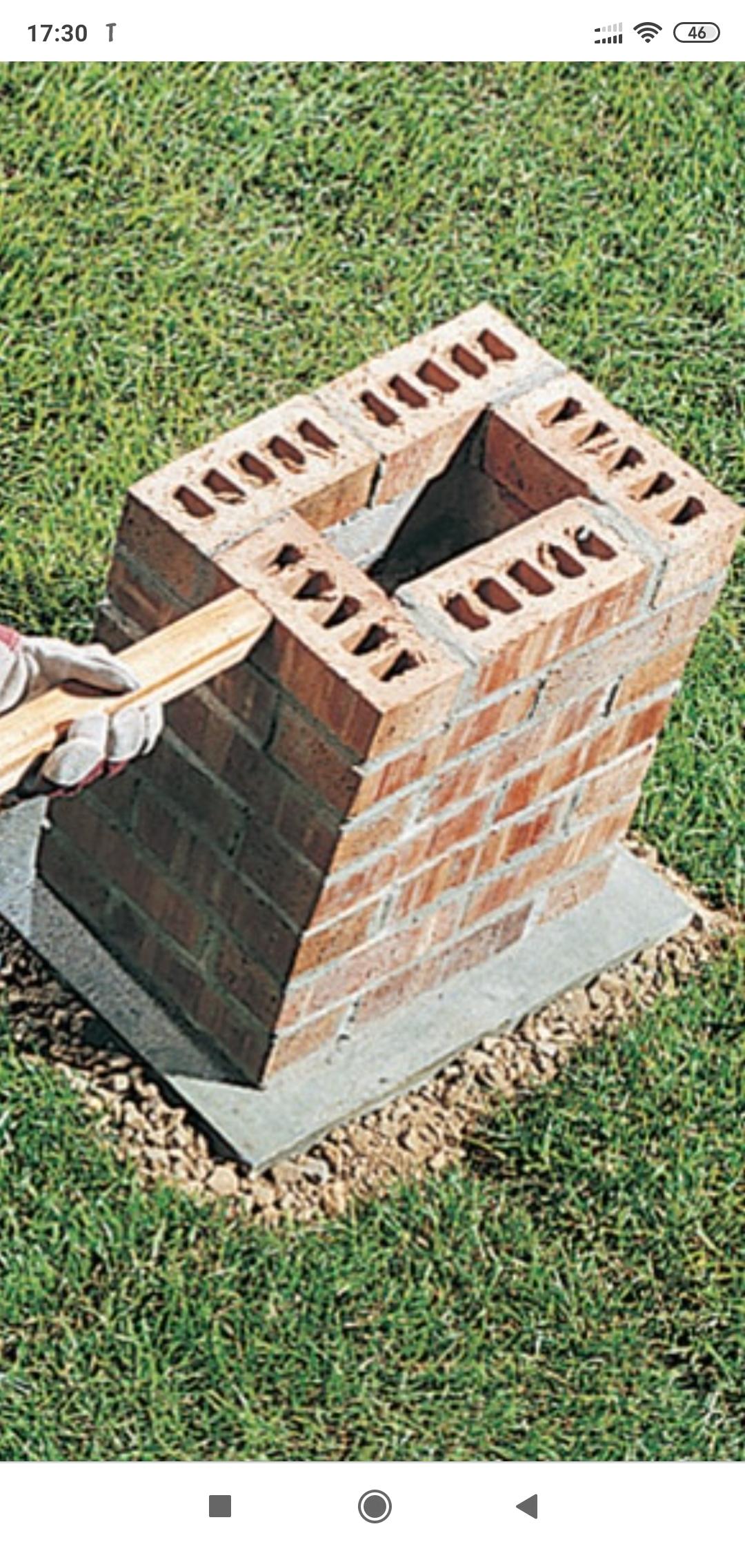

Do you want it straight with no pillars or you don't mind??
I would put a pillar in every 10/11/12 bricks depending on how long this wall is going to be. Put a single course down then measure out and see what suits the length of the wall so all the gaps between the pillars are the same.
The pillar be 2 brick long Infront and behind the main wall. It would look like the pic below with your wall running through the middle in the direction the piece of timber is.

The Georgian one I'm hoping to copy has no pillars (apart from at a small gate).
It's an aesthetic choice, a 200mm thick wall just looks too "heavy" for the garden it would be in.

A single brick wall with no pillars will wobble about in the wind. Unless you want bricks in your vegetable garden your going to need either pillars or make the wall wider.
