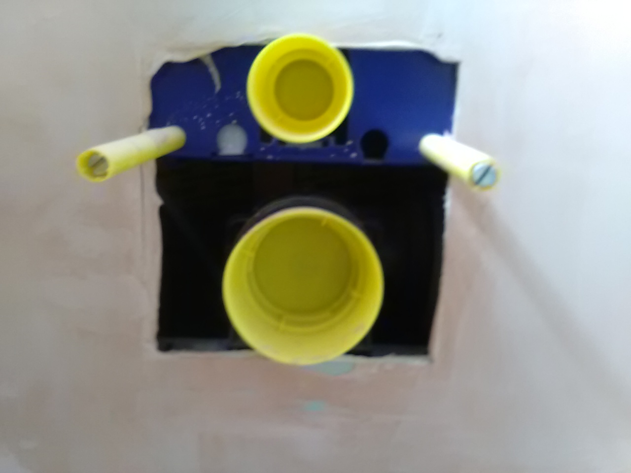

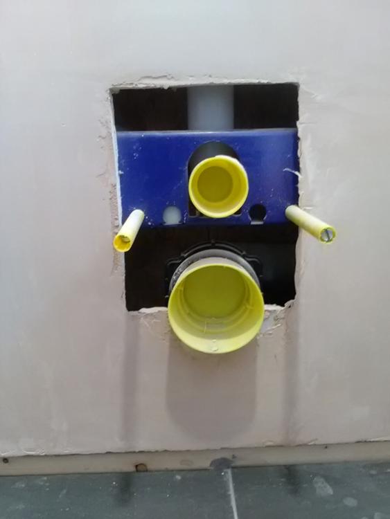

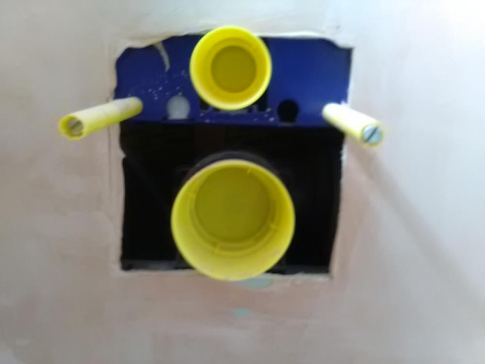

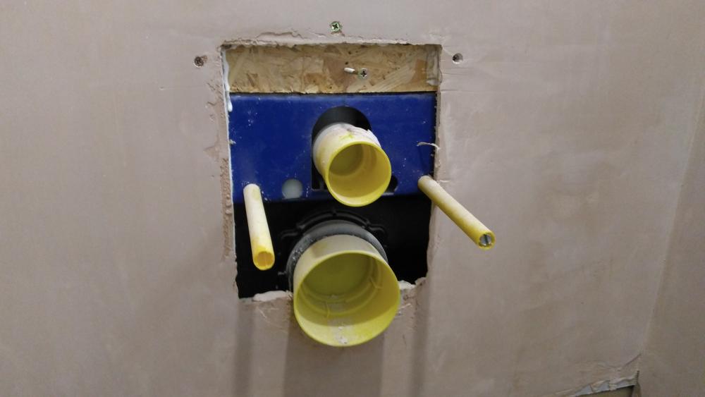

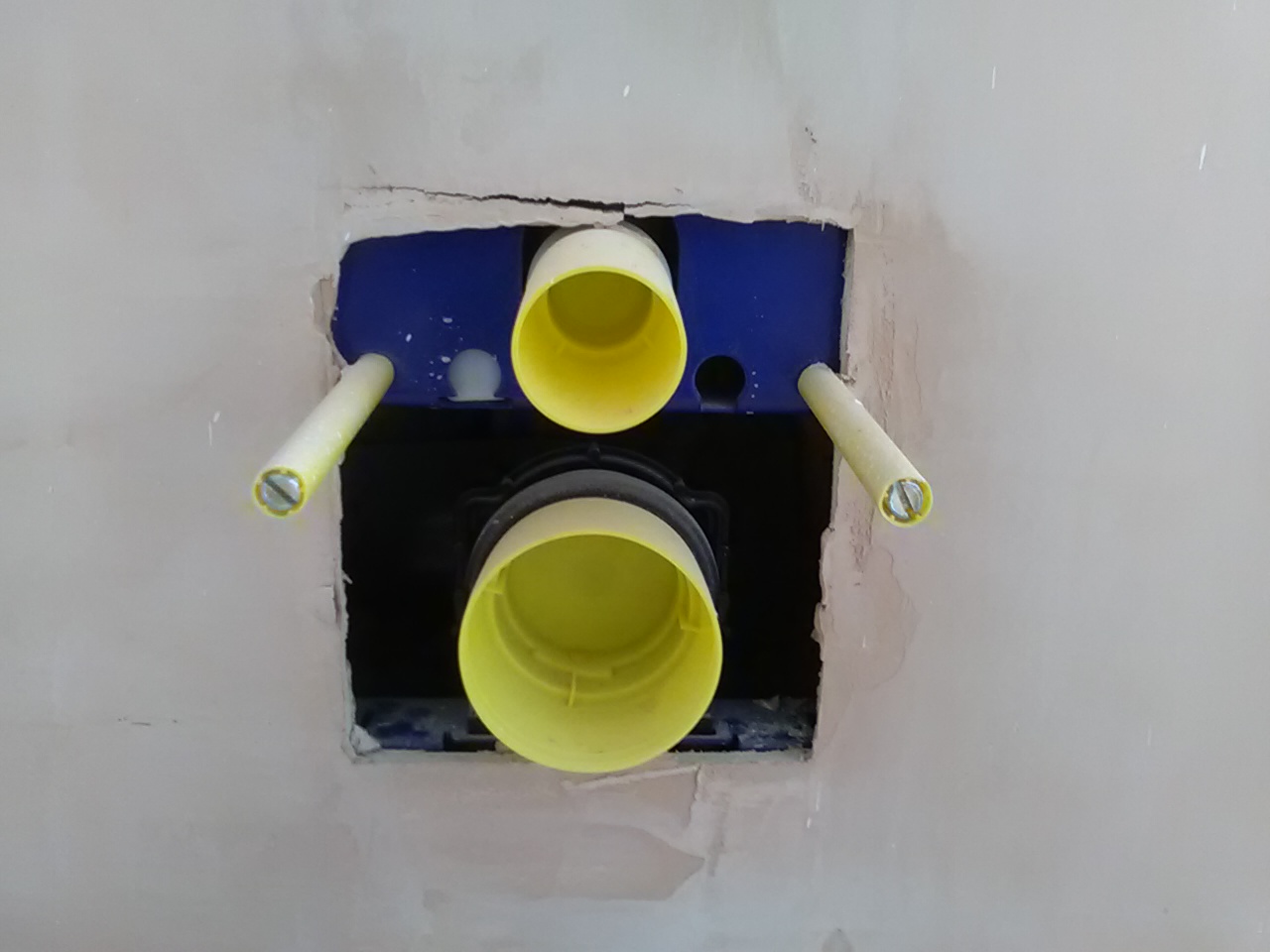

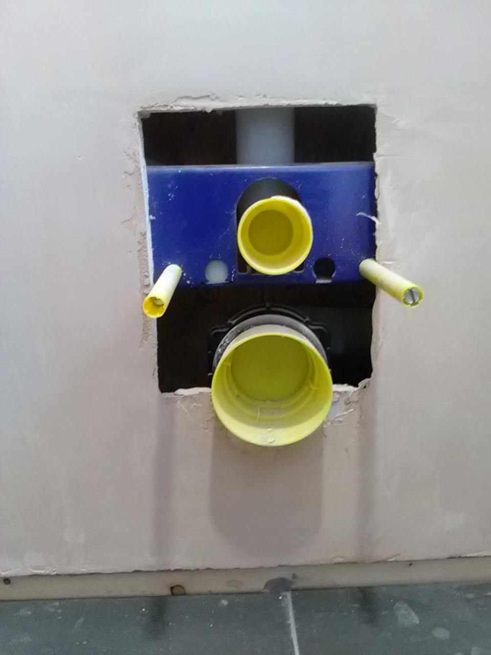

JanetE Posted February 16, 2017 Posted February 16, 2017 We are now at the stage of tiling our (many) bathrooms/en suites and would be grateful for some advice. When the plasterers boarded up around the Gerberit frames they cut large holes in the plasterboard to save them time. We're concerned that when we tile and hang the toilets there will not be enough support and the tiles may crack. Will we need to fill in the gaps at all or reinforce behind? All the frames are hard up against the plasterboard. I've attached photos of the four offending ones so you can see what the problem is.
Oz07 Posted February 16, 2017 Posted February 16, 2017 (edited) That's crap if your loo isn't going to cover that hole. Cut PB off as high as tiling allows (hopefully to the nogs) and replace with ply or backer board with better sized holes. Ply prob be better in this scenario. Edited February 16, 2017 by Oz07
Nickfromwales Posted February 16, 2017 Posted February 16, 2017 It's only the 4th one that bothers me. That would benefit from some 12mm ply ( not PB ) with a hard setting adhesive such as PinkGrip. The weight transfers ( pivots on the bolts ) to the bar below the soil / pan connector with the upper section typically only ever seeing compression from the fixings. . Remember that the pan doesn't even touch the wall where your cutouts are so relax, pack No.4 a bit better, and take yourselves off for a vino. NOTE: For others approaching this point ( boarding ) just get a nice template that sits onto the pan connector and mark the other hole sizes & centres. Take the soil and flush plugs out and bung them or tape them up to protect the seals. Let your boarders just cut a 50mm cutout where the centre of the soil is and leave them board the wall WITHOUT cutting out for the various gubbings. Plasterers and boarders are great at boarding and plastering, but lack tools like hokesaws etc so don't expect any more of you leave them uninstructed otherwise. ( and sorry @JanetE as I can already hear you shouting "now he tells us!" ). Edit to add : mark a vertical plumb line on the face of the template so; 1) you get it spot on after boarding ( as you'll have no other visual reference ) 2) you don't use the template the wrong way around when cutting the holes later. ? 1
Nickfromwales Posted February 16, 2017 Posted February 16, 2017 Re tiling, NEVER use ready mixed acrylic adhesive. Ever. Use a flexible powder floor / wall adhesive and make sure the tiles are buttered and the wall is full bed. Plumbers or sparkys diamond core drills will cut through later so up to you how brave you feel, but that's what I use for porcelain. Another cheat is to have two tiles meet at the centreline of the WC so you can nibble two semi-circles out of each tile accordingly. 1
JanetE Posted February 16, 2017 Author Posted February 16, 2017 1 hour ago, Nickfromwales said: It's only the 4th one that bothers me. That would benefit from some 12mm ply ( not PB ) with a hard setting adhesive such as PinkGrip. The weight transfers ( pivots on the bolts ) to the bar below the soil / pan connector with the upper section typically only ever seeing compression from the fixings ( and sorry @JanetE Maybe I'll forgive you Not quite clear what you're attaching the 12mm ply to?? Stick it on the front, tile around it? Stick it behind and fill the gap? Cut it to the size of the hole and attach some way??? Sorry if I'm being thick
Nickfromwales Posted February 16, 2017 Posted February 16, 2017 Only this one. Slip a small offcut ( x2 ) of 12mm ply say 80x80mm up behind the PB at the top, one either side of the white flush pipe. ( Screw a 6x100mm into the middle of each piece to make a handle so you can pull it tight against the PB ), then screw through the PB into the ply to make 2 ply patresses which are flush with the front of the blue frame. Cut a nice bit of 12mm ply ( 15mm may be better if the PB is 12.5mm and the skim takes the total thickness of the existing wall up to 15mm ), and make a piece that fills the top gap as best as possible. Apply a bit of neat PVA to the ply and your good to tile. Does that suit, Madame?

JanetE Posted February 16, 2017 Author Posted February 16, 2017 (edited) 4 hours ago, Nickfromwales said: Only this one. Slip a small offcut ( x2 ) of 12mm ply say 80x80mm up behind the PB at the top, one either side of the white flush pipe. ( Screw a 6x100mm into the middle of each piece to make a handle so you can pull it tight against the PB ), then screw through the PB into the ply to make 2 ply patresses which are flush with the front of the blue frame. Cut a nice bit of 12mm ply ( 15mm may be better if the PB is 12.5mm and the skim takes the total thickness of the existing wall up to 15mm ), and make a piece that fills the top gap as best as possible. Apply a bit of neat PVA to the ply and your good to tile. Does that suit, Madame? Got it! Thanks Nick, you're a star Edited February 16, 2017 by JanetE

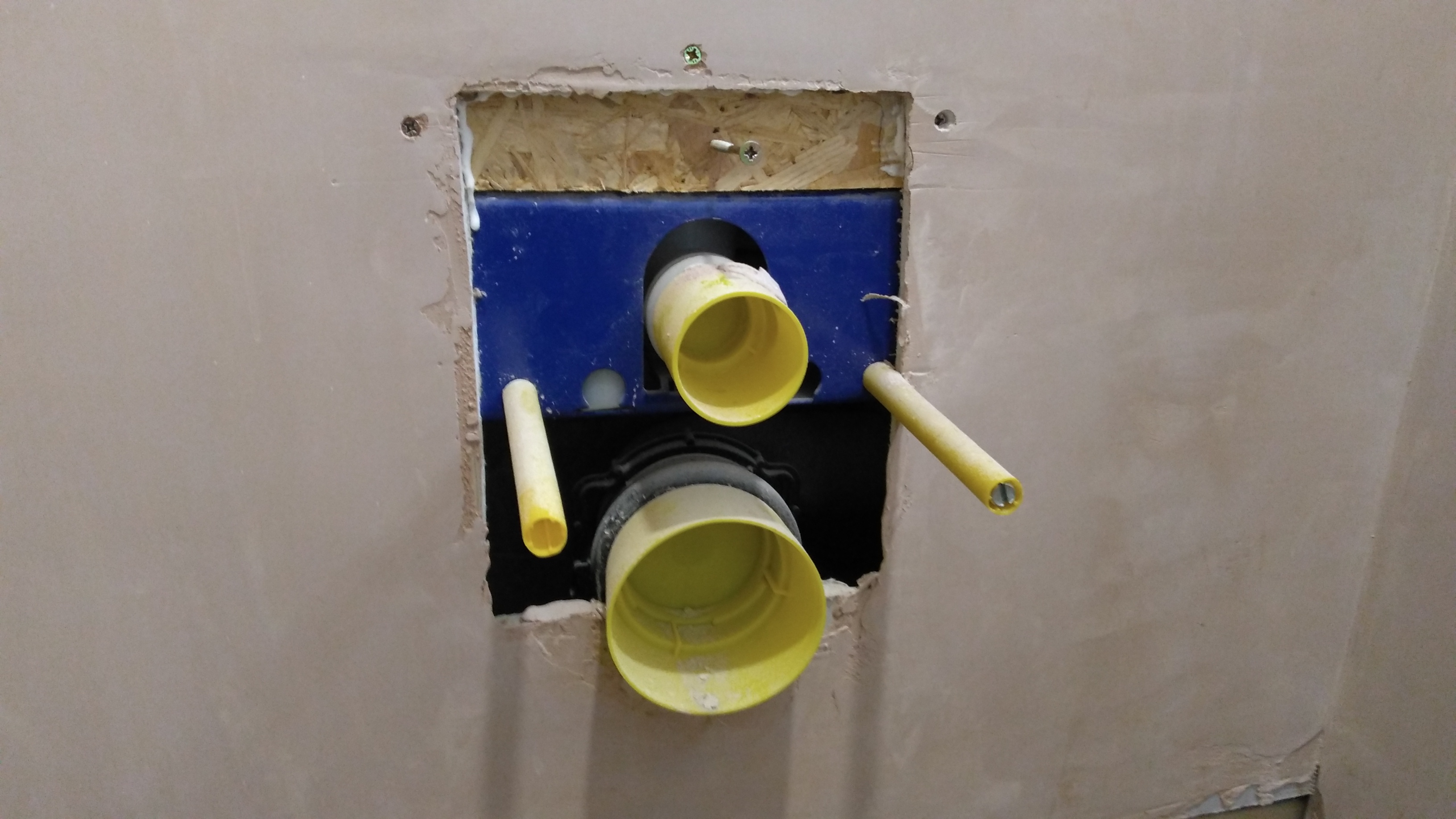

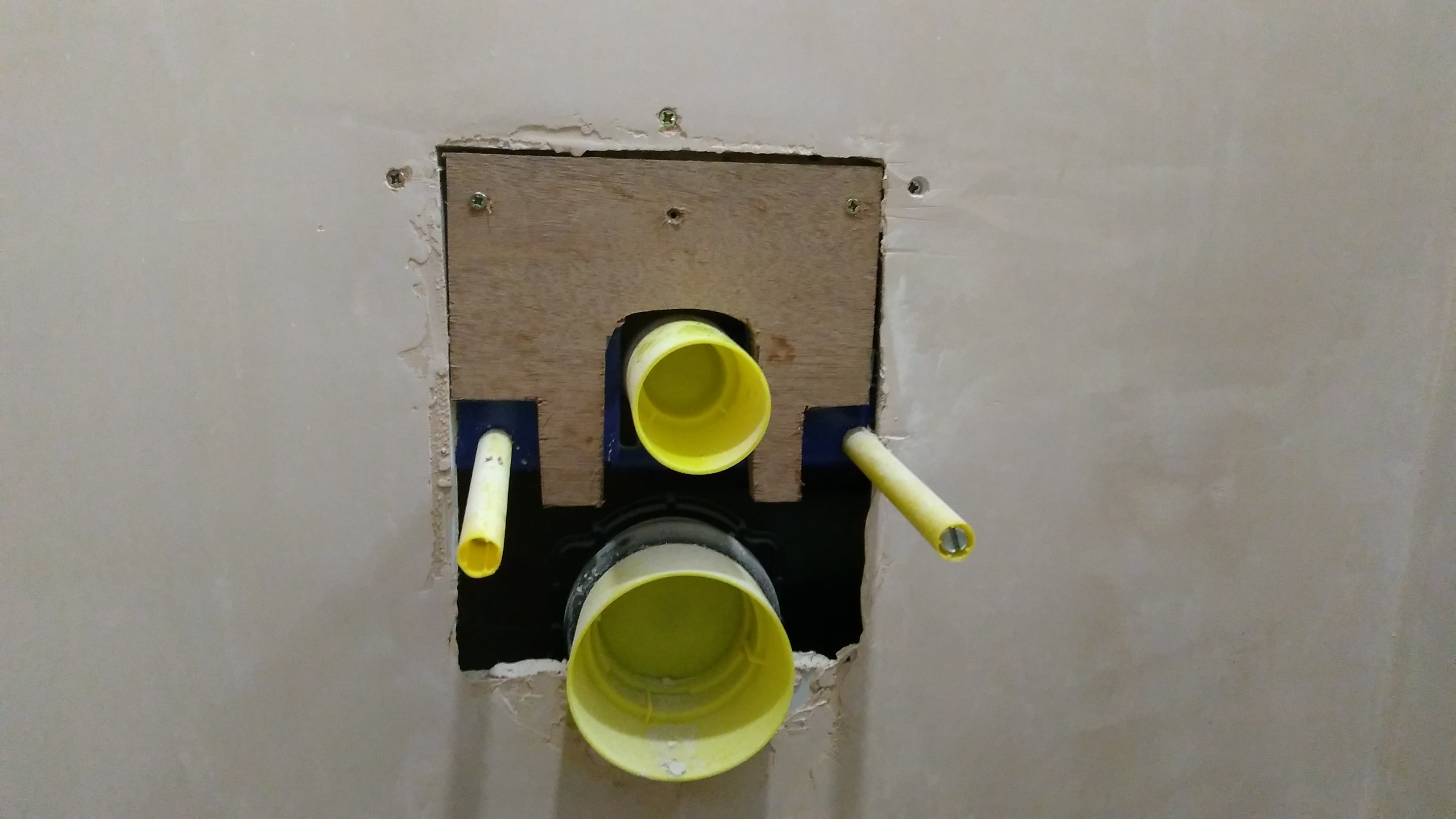

JanetE Posted February 19, 2017 Author Posted February 19, 2017 So I took a piece of OSB which was a bit bigger than the hole. Put a screw in the middle so I could hold it. Put some glue round and screwed it in. Left it to dry. Cut a piece of ply to fit the gap and glued and screwed it. How's that @Nickfromwales??
