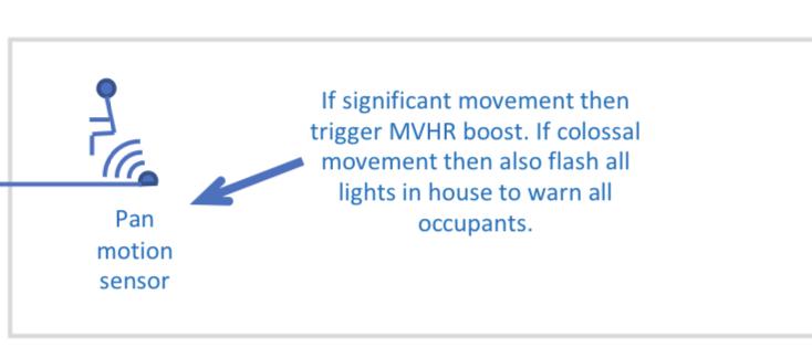

Gav_P Posted March 17, 2021 Share Posted March 17, 2021 I have no knowledge of automated systems, so am following these threads with interest... One bit does confuse me... This image appears to turn up the extractor if someone has a “movement” whilst on the pan... but if they have a “colossal movement” I.e. a big sh*t??.. then all the light in the house flash to warn the occupants! 3 Link to comment Share on other sites More sharing options...
Hilldes Posted March 17, 2021 Author Share Posted March 17, 2021 25 minutes ago, Gav_P said: I have no knowledge of automated systems, so am following these threads with interest... One bit does confuse me... This image appears to turn up the extractor if someone has a “movement” whilst on the pan... but if they have a “colossal movement” I.e. a big sh*t??.. then all the light in the house flash to warn the occupants! Ah you found it. There is actually 3rd level of escalation to the logic. If the motion sensor detects a “super collossal movement” then sound the alarm siren to alert the neighbours too. I wanted to see if anyone actually looked at the detail ? 3 Link to comment Share on other sites More sharing options...

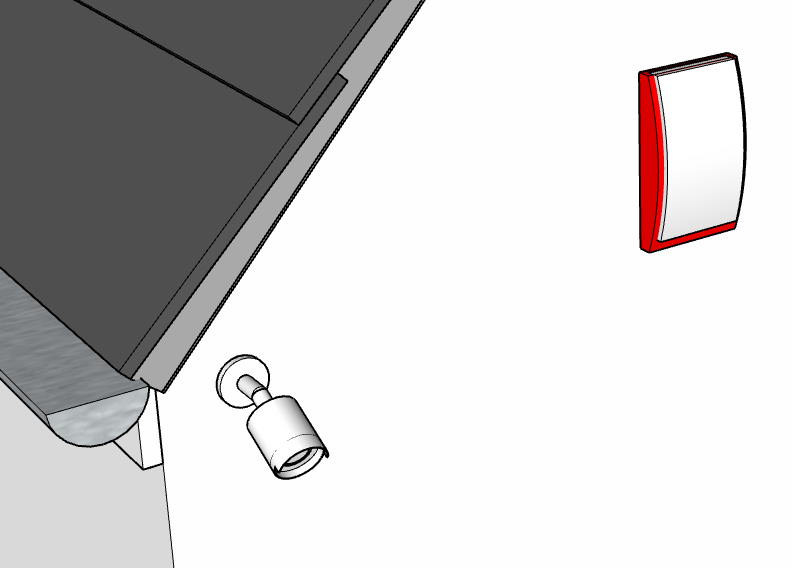

Hilldes Posted March 19, 2021 Author Share Posted March 19, 2021 3 hours ago, joth said: (Besides, I was reluctant to advertise the fact I have Loxone on the outside of my house, but that may just be me) You mean if the savvy thief knew how much Loxone kit costs they'd want to steal it? ? I quite liked the design of the Loxone siren and drew on my 3d CAD model (a bit sad I know): Thanks for the info on the SSR relays will take a look and I already have a 24ch dimmer on order from Aliexpress. Thanks also for the link to the 5 core cable. I was thinking more like solid conductor cables such as mains cabling, but the flex is not a bad price and I guess if your carefull when stripping will be fine. Link to comment Share on other sites More sharing options...

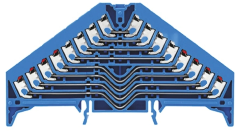

jack Posted March 19, 2021 Share Posted March 19, 2021 1 hour ago, Hilldes said: Thanks Jack, I'm about to purchase some Loxone banks of connectors like the one in the pic. Can I just check for the switches, your are feeding these to digital inputs - say supplying +24v from a PSU in the cabinet to the switch and when the switch closes this applies +24v to the Loxone digital input? .....so the busbar-type din rail termination would be a common +24v? Do you have a specific product in mind? Yes, that's right. You supply 24V to one side of the switch and connect the other side of the switch to the digital input of interest. At the moment, we have a weird arrangement where each extension has a cable extending from the power supply to that extension, to which the wires for the 24V side of the switches for that extension are connected. It's fine if you never want to change or add anything, but it means you need to bring both wires in each twisted pair all the way up to the extension. The product I had in mind would likely be something along the lines of the one for which an image is posted above. It's called a DIN rail termination block. I think I grabbed that image from RS components, but let me know if you have any issues finding what you're after. Link to comment Share on other sites More sharing options...
Hilldes Posted March 19, 2021 Author Share Posted March 19, 2021 (edited) 15 minutes ago, jack said: The product I had in mind would likely be something along the lines of the one for which an image is posted above. It's called a DIN rail termination block. I think I grabbed that image from RS components, but let me know if you have any issues finding what you're after. Thanks Jack, I have now ordered the Loxone terminal block sets - both interconnected and separate (latter very similar to the pic you posted). I did look at alternatives a while back and think I found some at RS or Farnell but were pretty much the same price as Loxone. I thought you had in mind some form of DIN mounted 'busbar' (like the neutral and earth busbars in a consumer unit) for a common 24v but I guess they would need to be split so one PSU only feeds one +24v busbar anyway. Edited March 19, 2021 by Hilldes Link to comment Share on other sites More sharing options...
jack Posted March 19, 2021 Share Posted March 19, 2021 2 hours ago, Hilldes said: Thanks Jack, I have now ordered the Loxone terminal block sets - both interconnected and separate (latter very similar to the pic you posted). I did look at alternatives a while back and think I found some at RS or Farnell but were pretty much the same price as Loxone. I thought you had in mind some form of DIN mounted 'busbar' (like the neutral and earth busbars in a consumer unit) for a common 24v but I guess they would need to be split so one PSU only feeds one +24v busbar anyway. You can get busbar-type products as well, but I think this type is neater and now compact. Link to comment Share on other sites More sharing options...
