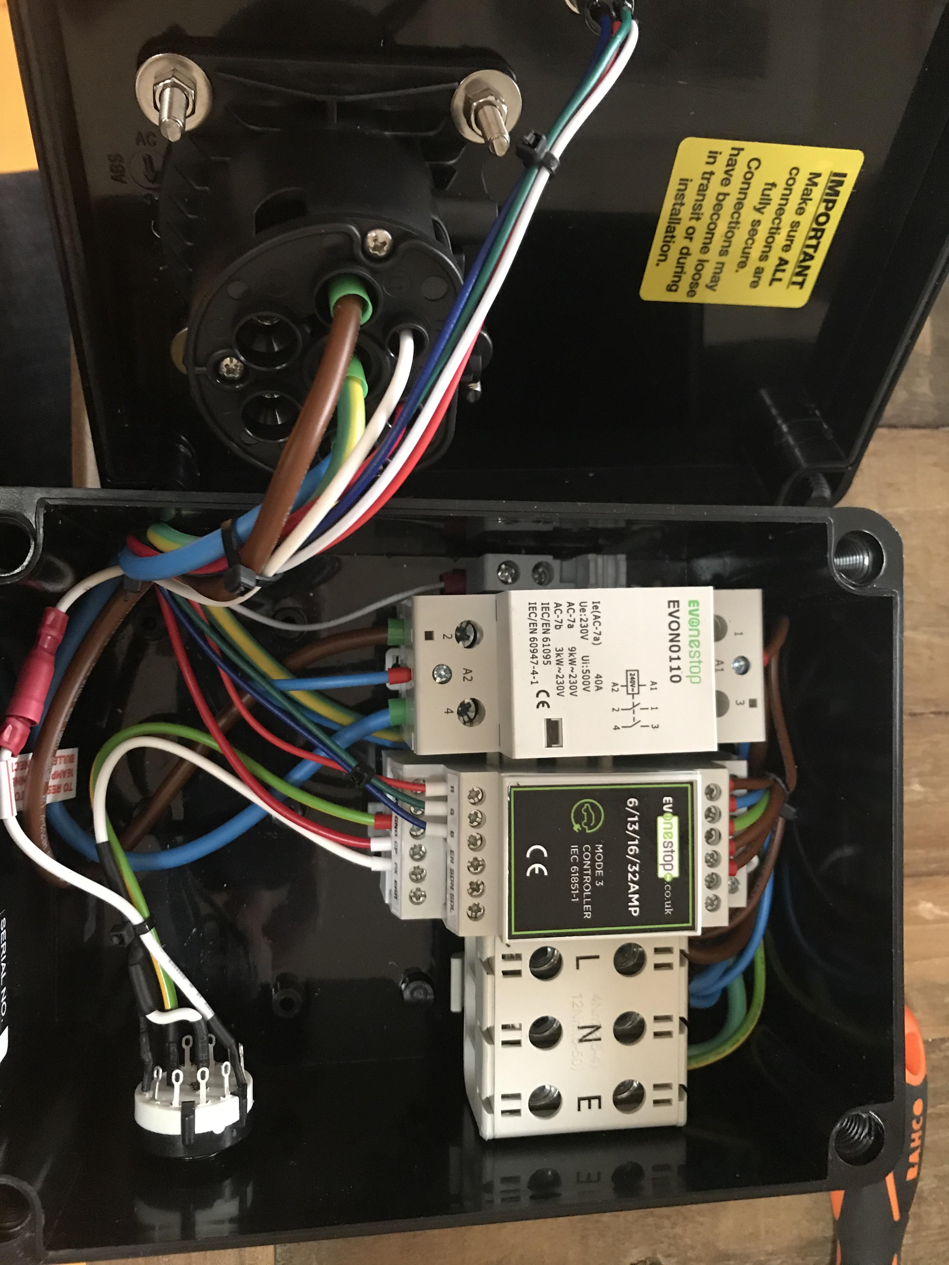

TonyT Posted March 10, 2021 Author Posted March 10, 2021 So that’s the inside. Solid box. contactor butted up to the side of the controller. back of box pre drilled for mounting, some what invalidating IP rating as where box lid unscrews has already a fixing hole in each corner, sealed when box lid tightened up. all conductors crimped. large Allan key termination for incoming power
TonyT Posted March 10, 2021 Author Posted March 10, 2021 Not homemade just a no frills type 2 ev charger. 7kW/32 amp

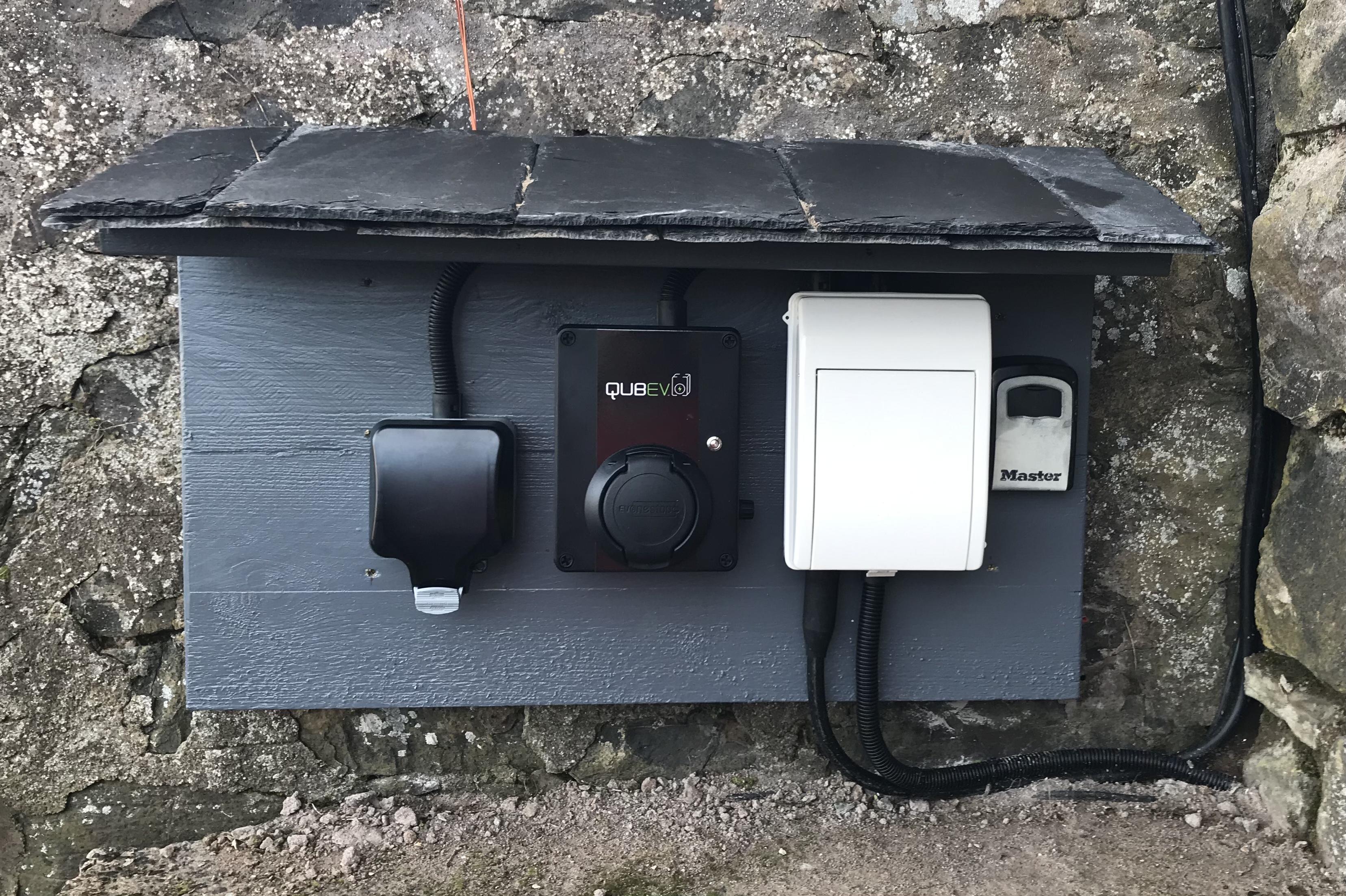

TonyT Posted March 19, 2021 Author Posted March 19, 2021 So charging point mounted onto backboard, along with single socket. 2

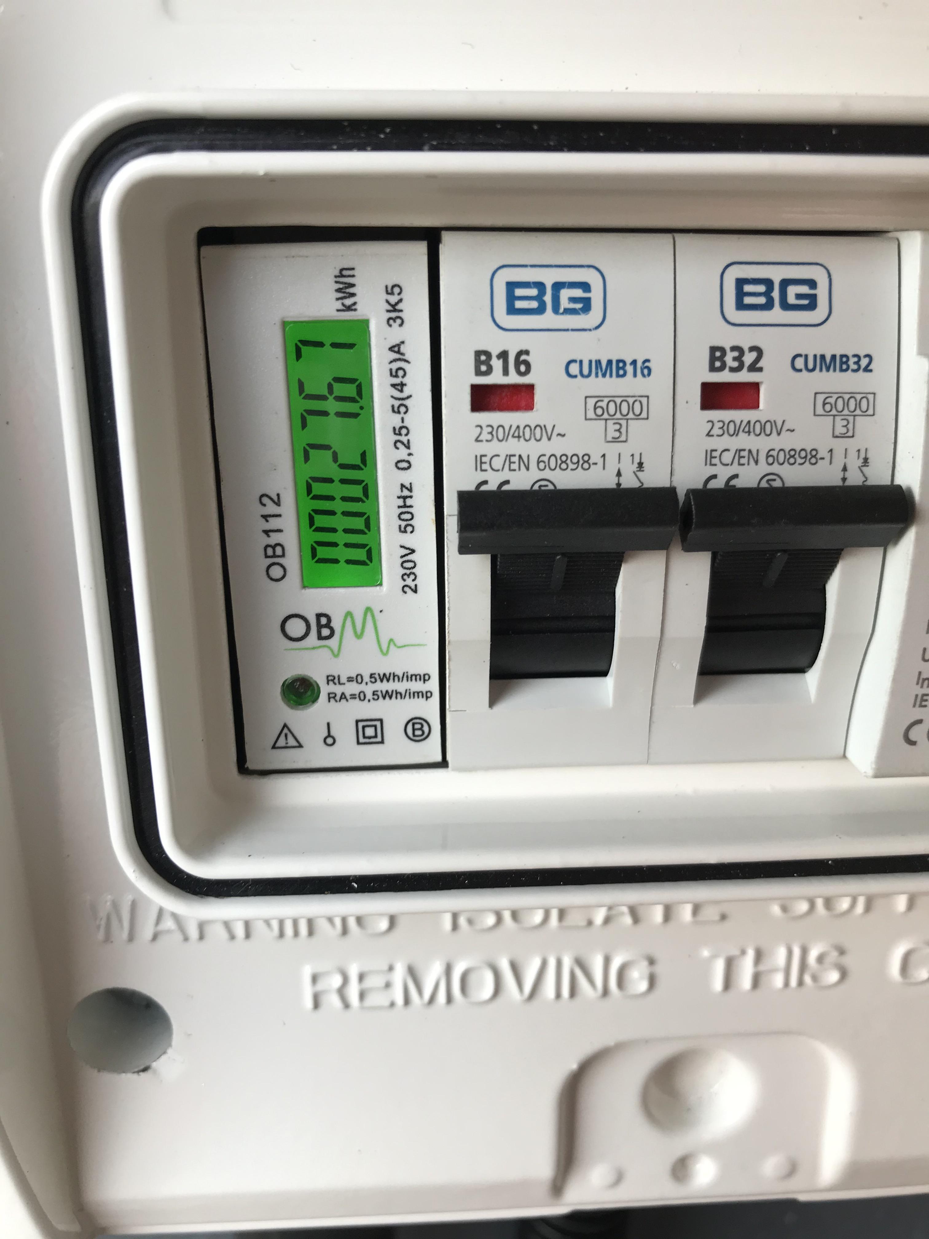

TonyT Posted March 22, 2021 Author Posted March 22, 2021 so the meter works well, first time charging at home, as I’m on holiday this week the meter is fed from the MCB for the EV , line and neutral in and output of meter directly to EV Charger. 1
MortarThePoint Posted March 22, 2021 Posted March 22, 2021 1 hour ago, TonyT said: so the meter works well, first time charging at home, as I’m on holiday this week the meter is fed from the MCB for the EV , line and neutral in and output of meter directly to EV Charger. I like the look of that little meter. Do you have a part number?
trialuser Posted March 22, 2021 Posted March 22, 2021 I loiked the look of it as well, so I bought one here No idea if the price is any good but ebay is convenient
TonyT Posted March 22, 2021 Author Posted March 22, 2021 OB112-45AMP kWh Electric Meter. Digital Backlit Display. MID Certified. it’s available direct from Owen Brothers or eBay/ amazon
