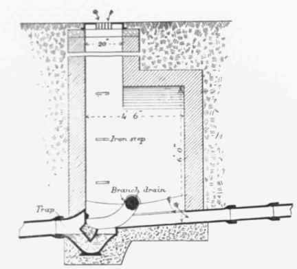

fiaraziqbal Posted March 8, 2021 Posted March 8, 2021 (edited) Good morning, I am laying out the design for a new build connection to.a main sewer line that runs on my land. Its 160mm uPVC and i shall be connecting with a standard 110mm soil pipe. I am only applying for the building regs as opposed to carrying out the actual work. I undestand all the componenets except for one, i have been asked to place a disconnection chamber into the design near the main swere pipe yet i do not seem to ba able to locate that specific componenet. Is that the same as an inspection chamber? or does it have a different name? Regards fiaraz Edited March 8, 2021 by fiaraziqbal

Temp Posted March 8, 2021 Posted March 8, 2021 Google found this. Sounds like a combined u bend and air vent ? https://chestofbooks.com/architecture/House-Construction/Ventilation-Disconnection-And-Inspection-Part-2.html "A disconnecting chamber or manhole within the curtilage of the premises and as near to the public sewer as possible. is infinitely better than a simple air-inlet pipe. The size will depend largely upon the number of branch-drains connected with it, but there should be plenty of room for access to the disconnecting-trap for inspecting the drain, and for cleansing it whenever required. The entrance-cover may be provided with an open grating to serve as an air-inlet, or it may be found preferable to use an air-tight cover, constructing an air-inlet in the manner shown in the last figure. Fig. 335 shows a section of a typical disconnecting chamber. In the drainage of town buildings, especially office premises, it is difficult to provide within the curtilage a disconnecting chamber, so that this will have to be constructed under the footway, subject to the approval of the local sanitary authority, who will no doubt not only exact a payment for the easement."
Temp Posted March 8, 2021 Posted March 8, 2021 All the drawings i can find of a "disconnecting chamber" are very old. It appears to be located at the point where your private sewer becomes public. I'm wondering if they just want a regular inspection chamber at that point these days?
PeterW Posted March 8, 2021 Posted March 8, 2021 3 minutes ago, Temp said: All the drawings i can find of a "disconnecting chamber" are very old. It appears to be located at the point where your private sewer becomes public. I'm wondering if they just want a regular inspection chamber at that point these days? That’s an old clay interceptor trap ..! Haven’t seen one of those in years ..! Real pig to clear and they fail and what happens is they flow over the top of the D entry point and people pull the plugs and they never get re-installed.
Temp Posted March 8, 2021 Posted March 8, 2021 More googling finds "Demarcation chambers" from several companies. https://hspipe.uk/product/hs-demarcation-control-chamber/ https://www.mjabbott.co.uk/products/hs-r-demarcation-chamber I think you may have to ask Building Control what they want unless someone else here knows.

HerbJ Posted March 9, 2021 Posted March 9, 2021 (edited) The house I demolished for my new build had an old interceptor chamber. It was originally the lodge house for a Victorian mansion, which had been gradually subvivided into 10 plots large plots, from 1950 thorugh 1970. It was the last chamber on the system at the time. When I was dealing with Thames Water on my new build, I was told that they were first introduced in Victorian times: in cities to stop smells(and rats) from the main system passing back to houses - a real problem for terrace houses and the like - see https://www.labc.co.uk/news/my-dad-told-me-about-them-drain-interceptors. Anyway, I was told it was no longer necessary and could replace it with a new inspection chamber, which was a big help as this gave me an extra 200 - 250mm or so drop in invert level and improved my foul water drainage design/layouts. Edited March 9, 2021 by HerbJ

fiaraziqbal Posted March 17, 2021 Author Posted March 17, 2021 As an update, a disconnection chamber in scotland is a standard inspection chamber and is the point at which the responsibility for piping belongs to scottish water.
